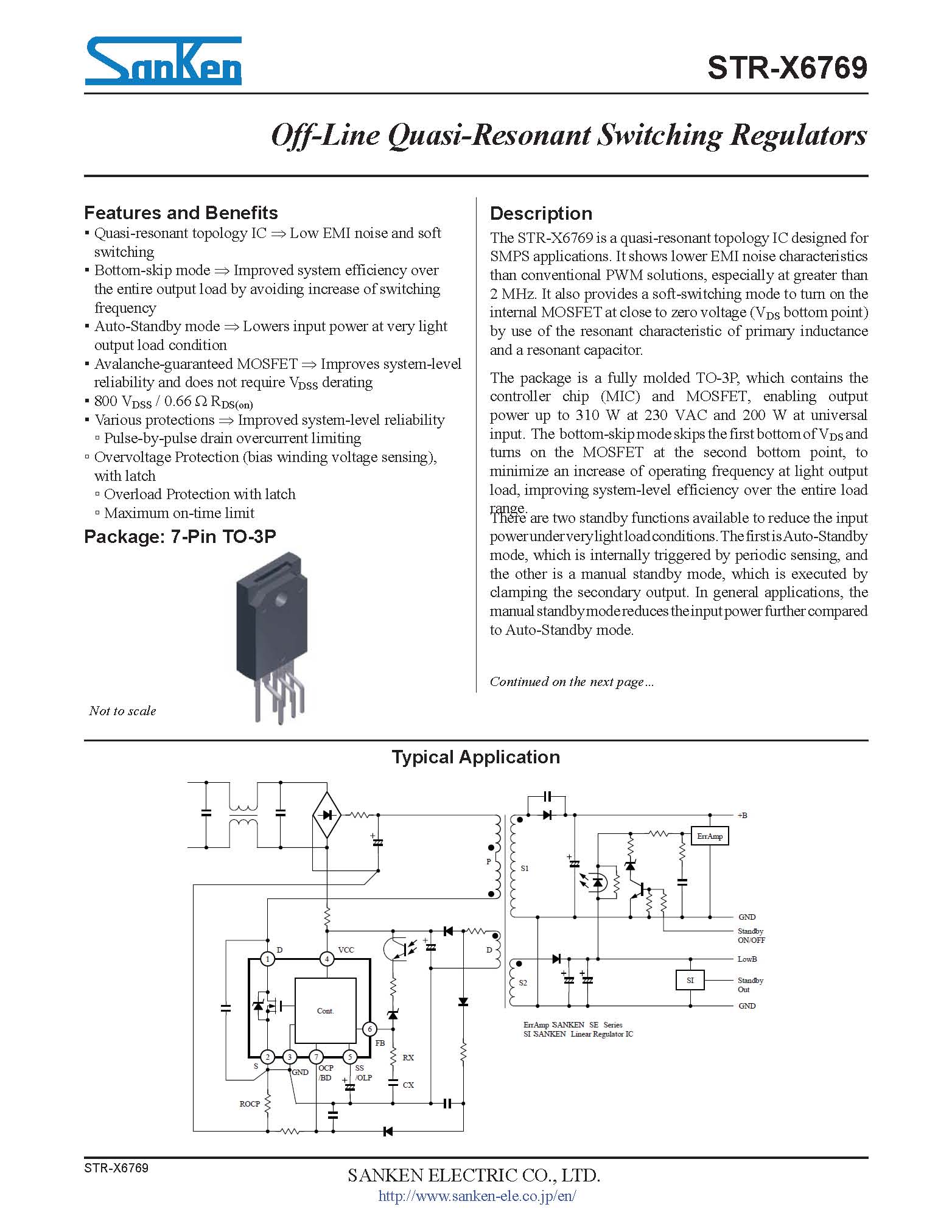

    1000V RU2C Diode https://cdn.badcaps-static.com/pdfs/...5711cea6d2.pdf
    Skanken str-x6769 regulator https://cdn.badcaps-static.com/pdfs/...4cf767d514.pdf

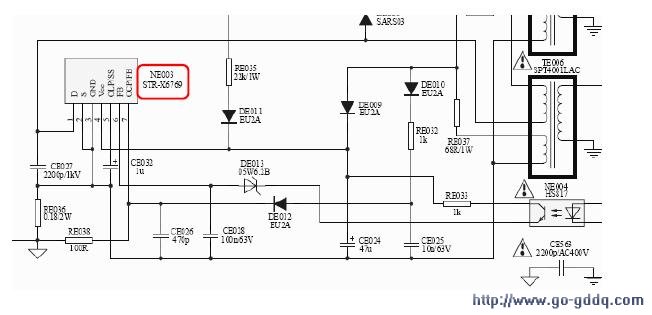

    The problem I have is the unknown resistor. It is completely fried.
    The resistor was connected to pin 7 of the Sanken STR-X6769 IC which is the Overcurrent Protection/Bottom Detection pin.
    Pin 7 splits into 2 paths, one path goes to a diode(not the faulty one) the other goes through the unknown resistor to the negative of the main bridge rectifier.
    Looking for schematics has been fruitless. Does anyone know what size resistor needs to go in. While i'm picking it will be a guess, where should I start, high resistance or low resistance?

    Here is one application which may help you.

          Thanks Dick for that picture, it's a massive help. The whole circuit is virtually the same. A 100 ohm resistor is what I need.

            Re: Uniden LCD TV power supply help
            i think what happen when the IC shorted it, the resistor on pin 7 was also got dumped by the HIGH Voltage (>300VDC) feeding the IC.
            You want those resistors to go open circuit when the IC failed so in case the main fuse did not blow, the resistors were damaged due to the failure of the IC, so when the resistors go open circuit then the current stop flowing which is what you want to happen when the fault occurs instead of heating up the resistors that may burn up other parts nearby and catch on fire.
            The resistors burnt up for reason due to too much current flowing through them.

                  Just a follow up on this if anyone has a similar issue. Optocoupler NE004 in Dicks pic above was also faulty. Datasheet for it is:
