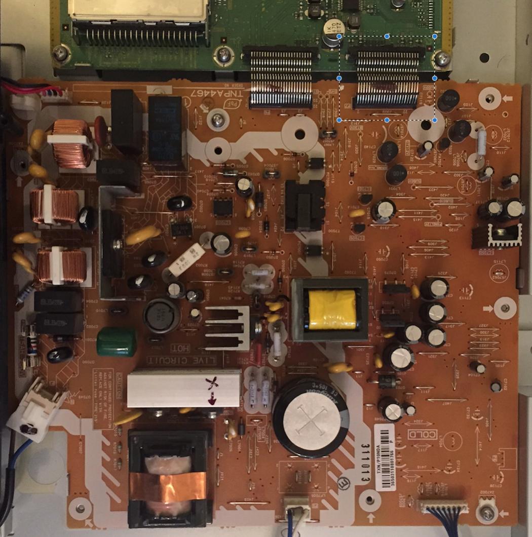

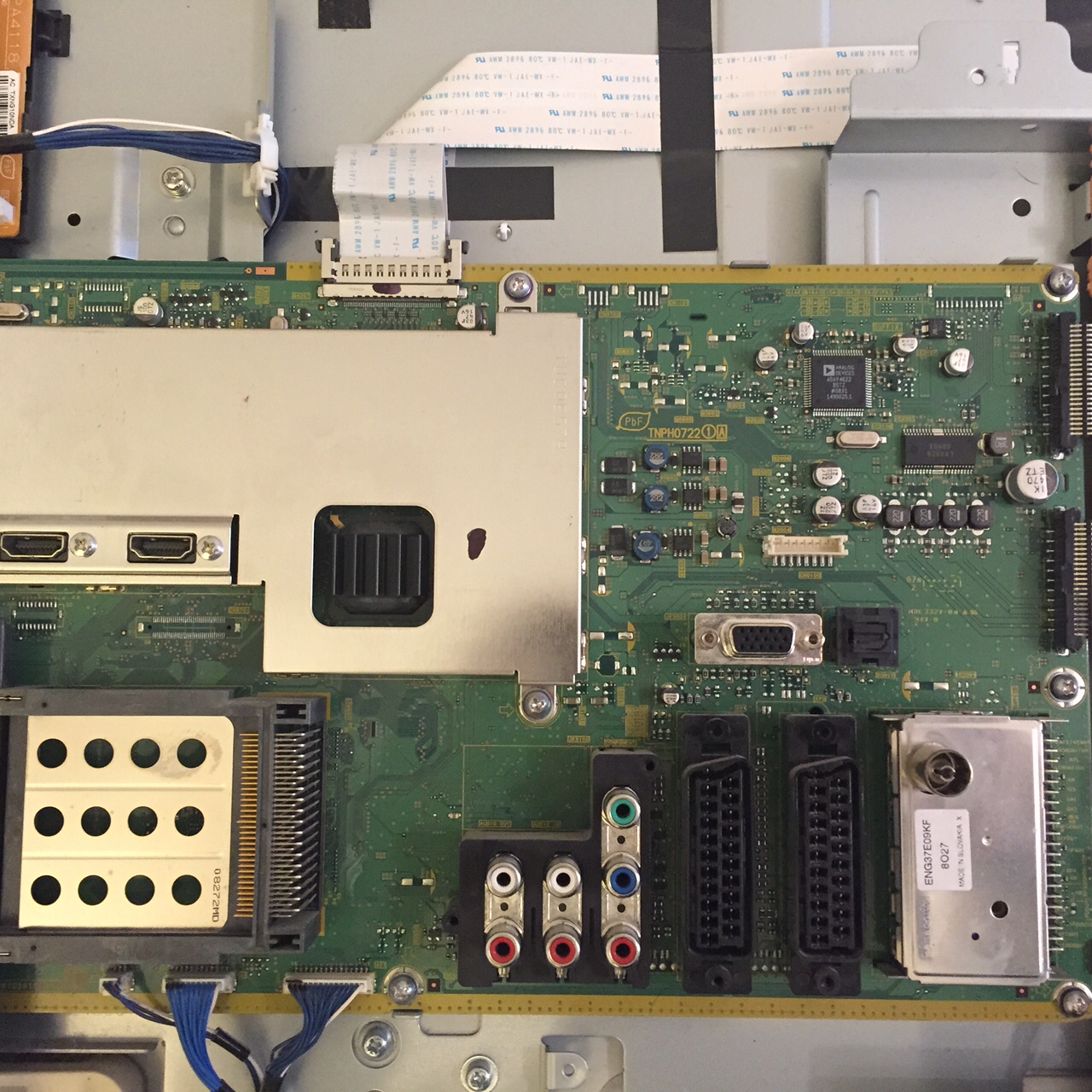

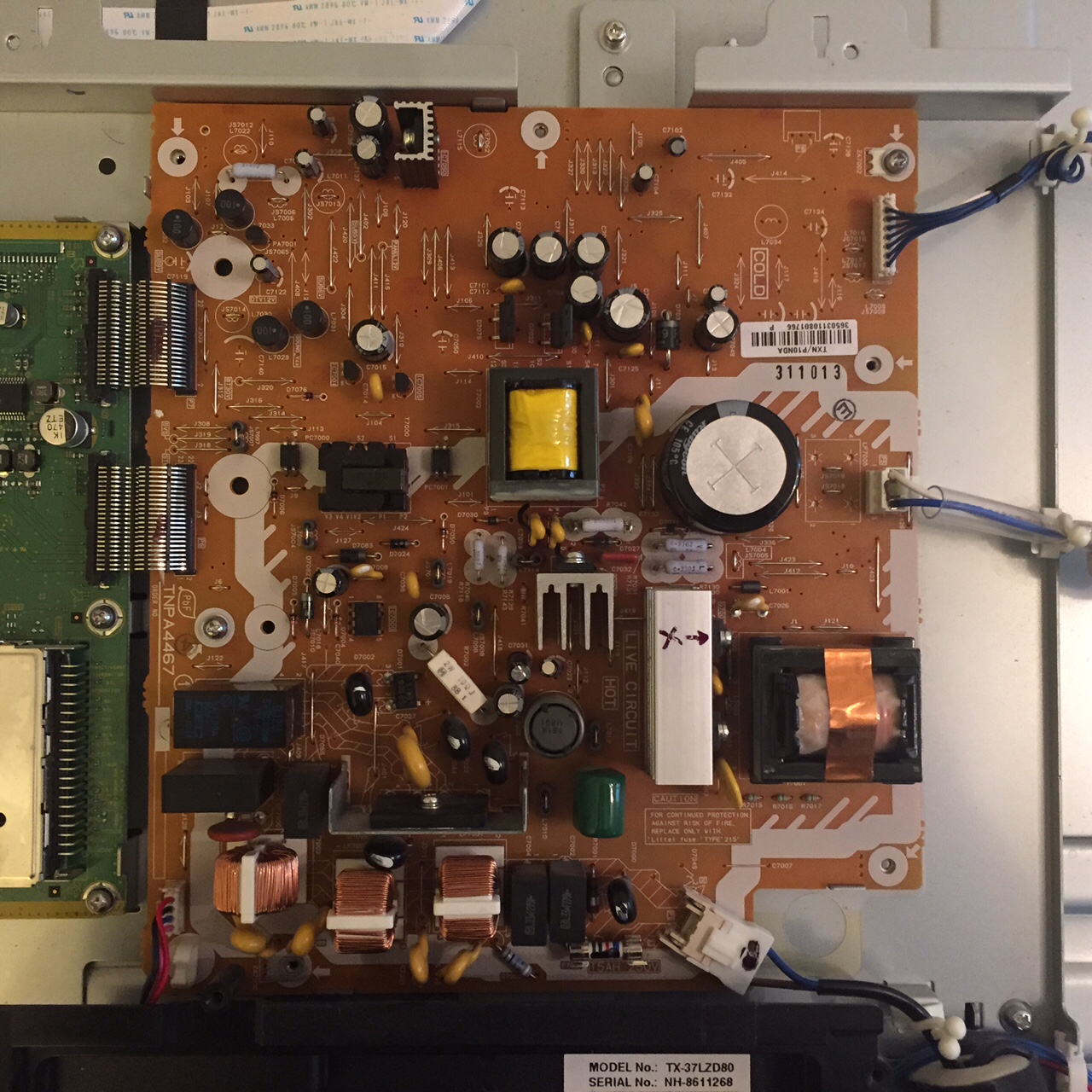

    Hi
    I wonder if anyone has experienced this before. Link is to youtube which shows exactly same problem with set I'm working on. I've located a repair kit and checked the components in the kit to my set but all seem to check out fine?
    https://www.youtube.com/watch?v=qlnFitNazG4
    If I disconnect the bendy connector highlighted, I get a red led 4 blink flash at the power button, if that helps? Disconnecting the inverter board still gives the rapid green flash though!
    I hope the photos are ok!
    Thanks in advance.

    Here's a link to the service manual and has blink codes.
    http://www.electronica-pt.com/esquem...artdown/18013/

      Thanks Mr Barton! Looks like a new A board then!!
