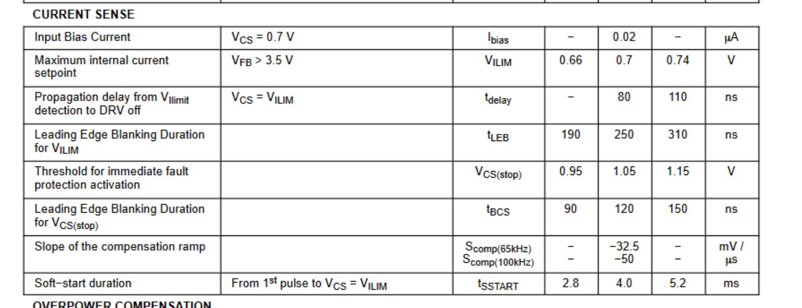

                    Re: Panasonic TX-P50STW50 Power Supply no 5V (was clicking)
                    Oh and one more question @R_J:
                    Am I getting you right that it might be the 34A65 limiting because it senses an error on the CS pin?
                    If I was able to understand the 34A65 Datasheet, I could measure whats happening on CS and see if it is correct?
                    This stuff is way above my head so far but I am here to learn, so Im trying to understand.
                    I attached the table that describes Current sensing of 34A65. I dont know if any of this can be measured without an oscilloscope but I should be able to get my hands on one if needed.

                      • R_J
                        • Jun 2012
                        • 9576

                        The CS pin voltage changes at the operating frequency (65/100kHz), You can try checking the voltage with a meter but you need to be very, very careful where you measure it. Try not to probe right at the ic, one slip and it could be a disaster.
                        You could also try checking the feedback line to the ic, If the feedback is not working the ic will not detect the drop in voltage on the secondary (5v) and not increase the drive to compensate.

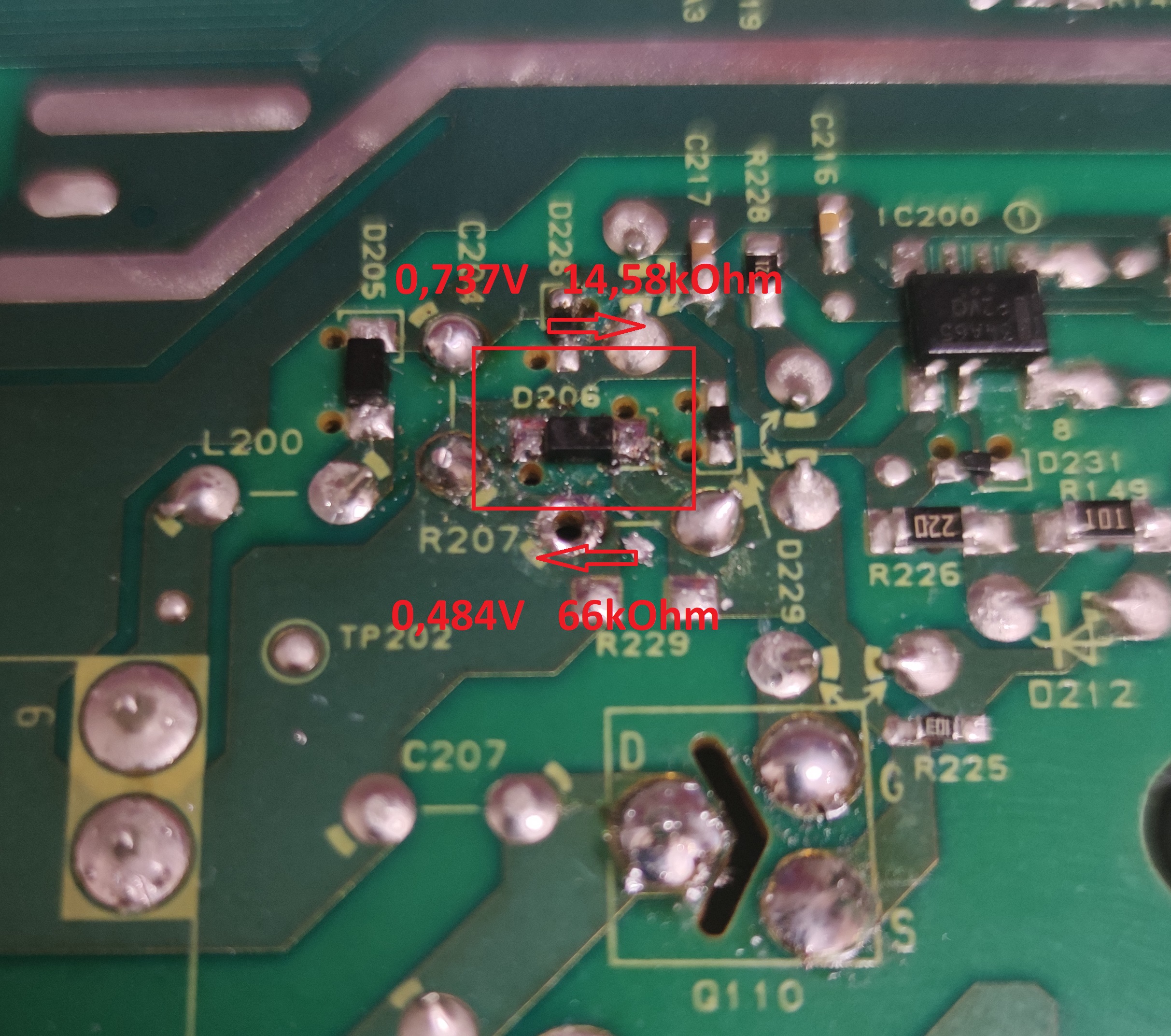

                          I unsoldered R207 and measured it at 0.6Ohm which seems good enough.
                          Then I tried to check the Diode and Im not quite sure what I am seeing and if it is at all possible to check it in the circuit. I attached a picture of the actual board and he readings.
                          In diode mode my meter reads 0.737V from T200 towards IC200 and 0.484V in the oposite direction. I assume that means the diode is not reversed and not shorted, right?
                          • R_J
                            • Jun 2012
                            • 9576
                            The diode is not shorted, but it is hard to say if it is reversed or not, use some alcohol to clean the top of the diode so you can see the letters or marks. in diode mode it should read around .6xx volts one way only. the cathode would be the negative lead of the meter when it reads .6xx v
                            You don't indicate which way your probes were so the arrows don't mean much. was the negative probe (black) at the point of the arrow?

                            • Ierwin
                              • Jul 2017
                              • 103
                              Oh, you are right, these errors do not make much sense.
                              They are always from black probe to red Probe. The point of the arrow is where the positive prove was.
                              I will try to clean up the diode later
                              *edit*
                              I was not able to uncover any markings on the diode so I eventually gave in, unsoldered it and measured it outside of the circuit.
                              I even put another larger diode with a visible marking next to it to make sure I do not do anything stupid with the probes.
                              I am now 100% sure that the diode is correct.
                              Oh and yes... I had it wrong before .
                              But the bad news is: it makes absolutely no difference to the 5V line.
                              *edit2*
                              Tried to measure CS on IC200 (I used R228 and pin 5 of T200 so I dont short the pins).
                              0.001V in AC mode. I have no idea if my meter is capable of measuring AC at the frequency it needs to
                              *edit3*
                              And Im reading 0.776V on the Feedback Pin

                                        I have a large box of resistors at my place so I assumed I should have a 2.2Ohm. I unsoldered the 4 resistors in series and took the board home.
                                        After hours of searching through the box I realized I do not have a 2.2 at home either so I used 4 10Ohm in parallel.
                                        Since then there has never been 5V on the output of the regulator.
                                        It frustrates me to no end because I know it has been working and I didnt even change anyhitng (critical) afterwards
