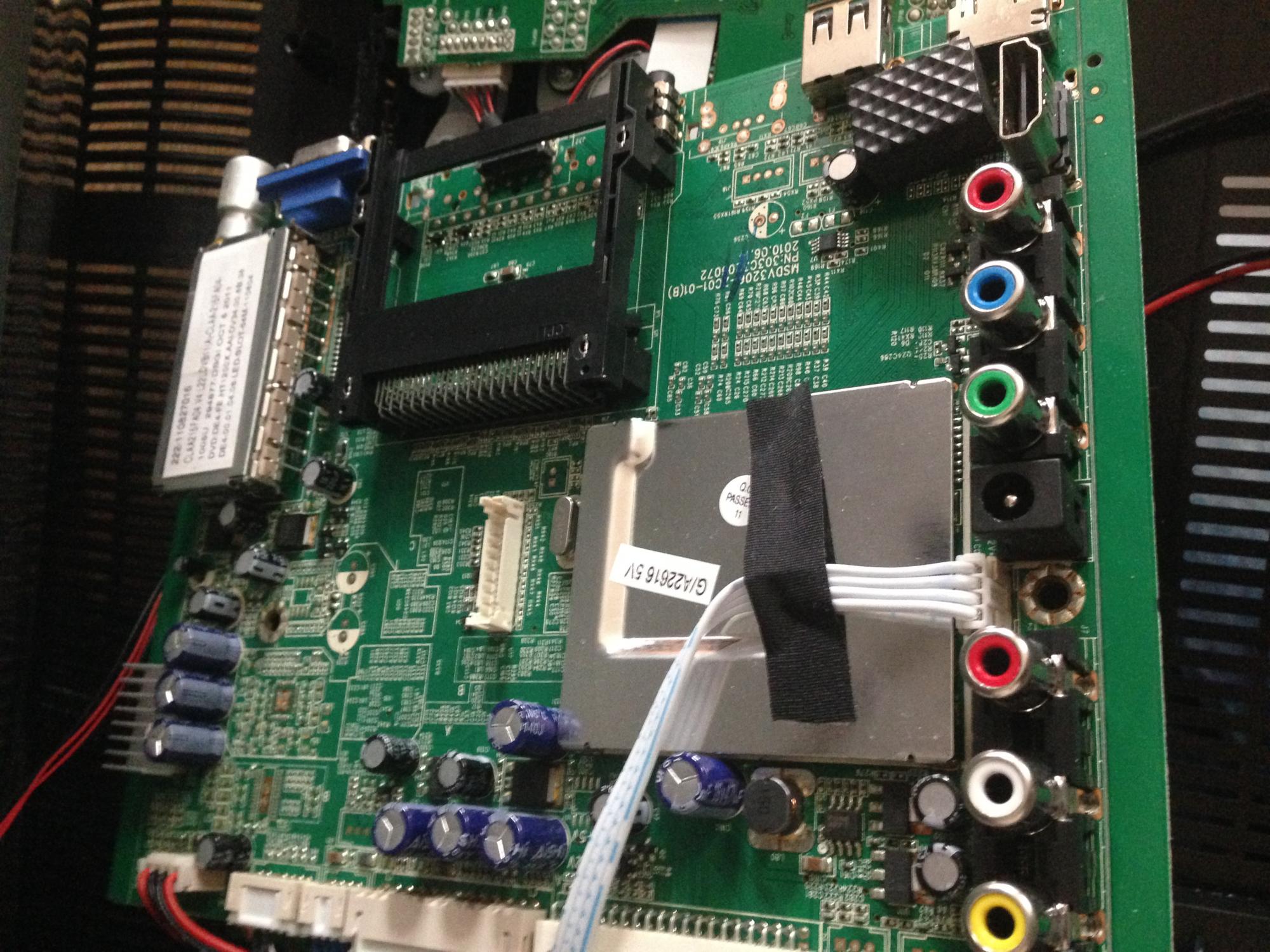

    Hello forum,I have a logik 22'' LCD,it has developed a fault,where the standby does light up switches/lights up briefly then switches off back to standby,just reading up could it be more of a firmware fault ? Help please

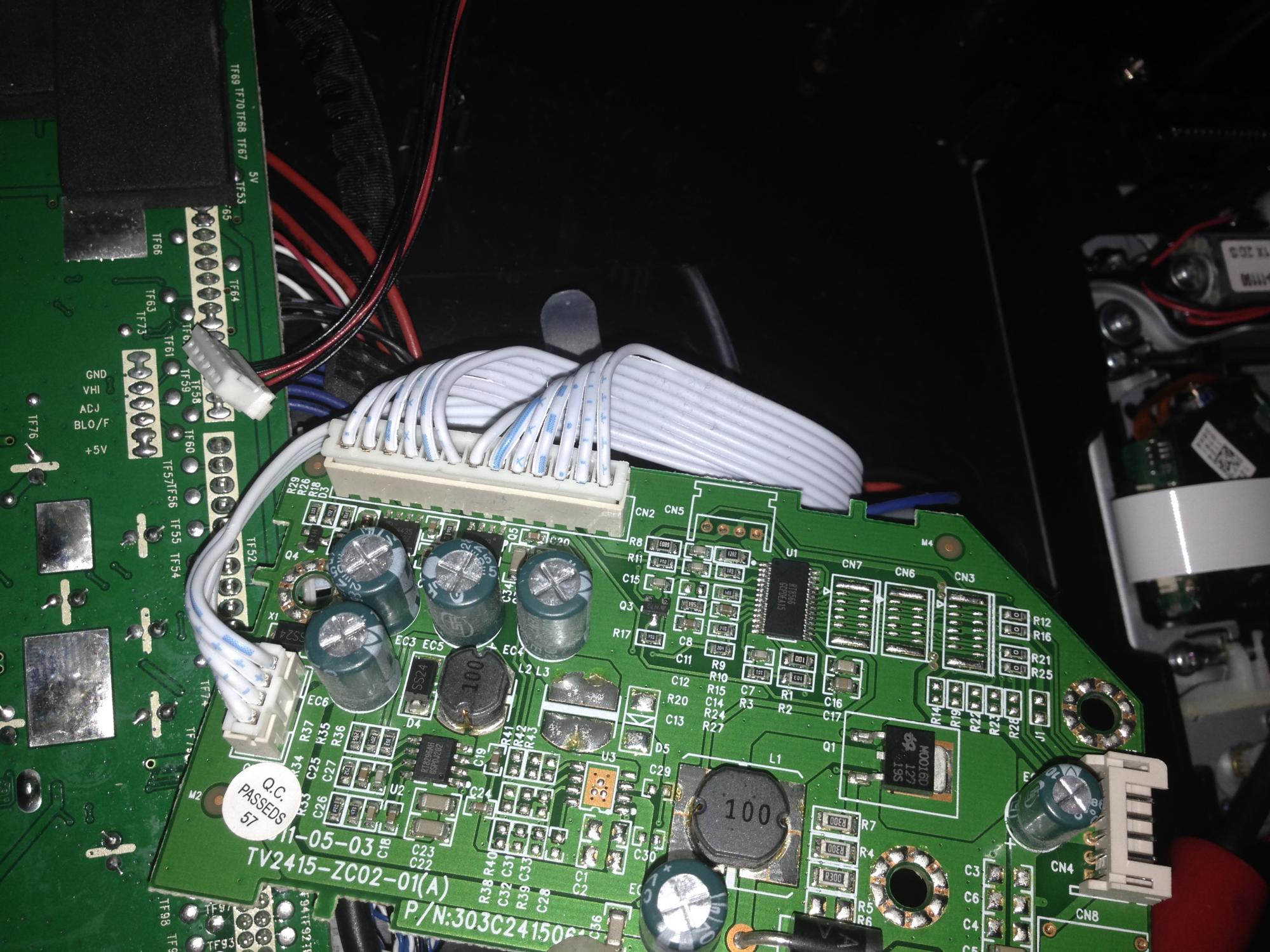

    Have you measured any voltages on the power supply connectors. Do you have pictures of the circuit boards mounted on the chassis. If you can post those details it would help others help you.

      Re: Logik l22ldvb21
      [ATTACH]129408[/ATTACH]

        Re: Logik l22ldvb21
        [ATTACH]129409[/ATTACH]

          Re: Logik l22ldvb21
          Yep I have the same board here, bad firmware on mine so chances are same on yours bro. Crappy junk.

              Re: Logik l22ldvb21
              Unless you find the FW for the board and panel no

                  Re: Logik l22ldvb21
                  You need to reflash the SPI memory Ic outside of the Tv using an SPI analyser. Just get a new board mate as its difficult to do.
