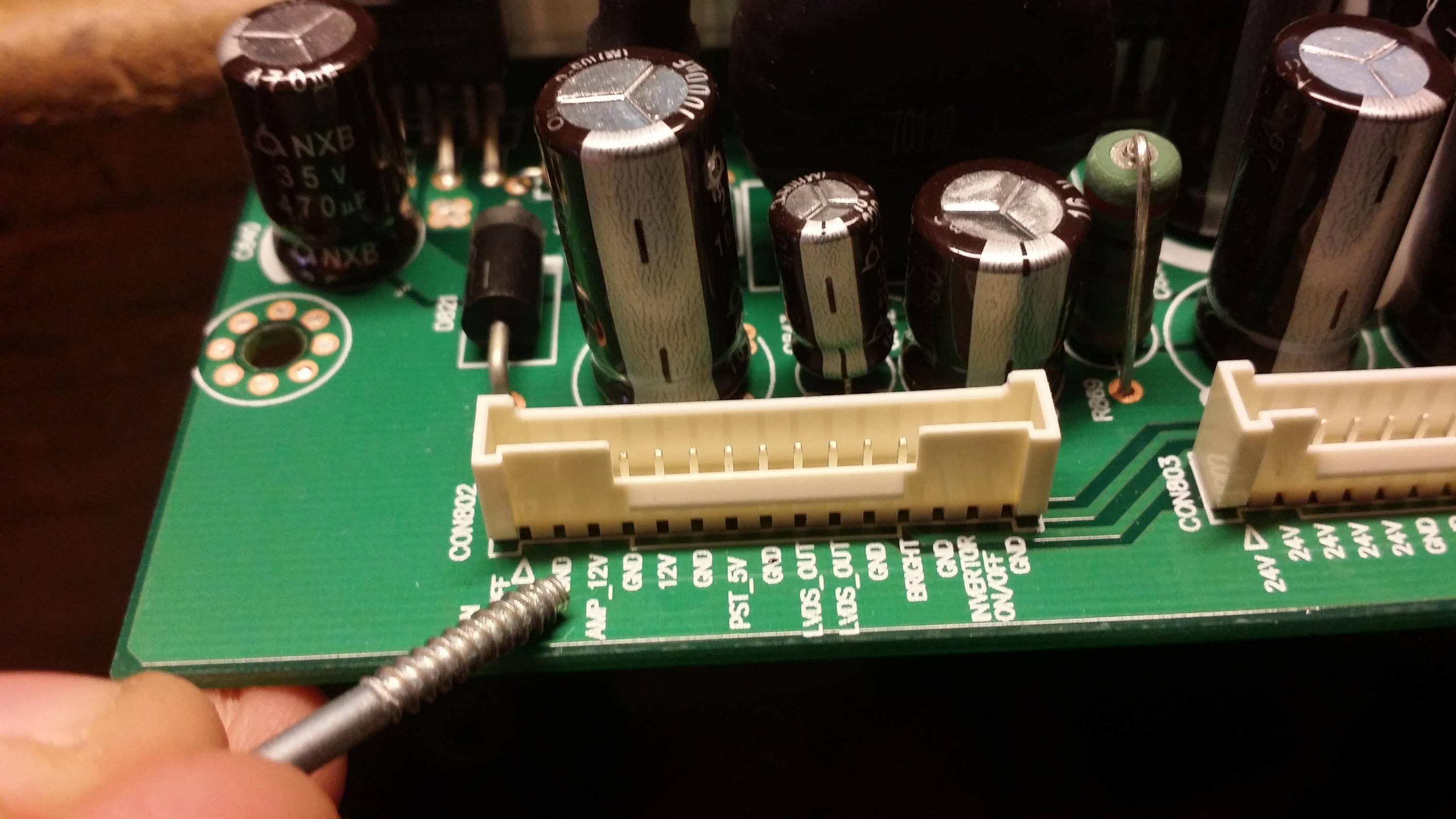

                  I'll recheck but that seems to be the case idk what to say. On the mainboard DC connector I get 12v and 5v and 28v in standby. Ok on this time testing once powered on I'm getting 1.0v on 5v stanby and on the 28v inverter pins I'm reading 0.68v.

                      I'll go thru and mark each pin right now the exact voltages in standy and powered on.
                      With a clear pinout and picutres of the pins. Give me 20 min.

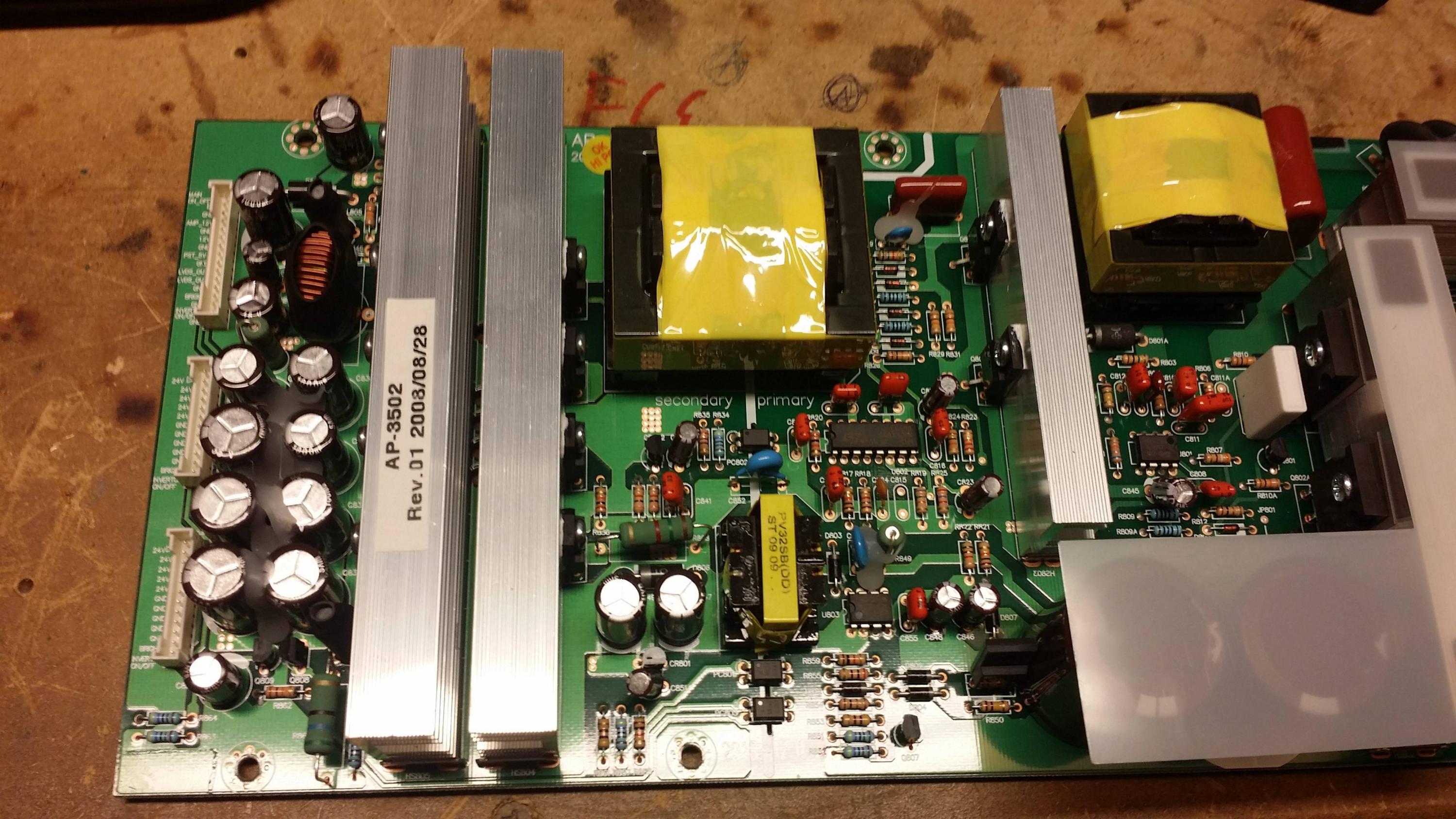

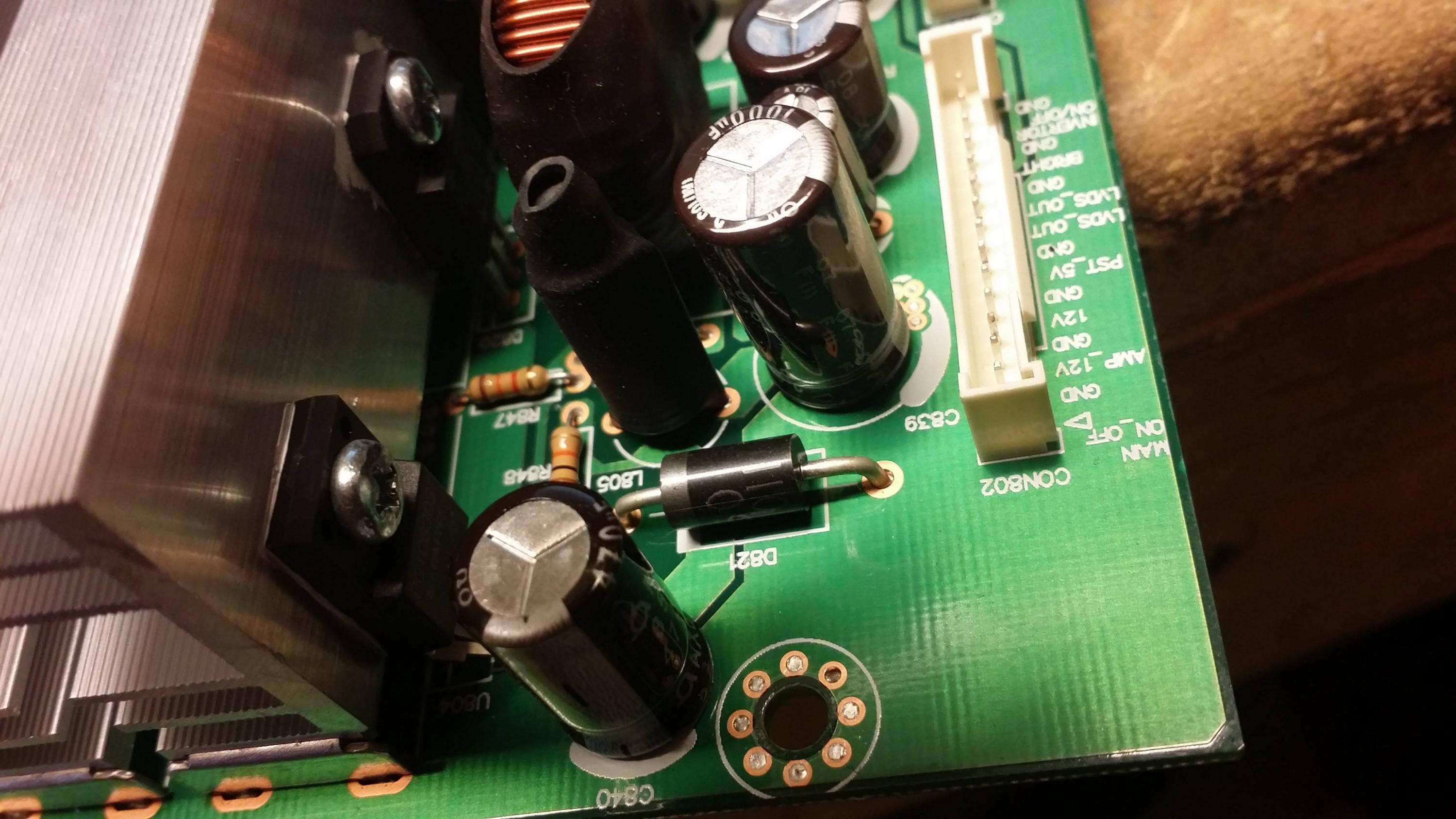

                          Well now I'm back at it again. The board is no longer supplying power to the mainboard as I am unable to turn it on. I am looking for I may have blown when I shorted 12v- to ground. I did not have anything connected to the PSU when I did that so it must be on that board. If you or anyone else can help point me where to look I'd appreciate it. At this point its a learning experience for me more then a repair.
                          Or if you think its a lost cause I found an inverter board and power supply board for pretty cheap but I'd rather learn on this one before I call it a day and just swap out parts.
                          I uploaded some more pics of the main board along with where I shorted 12v to gnd.
                          I also took a pic of a large diode which seems to be open??
                          http://imgur.com/a/pgfRI
                          there are two of those on the board and both test open. So could this be the issue?

                              Can you please do the straight shots of the board both top and bottom side?

                                    So at this point are there any DCV on any of the power supply pins that goes to the main board? You should at least have the Standby Voltage for the main board, the Switched 12V/24V will not be present on the power supply board until the main board sends the PS-ON to run on the 12V/24V circuits.

                                      http://imgur.com/a/Ycdxh
                                      here are pics as good as I could get them. When I last checked there was no standby at all and when I checked the red power light is not on.
                                      But I will hook up the boards again and try it out.

                                        You can test the power supply board by itself since the standby power supply is an always on power supply which the Voltage should be present the minute you apply the MAIN AC to the power supply board.

                                          Ok it does indeed have 5v standby
