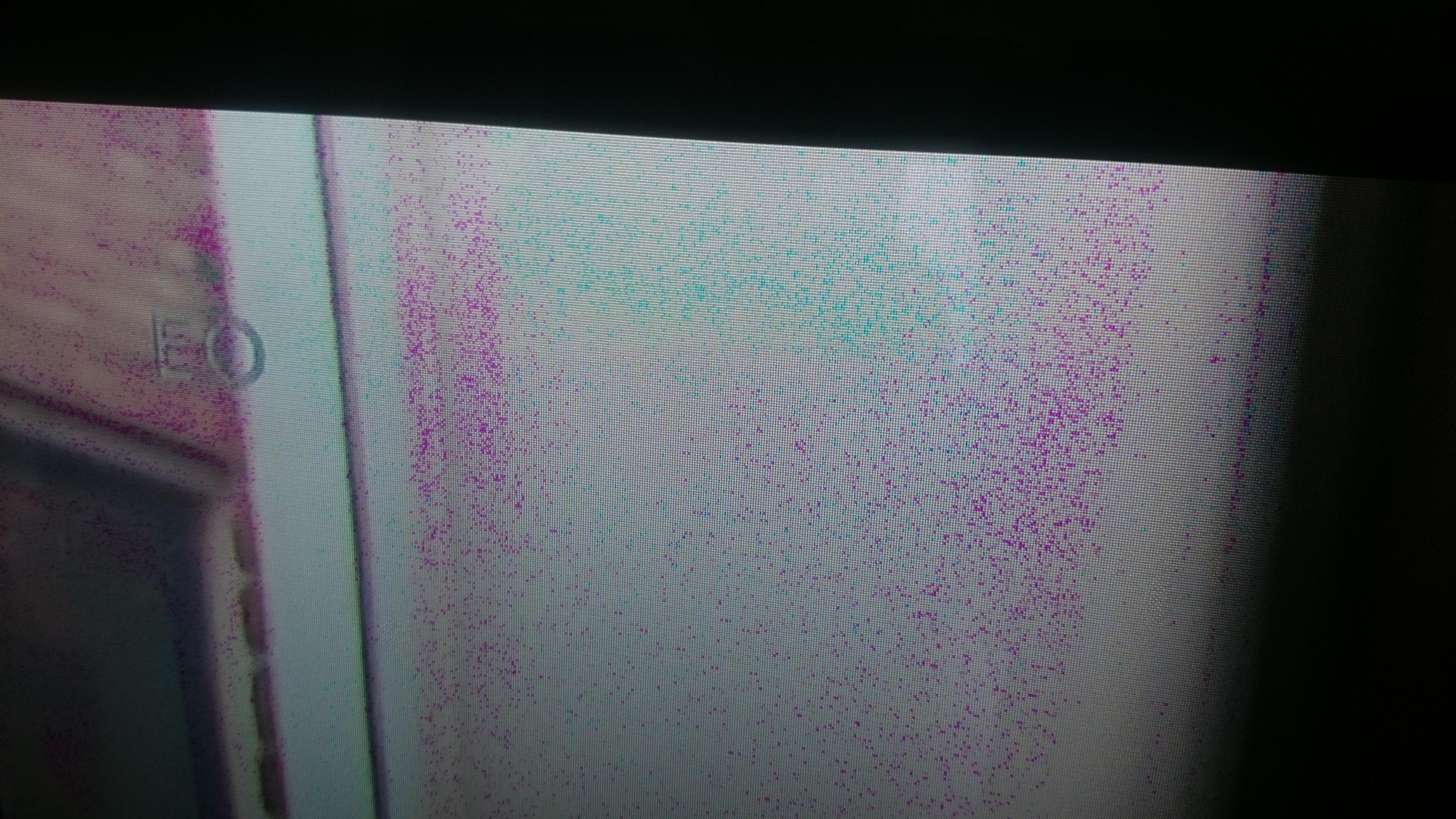

    Hey guys ,
    50VT30 after 7 blink repair! Im getting pink sparkles on whiter area's.
    Tpvsus is 114v
    Tpvad is 69 vdc , fluctuates a bit...
    I cant find the correct voltages for this model. What pot meter do i need to use? Can this be dust also?

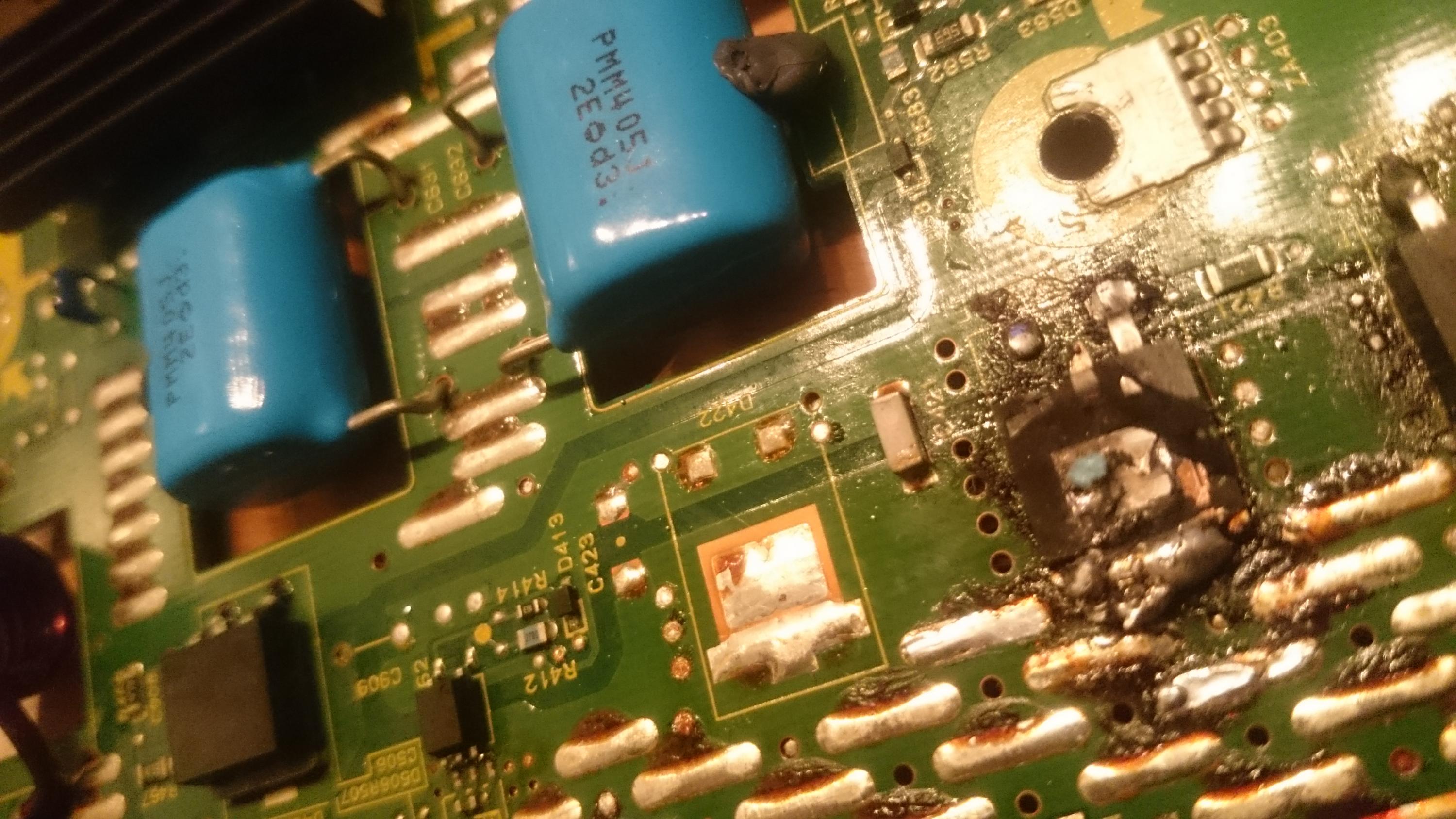

        Hmm , one IGBT ( Q421 ) just exploded. Did not touch the potmeters , they are still on its original value. IGBT is literally in half.
        Back to the drawing board! :/

                Were some very loud bangs , not just one!
                All 6 IGBT's + RF1501 + DAF30 died.
                Will take the board back to work tomorrow and replace all components again! It might explain the sparkles....maybe bad IGBT?

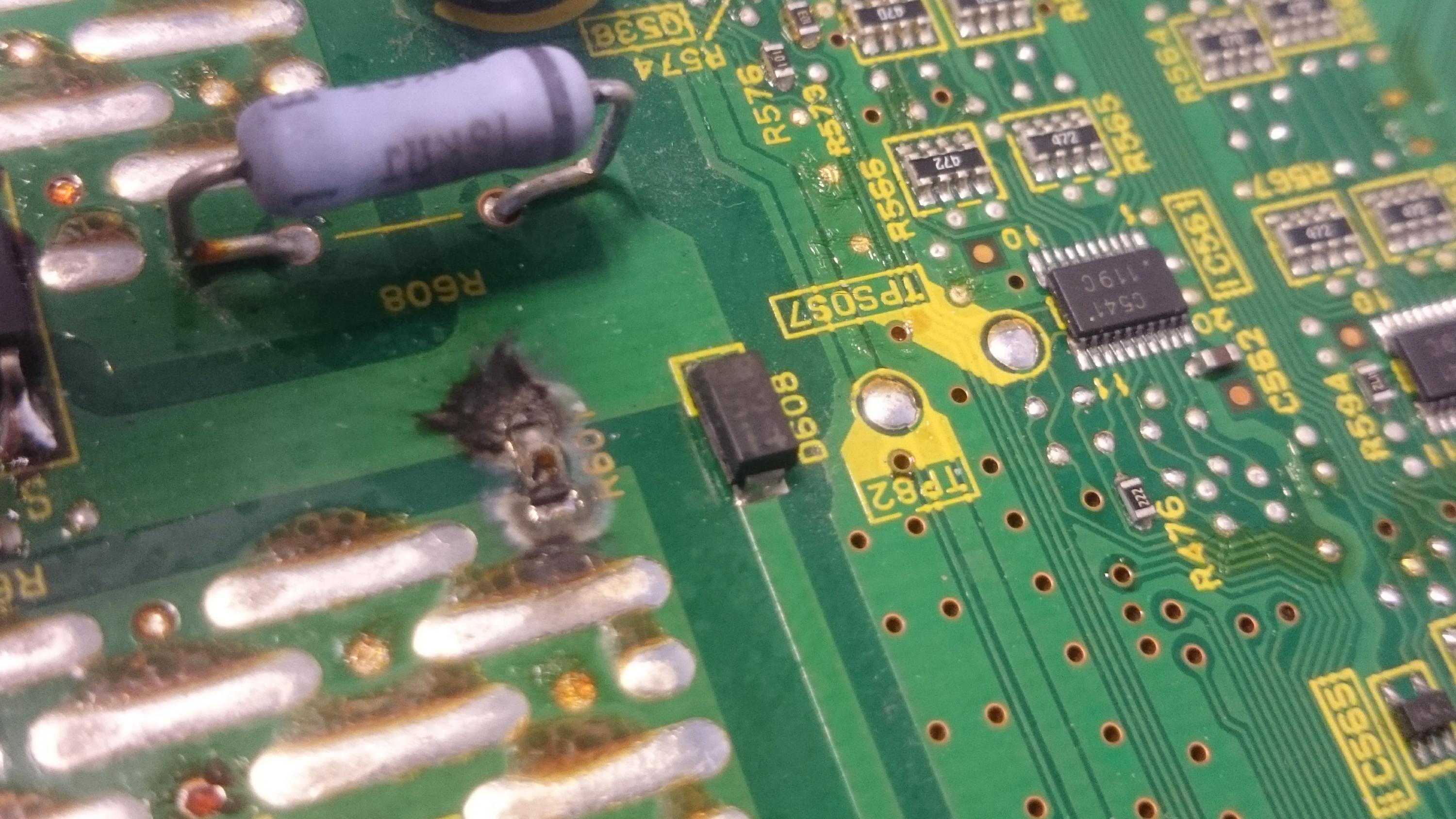

                          SC board is in Panasonic heaven and officially dead.
                          The big bangs ( 4 or 5 bangs ) on the sc board destroyed alot of components. Some pads came off and a few resistors were black/measuring OL. I seriously have no idea what happend. Maybe a resistor that went bad?
                          The dirt you see on the board was already there + exploded solder. Looks like alot of solder but that exploded
                          Resistors are measuring OL and Small diodes are also short + big diode near exploded resistor is short.
                          Small IC near Q621 is damaged but the 7.5ohm resistors are still ok! Only IGBTS that are short are the standard IGBTs , rest is ok.....
                          It probably can be fixed but i ordered a repaired board from Ebay so i can sell the tv.
                          Can someone tell me what caused the sparkles? SC board?
                            Re: Panasonic 50VT30 , Sparkles after SC Board repair.
                            TPVSUS should be MUCH higher than 114V...I doubt you'd have an image that "good" with Vsus that low (it'd basically be a few pink pixels splattered across the panel and nowt much else!)
                            Also Vda should surely be lower than 69V (more likely around 55-60V)
                            I think your meter has a problem...or the power supply has a really serious problem

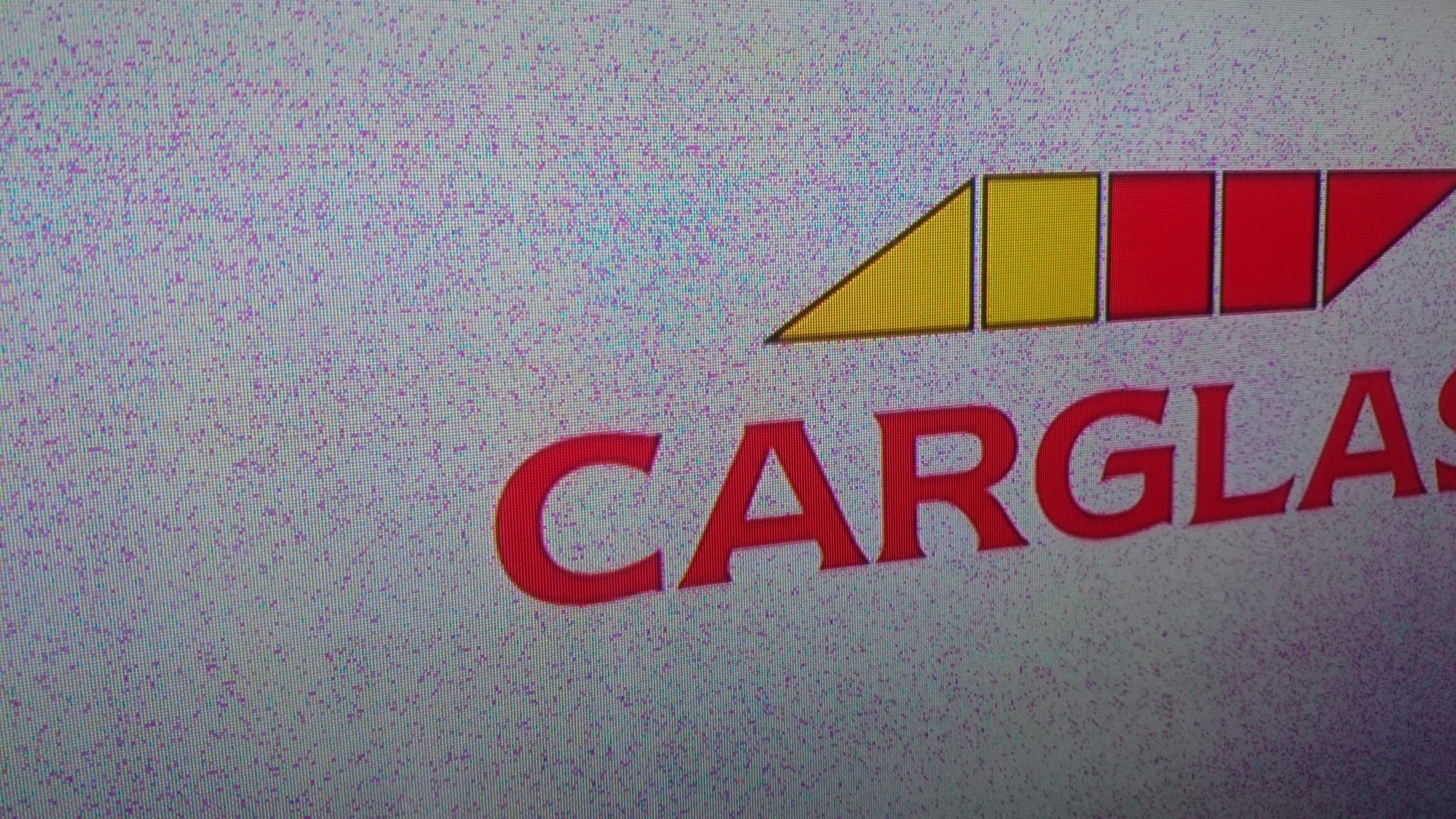

                                    Replacement board is working perfectly. TPVsus is 213V and little to no sparkles.
                                    Tried it at the maximum of 217V but no differences! 213V looks good so i'll keap it this way.
