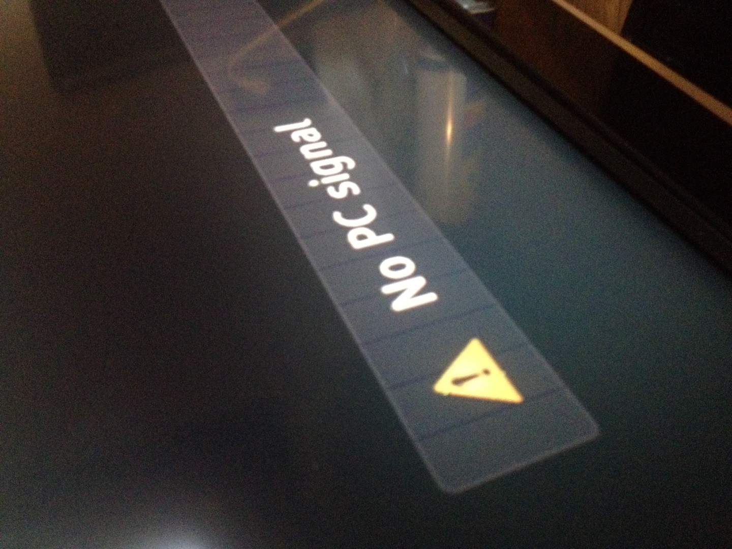

    sony KDL-52XBR5 parralel vertical lines

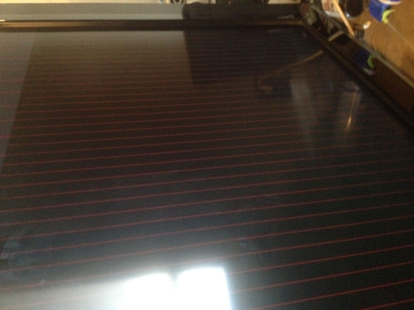

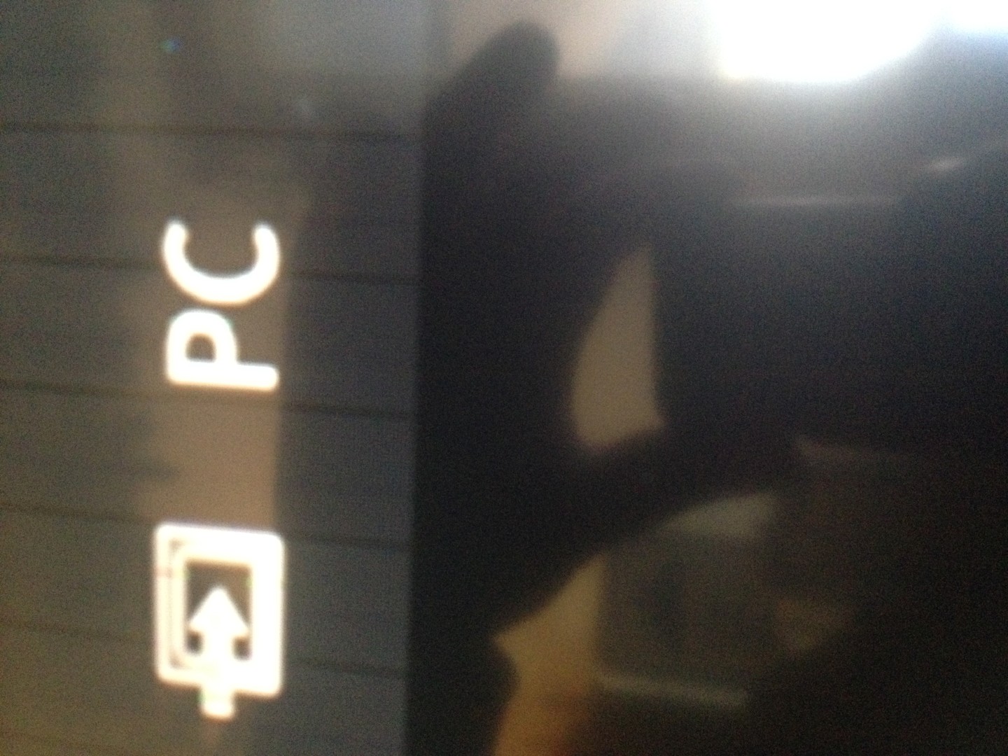

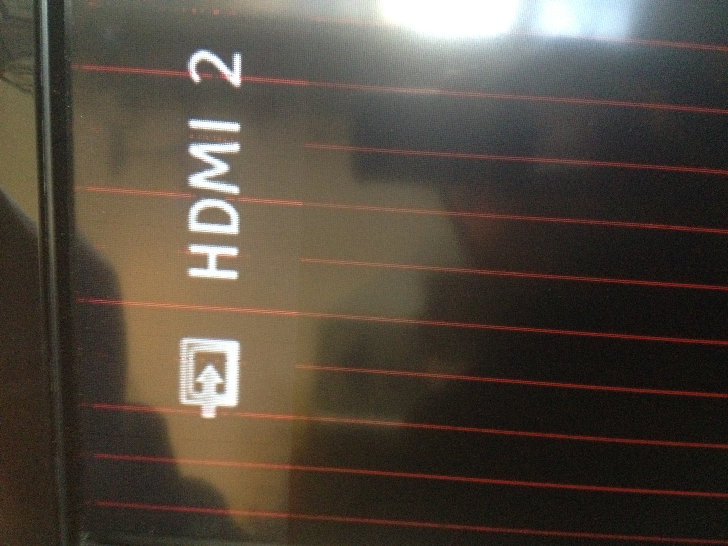

    Past owner said that all of a certain the red lines appeared.
    On all inputs they are red,but on pc input the turn a dark grey.
    Not sensitive to wiggling the lvds cables

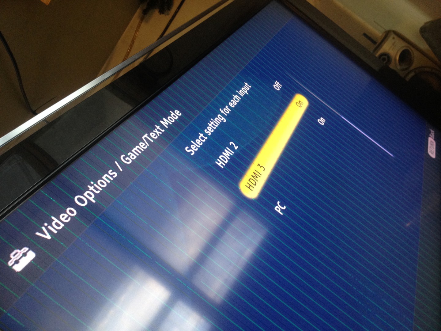

    edit:I put hdmi input on game/text mode " on" ,same as pc input was and now on input hdmi 3 lines are grey also!!!!(pic 5)
    Any idea at first glance?

    Re: sony KDL-52XBR5 parralel vertical lines
    This is most likely the UB1(UB2?) Board between t-con and mainboard, try to replace that board to see..

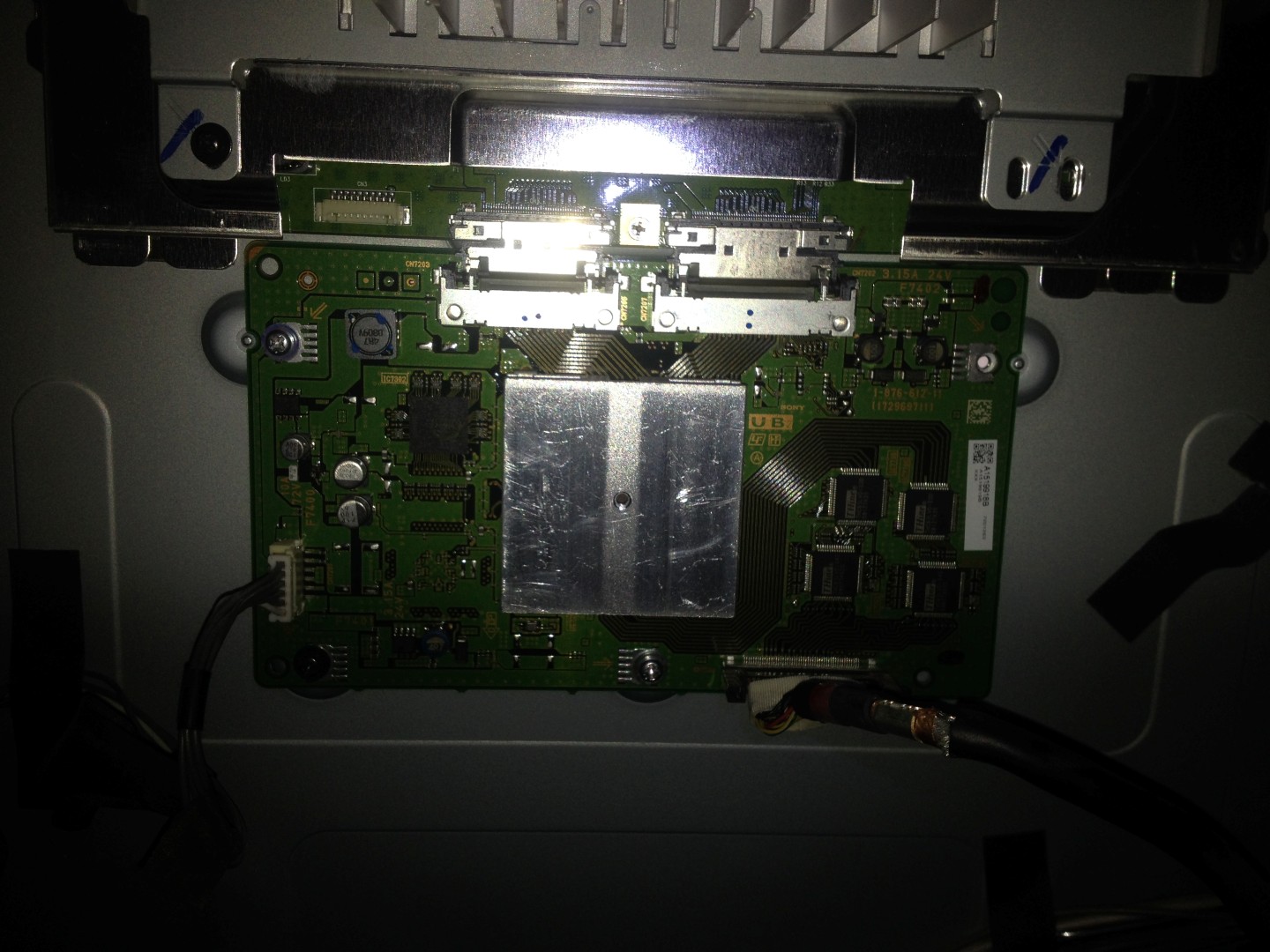

        Can we see the whole back side of the TV so we can see all the boards and how they are connected together.
        He is referring to the FRC (Frame Rate Converter) board which is connected between the T-CON and the Main board.
        Sony A-1257-224-A (1-873-860-11, (172868211)) UB1 Board
        http://www.shopjimmy.com/sony-a-1257...-ub1-board.htm
        You can try re-seating the connectors, heating and cooling the board to see if it has any affect.
        There are bunch of SMD lytics caps on that board.

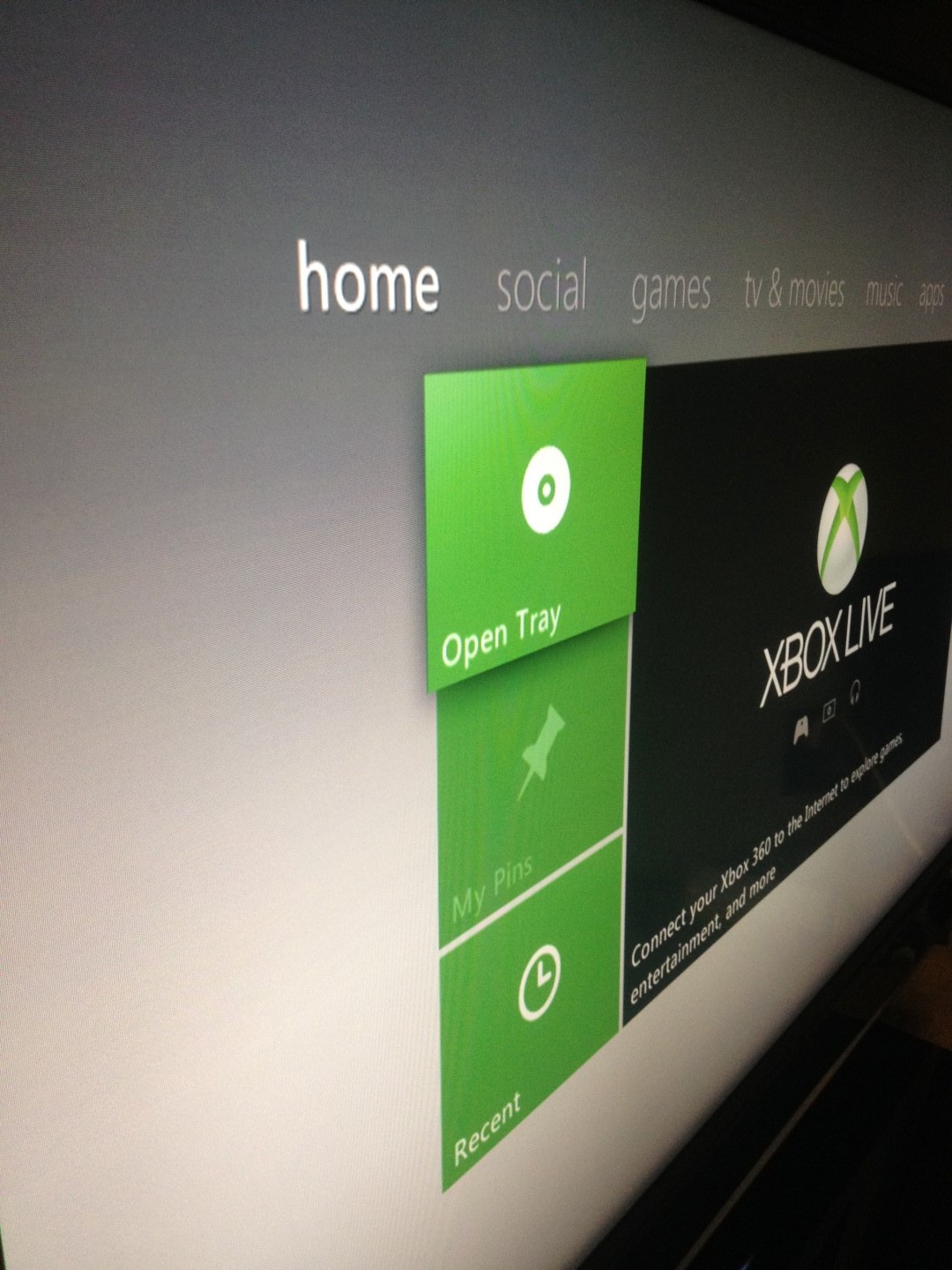

          We have success,took the shield off UB1 board,turned tv on and started cold spraying the little caps etc on the board with no success,till I hit the big BGA chip in the middle=see pic#2,a wonderful a clear picture!
          Till that chip warmed up again,lol
          So I ordered a used board off fleebay,$53 canadian dollars.
          I will try and reflow that chip,but so far I never had reliable luck doing that.
