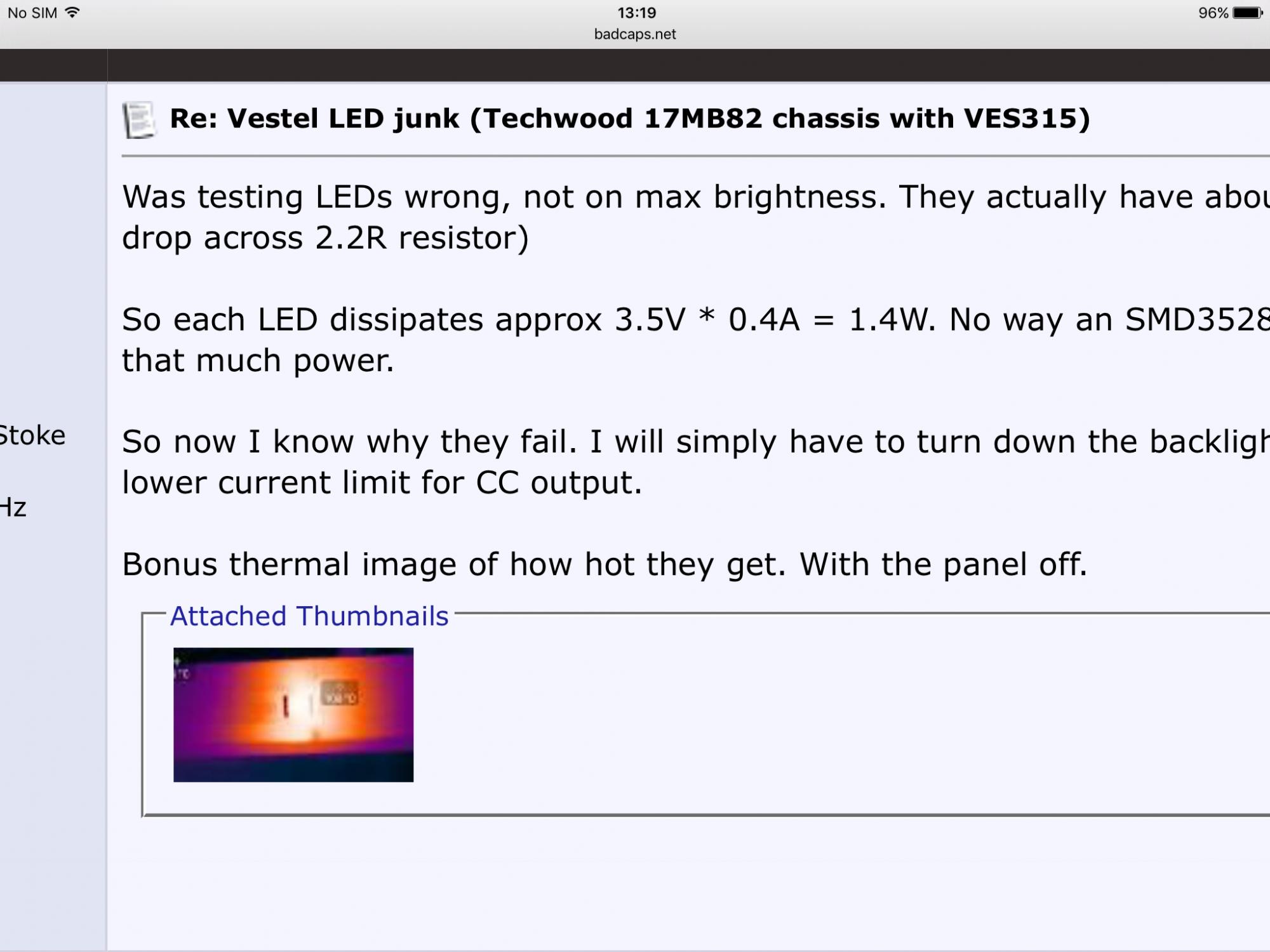

    Hi Reecy
    Great video mate, with or without popcorn!
    I'm just doing this to a couple of sets, Samsung and a Toshiba.
    Did you happen to measure the LED current draw at all?
    I see Shopjimmy is inaccessible from this part of the world too...
    Cheers
    Ian

      Re: How To Repair Led Backlight Strips Video !
      Cheers buddy Tom66 measured the current of each Led in a separate thread, its over 400ma on lowest brightness.
        I dont think that is right 400Ma. most LED string drives have a max of 200Ma for the total string ? If each LED is driven at about 2.6-8 volts you will see about 8-10Ma
          Wait there will get the thread bud.
          • ReeceyBurger123
            Never Give Up !
            • May 2014
            • 7325
            • Britain
            Its 11ma at low buddy which is still pushing them very hard lol I got confused.
              Not with the lower voltage , my testing shows just about the lowest they can be run at Is about 2.8-3.0v this is for one LED, when you get a string you will see up to 200Ma, this is why they need a forward currant of 200Ma but this must not be confused with rated currant consumed by each LED Yes you boy with your hand up sorry I though I was back in the class room
                Flocko sir, please check this for these Vestel Tv's on low Bl:
                  Think you going to need a bigger power supply in that one then. so lets say each string has 18 LEDs x 4 strings so thats 18 x 400Ma X 4 = come on boy work it out ? we and a bigger fuse in the plug and bigger cable
                    No this has 11 leds between two strings which is 22 in total, so thats 30.4w between the two meaning that each Led dissipates what Tom said lol tell me im in the wrong but that is exactly just below what the driver is set to output.
                      No it's pretty simple strip drops about 30V at 400mA so the total power is ~12W per strip. Current is NOT summed up in series circuits.
                      Current drawn from the wall plug is proportional to input voltage and load power. (So this thing using ~30W will pull roughly 30W/230V = 130mA from the wall)
                        Cheers Tom lol as I said. I think Flocko got a bit confused lol
                          I Dont think its me that is confused Reeccey you were telling Telefixer that each LED would draw 400Ma in post 22, I was just putting you right and showing you if that were the case we were going to need a bigger power board ?
                            No that was a mistake lol I meant per strip
                                      The circuit is series configuration so the LEDs don't really draw 400mA, the current is determined by the power supply which passes 400mA through them (constant current circuit.) To do this it increases the voltage until the LED current is around 400mA. I think you are confusing it as if all the LEDs were in parallel, but they are in fact in series and so the total current of one strip is just 400mA, at its nominal rating (~30VDC for example)
