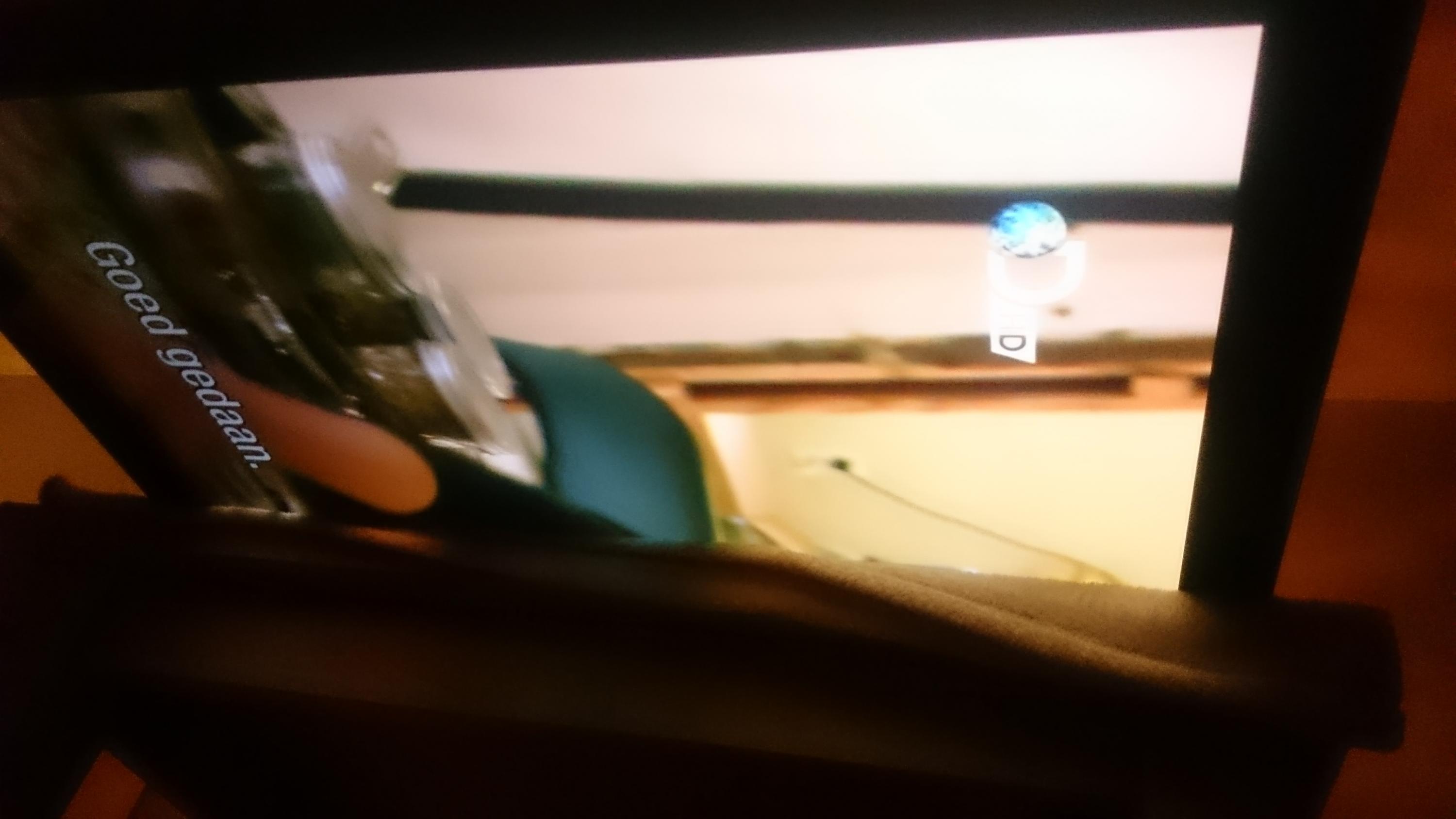

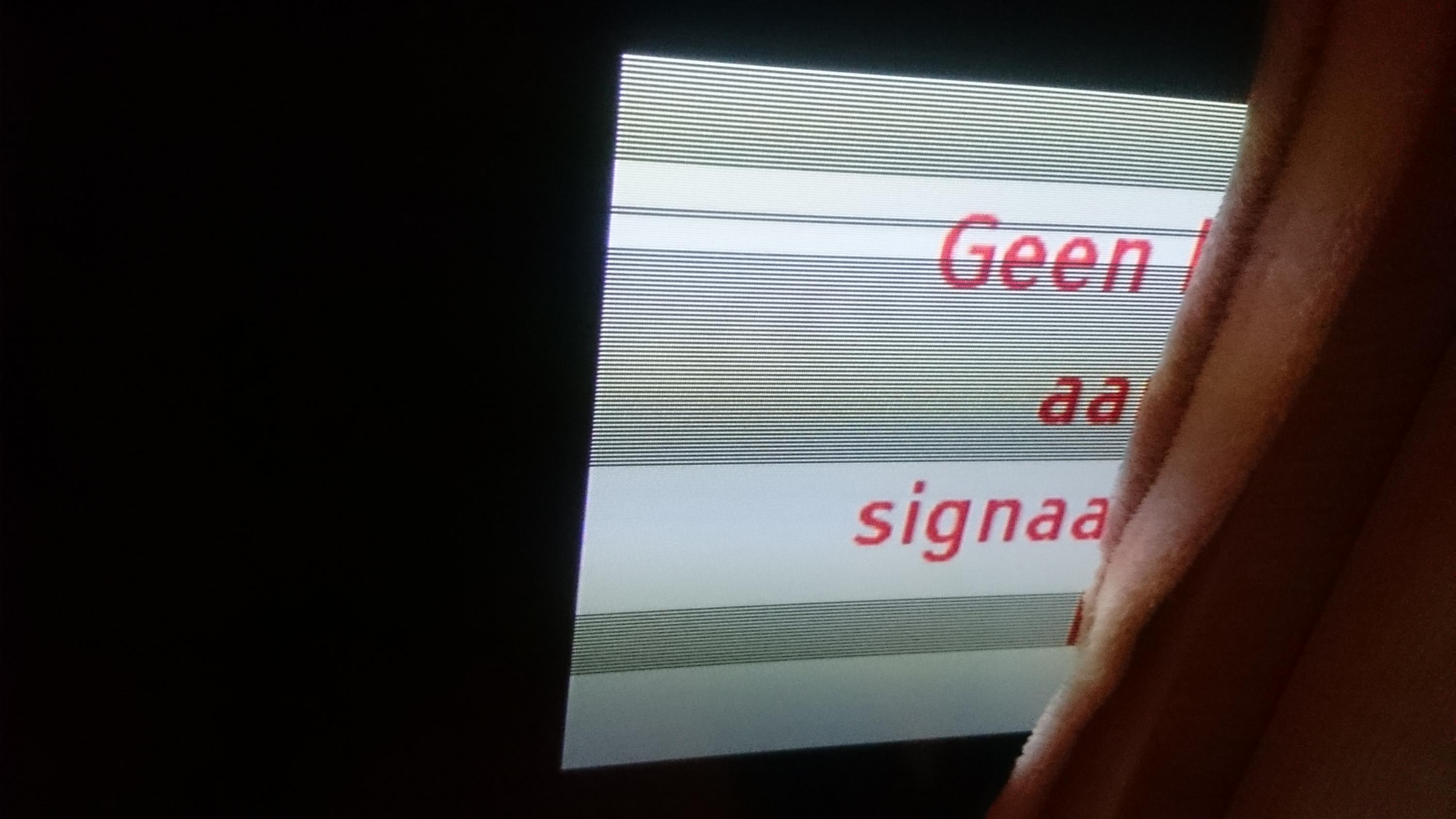

                                  UPDATE!
                                  I placed the tv down on a table and turned it on. Suprisingly it stays on and shows a picture with lines...
                                  Looks like a bad connection somewhere , i might strip the complete tv and find the fault.....
                                    #77
                                    Re: Panasonic 50VT30 , Blinking 7 times.
                                    Lines were bad seated ribbon cables on the buffer boards.

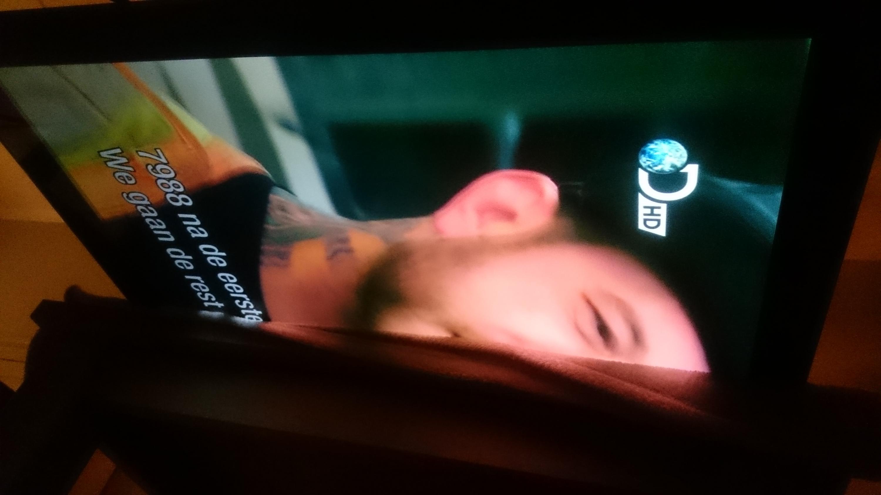

                                    Tv now works but only when its laying on the panel itself. I dont have the foot for the tv.....
                                    I think that the weight of the tv is actually bending a board or something. Tv is so thin that it cant have much pressure i guess??
                                      #78

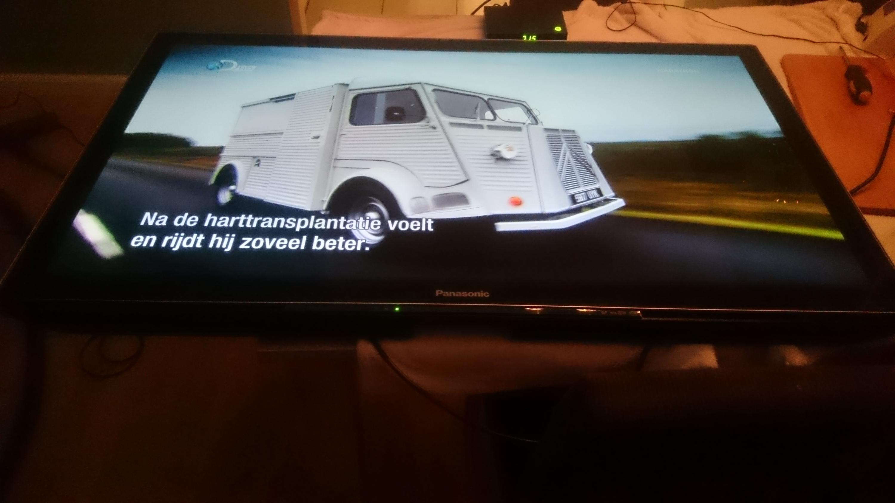

                                      Hmmm working perfectly on its back also! Thank god the panel is ok haha!
                                      Great picture!

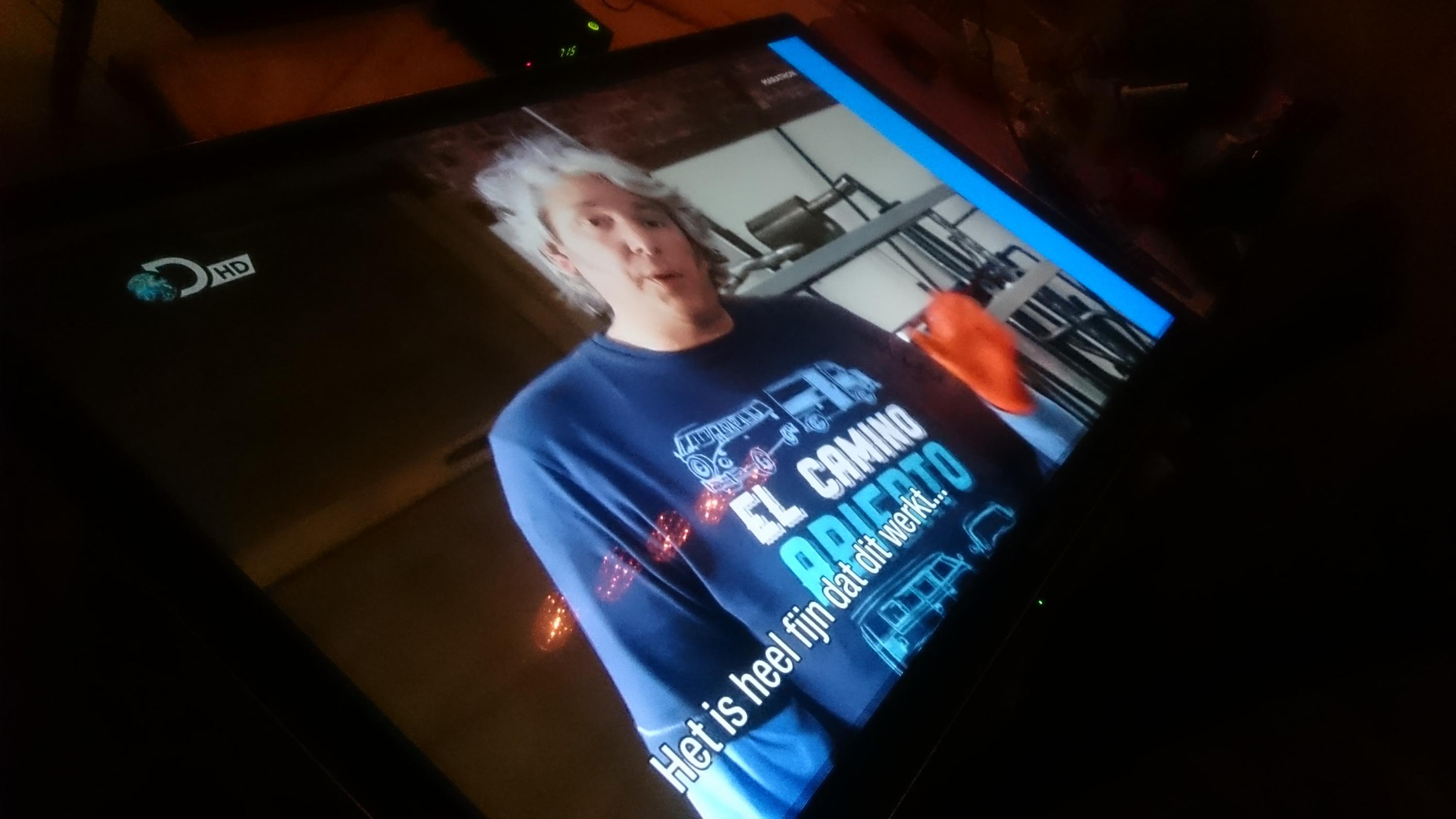

                                        #79
                                        pic#2 "Het is heel fijn that dit werkt".....Ya I bet,haha..
                                        In english it says "Very nice that this is working"

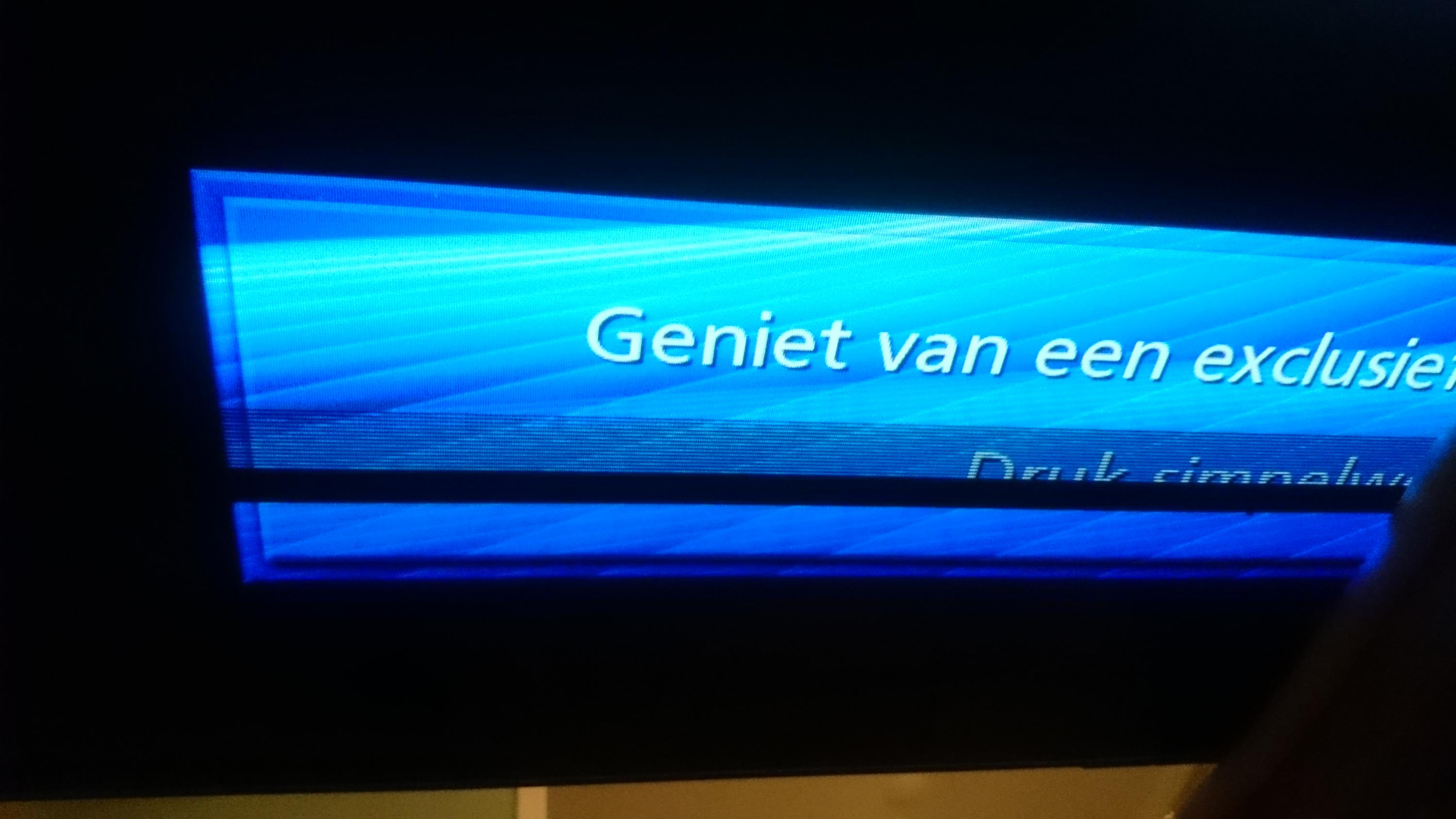

                                          Haha!! Timing or what? He said what i was thinking....
                                          Tv is working fine , turns on and off as it should. Sometimes on white area's i get purple sparkles which come and go so it needs a little fine tuning but thats for tomorrow.....
                                          If i didn't place the tv flat on a table i would still be thinking; "What is wrong with this tv...??? "
