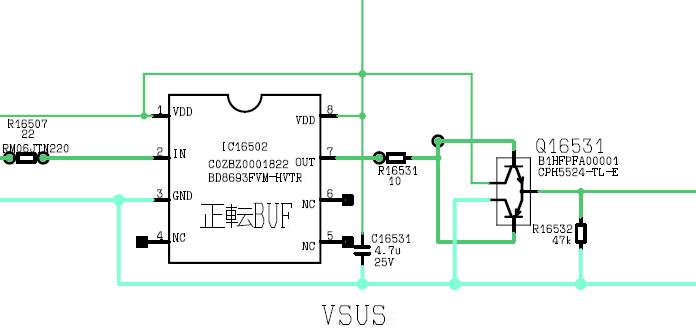

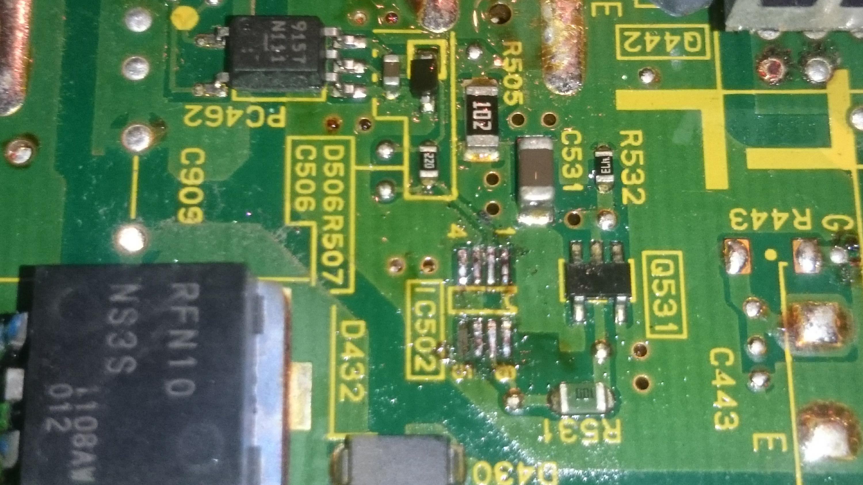

                            Re: Panasonic 50VT30 , Blinking 7 times.
                            Lost a pad when i tried to replace ic502. Is this pad doing anything? If so , where can i jump it to?

                              #34
                              can you get the data sheet for the ic that leg may not be connected.

                                #35
                                I'll search for the data sheet. Any idea's why its blinking 6 times? All IGBT's are ok , no shorts. Im not sure how to test the D401 for example.
                                The IC is BD8693FVM-HVTR

                                  #36
                                  pins 4,5,6 are NC.

                                  • vinceroger69
                                    • Mar 2012
                                    • 6714
                                    • uk
                                    #37
                                    this is a picutre of the ic pins
