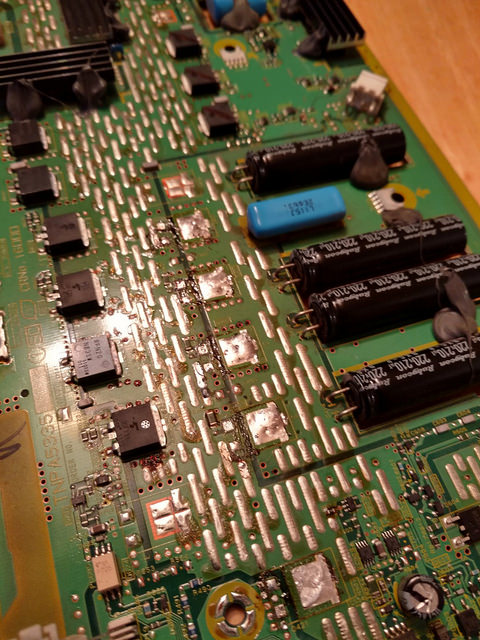

                                  My experience with SC ( seven blinks ) and SS ( eight blinks ) failure indicates a very common repair principle over-looked ! If you ever get to work on one with the obvious symptom of buzzing noise coming from the SC and/or SS boards you will appreciate what I am about to tell you.I just finished a thorough final complete repair on a TC-P55VT50.
                                  I opened to find very loose screws on SC and one or two loose on SS. Panasonic has said replace with new ( Part # XYN3+F6FJ-18PK ) [ NO LONGER AVAILABLE ]!!
                                  I had one package left so I want this repair solid and no recall down the line.
                                  Do not attempt this repair by simply tightening the original screws !! Practice Visual
                                  Acuity and closely examine the ground surfaces on each screw removed. You will find black evidence of bad ground connects on the top and bottom of each ! Clean ( I scrape with razor blade ) ALL ground contact points even where board sits on chassis pan. Do not use original screws ! They are cheap junk ! Next, take the time to properly solder all the legs of every FET that look suspect on SC and SS ! Thankfully,my good customer brought his in with the " buzzes" symptom before it crashed hard doing harm as we all have seen ! One recent customer telling me he heard buzzing some days before the "loud bang" ! So, please address what starts many catastrophic failures = bad ground connects !! My repair is on test run with speakers off and is totally quiet !
                                  A final side note = I use the exact part Panasonic installed unless an upgrade is used as a sub recommended by the manufacturer or a qualified senior technician.

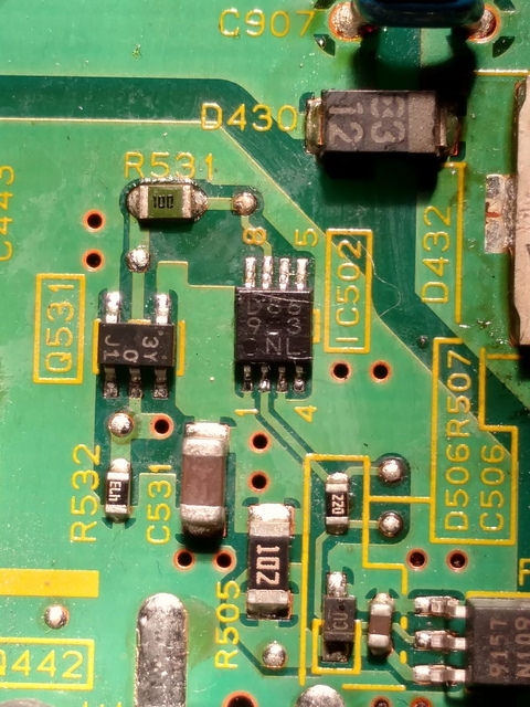

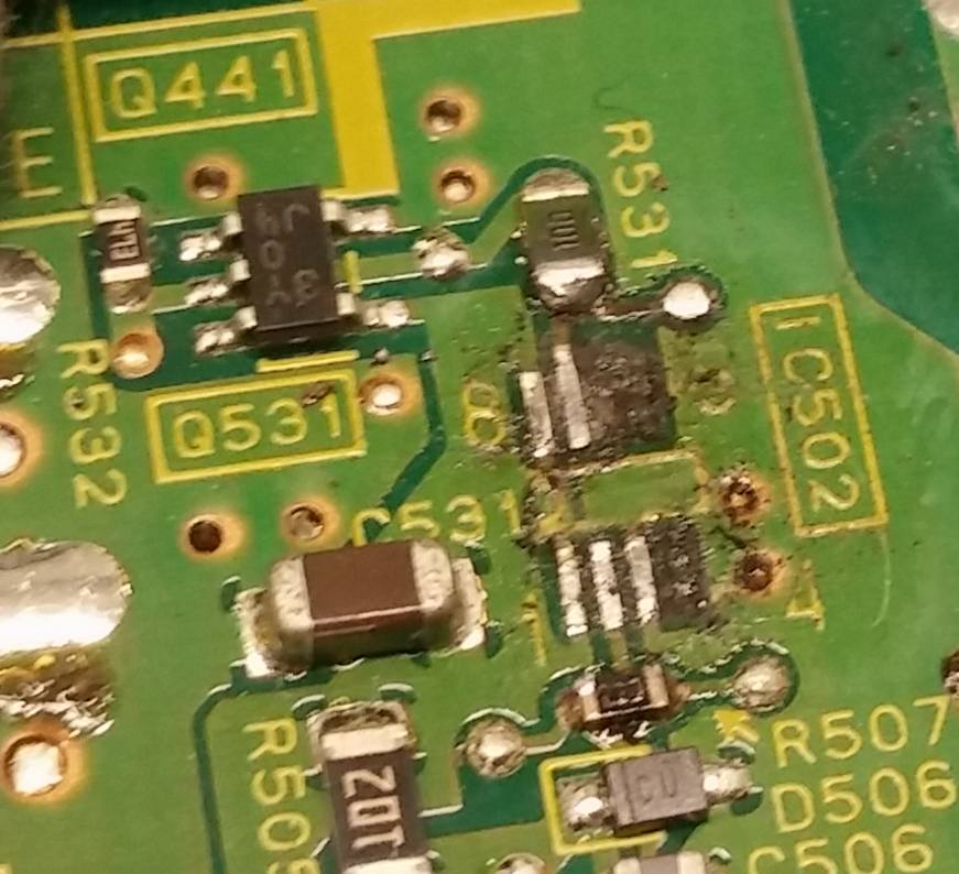

                                        I frustrated myself by the hack method I removed IC502 (BD8693FVM) on my TNPA5330 board (Panasonic 42" VT30 from April 2011).
                                        I have the symptoms of the blown fuse on the TNPA5390 (and transistors q300 and q301) caused by the shorting of components in TNPA5330.
                                        Soldering on both sides of ic502 and sliding it off... and you can guess what happened. Some of the pads came off.
                                        Luckily, there was a service manual posted for a GT30 model, showing the connections for IC502, and luckily the pads that pulled off are pins 4, 5, 6 - all NC.
                                        pic, still need to clean up the board, and solder in the new part(s).
