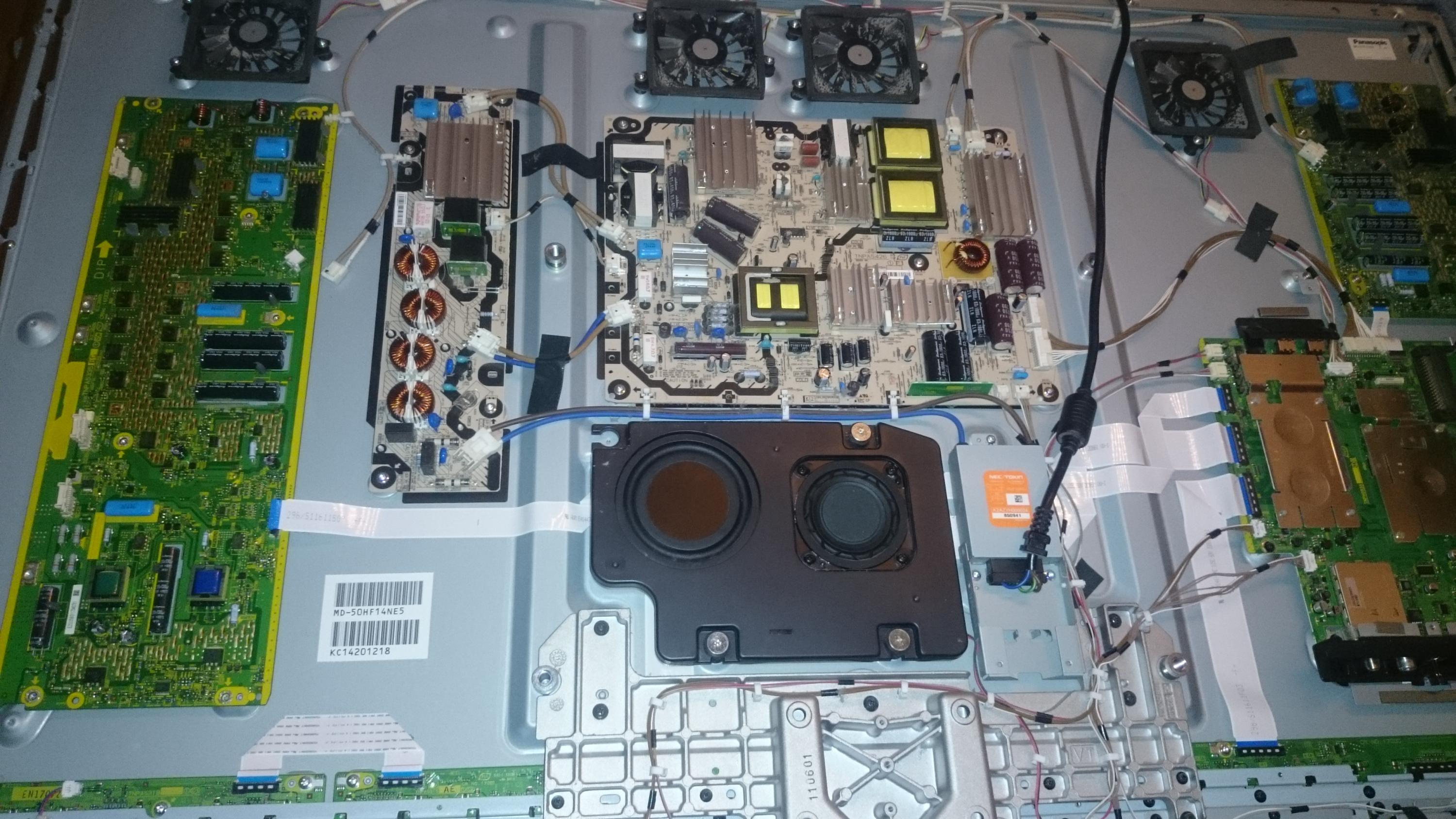

    Hey guys ,
    Going to pick this 50VT30 up tonight and see if i can fix it. I still have my VT50 so this one is for sale.
    Set is blinking 7 times which means the SC/SS boards. I want to do the repair myself so im searching for a reliable repair set.
    Can someone recommend me a good repair set for this tv? I heard that some repair sets are cheap chinese brands so i want to avoid those.
    Can i be lucky that i only need to tighten the screws?
    Thanks.
    ps , will post pictures when i got the tv!

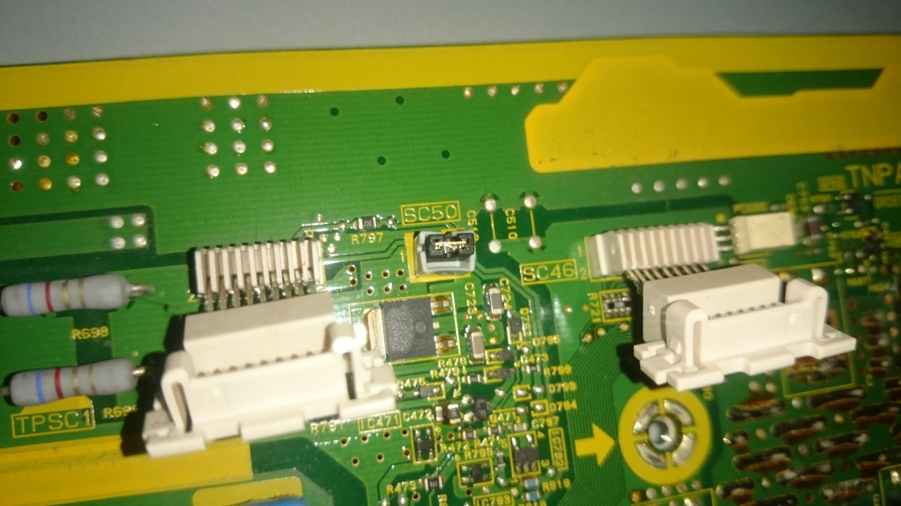

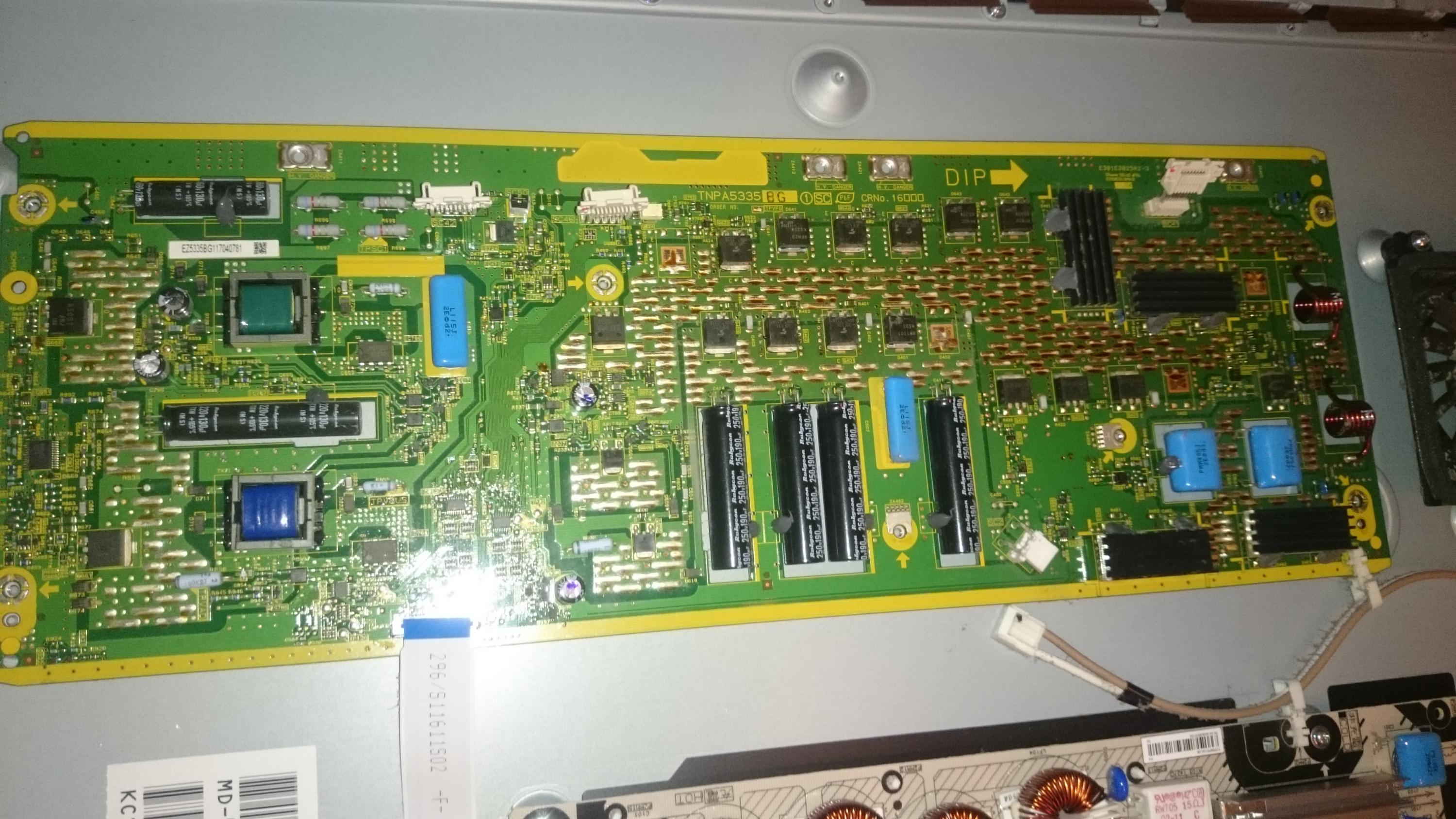

          Isolated the buffer boards and used the SC50 jumper. Still 7 blinks. Removed the SC20 cable and i get 8 blinks.
          Checked the bufferboards for shorts but they are ok! Lucky me.
          So my SC board , TNPA5335 , has a short somewhere. Need to wait for the parts to come in...

            Btw , screws on the SC board were loose! Buying a new board in the netherlands will cost me 200 euro haha. I'll wait a week or 2 and repair it myself

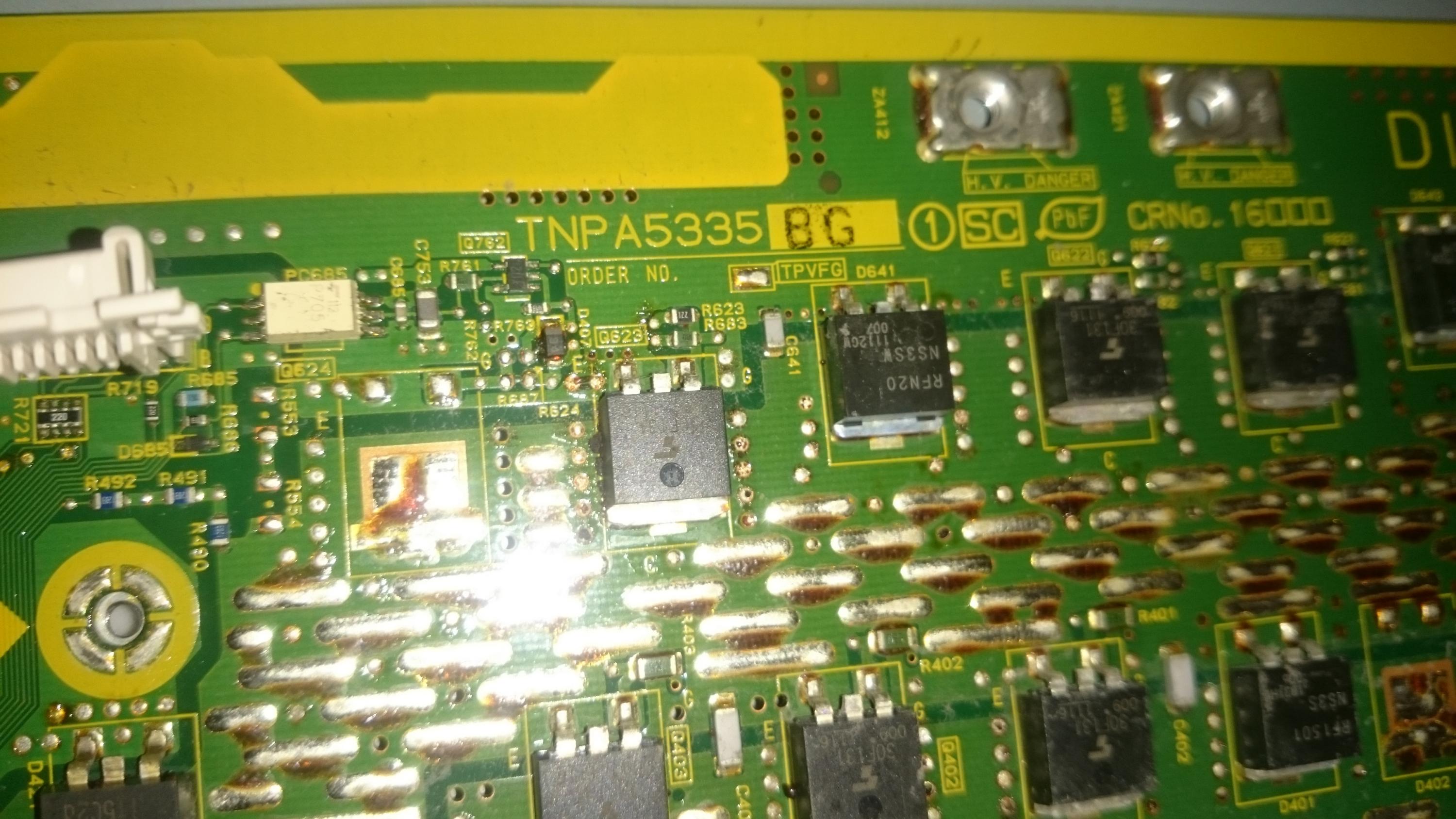

                  Bought a repair set from a UK seller. Replaced all IGBT's that came with the repair set and i tested it with SC50 jumper. Tv went out with a bang. I think D401 gave a bang and flash.....
                  Not sure if its my soldering that caused this!

                    I must be lucky then. Just did two 5335 boards today, rather boring affair, no smoke no noise just a good picture.
                    Was it 1 you replaced? So far I've gotten away with no diodes replaced on 3 5335 boards and a 5351

                                Removing them is easy , i had no trouble with that. Im having trouble soldering the new ones. Do you also use a heatgun for that?
                                Yes i ordered a repair set and a bulk. Could you please tell me how to measure the new IGBT's so i cant go wrong? I can look on youtube but you have repaired so many boards and you know what your doing. This is my very first SC board repair.

                                      I see. seems strange you have trouble in the reverse. If you can get enough heat to get it off then the reverse should be the same.
                                      So today was the first time I tried the hot air otherwise i would have done it without.
                                      I blew the hot air onto the legs and at the same time having tinned the back of the transistor, placed flux on the board and then tinned the iron tip flowing solder so it touches the board and the metal tab.
                                      When it reached temp the solder actually wicked under the transistor. If you're having trouble try tinning the tab on top and glide the iron tip back and forth to distribute the heat.
                                      practice will improve things, I'm just getting the knack myself.
                                      As far as knowing what I'm doing, probably 50% true, 50% luck and take a gamble from time to time.
                                      What I'm interested in is what was short in the beginning?
                                      Why? Because the kit contents is somewhat interesting due to no RJP30H2 IGBTs.
                                      Were there instructions or location numbers given?
                                      If I look at the 3 boards I've faced. Two have simply had 3 x 30f131 and 3 x RJP30H2.
                                      the board that had the blown RJP63G4 had 3 x 30F131 shorted which I believe failed first taking out Q661. They're not the same bank of 3 30F131 that go when the RJP30H2 are shorted.
                                      So if you simply located all the 30F131 replacing 6 but did not check the RJP30H2 then this maybe what went wrong? We all have a blowout but always nice to go back over and analyse it to learn.
                                      So my curiosity is, did you just get the kit and throw it in or how did you determine it was the right kit?
                                      Any chance the RJP30H2 IGBTs were overlooked?
                                      IGBTs normally just go dead short on failure so finding them is usually pretty easy .
                                      I do have a 5335 spare out of the TV if you have some points you'd like to compare.
