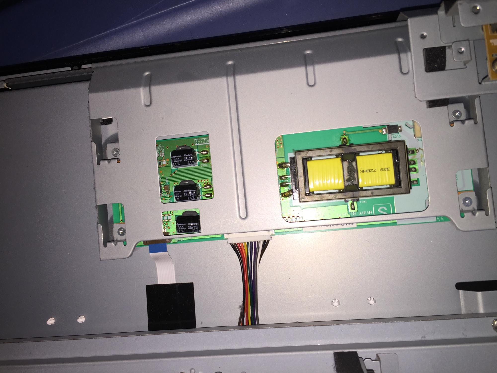

    Hello as the title says I have a Toshiba 37av500u where the screen is flickering and what I mean is the screen lights up dimly and goes off in a one second interval and continuous until you unplug the power cord.
    The power button will not stop the flickering or blinking whatever you want to call it.i took the back panel off and did a visual inspection no bulging or blown caps.also can see the backlight going on and off.
    I have not checked anything yet with the multi meter,I have searched and seen maybe the master or slave inverter may cause this issue but figured I would ask for help here before proceeding on any testing.

    Re: Toshiba 37av500u screen flickering
    Another pic

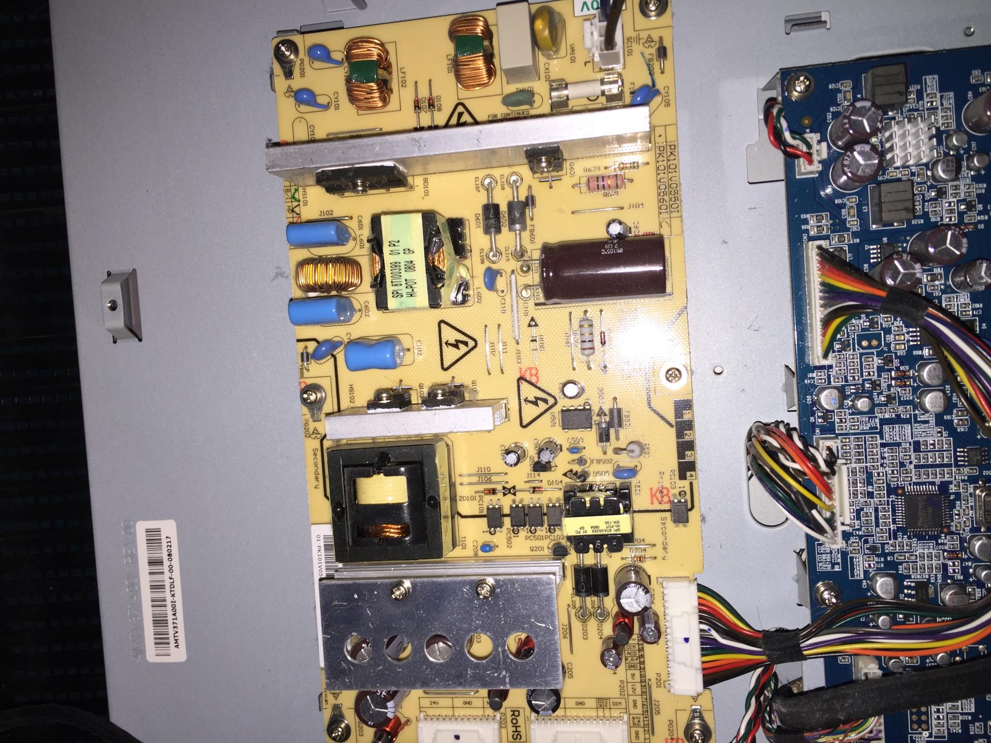

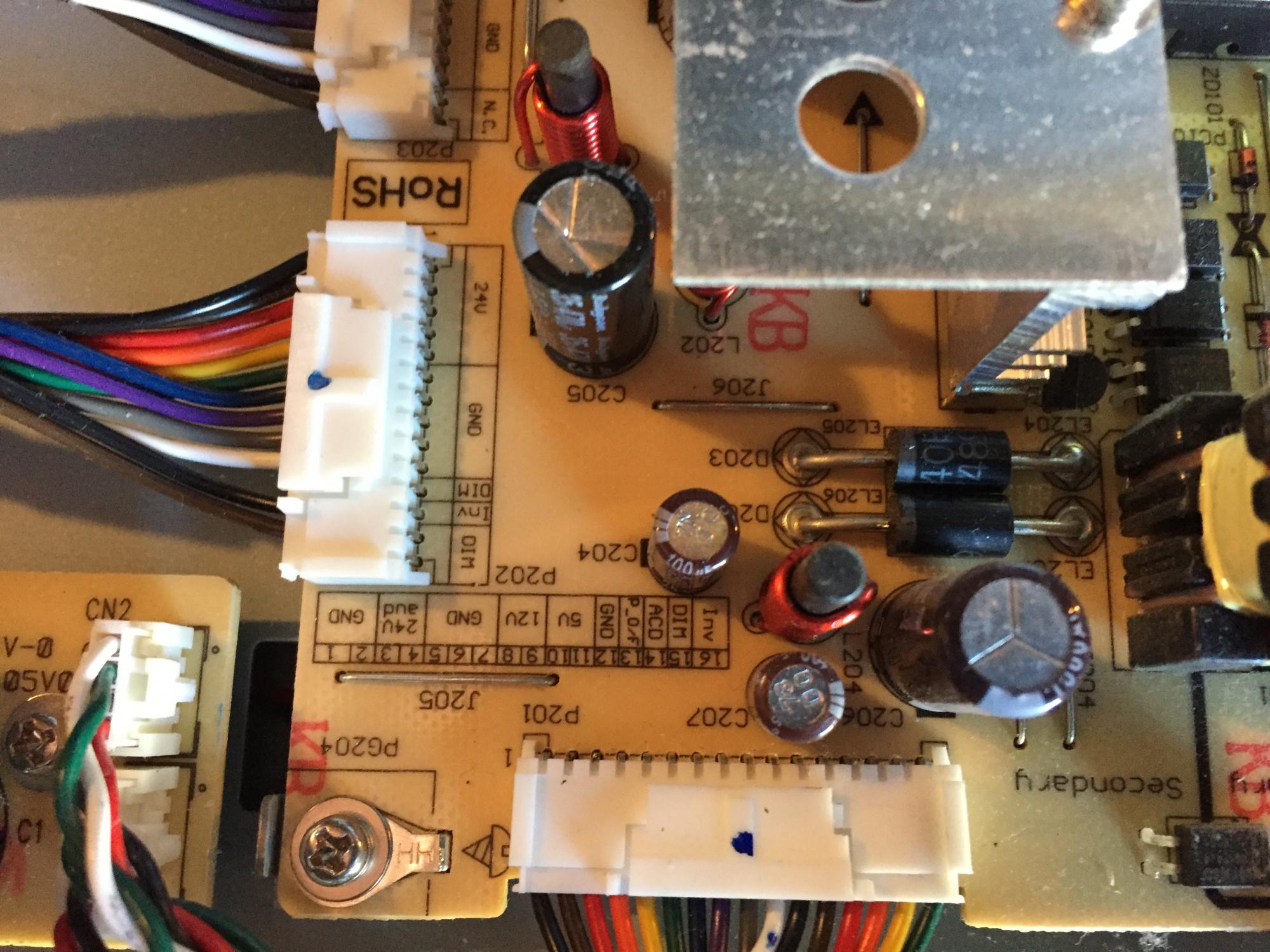

            Just to update I took a close look at power supply and tested all the 24v 12v & 5v pins on the board.the readings were very close or right on the money.such as all the 24v readings were 23.96 & 5v pins were 5.03 on my meter.
            So would it be safe to assume the problems lies within the master or slave inverter boards?
            If so is there any way to test them?
            Thanks for any help or suggestions as I would greatly appreciate them.
            I will include a couple pics of the power supply.
              Here's a pic of the power supply
                Another close up of power supply
