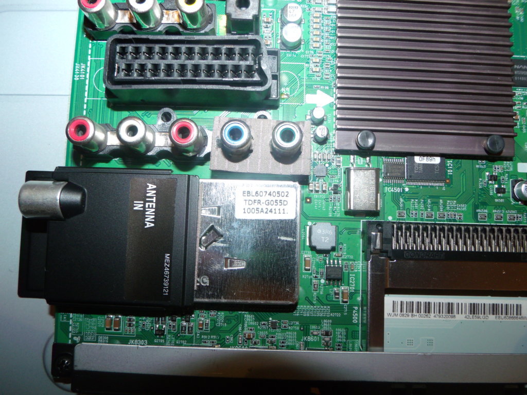

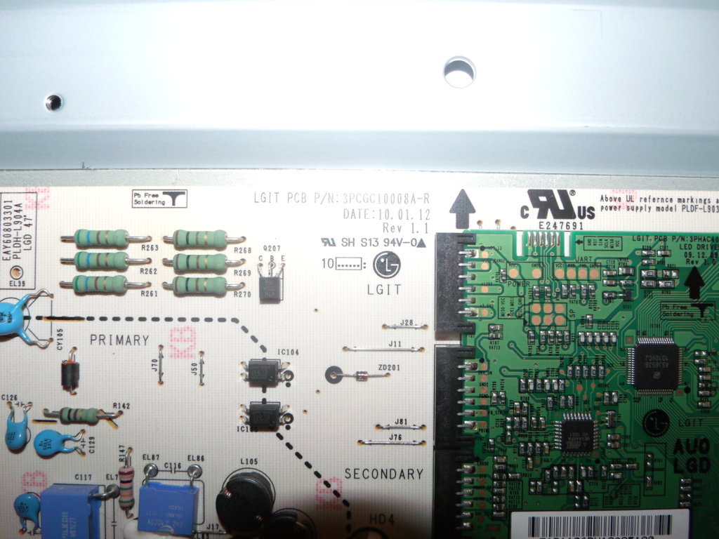

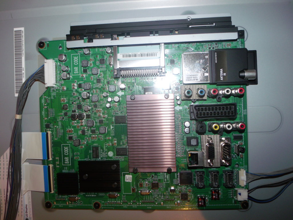

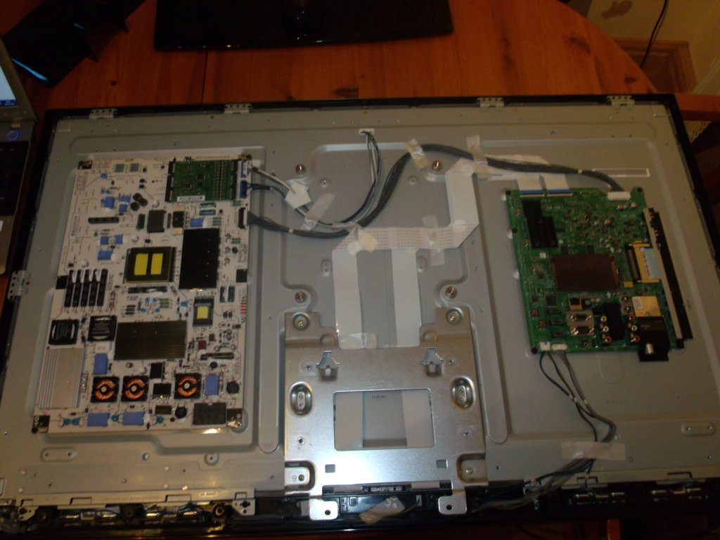

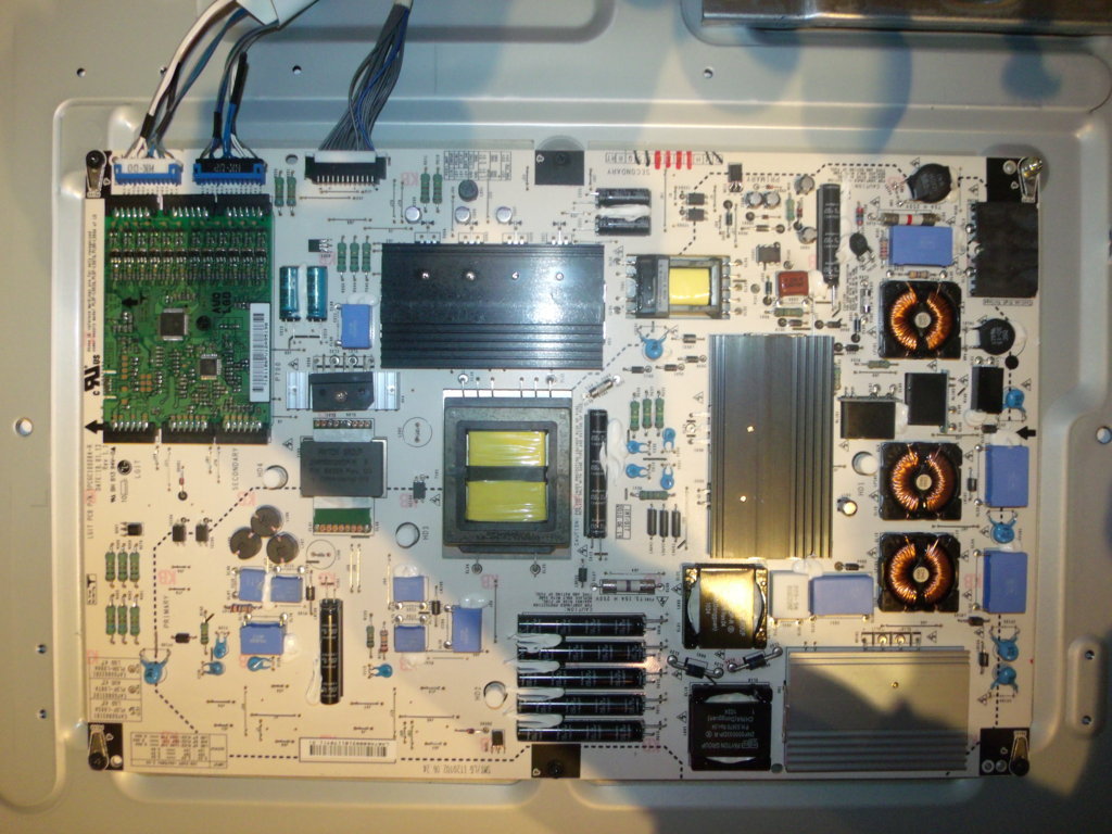

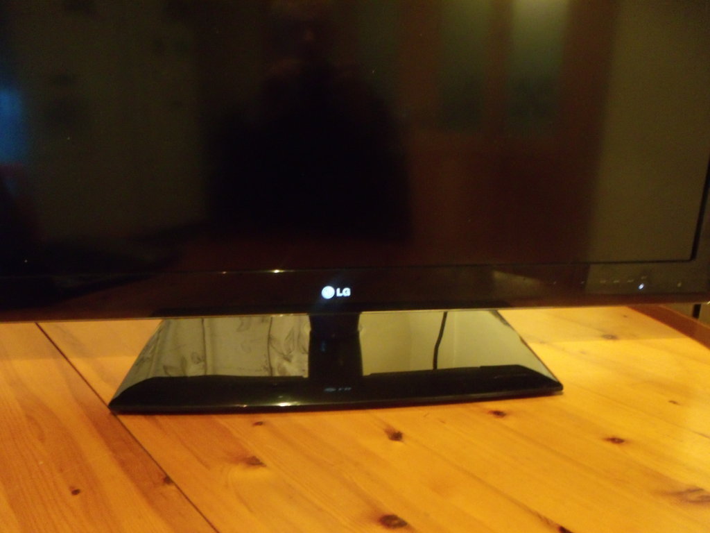

    Hi there I had a look for any other posts relating to this and couldn't find any so I thought I'd start one. I'm having an issue with the above LG it will turn on ok and do its fancy light show across the bezel but I get nothing on the screen, I can see its responding to the signals from the remote as the power light flashes, I get the same plus an audible when the buttons are pressed on the set. I've had a look at the boards visualy and all apear ok (I've added some pic's) has anybody got any experience with this isssue/set? Thanks in advance bad cappers :-)00

    That looks just like mine which I had just tinkered with.
    Dont wanna say 'fixed' but nicholas1110 said his problem was the main bga processor and mmartell suggested to heat it up, which I did and it worked.
    Just used a regular hair blow dryer.
    Using it as a monitor to type this right now.
    • 24mech
      Badcaps Baby
      • Feb 2014
      • 103
      • United Kingdom
      Re: LG 42LE59000 no picture or sound turns on ok
      So are we saying a reflow will (possably) fix this and if so does anybody know the temps I should be looking for? do you reflow all boards at the same temp? I would have though you would as solder is solder isn't it?

        Don't reflow anything.
        Firstly are the backlights on?
        • 24mech
          Badcaps Baby
          • Feb 2014
          • 103
          • United Kingdom
          nothing is coming on that I can see, I've read on another post that you can force it on for diag but I haven't done this (not sure how to) as I don't want to full kill it.
          • Hamie
            • Apr 2014
            • 1383
            Can you remove the wire thats labelled B-dim or P-dim something like that from the harness.
            Just remove that one wire.
