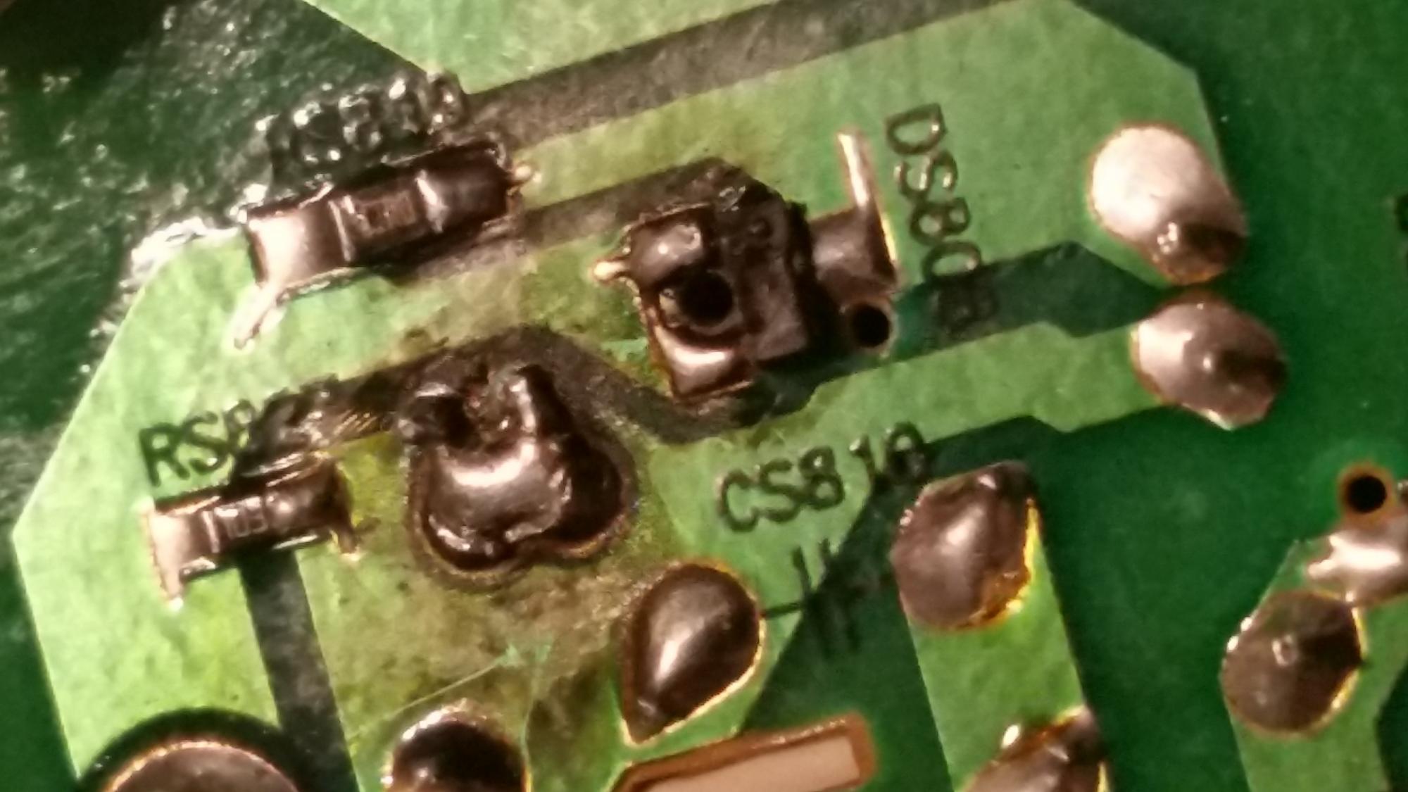

    Hi all I'm new to this I have a pn60e6500 Samsung tv about a year ago the power board failed so I found one online I ordered it and installed price was not too bad i installed it and was all good until today I opened it up and same spot was burnt the plastic piece screwed to aluminium bar ( correct me if my terms ar incorrect but I believe shotky diode attached to heat sink ) has one lead melted off and on the reverse side of the board there is a chip ( again correct me if I'm wrong a ic ) the location is labeled ds808 my question is you can get a kit to replace all but that ic chip how do I get my hands on one and is there any issues I should think about with trying to replace I'm not about to spend another 400 dollars to replace board and I would like to try and fix myself electronics repair interests me any help would be great thanks to all Jay

      Hi did you manage to fix the issue with this supply board? I have the same tv (EU model) that has PSU problem, tried repairing it twice in repair shop but after 10 days or so the board shorts out.

        Obvioulsy, the problem is not on the power supply board, but on another board which is drawing too much current. Schematic.

          I have not repaired yet I have been to busy was just looking for parts and found my question and your questions would be great if anyone had any input on it

            Bad solder joints blows switching transistor and controller, might be best to replace the psu again and resolder ALL devices mounted on a heatsink for reliability.
