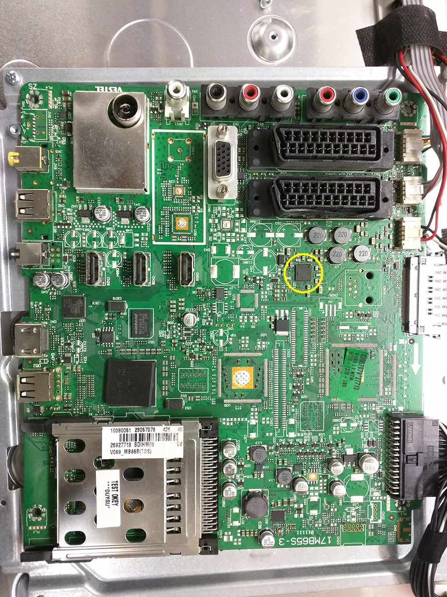

    Toshiba 17mb65s-s
    Typo: 17MB65S-3

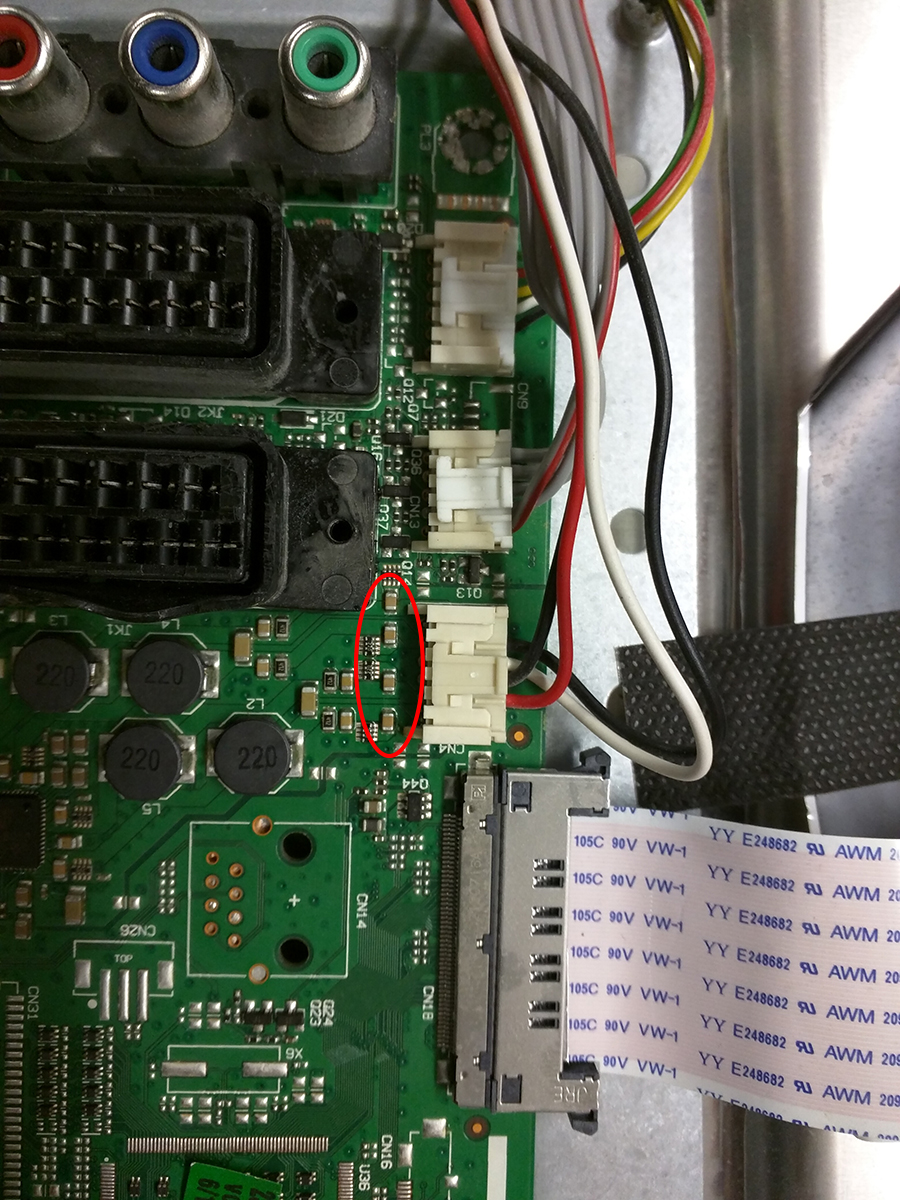

    TV works great but no sound from speakers. Sound does come from the audio jack so no need to replace the audio IC. Done some research on this issue and the next issue can be those ceramic caps. Can someone tell me their values or provide a schematic?
    See red:
    Yellow for audio ic:

    Look for the obvious. See if the caps you circled are shorted, check with an oscilloscope where you lose the audio. Maybe the headphone jack is bad etc.
      Thanks but headphone jack is ok. Two caps are 100% shorted.

        Looks like an RC snubber, and since each channel is the same frequency then they're likely to all be the same value. A multimeter may be able to measure them.

                    Re: Toshiba 17mb65s-s
                    Originally posted by speedypro
                    What is that?
                    It removes higher frequency components in the output signal from the class-D amp by shunting them to ground via a resistor. Energy is dissipated in that resistor.
                      I think you are see the DCR of the speakers, remove the speakers connector and check again.
                      What id the P/N of that class D chip? The headphone output is probably driven by small OPAMPS.

                        Correct the Amp for the ear phone ports in integrated in the main Cpu but the amp is driven separately as you know. However the firmware on these always seems to mess up and the Tv no longer runs the main speaker amp a simple reset should fix it in my case anyway.
