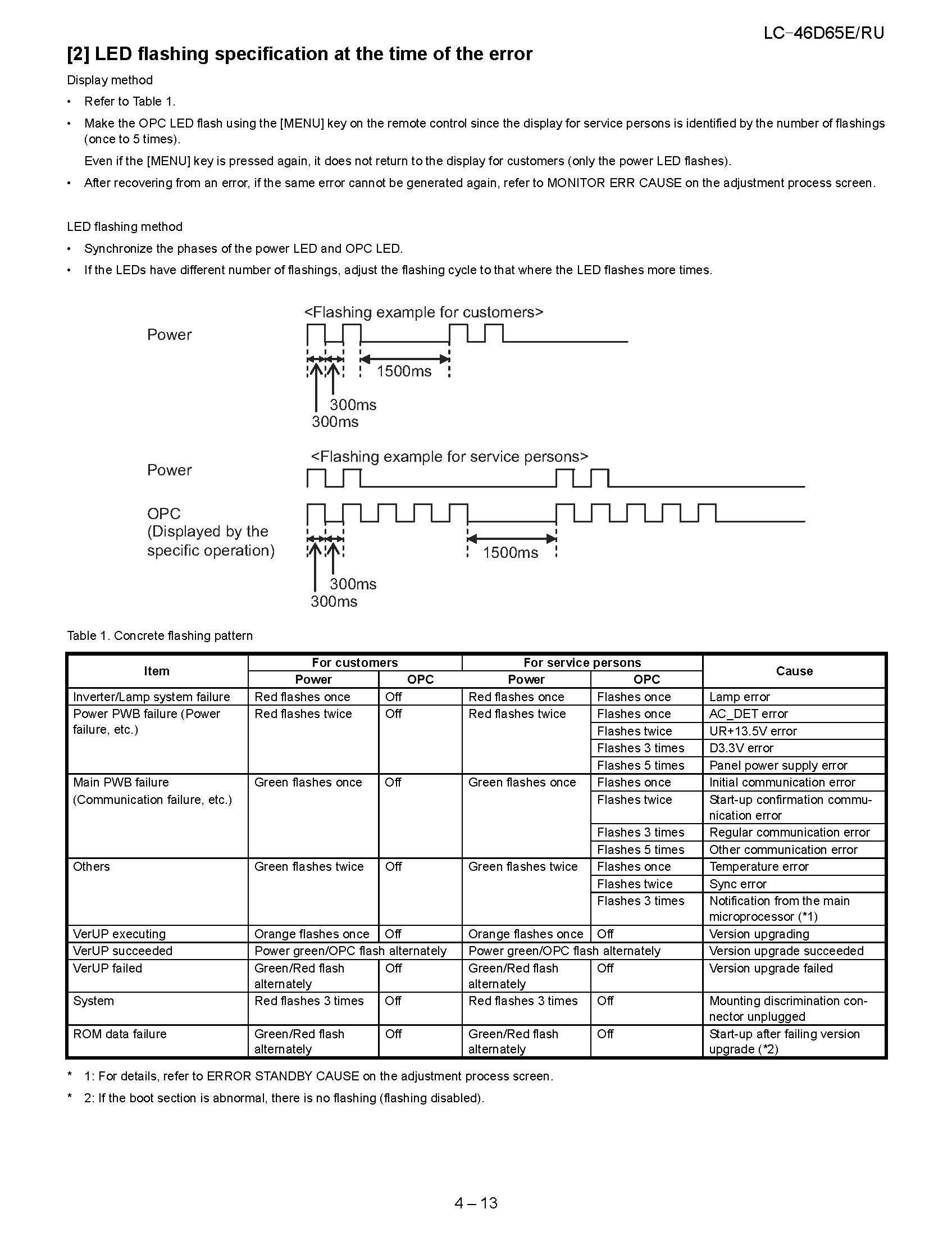

        TV will not turn on. Getting flash codes of power 2 flashes / opc 1 flashes per second. When i press the power button then it changes to power 1 flash per second. I have done the resetting and such and it does not allow the tv to turn on. Im thinking the issue is with the power board but i could be wrong. Not allot of info out the especially on this Model #.

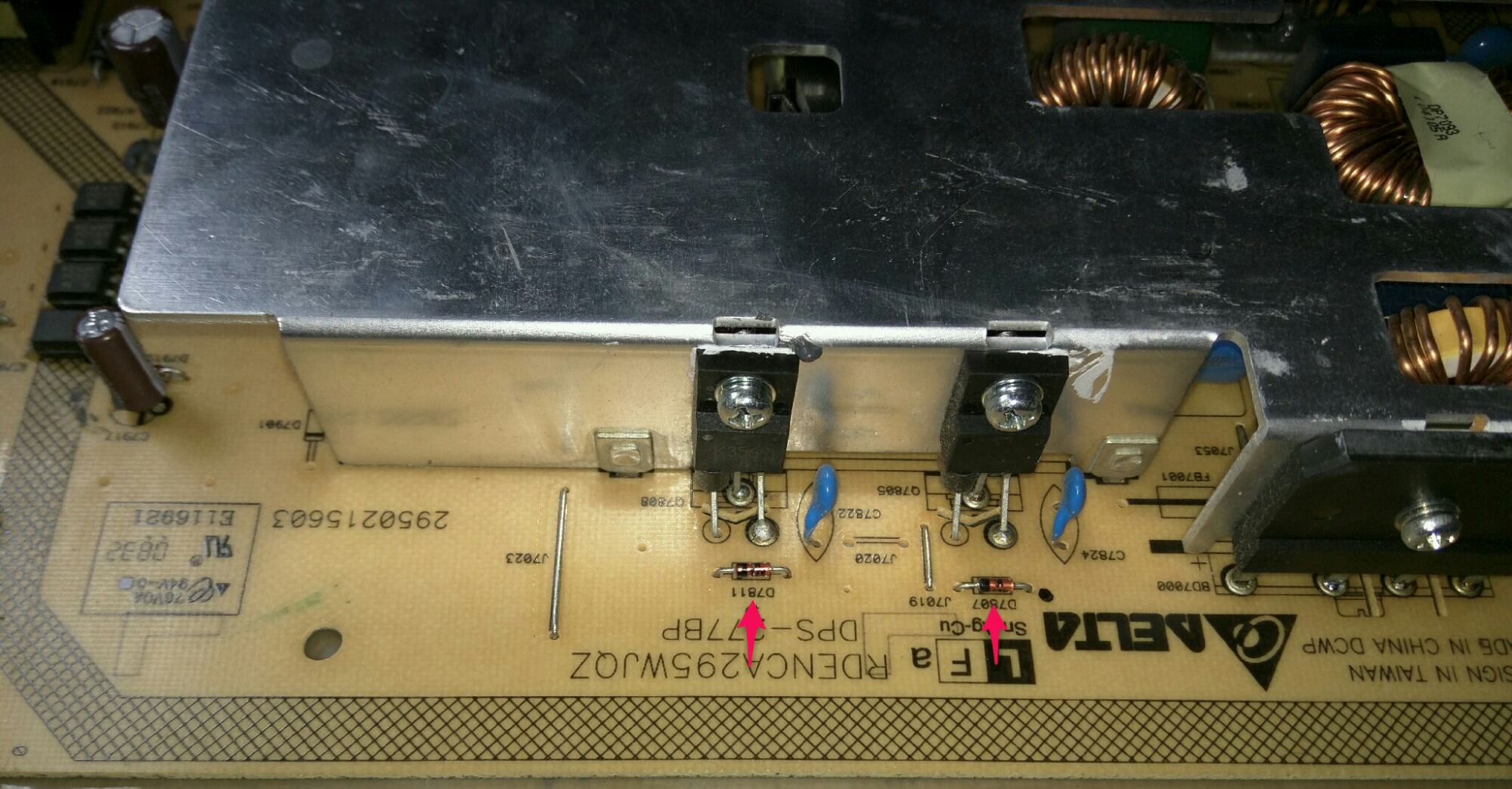

          I have come across at least two bad diodes on my hunt to find the problem with my power board. I've tested for power when the board is connected to the TV and I'm not getting the 13v needed on the pd1 connector. I have uploaded the images of the front and back of the board. I also included a image of the diodes that are bad. Maybe you all can help me figure out what else I need to be looking at. I'm guessing the 2 mosfits k3569 next to the diodes are probably something I need to check as well. Thank for any help given. I will be working on now and then during the weekend so don't get frustrated if I don't respond right away.

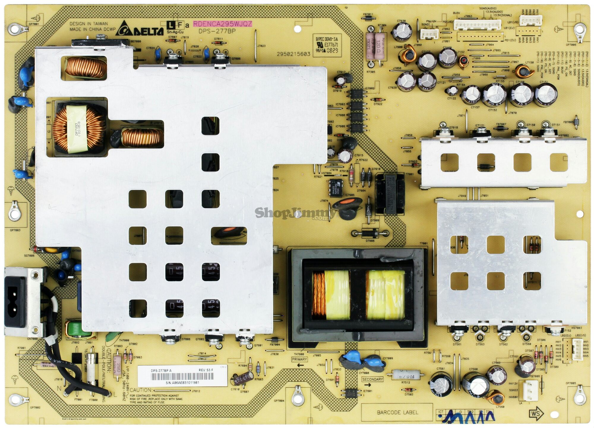

            'Getting flash codes of power 2 flashes / opc 1 flashes per second' Per error codes listing (from LC-46D65E/RU may use the same error code, i will find out once I get the DCV readings of the PD connector): AC_DET ERROR.
            Power supply board is made by DELTA electronics: DPS-277BPA
            http://www.shopjimmy.com/sharp-rdenc...upply-unit.htm

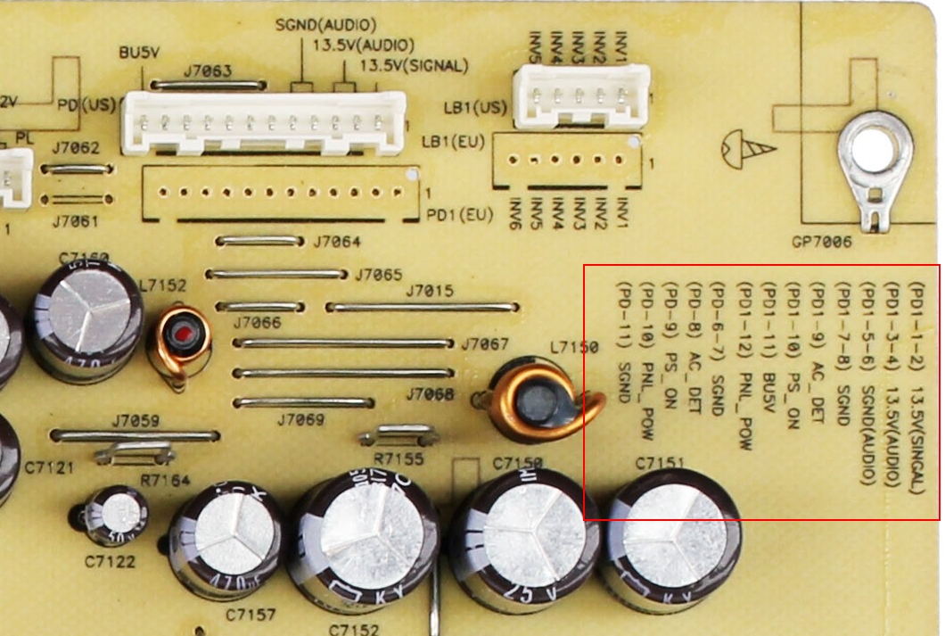

            I need the DCV readings of all the conncetor PD pins (except the GND pin).

              Here are the measurements I got. I included all connections.

                  OK, are those readings are done with the power switched activated and the Error lights are blinking?
                  PD connector readings per you chart with my format:
                  Pin 1: 13.5V (SIGNAL) = 2v
                  Pin 2, 3: 13.5V (AUDIO) = 2.1V
                  Pin 4, 5: SGND (AUDIO) = 0V
                  Pin 6, 7: SGND = 0V
                  PIN 8: AC_DET = 2.9V
                  Pin 9: PS_ON = 0V
                  Pin 10: PNL_POW = 0V When this one is present then you will get 12V at PL connector pin 1, 2 (PNL_12V).
                  Pin 11: SGND = 0V
                  Pin 12: BU5V = 4.94V
                  There is no PS-ON signal to turn on the power supply.

                      We need to find out if that PS-ON at least goes high before the error occur then we can then try to find what the cause of the error is.
                      Your error code per my PDF indicate AC_DET error but it is not the case here because you do have 2.9VDC at AC_DET (0V = trouble) so the chart is not correct if that is you are seeing.

                        I do have a pin that is 2.9v so maybe i'm reading the pin description layout wrong. some of it says pd and the other says pd1 and has like 1-2,3-4. scratching my head trying to figure it out.

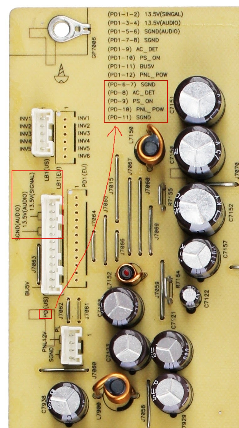

                          Re: Sharp aquos lc-46d85u Service manual with schematics
                          How to read pin out of PD (US) connector:
                          PD (US) pin 1~5 are labled right next to the connector PD (US)
                          Pin 6~11 are on the chart.
                          They match what I put in post 9 and filled with readings you provided.
                          PD1 (EU) connector for European countries is not installed.

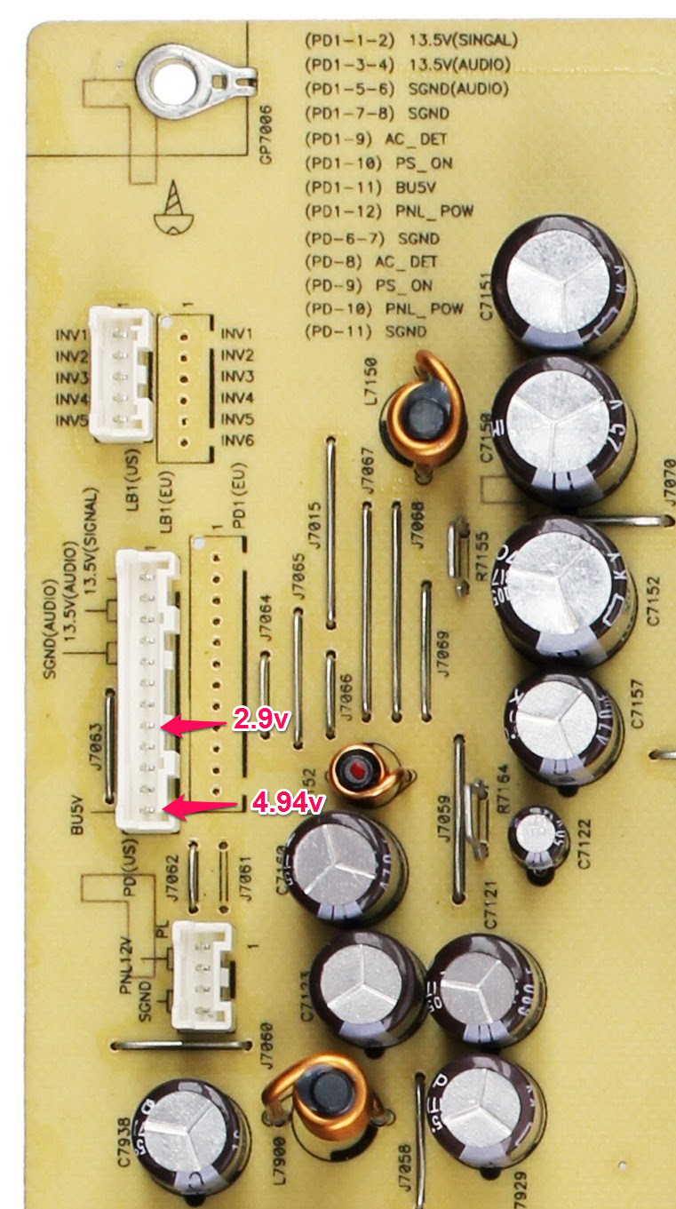

                            here are the two pins with the 2.9 and 4.94 volts readings. I use the program skitch to make the markings in the photo.
                              You got it right, the AC_DET (AC power is OK signal to indicate that the incoming AC Voltage is not too LOW or not too high for the TV to operate).
                              So you have STBY 5V and AC_DET but nothing else.

                                yes i was confused. thanks for helping me figure it out. so I do have the correct 2.9 volts where it is needed.
                                • drkthundr
                                  • Feb 2016
                                  • 45
                                  yes that would be true. STBY 5V and AC_DET but nothing else - correct.
                                    You need the PS-ON signal from the main board to turn on the power supply.
