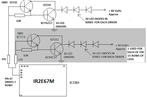

                        I have attached a diagram of part of the Backlight Driver IC 7201 for any one who is interested also I was able to purchase this IC from a chinese company on-line. I am still trying to get the Datasheet for it.

                                      To: BUDWICH or any one who have followed up with what I 've done so far and could help me with some suggestions.
                                      I have just finished changing the IR2E67M after doing some Internet training and practicing on some Motherboard chips . After installing the chip I notice the whole Menu with the Backlight flickering a little and lasted for a around five seconds and if I disconnect the AC plug the TV would resort to 1-1 Blink code .
                                      I decided to do an extensive check on the fifteen rows of thirty LED's by first assembly two of the rows with new led's
                                      [1]Row one just like in the TV with three segments P/N:5073+5069+5071 all in series comprising of thirty LED's.
                                      [2] Row two ,, ,, ,, ,, ,, P/N:5072+5070+5024 all in series comprising of thirty LED's.
                                      I applied 175v with the LED tester to the first and second Rows independently and got a current of 29.1 mA. in each case. I then checked the 15 Rows in the TV by disconnecting the two connectors and checking each row and got the same 29.1 mA. at 175 vdc.
                                      For the fifteen Rows they have alternated Rows one and two.
                                      I sprayed the connectors with 226 CRC and plug them back to the board.
                                      I rechecked the TV after replacing the connectors and got a stable Menu. I was able to reset the TV using the Menu and started an auto tuning which got dim after finding about 14 channels. so
                                      I am planning to re check the other Backlight components on the board and do a reflow of all the soldering joints to see if I could improve on the present state of the board.
                                      I have noticed that the Power Supply Diagram is not available in the Service Manuals for the 60 to 80 inch Sharp TV and I would like some help in locating a copy.

                                        wow lots of good work.
                                        As for a power supply diagram, as you have found, I think you will likely not find any as somehow the manufacturers (or their suppliers) appear unwilling to provide these even in manufacturer service manuals for a set. :-(
                                        Not sure but from your "last step" (ie. auto tuning), you mention "got dim" but you still have some form of back lighting, right? or its gone away again?
                                        IF you have some form of backlighting so that you can hopefully see the screen, you might consider trying to get into the service menu and look at the error counts to see if they provide any clues that the controller might be "seeing" some issues.
                                        IF you still have some form of backlighting, maybe you have some sort of "auto dimming" circuit kicking in... just a thought though.
