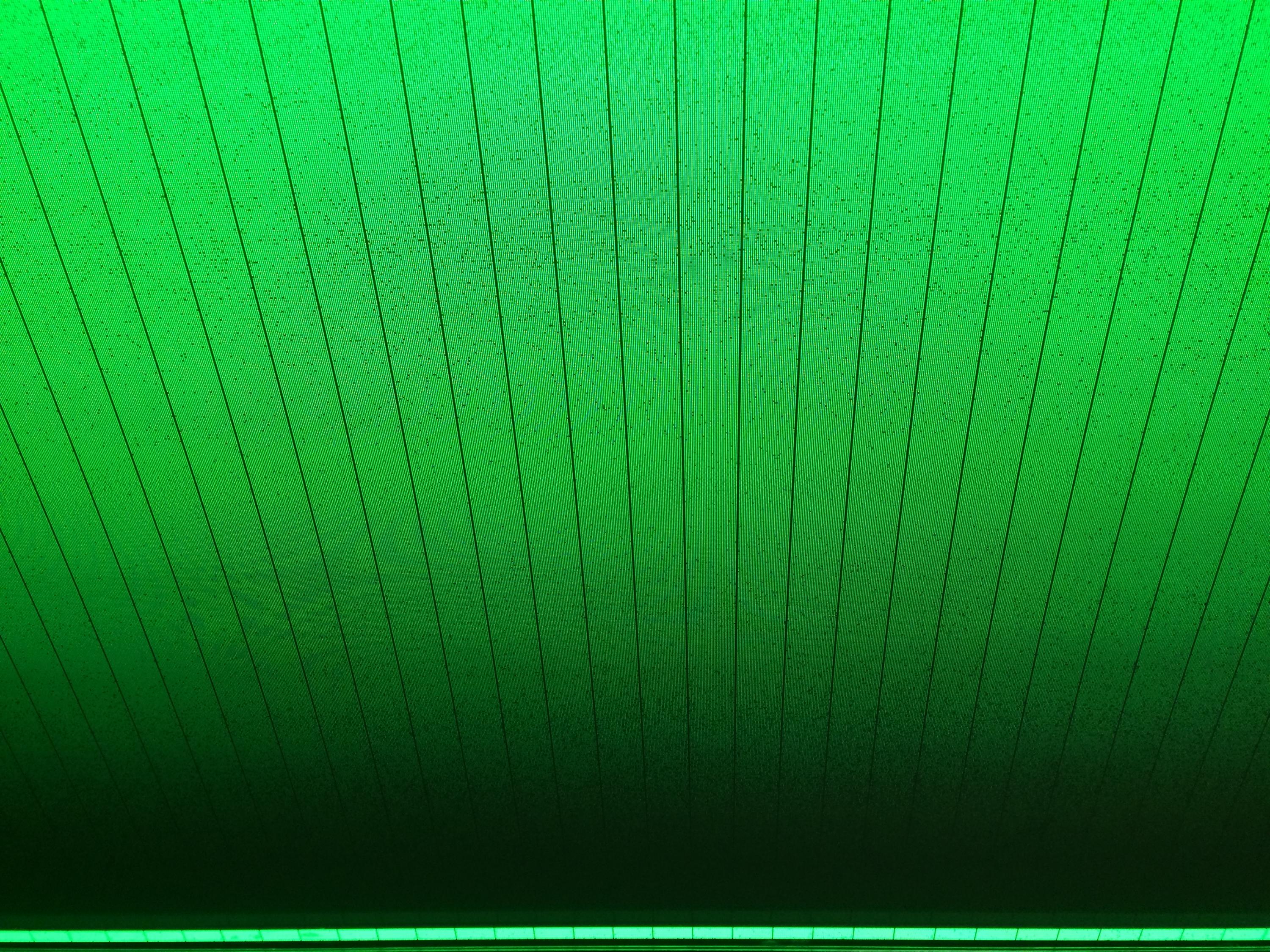

    I have this Samsung with vertical lines. They are evenly placed on the screen, making me think it's not a panel problem. Is that caused by the upper scan drive or the XSUS?

    Thats either a mainboard or Tcon problem, upload images of the boards.

          Run test patters by jumping pins 3 and 4 on the control board.
          If the lines remain it's a control board fault.

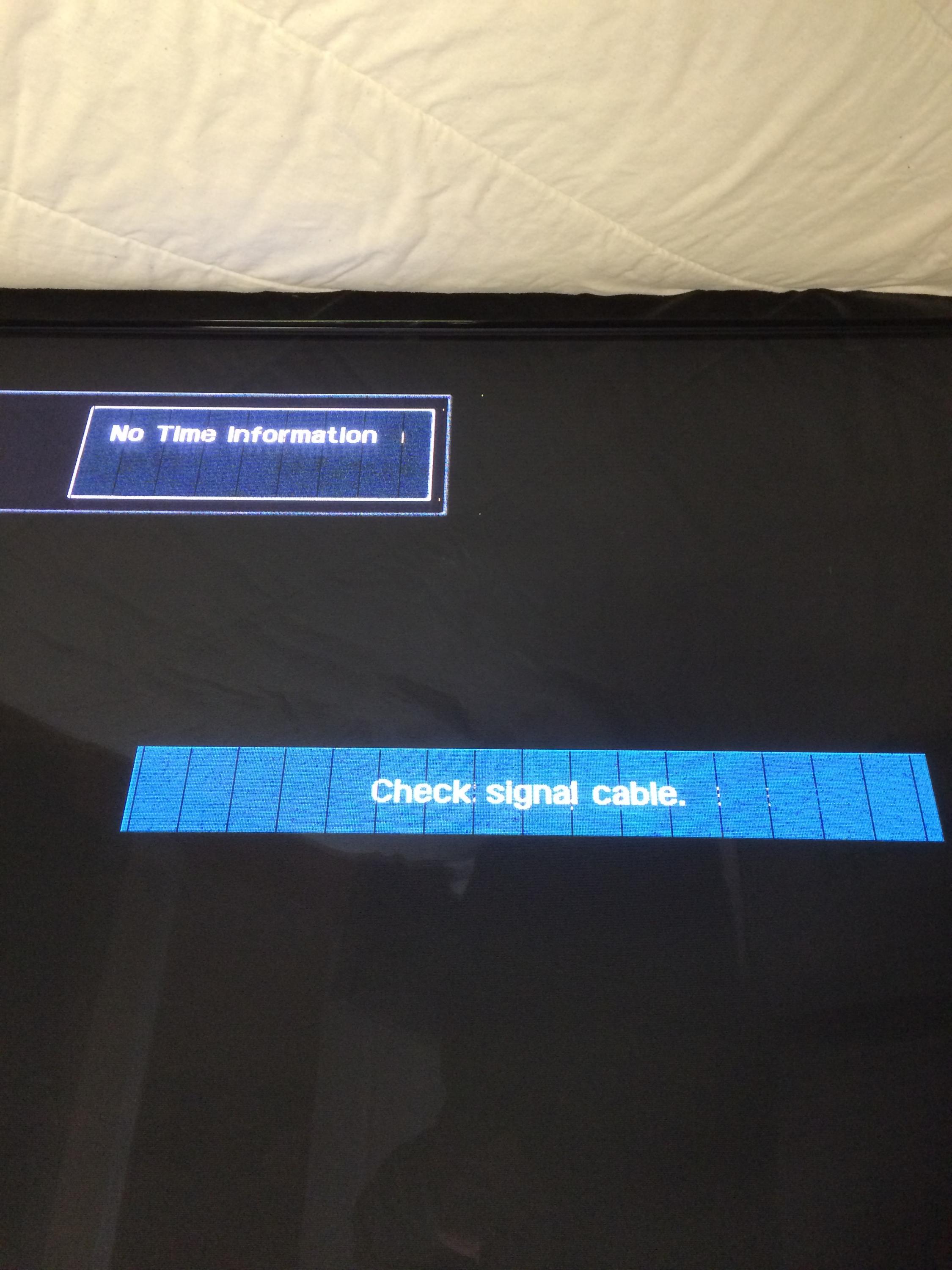

                My buddy popped into my house to look at the tv. The main board is a BN94-02802C. The logic board is a LJ92-01700A. I asked him to do the logic board test but he couldn't get the test pattern. He jumpered 3 to 4 and pulled the right ribbon cable. He said the tv turned on but it was a blank screen. Is that a main board or is that he's doing it wrong?

                  Make sure to remove the Lvds cable (main board to logik board) then try.

                    He said that's what he did and it was just a blank screen. He had to leave but might go back to the house later on tonight.

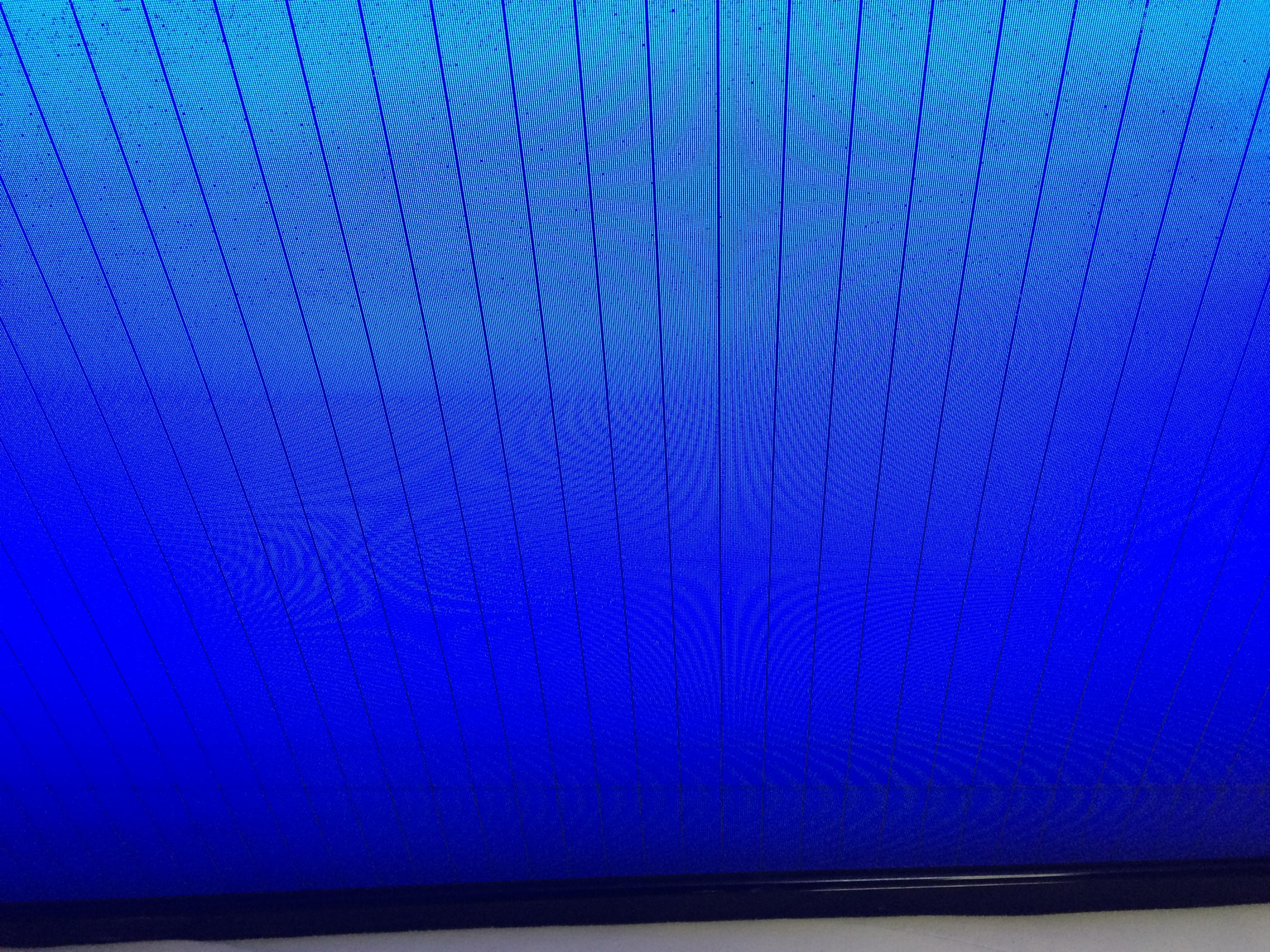

                      He sent me pics on the test screen. I told him to pull the wrong ribbon cable. The lines are still there. I guess the control board is faulty?

                        So was this ever fixed? I have an insignia set with the same exact lines and results in diagnostics

                          It'll be a control board fault.

                            It was the small main logic control board... $15 fix..
