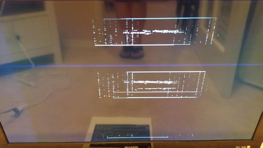

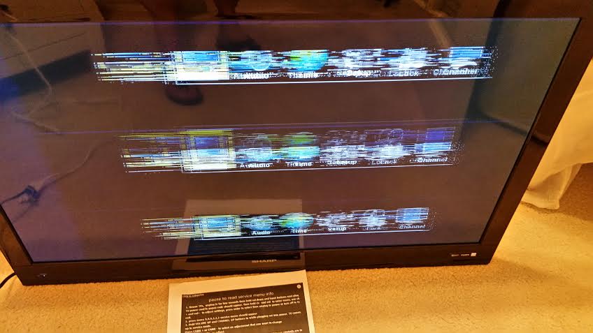

    I found a service menu online and pushing a sequence of buttons got me to these next 2 screens ("No Signal" and what appears to be a Menu screen). As you can see, the images are quite distorted. They are also in triplicate.

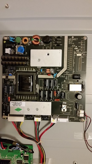

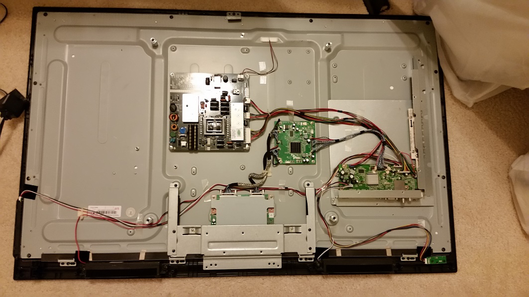

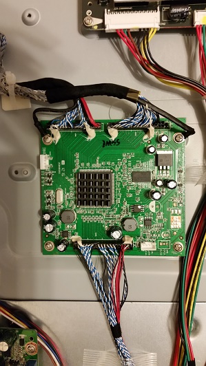

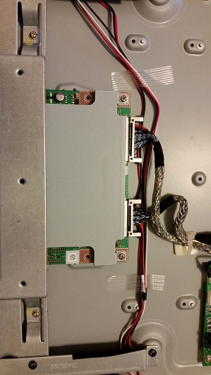

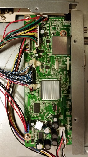

    I took off the back cover and took a look around. (see photos). Nothing looks glaringly obvious or out of place.
    Any suggestions as to what might be the issue? What I might try next? OR is this a lost cause?

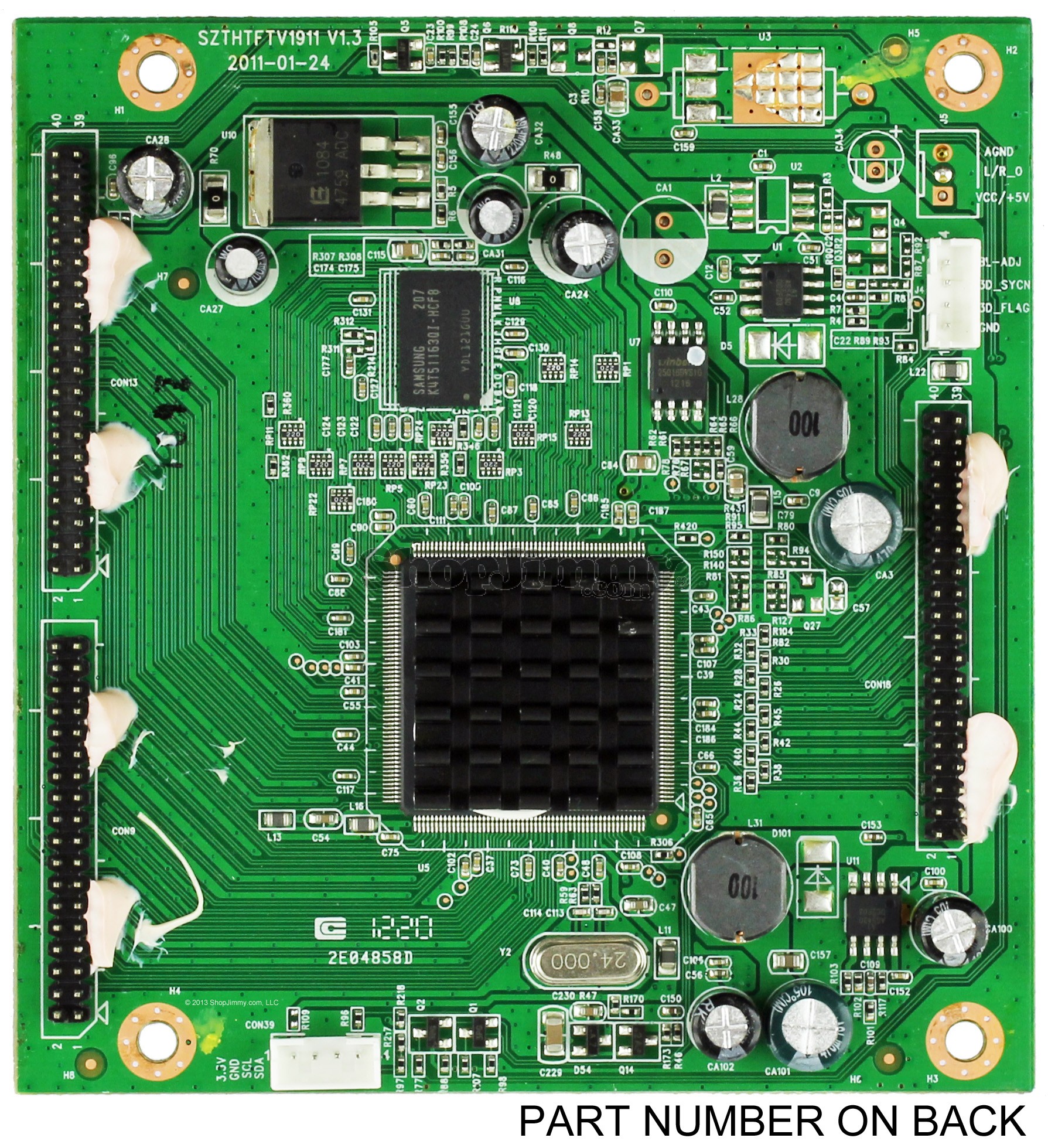

    If I remember correctly, it may be bad caps on this FRC board.
    https://www.badcaps.net/forum/attach...5&d=1453951275
    You can try heating this board with hair dryer to see if the symptom changes.

        I tried applying heat to the FRC board with a hair dryer, as suggested.
        Initially, I didn't notice much change in the display (although the chassis in that area got warm/hot to the touch), so I tried the hair dryer again.
        After a few minutes, I was watching the display and noticed some random red coloration in the background of the black & white "No Signal" screen. As I was getting my camera ready to snap a photo, the TV shut itself off, leaving a solid red power light.
        I tried restarting the TV, but have not been able to get past the red power light.

          The TV is back to it's "usual"...a distorted black and white "No Signal" displayed in triplicate....and a random blue horizontal line (approx. 1/2" high) across the screen every now and then. (No sign of the random red coloration the showed-up just before the TV turned itself off earlier.)
          Would this test indicate that the FRC board is (or bad caps on it are) the culprit?

            I found a video online where a service tech mentions the use of a hair dryer to heat up a board to temporarily bring it back to life, which would indicate possible bad caps.
            When I heated up the FRC board in the Sharp TV initially, nothing much changed. Then when I went back and reheated the FRC board some more, I induced some random red coloration on the B&W "No Signal" screen before the set shut itself off. I had to let things cool down before I was able to turn the TV on again.
            I'm not sure if this "test" now proves that the FRC board needs replacement or should I pursue something else in troubleshooting this TV?

              Re: Sharp LC-40LE433U triple images and distortion
              It is tough troubleshooting without much of the service manual.
              When caps go bad the ESR will go up and cause the circuit to malfunction, so when you heat it up if the caps are not too far gone, the ESR will come down then the circuit will operate again.
              You may want to look around to how much the FRC board is or try recaping the whole FRC board. You have about 9 electrolytics caps on that FRC board.
              I also wonder if it has correct DCV feeding that FRC board. The pin are labeled so you can verify the Voltages.

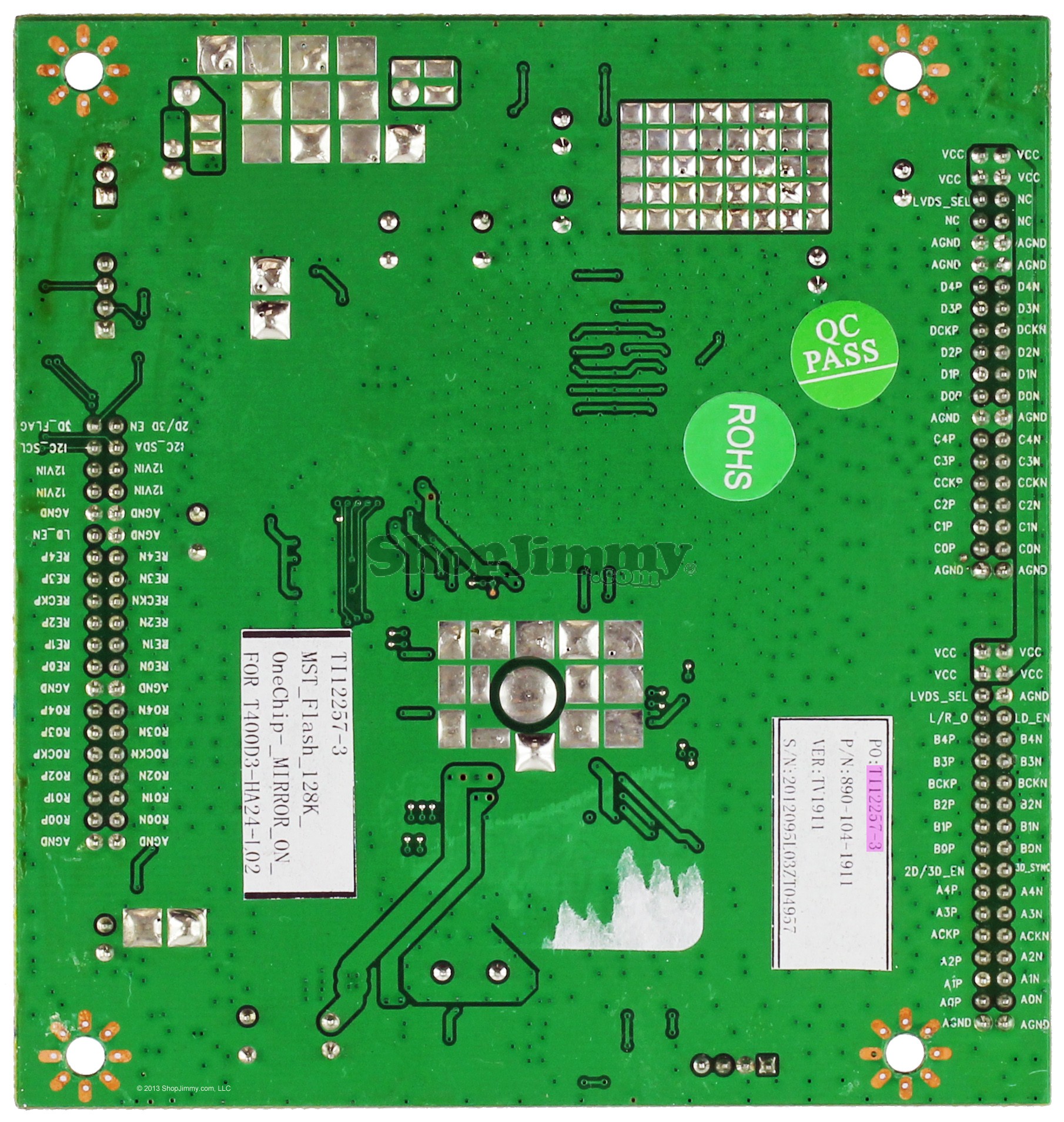

              Board is only $10.
              http://www.shopjimmy.com/sharp-ti122...ital-board.htm
                    budm,

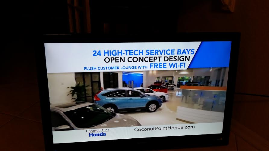

                    I ordered and installed the FRC board as you suggested.
                    Success! No more triple images and a good picture!
                    I've attached a screen shot (photo of a car commercial).
                    Thanks for your spot-on suggestion.
