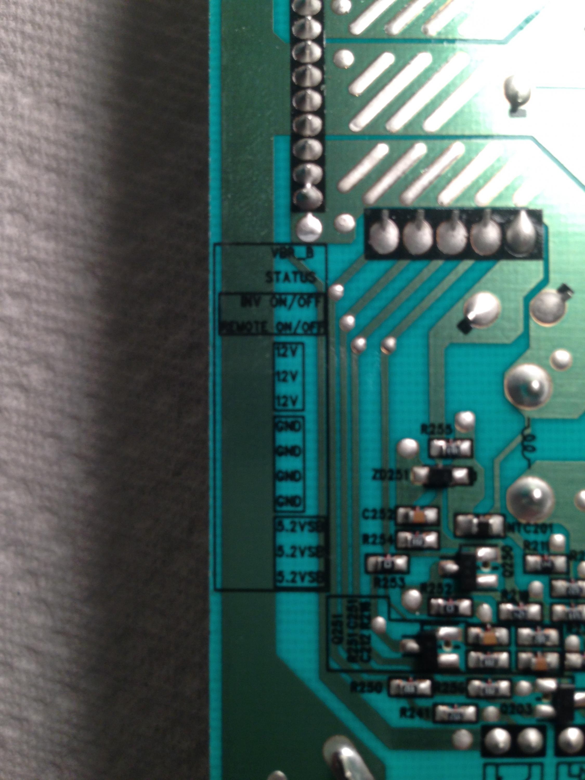

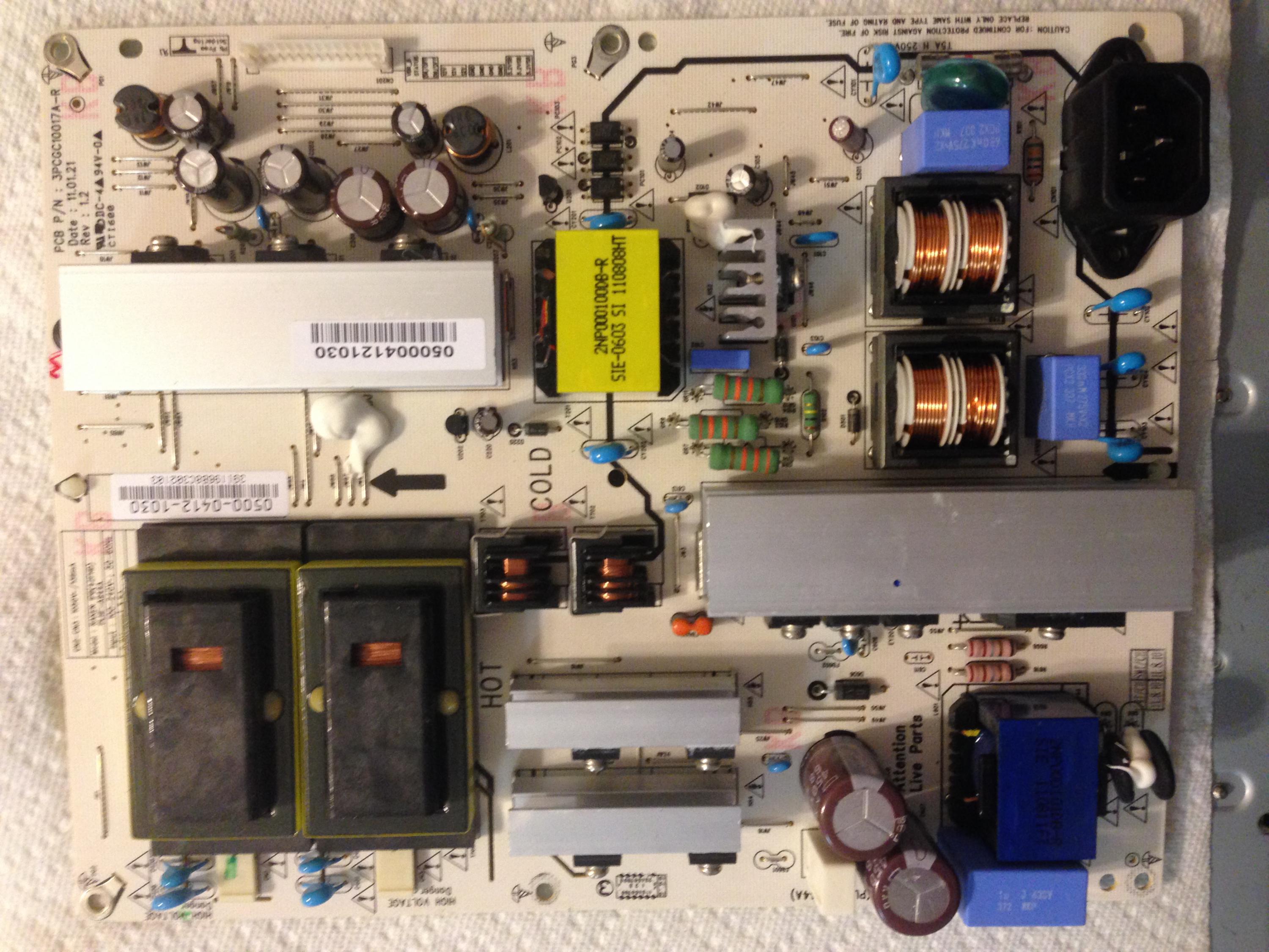

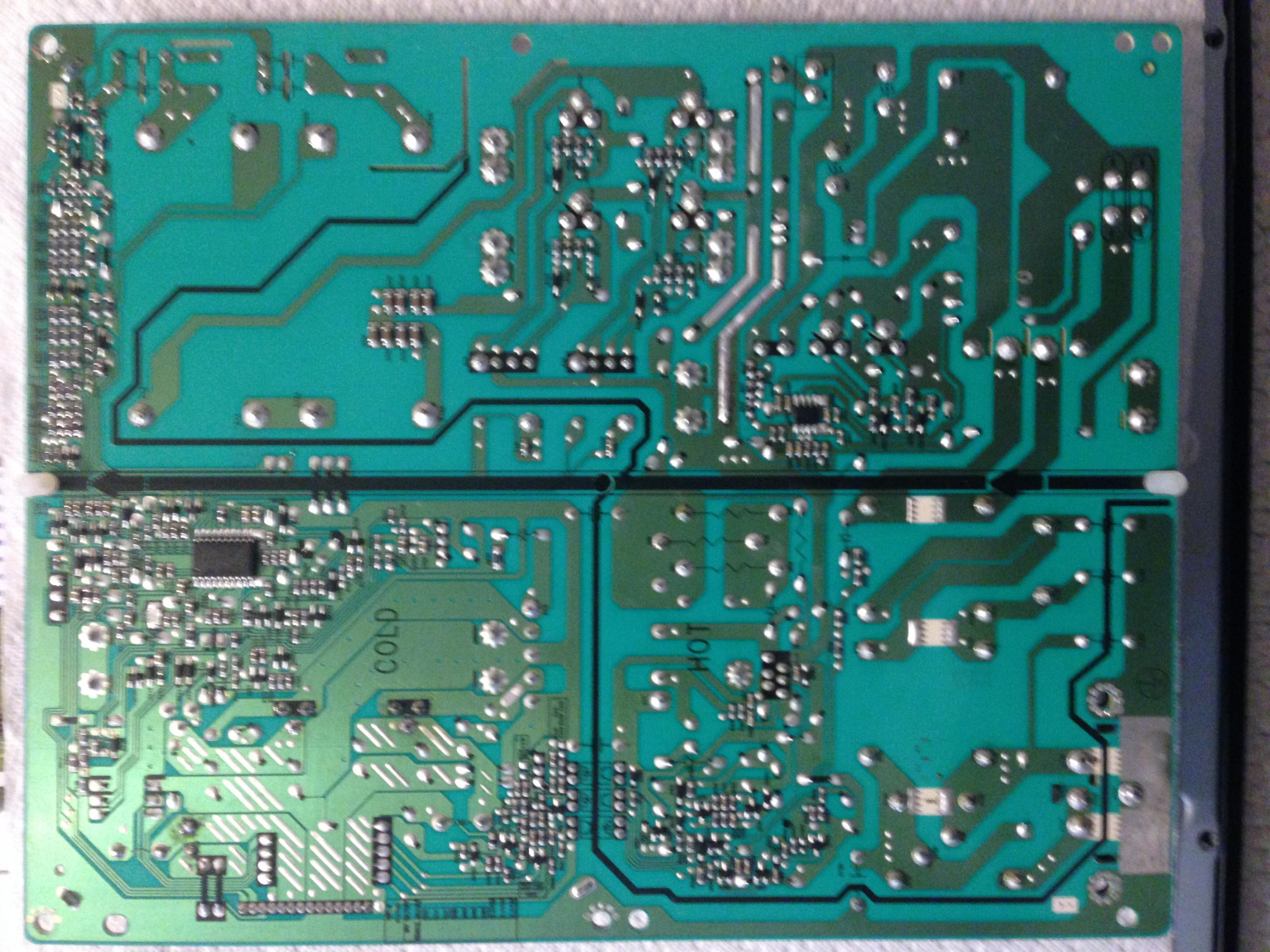

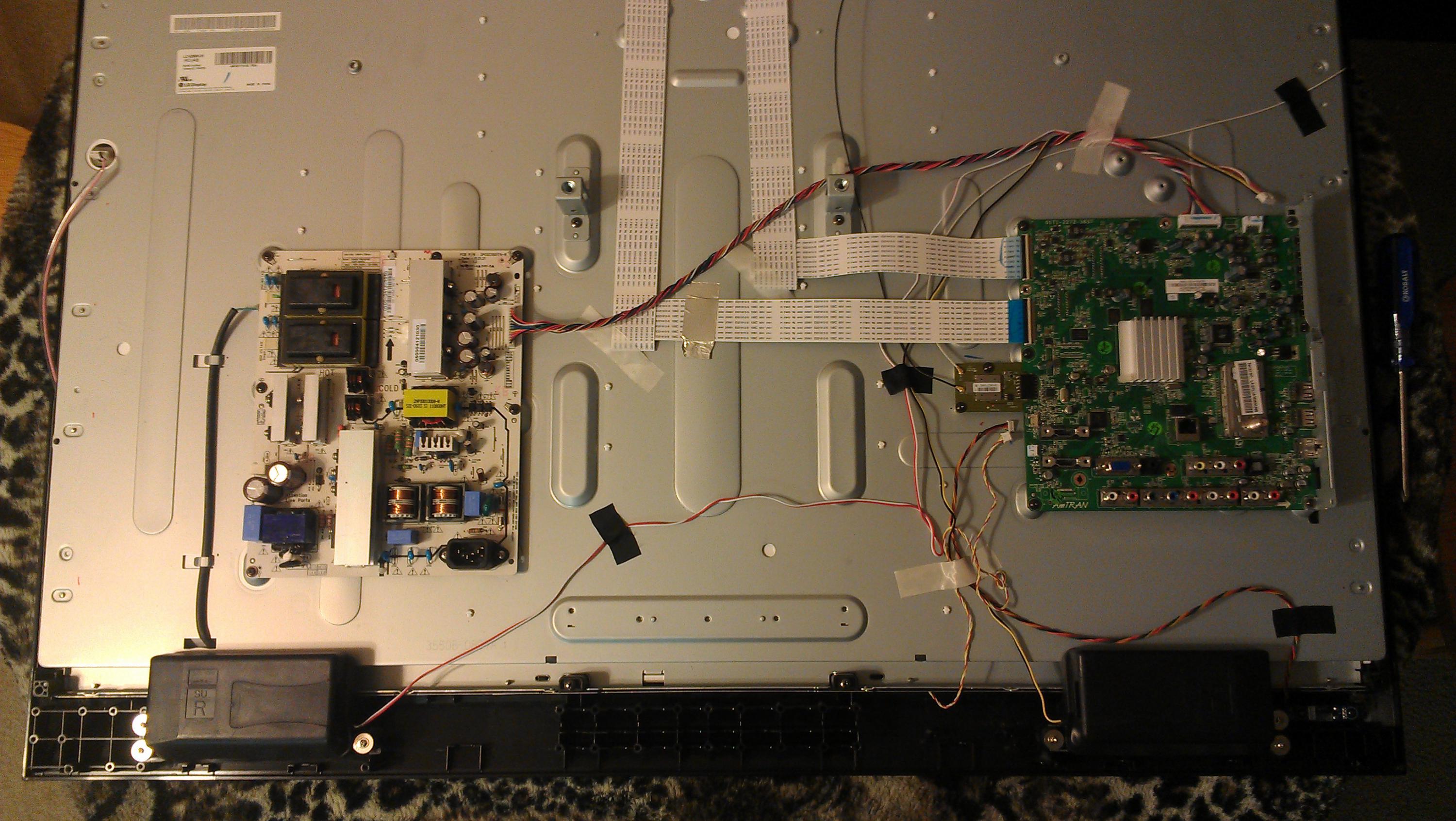

    Need some help troubleshooting this vizio. The set appears completely dead with no Logo light and does nothing when pushing the power button. I have done some tests. The power supply appears to be working correctly. By isolating the power supply, I get the 5v standby. Once I connect only the mainboard to the power supply, I get 12v along with the 5v. The weird thing is the mainboard sends 2.2v on the power on/off pin even before hitting the power. That is why I have 12v before powering up the set. I have checked the voltage regulators and they function correctly. I am looking for ideas on troubleshooting this LCD.

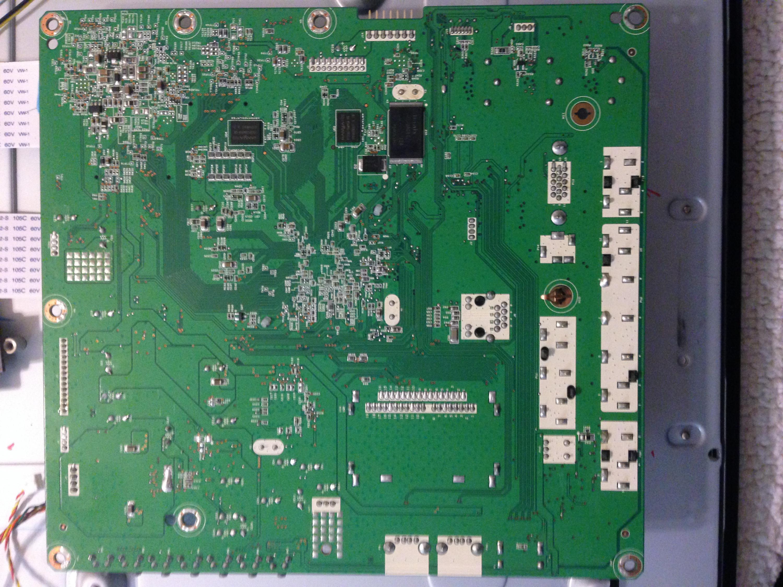

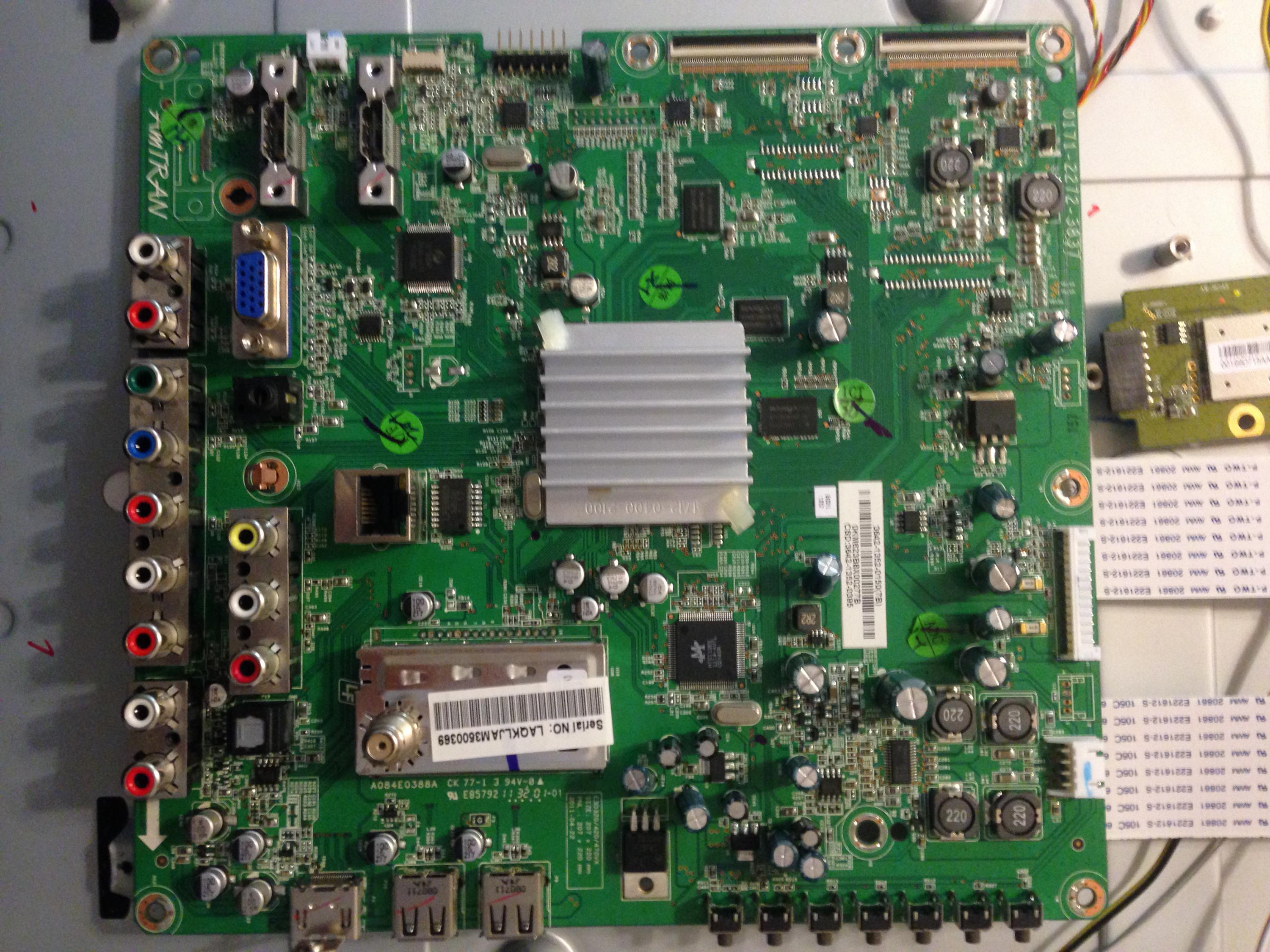

      So what you saying is that the PSon signal from the main board is "stuck on", but yet the TV won't power up? Looks like a main board problem to me.
      Try unplugging the IR board?

        That's a good way to put it, its "stuck on" but will not power up. I agree with you, its the mainboard. I have shorted the PSon and backlight on with 1k resistors and the backlights came on. So, I figure that rules out the PS. I have tried unplugging everything except the PS and nothing changes. The fuses on the main board check out. The voltage regulators also check out. I am stump with this one.

          There is a eeprom to be had at SJ, but it doesn't mention that symptom you have. So I guess you should look for a new main board.
          You also could try heating (hair dryer) or cooling (can of air upside down). Freeze the eeprom, see what happens.

              Or there is some problem with PSOn signal generation circuitry on mainboard, shorted transistor perhaps?
