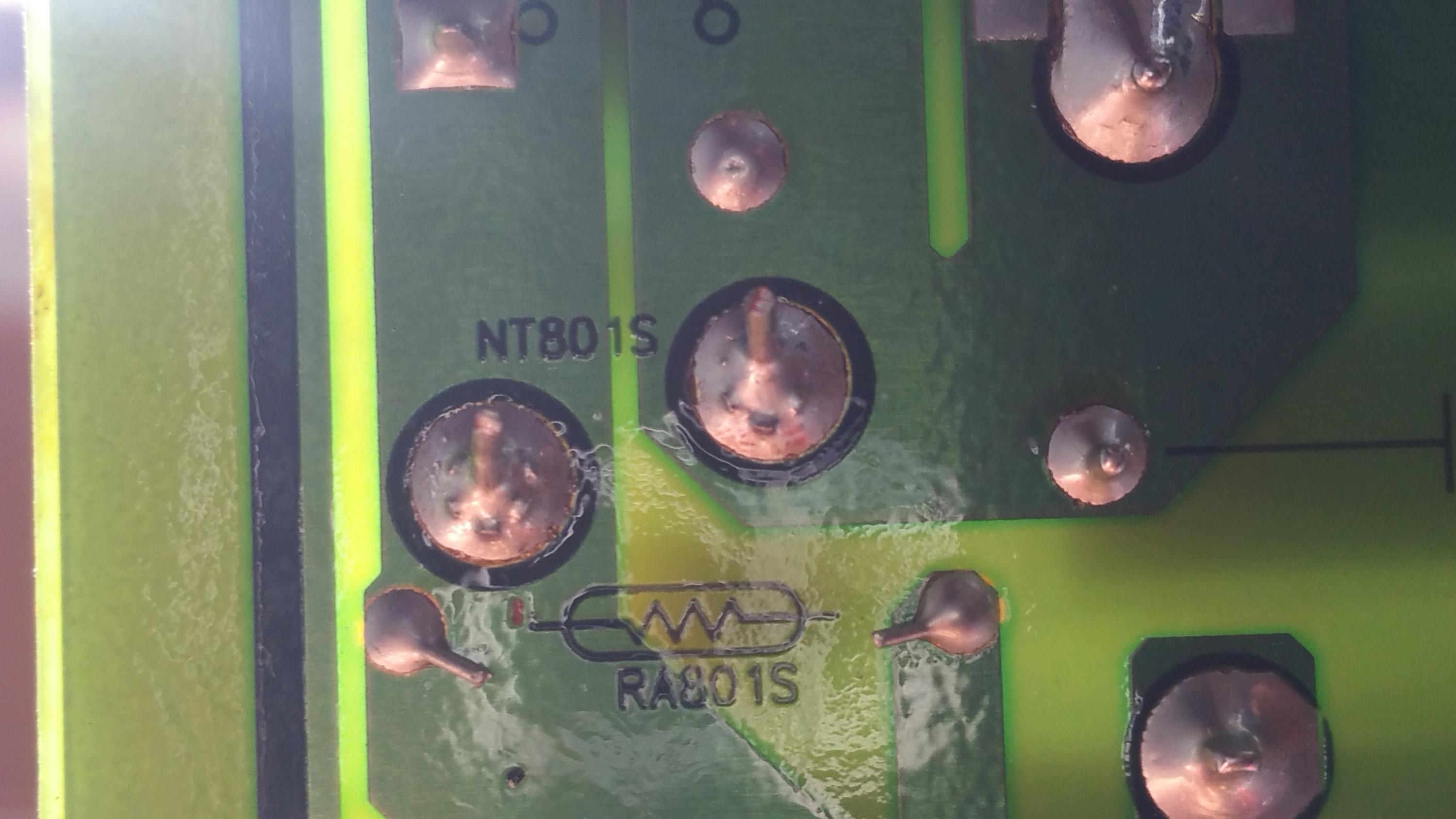

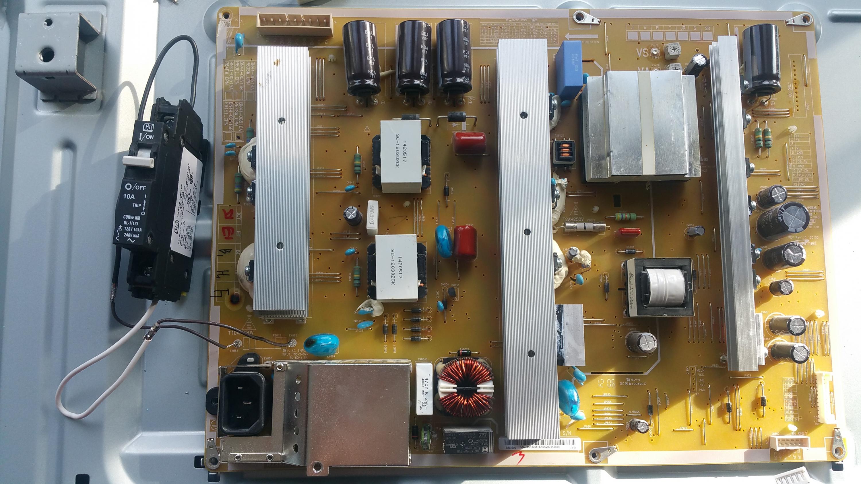

        hi guys.. so i have the same model - fuse was blown no power , no standby.
        put in a small circuit breaker to narrow down bad board. its the actual power board thats causing the problem. what i have found was the green porcelain (capacitor ?) was letting out am extremely tiny puff of smoke when i would try and reset the breaker. there is no name or number on the piece but it does have the number RL801S on the top and NT801S on the back. trying to find that replacement item but i have no idea what that particular item is. its porcelain and it has a crack in it. there is currently 19ohms across it.
        i realize im late to the party here but any help is greatly appreciated... thanks

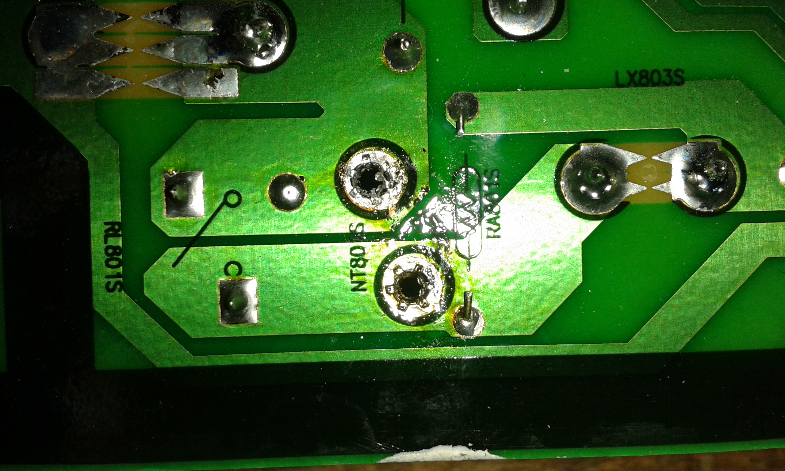

          i would like to point out, the discoloration on the left side of the board and the discoloration on the capacitor is from my cordless soldering iron (was doing this at home, actual corded is at work) and those are light surface only with no effect on parts.
            Re: BN44-00516a
            Did you solve your fault, pipeandwire? I may have a similar problem with my board. I measure <10ohms across NT801S (which shows some crumbling of the material near the legs, but no obvious sign of having blown). I also had a blown fuse F801S.
            I've measured QS802 and QS804 but they are not shorted.
            I do, however, measure a short across the DC outputs of the rectifier BD802S - I am in the process of narrowing this down.

              It looks like QP802 and QP804 have shorted (both of these are K18A60V MOSFETS). The short measured across output of rectifier BD802S has now gone.

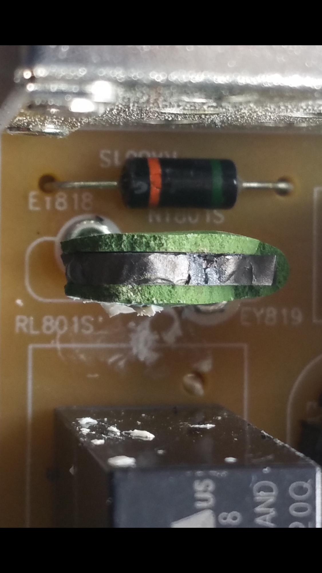

                        Hello,what do I replace NT80S with, in the power supply BN44-00516A. Thanks Bertil,

                            Can you read the numbers as printed on the body?
                              #34
                              Re: BN44-00516a

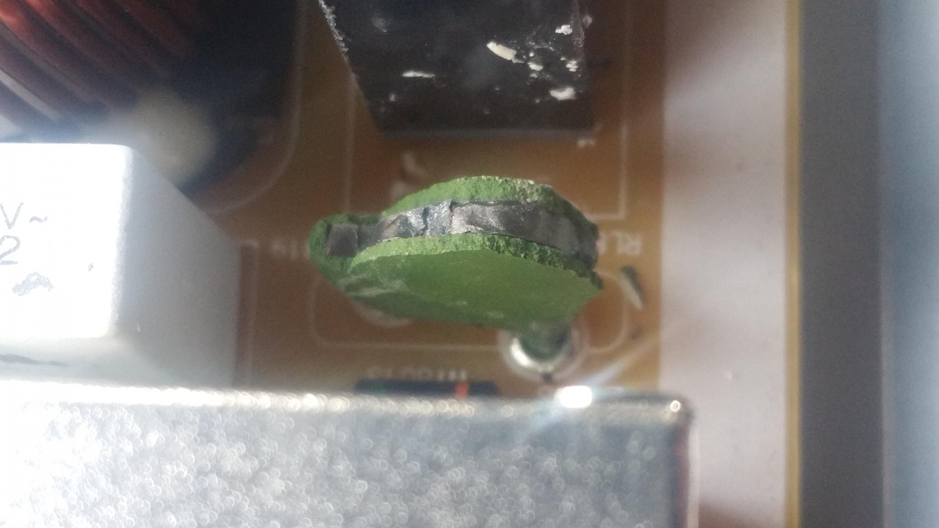

                              I think NT801s is a 15D050

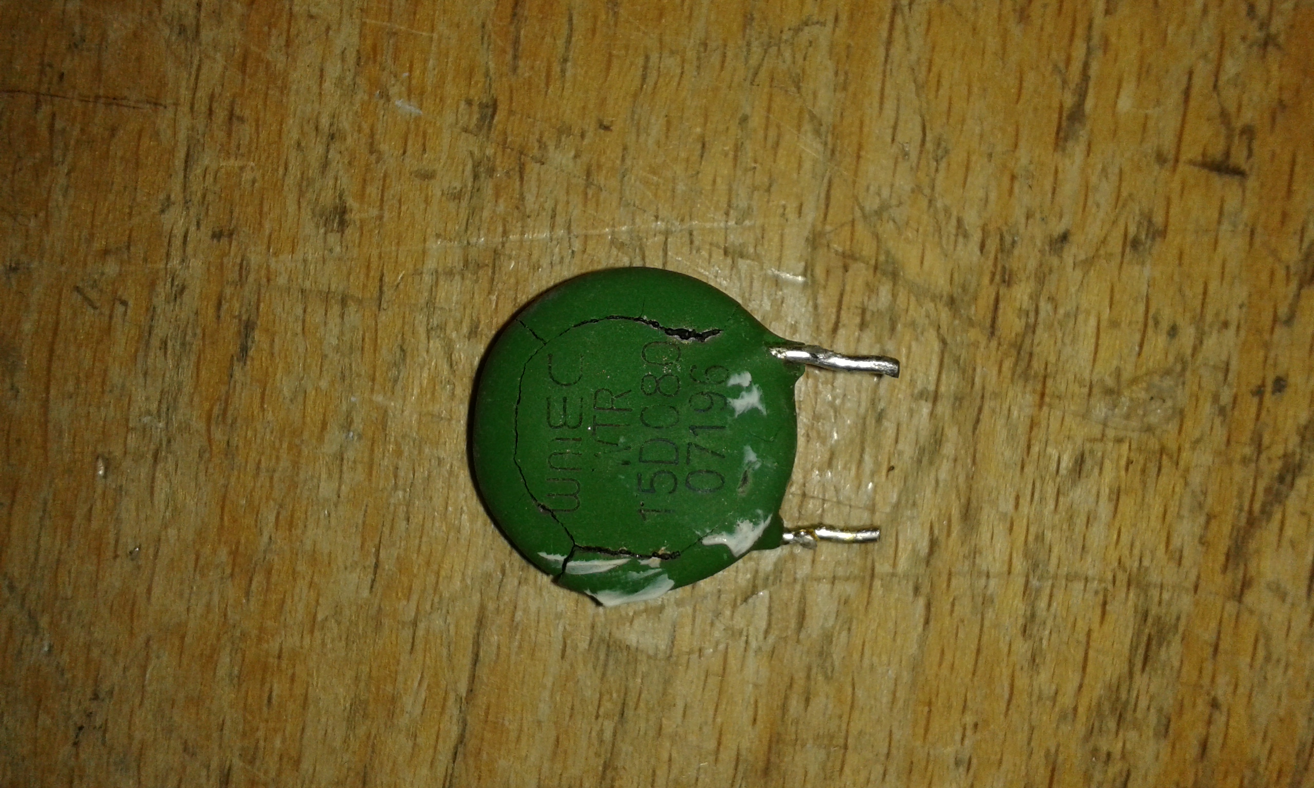

                                Hello, picture shows 14 ohms what can i use instead.
                                Best Regards . Bertil
                                  #36
                                  Re: BN44-00516a
                                  WMEC WTR series
                                  WTR15D080
                                  15mm diameter, 8 Ohms @25c
                                  https://cdn.badcaps-static.com/pdfs/...e83555c7f0.pdf

                                      I originally listed a 15D080 but changed it when I looked at a BN44-00622b schematic which uses the 15D050
