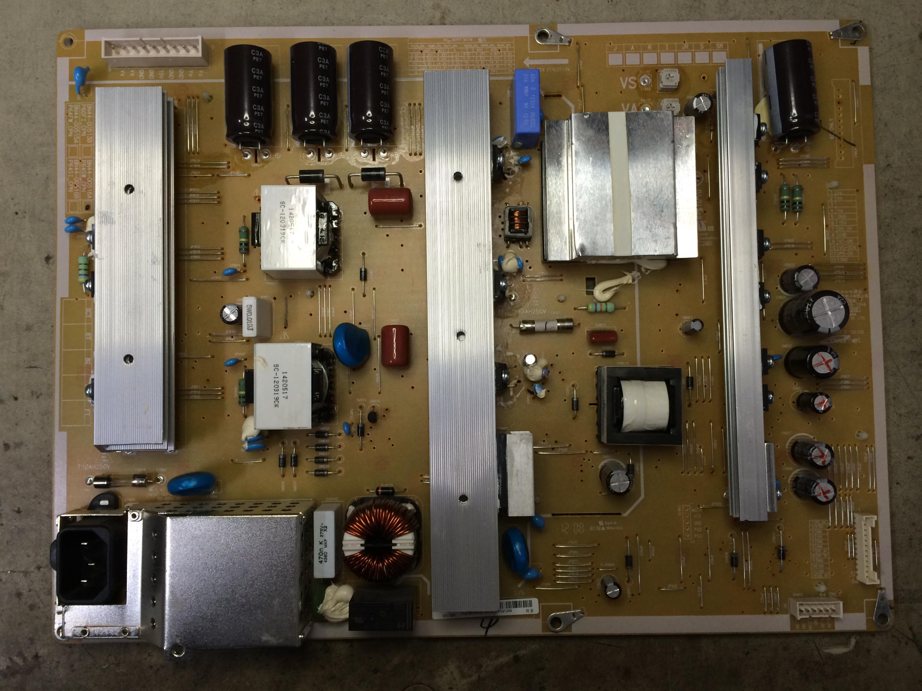

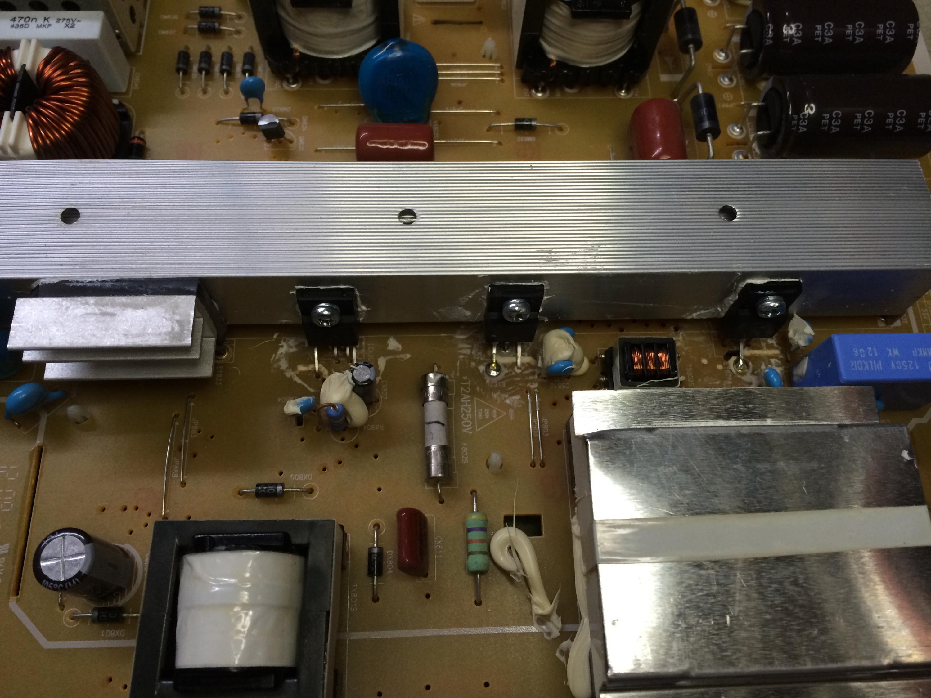

    I have a BN44-00516a that had a shorted Qs802 and Qs804. Probably because the pins had cold soldered joints. F801s was also open. Ordered repair kit from ShopJimmy. Now I have no standby voltage, but PSon has approx. 4.5 volts. I was reading previous forum posts on similar boards (specifically BN44-00514a). My problem is exactly the same as this thread: https://www.badcaps.net/forum/showth...ht=bn44-00514a
    Any help would be greatly appreciated.
    Re: BN44-00516a
    Here are some photos of the power supply board.
      Re: BN44-00516a

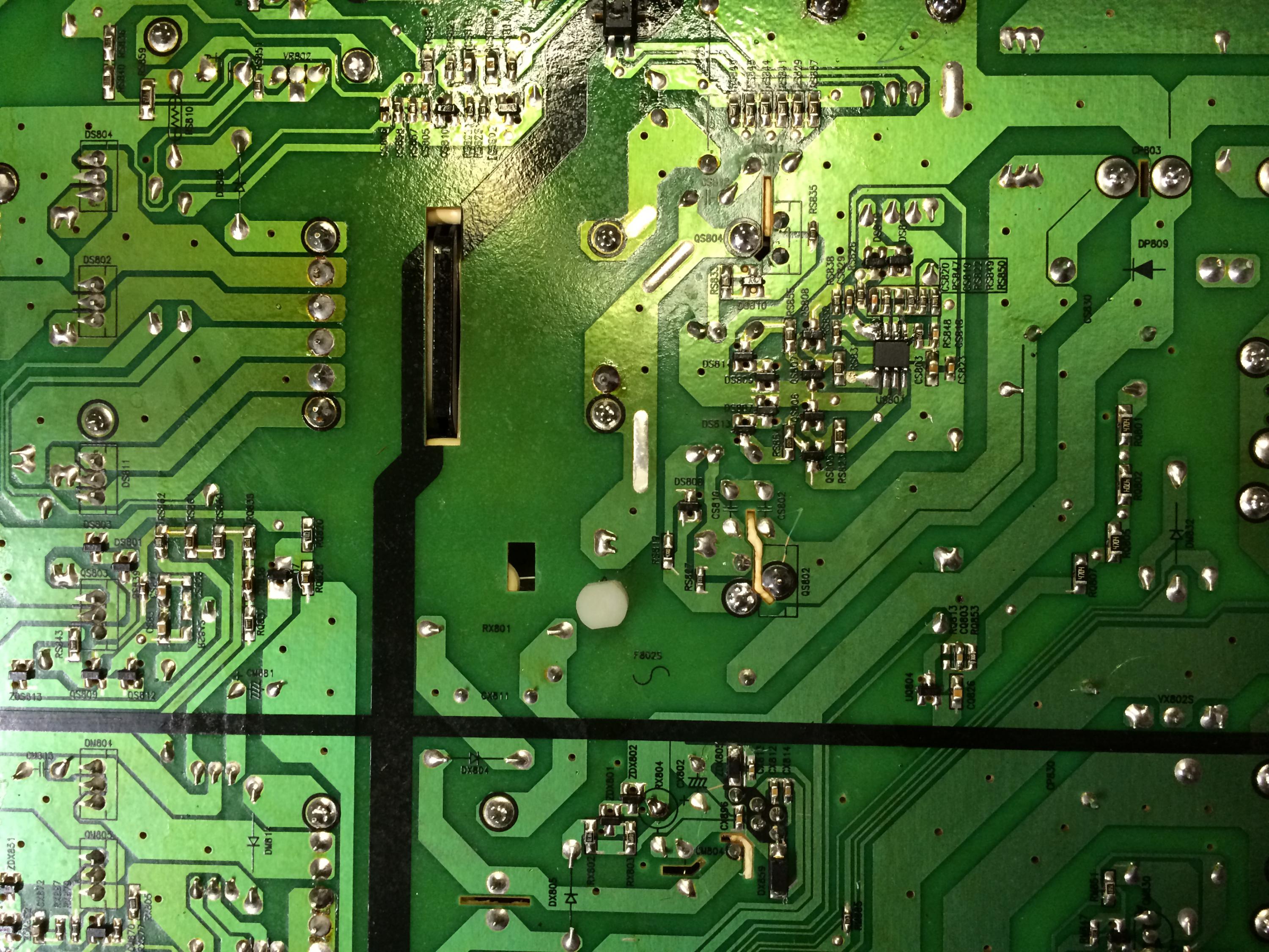

      Update: Found UQ802 (picture 4) was defective. This part was a part I replaced as part of the kit that was ordered. Replaced part with the original and 5v standby returned.
      Since the original problem was QS802 and QS804, I figured it was worth a shot to reinstall this part.

              It sounds like I might have a similar problem to you (my original post was "Samsung S64FH Sound but no picture then no power"). I have found that QS802 and QS804 were shorted on my board and I have replaced them (I had bought the BN44-00516A repair kit).
              My question is how did you determine that UQ802 was defective? Appreciate any insight you might have.

                      After installing the kit, my 5 V supply was missing. I believe UQ802 is the controller for that voltage line. Since that wasn't my original problem I just reinstalled the original part
