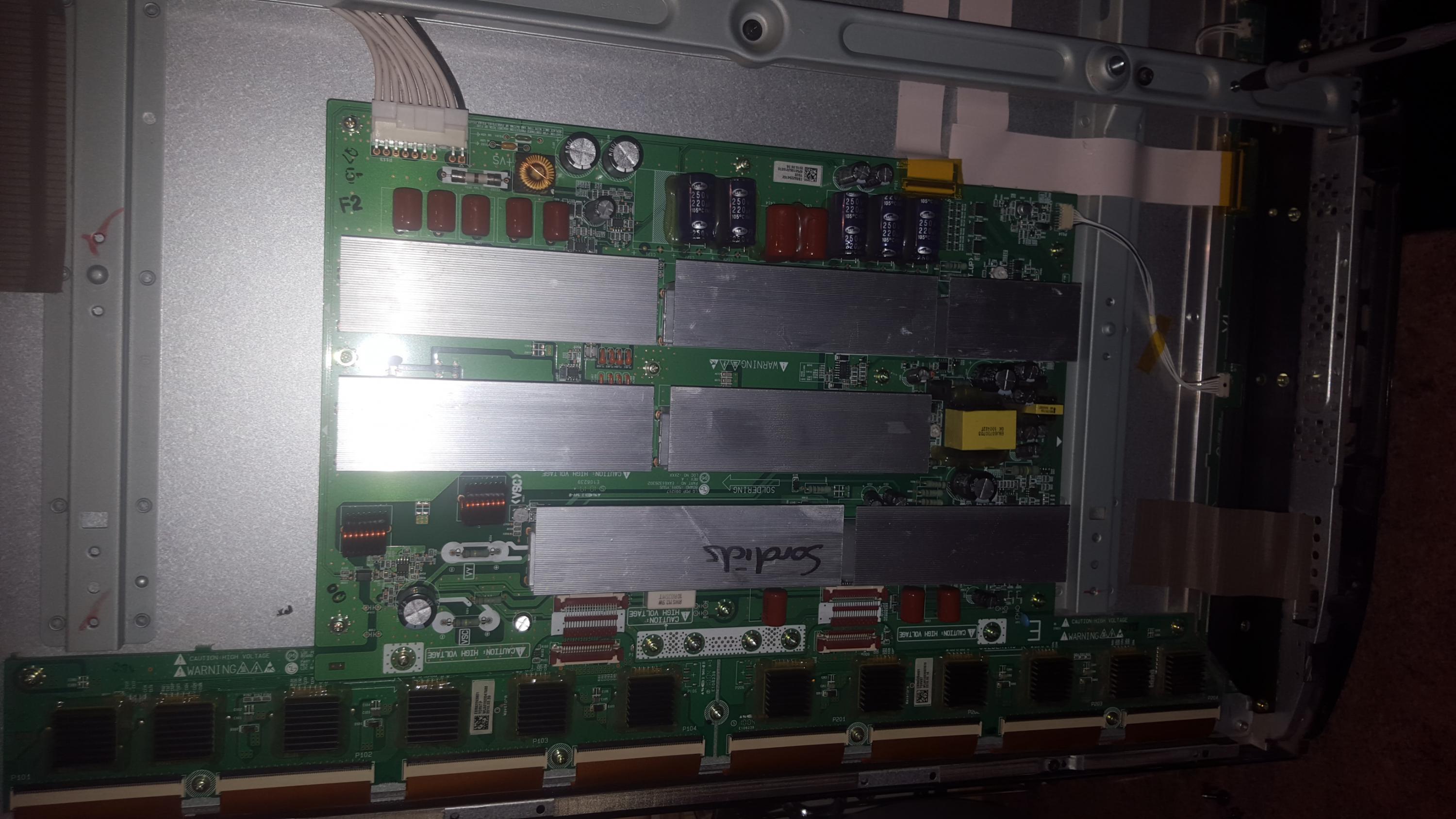

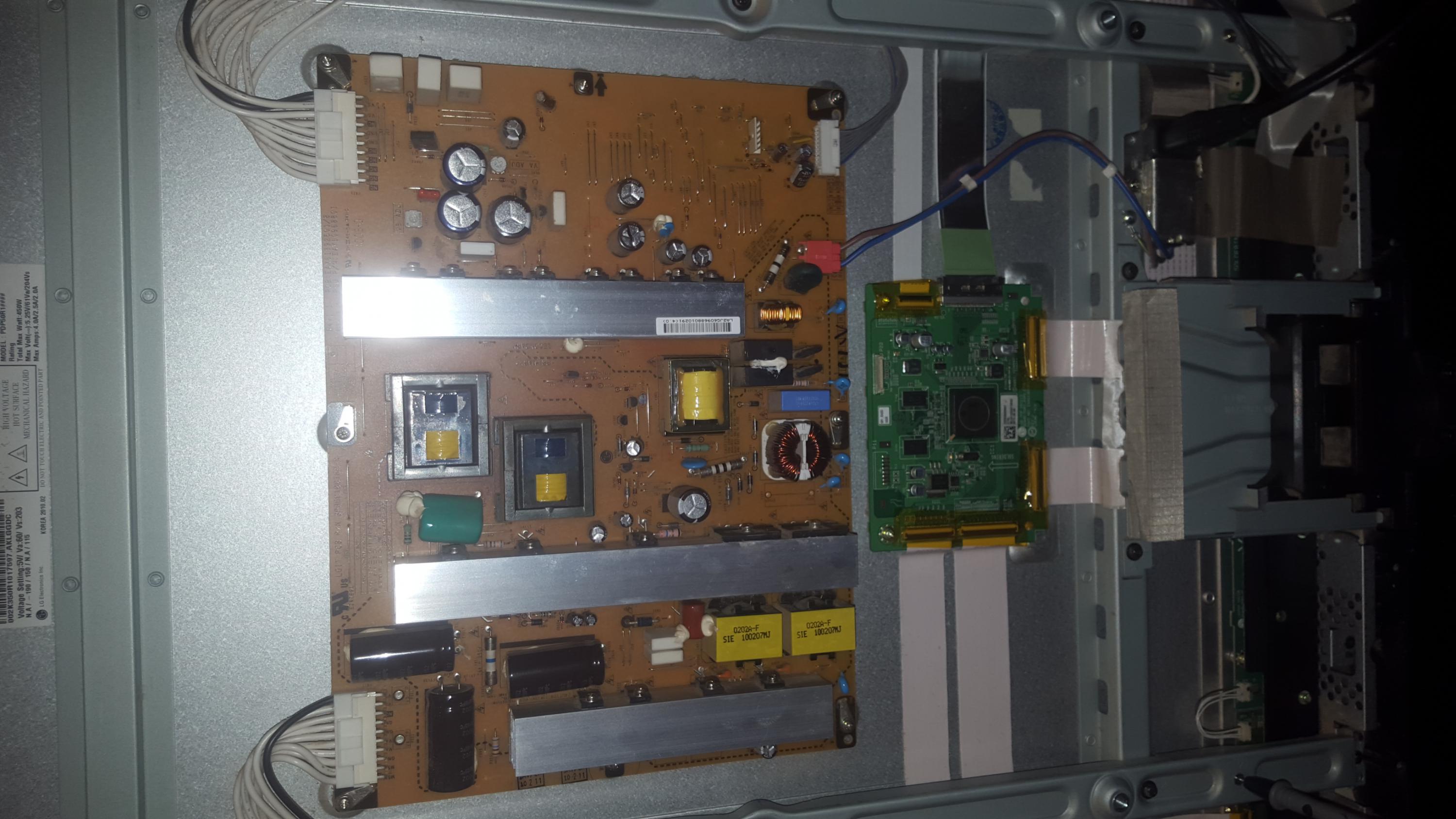

    hello guys

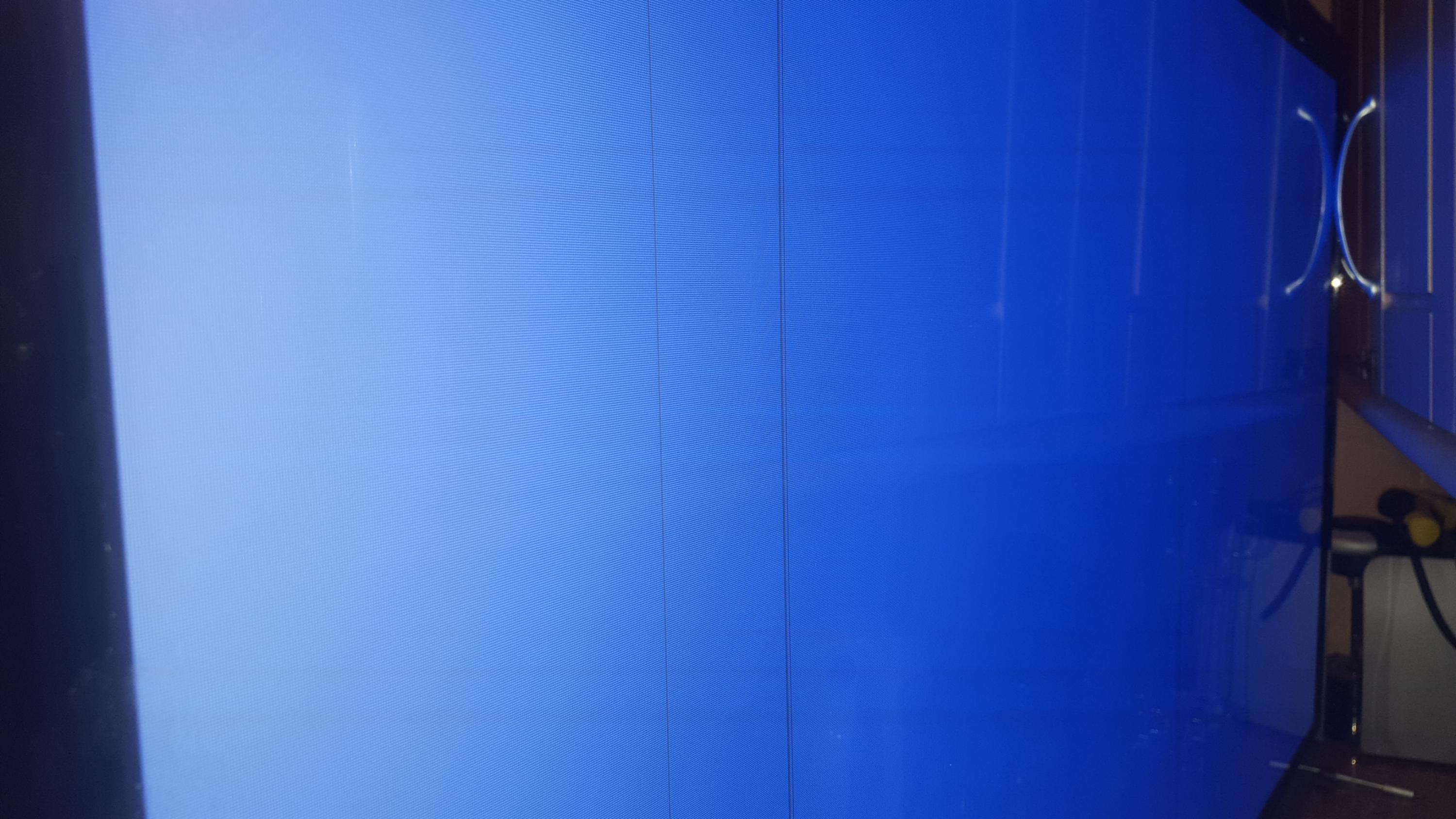

    got this tv that would power up VS 200 volts VA 57 volts but no picture but VSC AND VY was low so ordered a replacement Yus which arrived today but upon fitting still the same so tested for test patterns which worked so main board was faulty luckily had a replacement,so tv is all working fine now but with fours vertical lines.
    I know the panel is proberly faulty but i still cant get good readings off the Ysus
    readings as follows
    VS 200 volts
    VA 57 volts
    VSC -104 volts
    VY -104 volts
    VZB -115 volts
    any ideas why readings are so low
    thanks

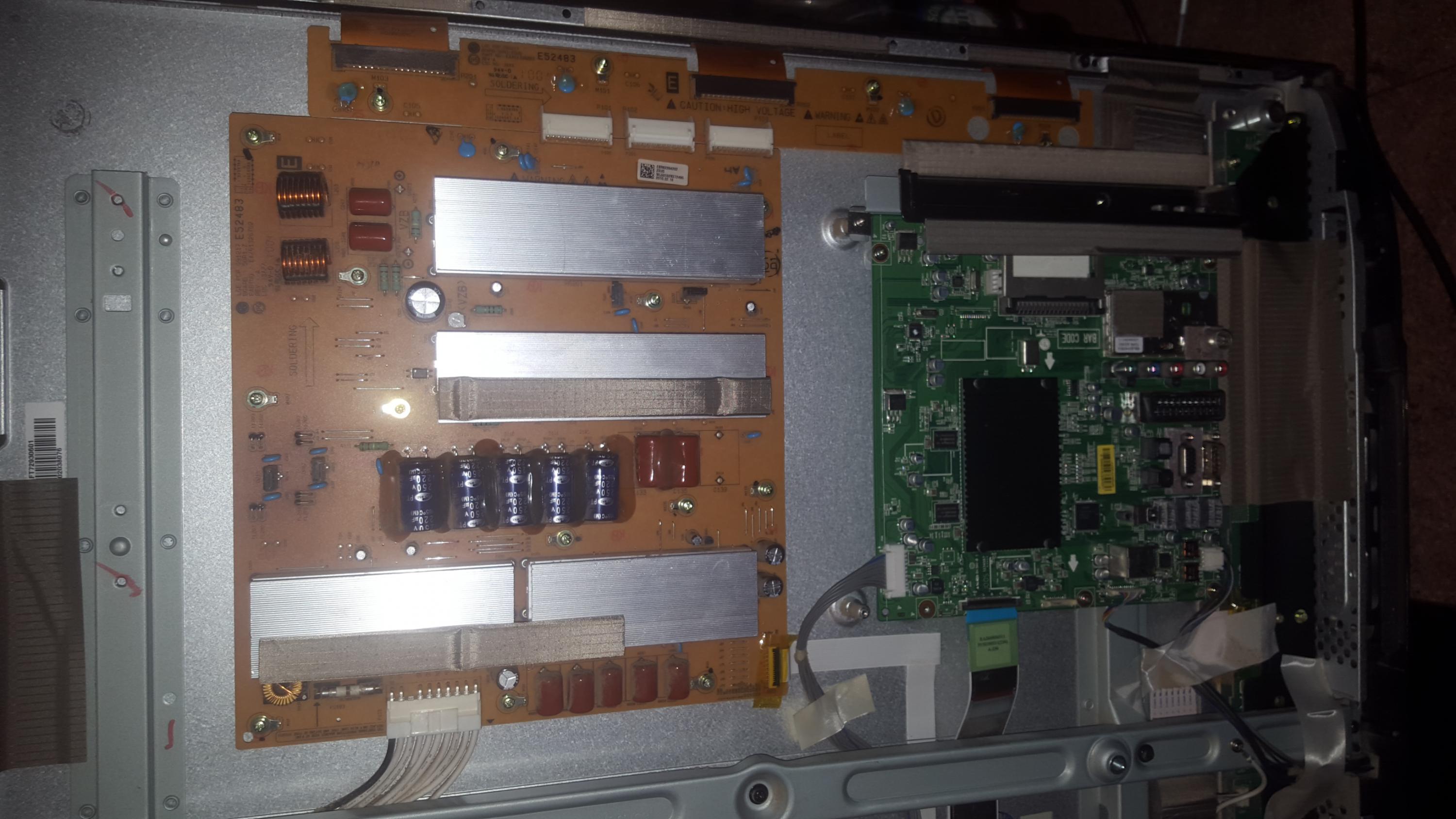

      Just tried the old YSUS and same readings so it was the main board at fault but just cant understand why voltages are low on both YUS`s

        Re: LG 50PK590 VSC low
        Mainboard isnt puimg Vs on low enough. Also Panel is toast seen it on the model before
            Yeah I'll strip it for spares got it cheap anyway shame really watching it now looks good apart from the various lines
