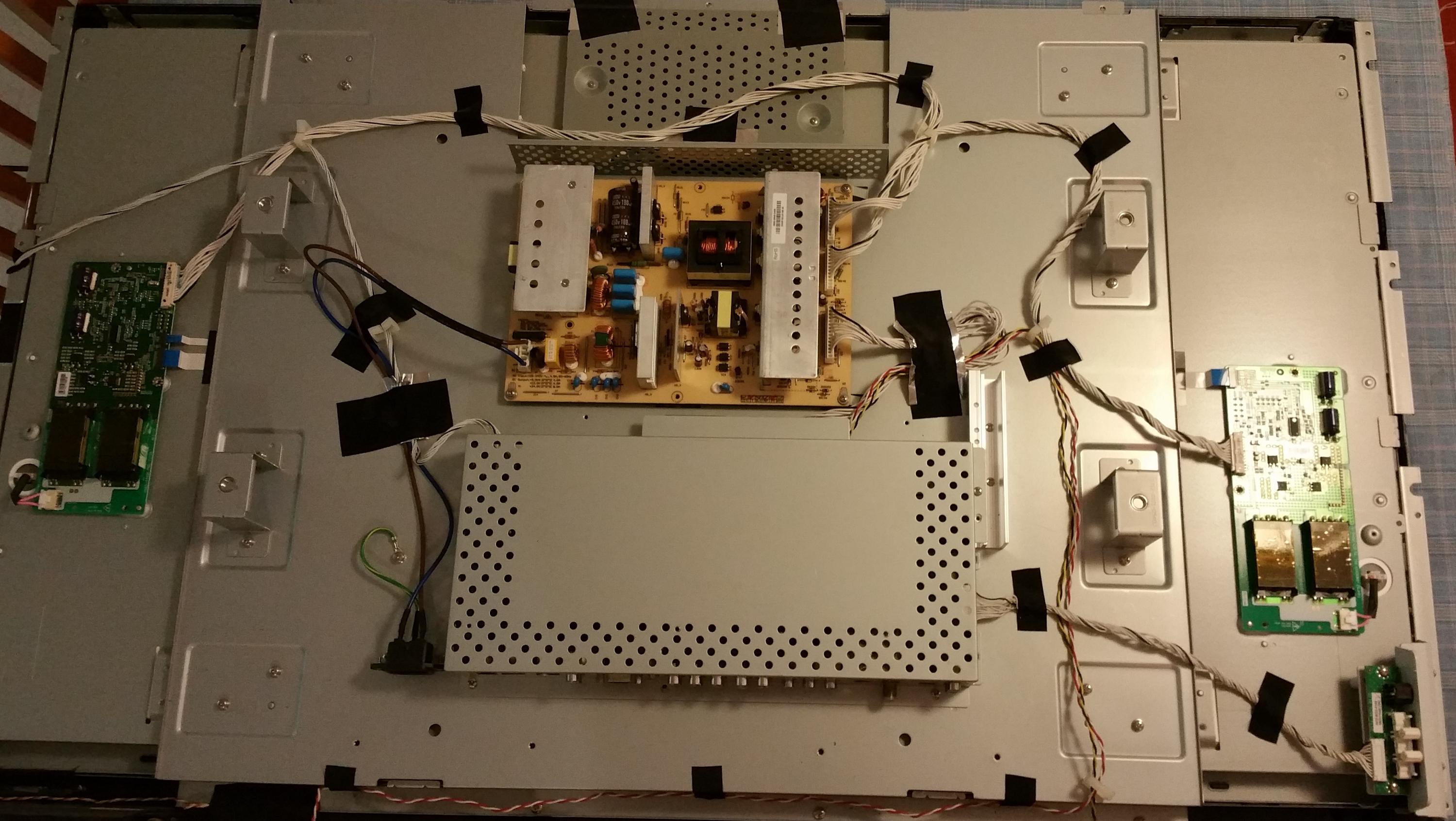

    Re: VX42LHDTV10A Power supply
    Posting pictures of the back of your tv showing the boards with clear pictures may help you more with fixing your problem

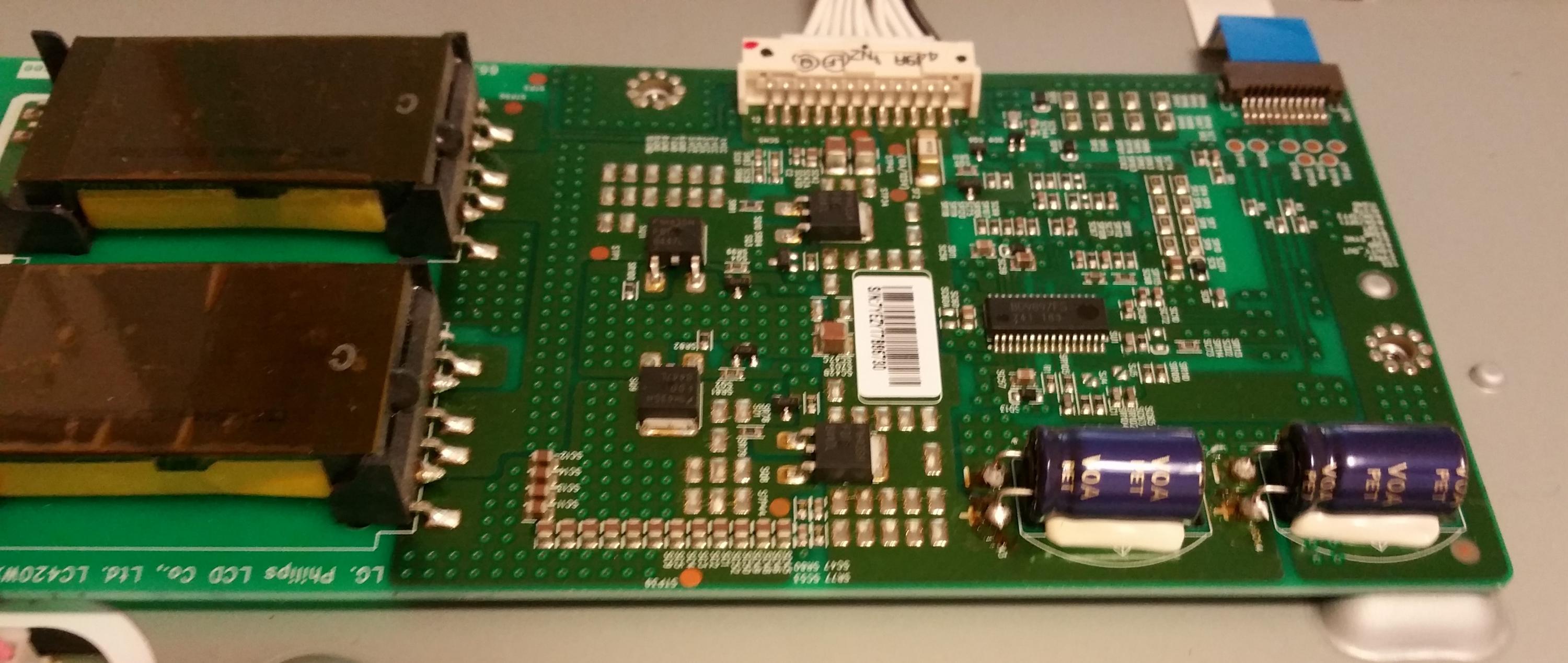

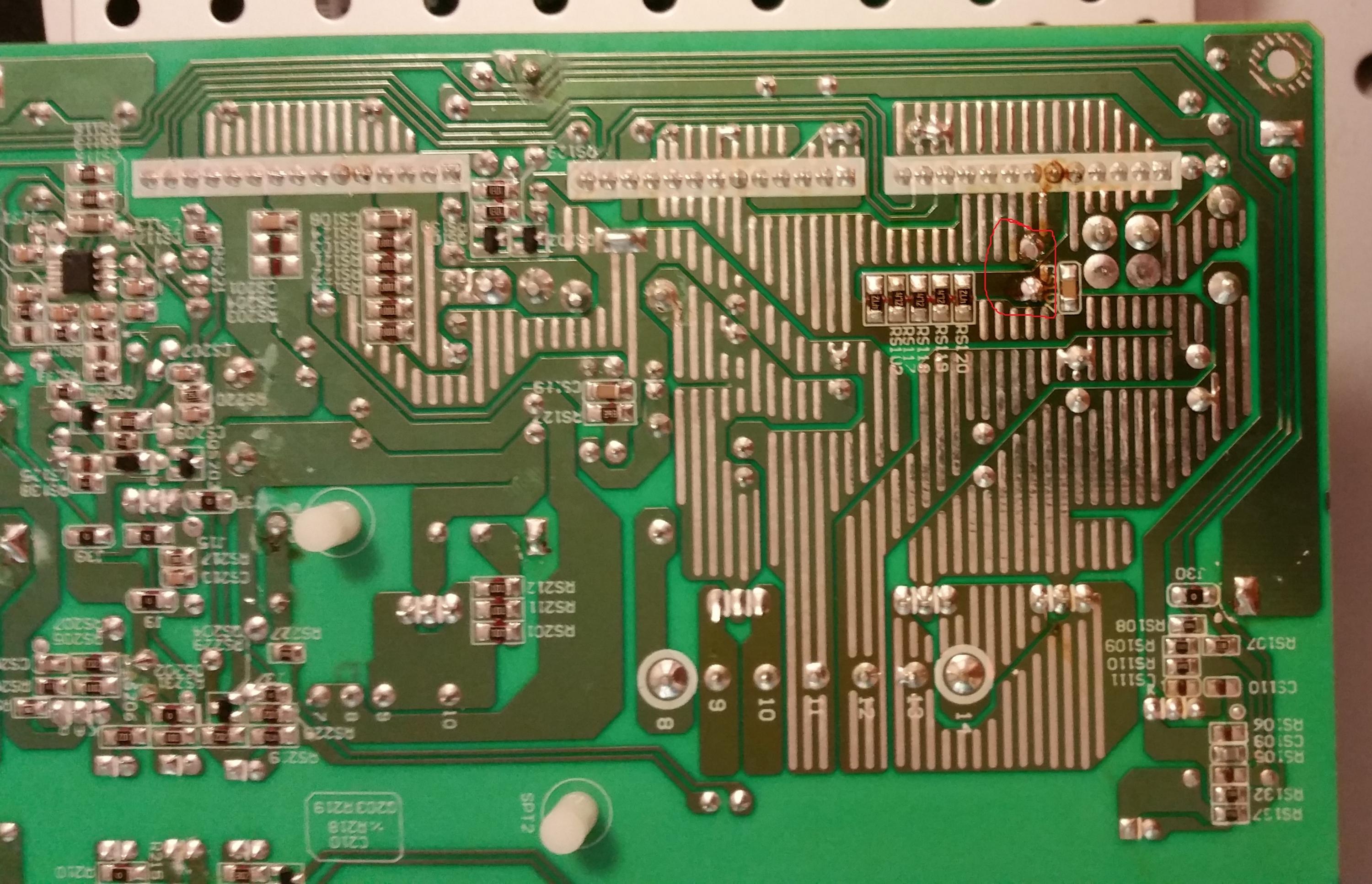

      here are the photos.
      this was a USED purchase and upon looking at the power board, the cap at CS107 was actually solder in backwards. fixed it and now the board now has 24v and 12v.
      the back-lights now flash on then off, did not before. the Vizio logo is still white.
      the unit now has a crackling,very loud sound coming from the slave inverter board. powered it off fast!!
      i would presume the caps are going bad as this unit is from 2007.
      any thoughts?
