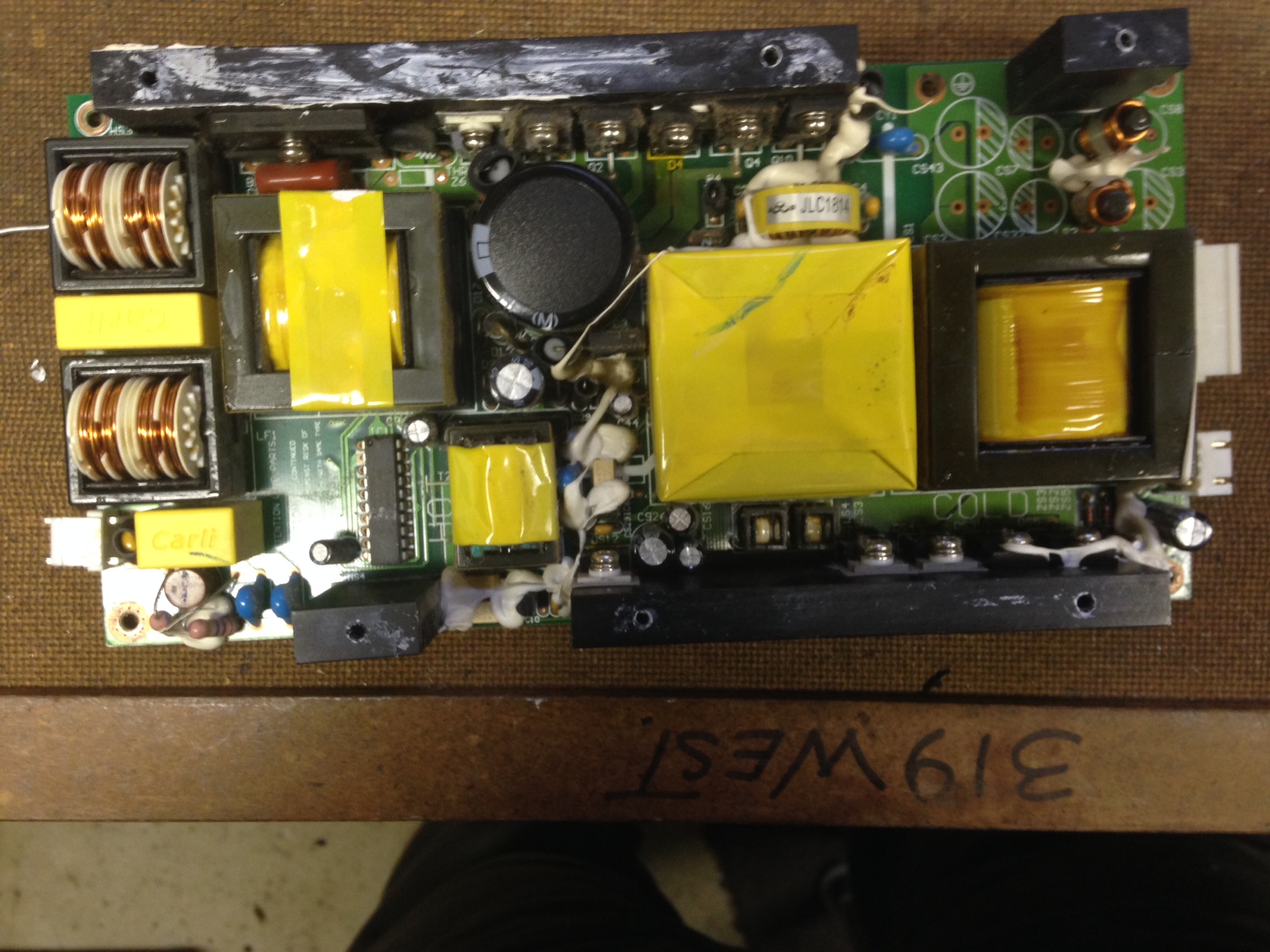

    I have this RCA L37WD12 that won't power on. the small 1W 5V stdby power supply is working. 5.1V stdby voltage is there.
    The power on signal from the scaler board is working. the small 1W 5V supply does supply 120vac to the main SMPS after hitting the power on button.
    however, at conn3, the +12 and the +24 are not reading correctly. pin 1 of conn3 reads about 1.9V instead of +12. pins 5 and 6 on conn3 read 19.0 volts instead of +24. pin 7 (blue wire) has 3.2V.

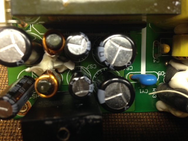

    I removed the 6 caps from the main SMPS board and have decided to replace them. they are capXon caps, 3 of them are 1000uf@16V, and the other 3 are 1000uf@35V and probably original to the board.
    I'd like to buy the Panasonic FR series from digikey. will the following caps be a good replacement?
    http://www.digikey.com/product-detai...466-ND/2433600
    http://www.digikey.com/product-detai...2CT-ND/3072212
    thanks guys.

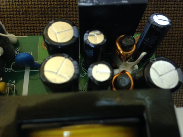

    UPDATE:
    replaced 6 caps, 3=1000uf 16V, and 3= 1000uf 35V. the caps were Panasonic FR series and I matched the exact uf and voltage ratings.
    no change in the powering on of the TV.
    stdby voltage 5.1V
    upon power on, led goes from red to green (ps clicks) and the led continually blinks green until I interrupt the power. dead set.
    AC 120V is being turned on to the main smps.
    voltages out at connector #3 are 3.6V for the +12V leg, and 21V for the +24V leg. consensus is the main smps not putting out the correct +12 and +24, right?

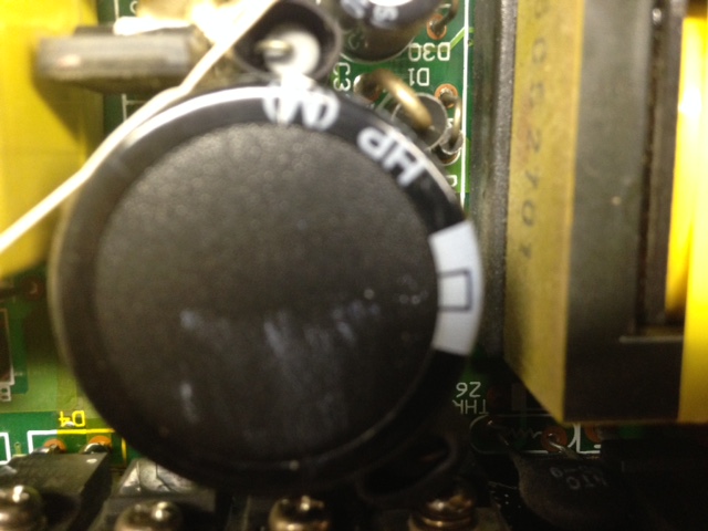

            Re: RCA L37WD12 won't power up
            Budm,
            180uf, 400V rated cap. looks like C3 in schematic. I got 360V across + and - leads. now what?

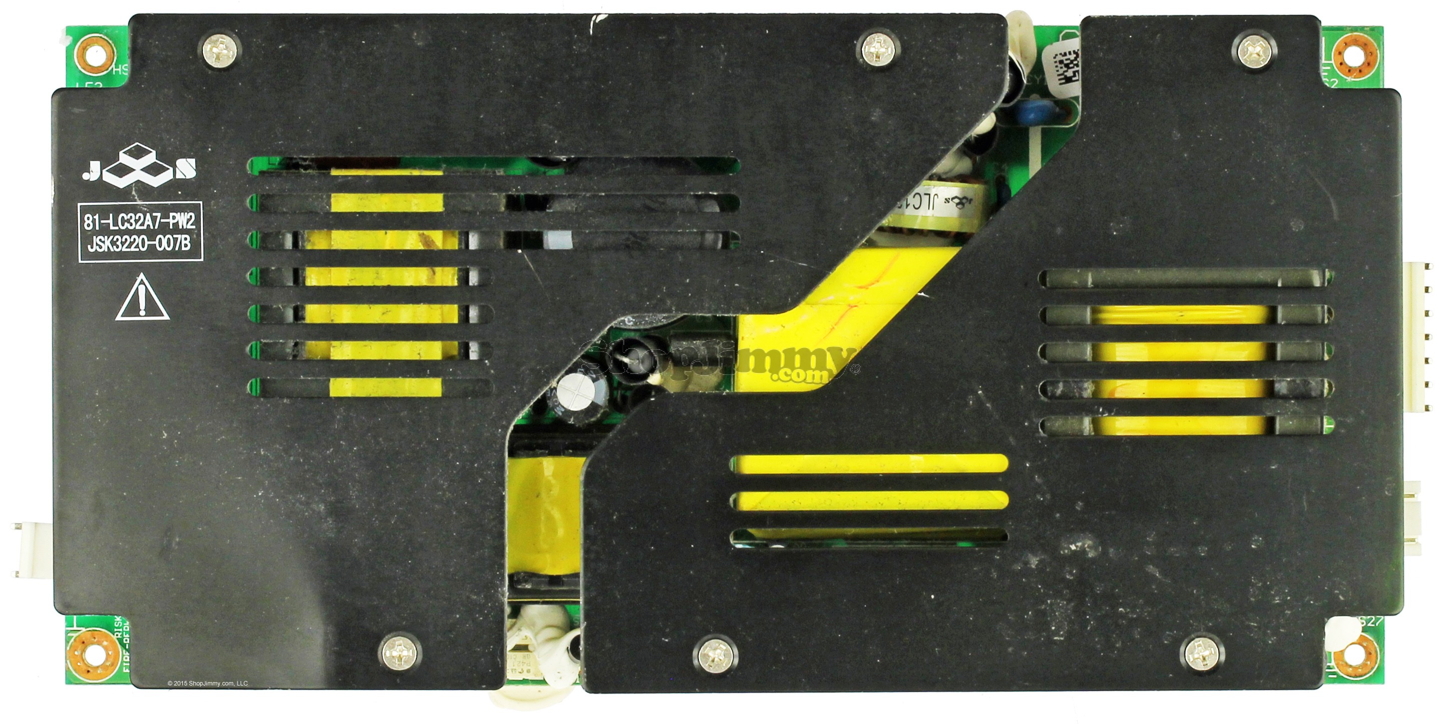

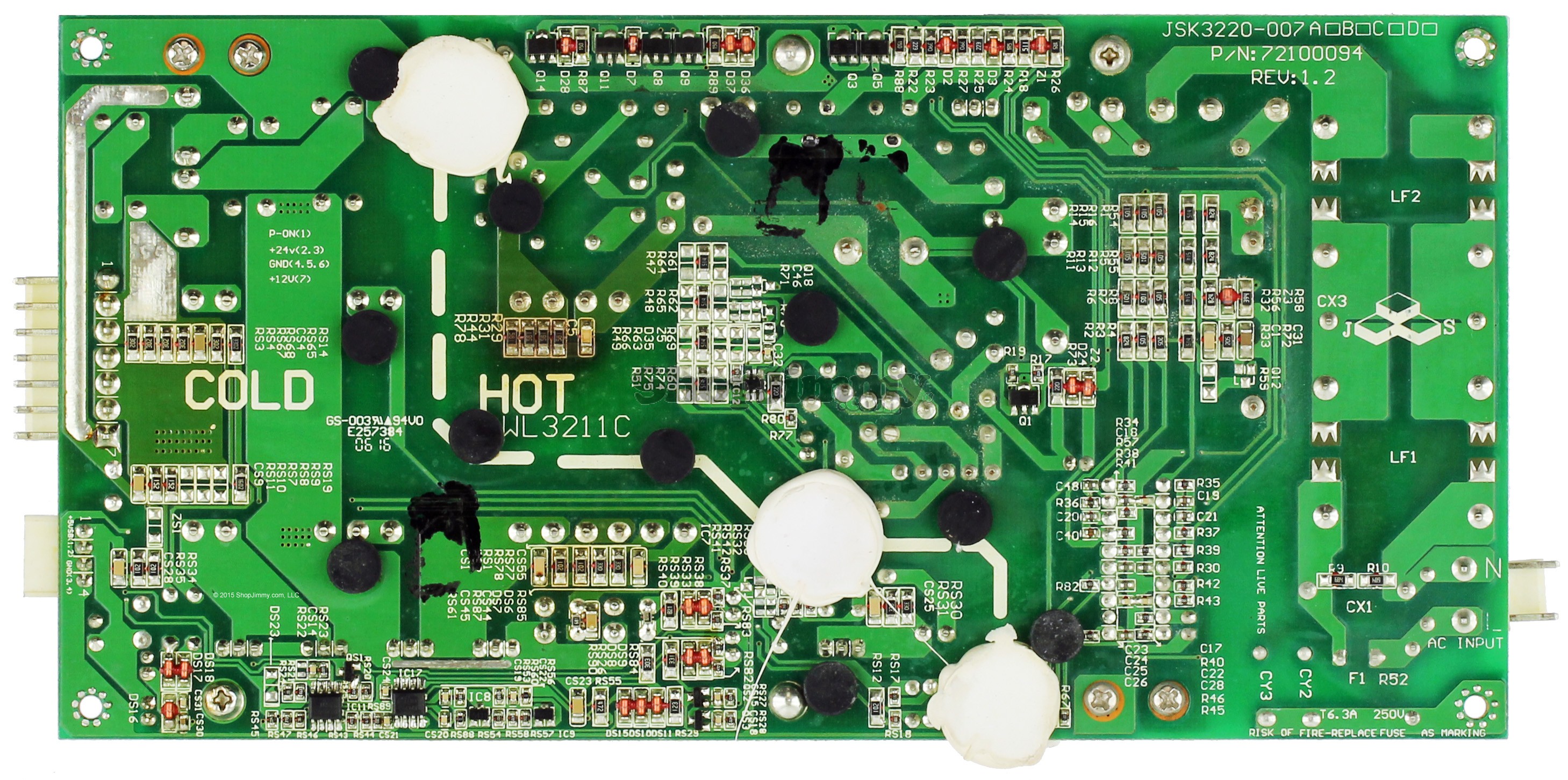

                  http://www.shopjimmy.com/rca-272062-power-supply.htm
                  Is this the one you have?
                  RCA 272062 (JSK3220-007D, JSK3220-007B) Power Supply
                  Pictures provided by shopjimmy
                    Budm,
                    Yes, That's the one. I was going to try and get some voltage readings on the cold side of the T1. not sure what to expect. the schematic I have does not show voltages except for the output of the +5, +12 and the +24. just give me a place to start.
                    thanks,
                    ilikesteel
                      Originally posted by ilikesteel
                      Budm,
                      thanks,
                      ilikesteel

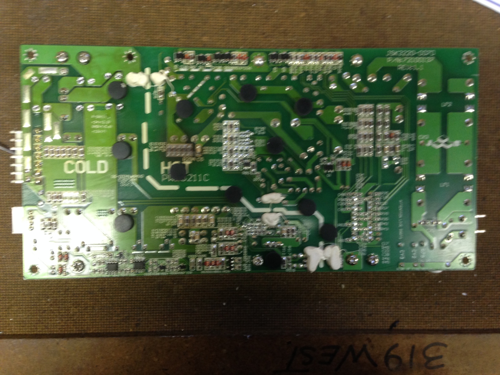

                      OK, good, now I have good picture of the bottom side of the board from SJ for me to trace the circuit, but I do need good hi res straight shot of the top side.

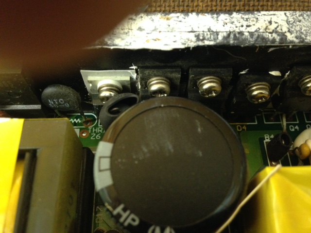

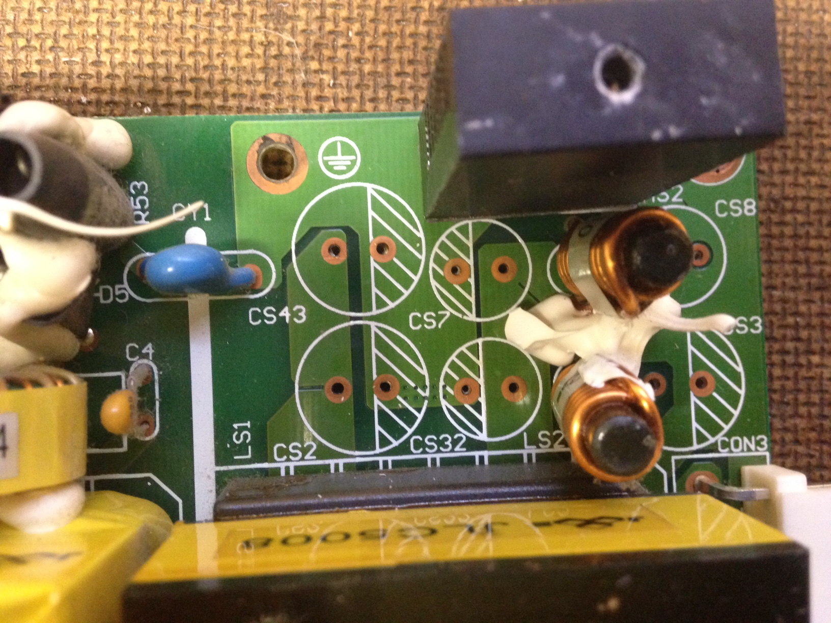

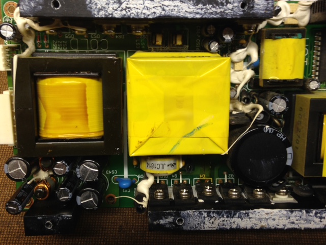

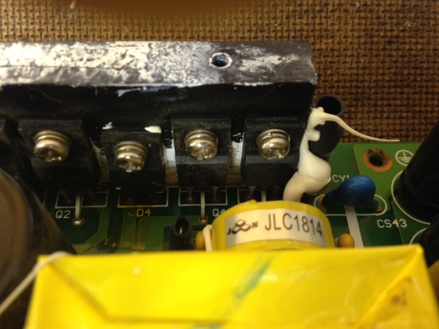

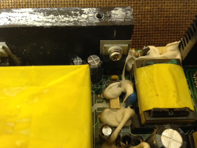

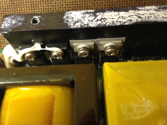

                        Budm,

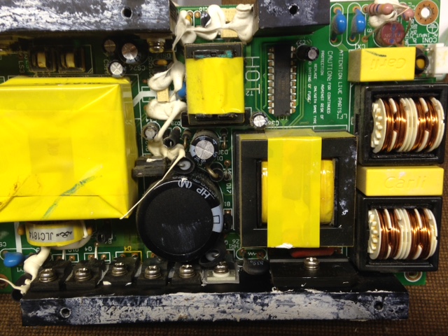

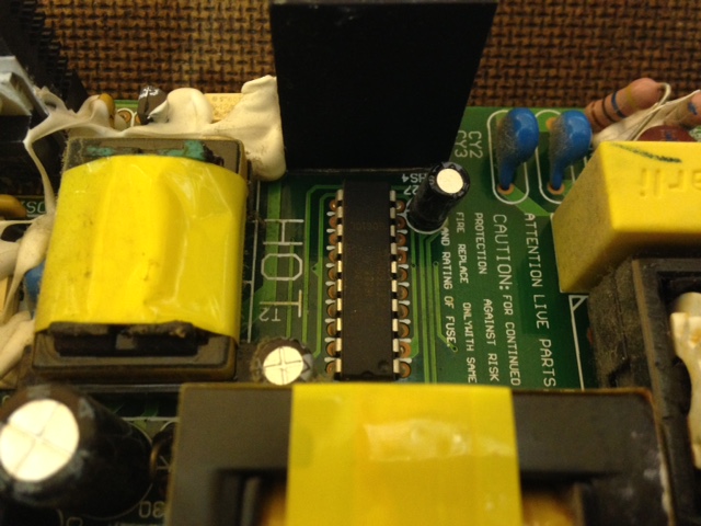

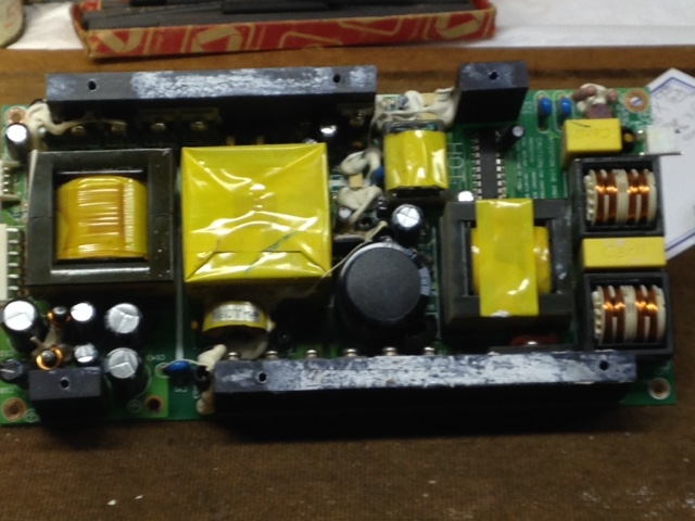

                        The very 1st pic on post 1 is of the top of the board. I just took some pics of the board in sections trying to get some close ups. I also tried to identify some of the components mounted to the black heat sinks on both sides of the supply.
                        The following are mounted on the black heat sinks. some are isolated from the heatsink.
                        Q2, Q4 and Q10 are all FOPF 13N50C
                        D4 N6D-FSU10A60
                        DS3, DS5 MBR-20100 FCT AKA ac0160 (?)
                        DS2,DS4 MBR-20150 CT AKA AC0529
                        could not quite read Q12, but it's marked with SIRECT MBR -xxxxxxx
                        most are marked with the name SIRECT
                        IC1 INFINEON
                        TDA 16888
                        P V0617601K15
                        G0610L
                        T1 BCK50298S
                            I did not get any where with it last night, I spent over an hours looking at the pictures, the board is really crowded so it hard to trace the connections.
                            BTW, you can see over heated SMD resistors/cap for the snubber drive circuit.
