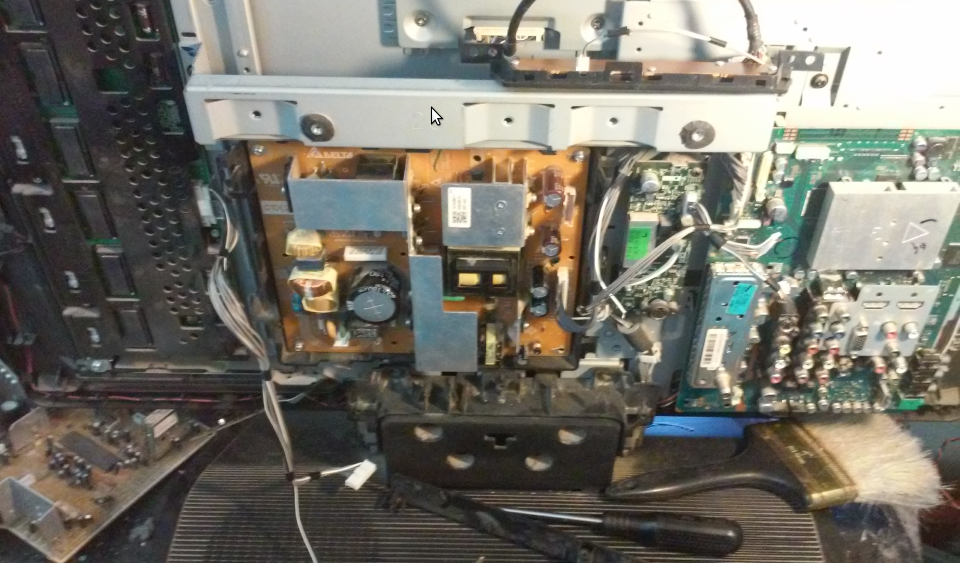

            Are you also missing the BL-ON and DIM commands to turn on the backlights?
            Can you provide pictures of the whole back side of the TV so we can see all the boards?

              Here's your picture of the boards, sorry it's kinda crappy.
              No BL_ON, no ADIM, no PDIM. Not even for a second.
              I thought I was close to what may have been a short but now I'm not sure. I was getting a reading of 10 ohms across a coupling cap and ground. I found that the source is IC7005 pin 13 which says Vout. The voltage branch is called D3.3V. Every part of this branch reads 10 ohms to ground but considering this is only 3.3V then that would only be around 300mA which may not constitute an actual short, 10 ohms is probably just coming from all the stuff sharing the circuit. Your thoughts?
