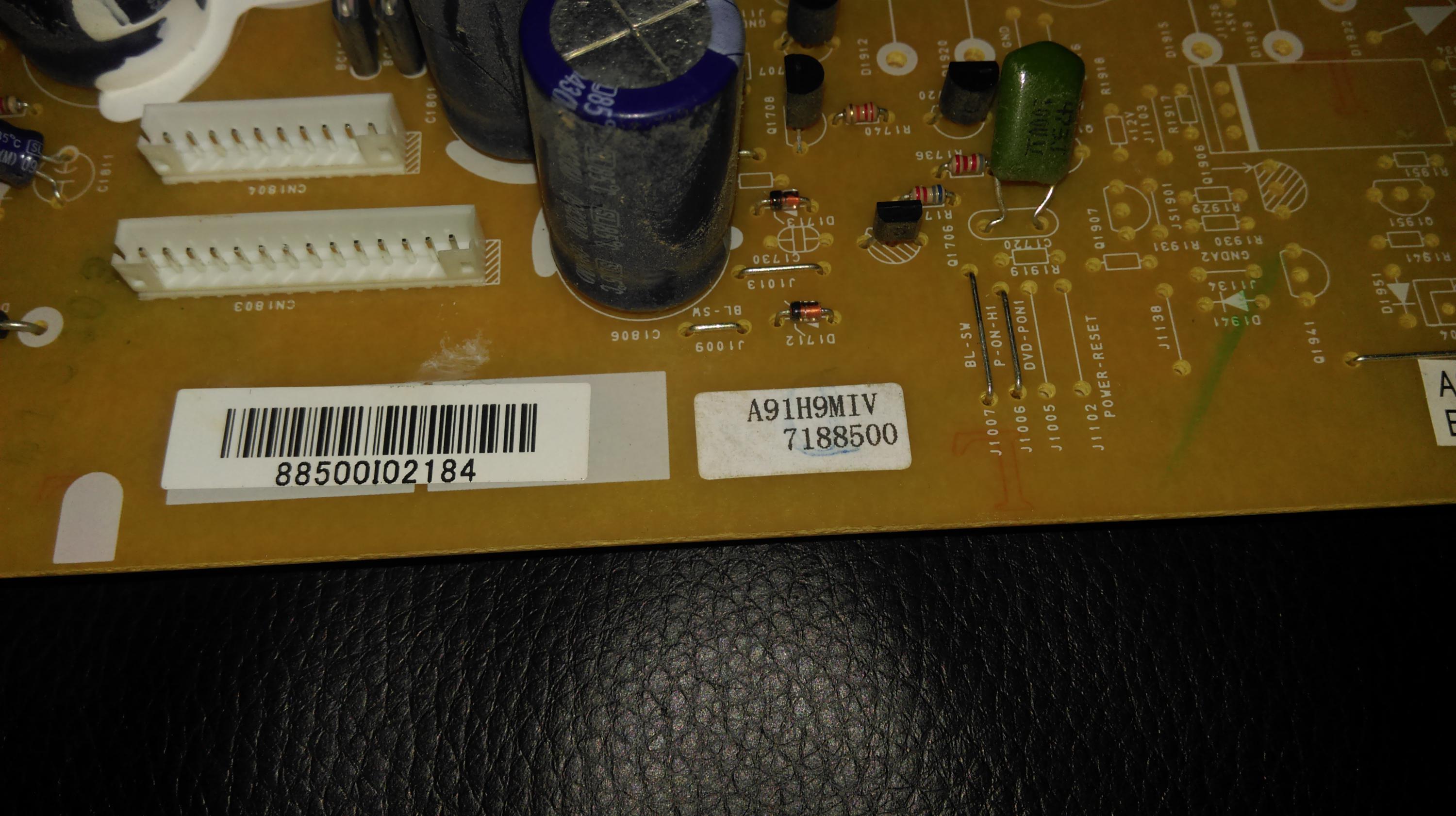

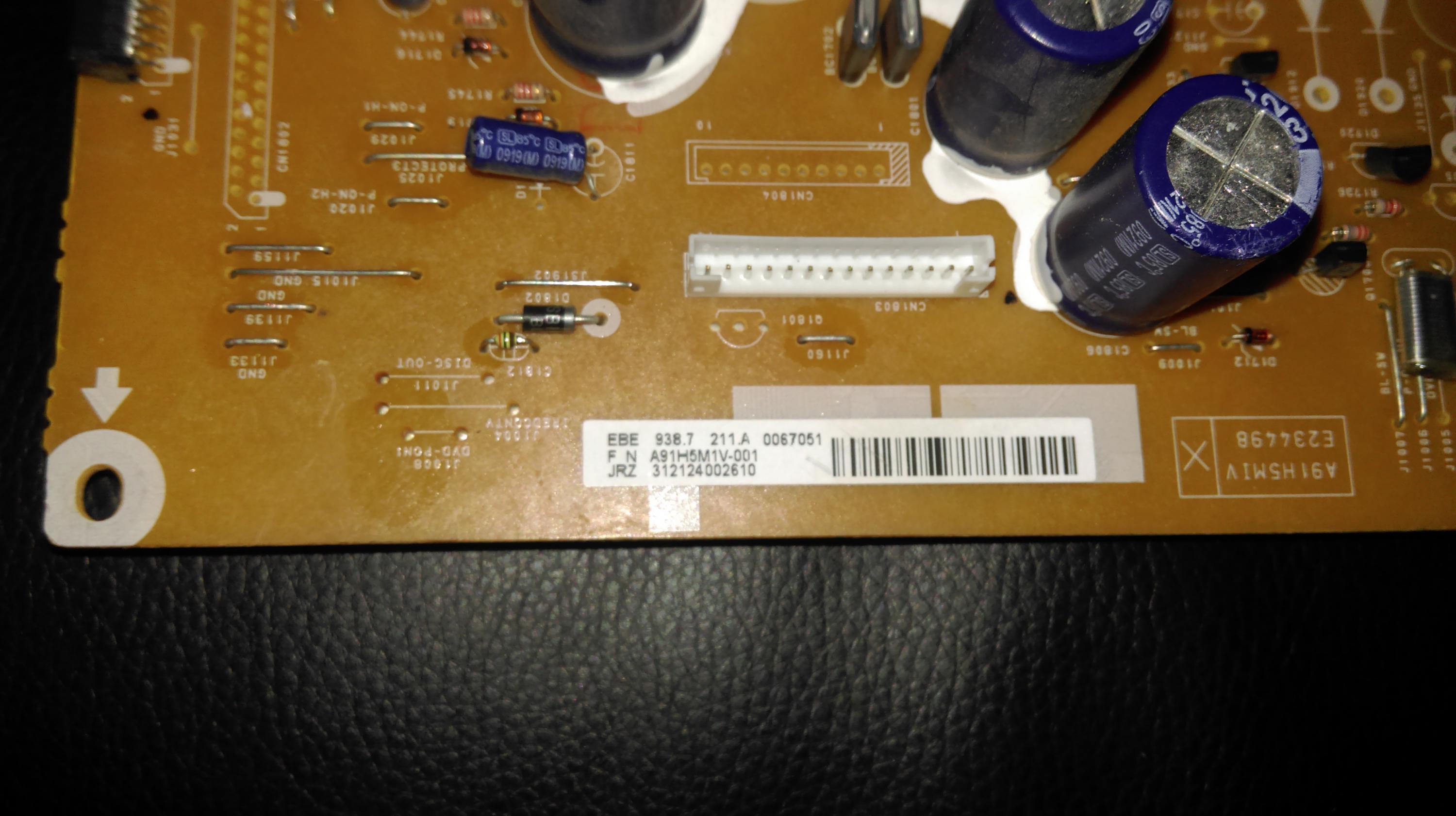

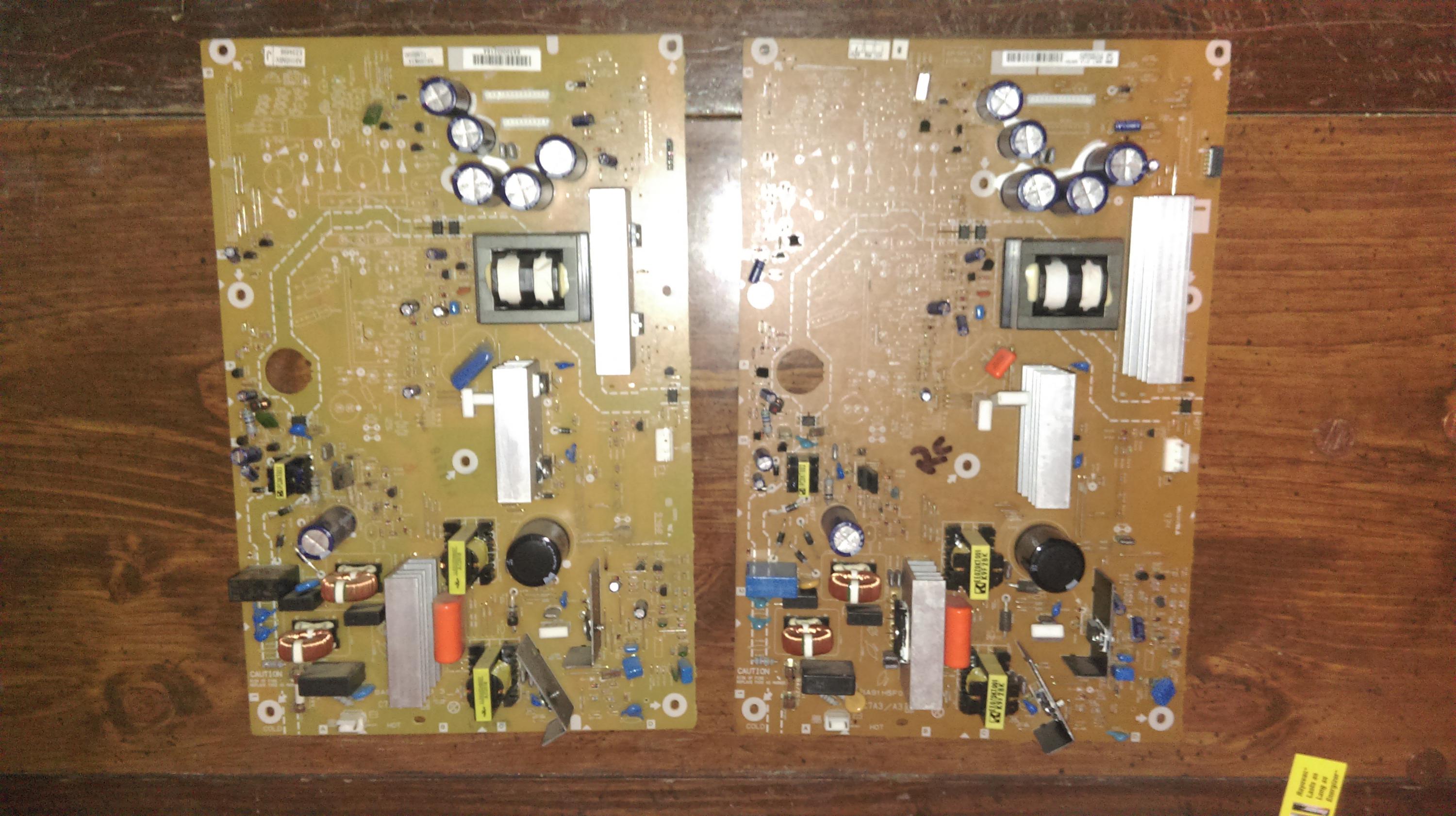

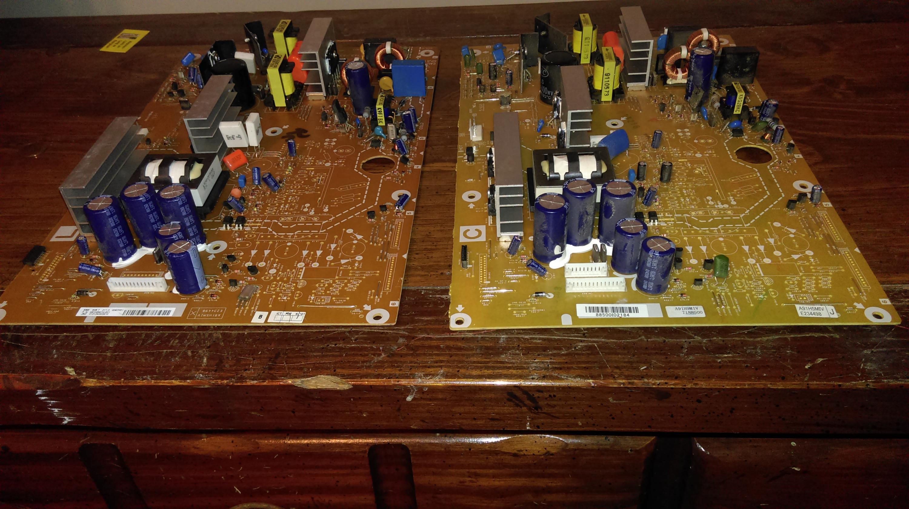

          Here's another question for you. I ordered a power supply board off eBay. When I received it I noticed that it was missing one of the connectors. The board I needed was aA91H9MIV. The one he sent was a A91H5MIV. He assured me that they are compatible. These are pictures of the differences between my board and the one he sent me.
          The one he sent me doesn't have a CN1804 connector on it. Can I use this board without that connector?

            Re: Problems with Phillips 42PFL3704D/F7
            Is that connector used in the original set? If not and the board looks the same it can't do much harm.
            • Phydoux
              • Aug 2012
              • 83
              There is a harness for that connector on my set. Trying to dig up the service manual to see what that connector does.
              Looks like there are +24 volt and Ground connectors on it. Probably for more devices or whatever included with this TV.
              CN1804 is part of the LCD Module Assembly PH CONNECTOR TOP 10P B10B-PH-KS(LF)(SN). Sounds pretty important...
