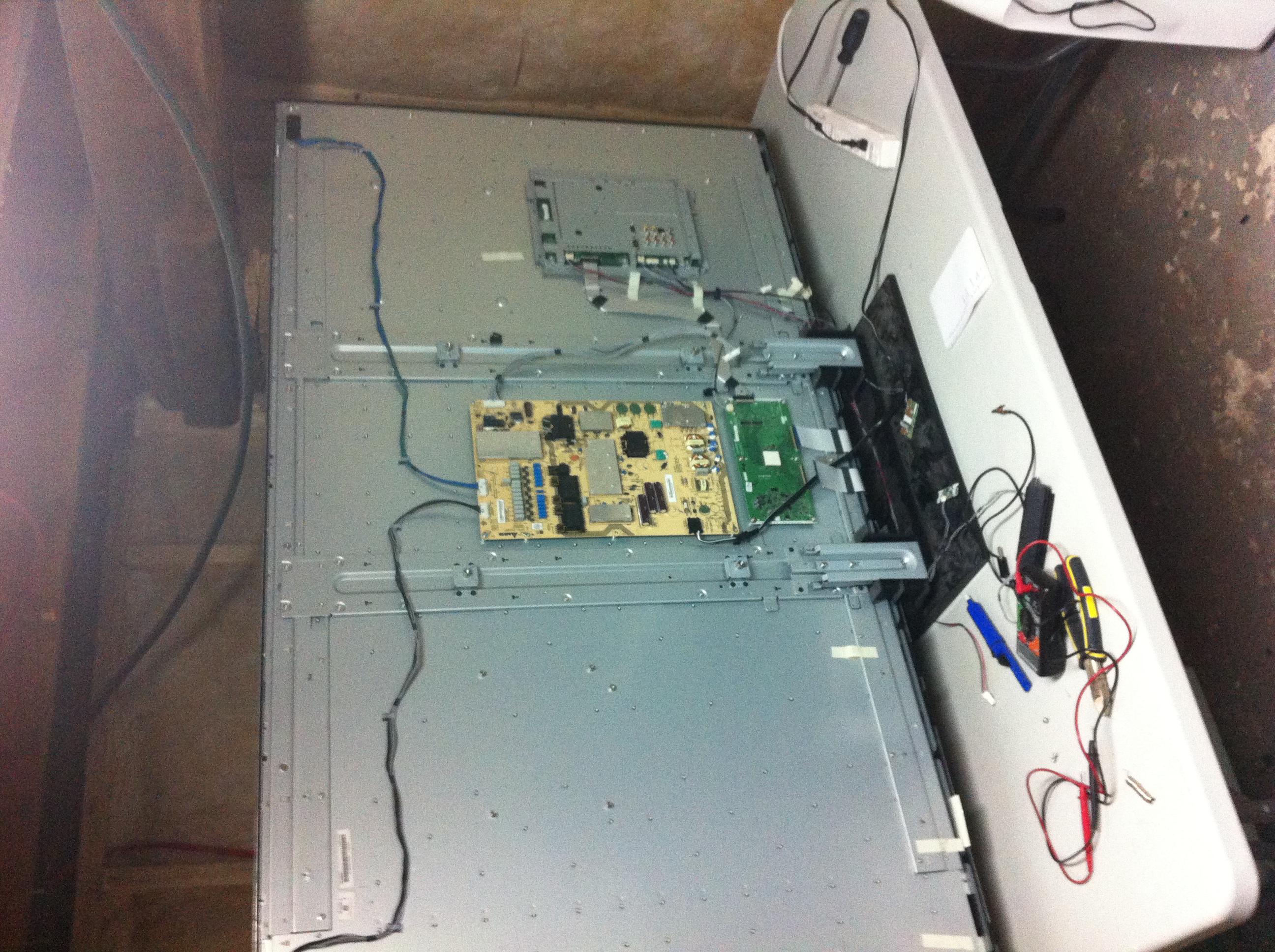

    I took the back cover off, downloaded the service manual - popped the front screen off and tested all the LED's - I was expecting a few mini light bulbs... and almost wet meself when I saw over 400 LED's - I used a 48VDC source to test 5 or so at a time using the TP's on the strips. they all lit up nicely.

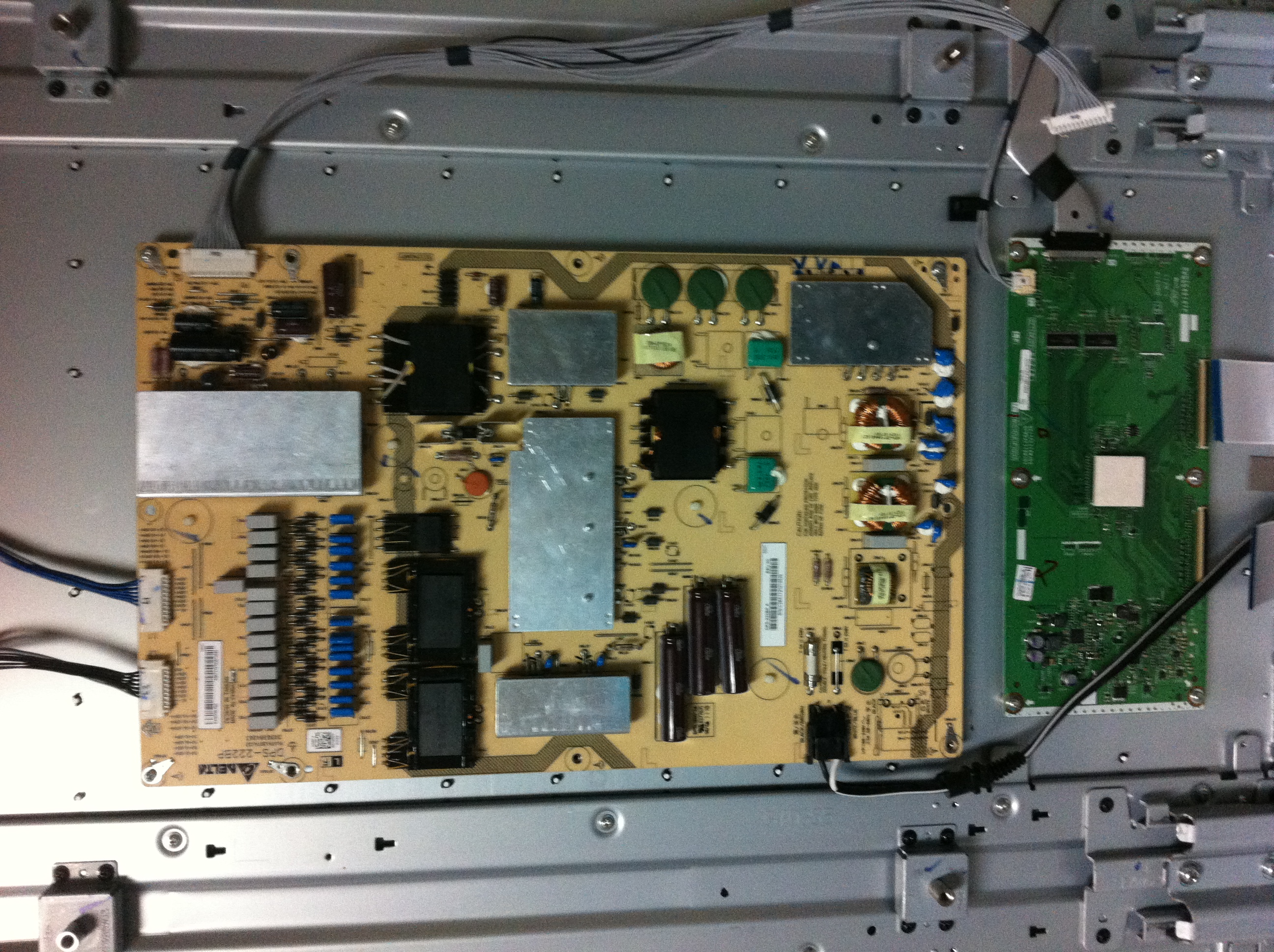

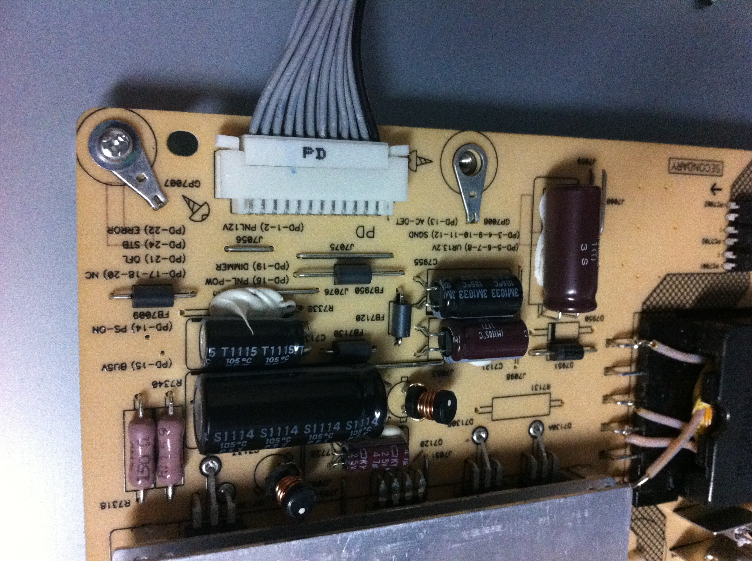

    I then disconnected the cable between the PSU and the main board - jumped the PS-ON to BU5V and PNL-POW (so the 3 connect together) the PSU comes to life - no LED action from doing this.

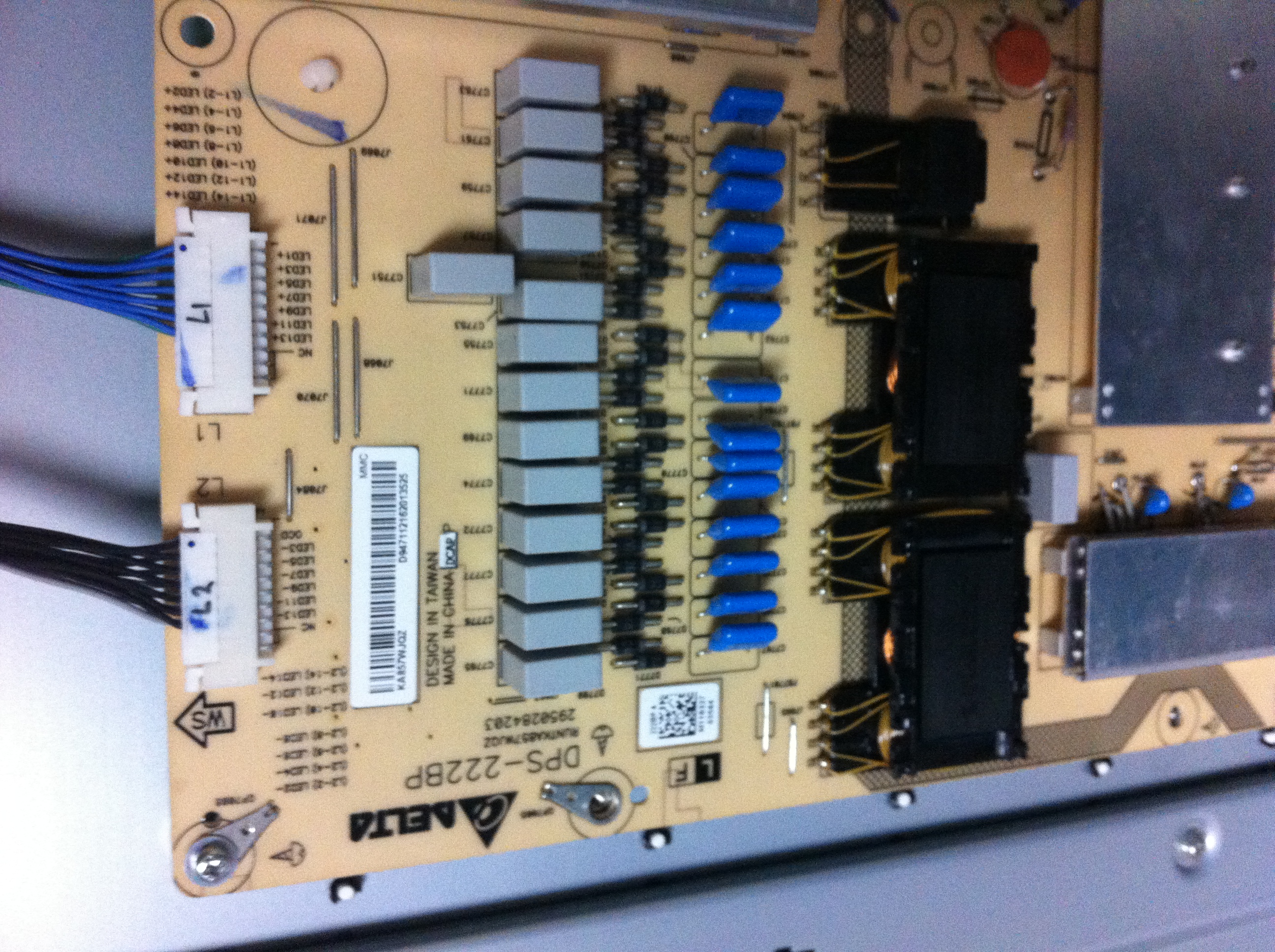

    There is a PIN labled OFL which I don't know what it means and would like to understand it's function. when the PSU is on, there is 700+ AC volts on the primary side which got me all excited. from my random testing there is no pwr going to the transformers for the LED's, I can't find what kicks on the transistors for them. I get no voltage from the STB pin at any point.

    Now I must confess that I damaged the front panel when taking it off - who knew it was a bad idea to do so with the tv upright. I have disconnected the 2 big ribbon cables that connect to the TCON (if thats what it's called) board for all of my testing. I realize this TV will never be used again, and to be honest it's far to big for any normal house. But it does offer a great test lab to learn from.
    So my question is - how to force the backlights on - i get all the right voltages based on the pins including PNL 12V on pins 1 + 2 but whatever tells the lights to come to life has been eluding me.

    Here are the pics

      Looks very similar to
      https://www.badcaps.net/forum/showth...t=50663&page=1
      Only difference I see is the led power on yours having two outputs.
      For a reference
      pd-19 2.5 to 3.xx V depending on dimmer settings( backlight)
      pd-21 OFL 1.6V
      What tells the light to come up is still a partial mystery to me, but that main board sends some signal back over that way based on my experience.
