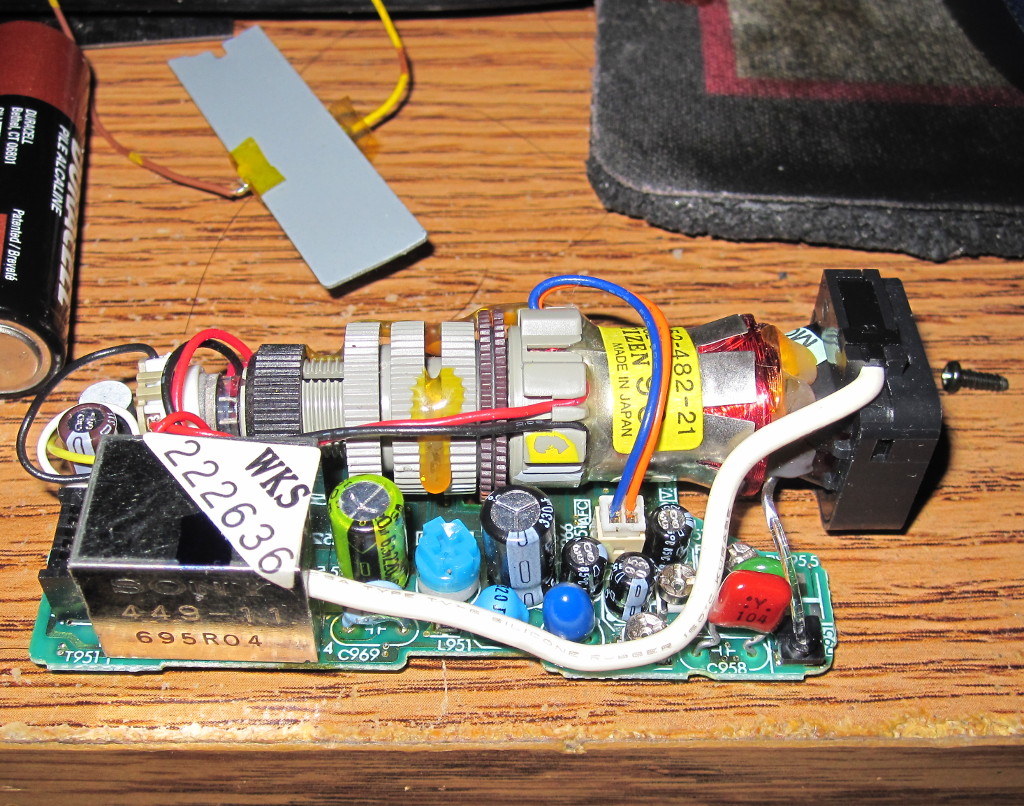

          Re: Lost cause, useless Sony CCD-V99 CRT and Record?
          For viewing pleasure,
          https://www.badcaps.net/forum/attach...1&d=1451870492
          That's an AA battery to the upper left.
          I do wonder if the video going to this thing is NTSC or not, or if video goes to this display and then back down to the record unit. Kinda dumb if it does but it would be nice... The ribbon cable has 5 wires on it, it seems... Other than the record light, still seems a bit more than needed?
          This camcorder is still quite complicated, looking at the 8mm cassette deck, it's quite intimidating. Not sure how to open it to view the rest of the electronics now...

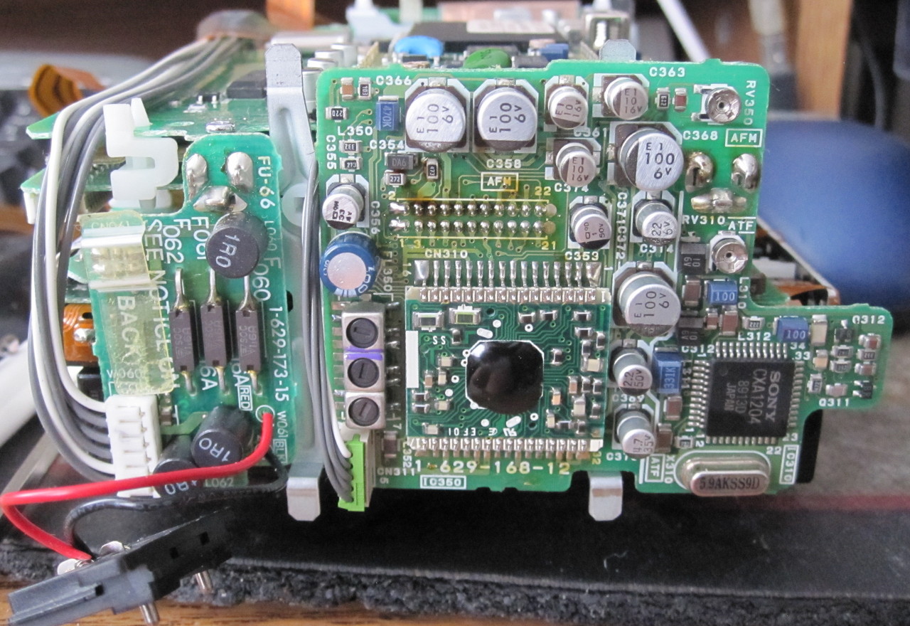

                          Finally tore down the camcorder so I can actually see the boards in it...this thing has boards and wires everywhere...
                          Wow, are there ANY caps that are still good on this unit? A quick check with my ESR meter on the tons of small SMT electrolytics... they are ALL bad! Has anyone found this to be the case on these handycams of this era? I simply can't believe it! That'll be quite a bit of work to replace all of them (plus I don't have parts... jury rigging a through hole is going to be a PITA.)
                          A bunch of 6V 22uF
                          35V 4.7uF
                          6V 100uF
                          Here's one board:
                          I was spot checking the caps and found just one of the 4.7uF 35V have 4 ohms ESR! (I couldn't get a reading on any of the caps on this board.)
                          I hope it's just a problem of me piercing through the conformal coating but this is pretty depressing.

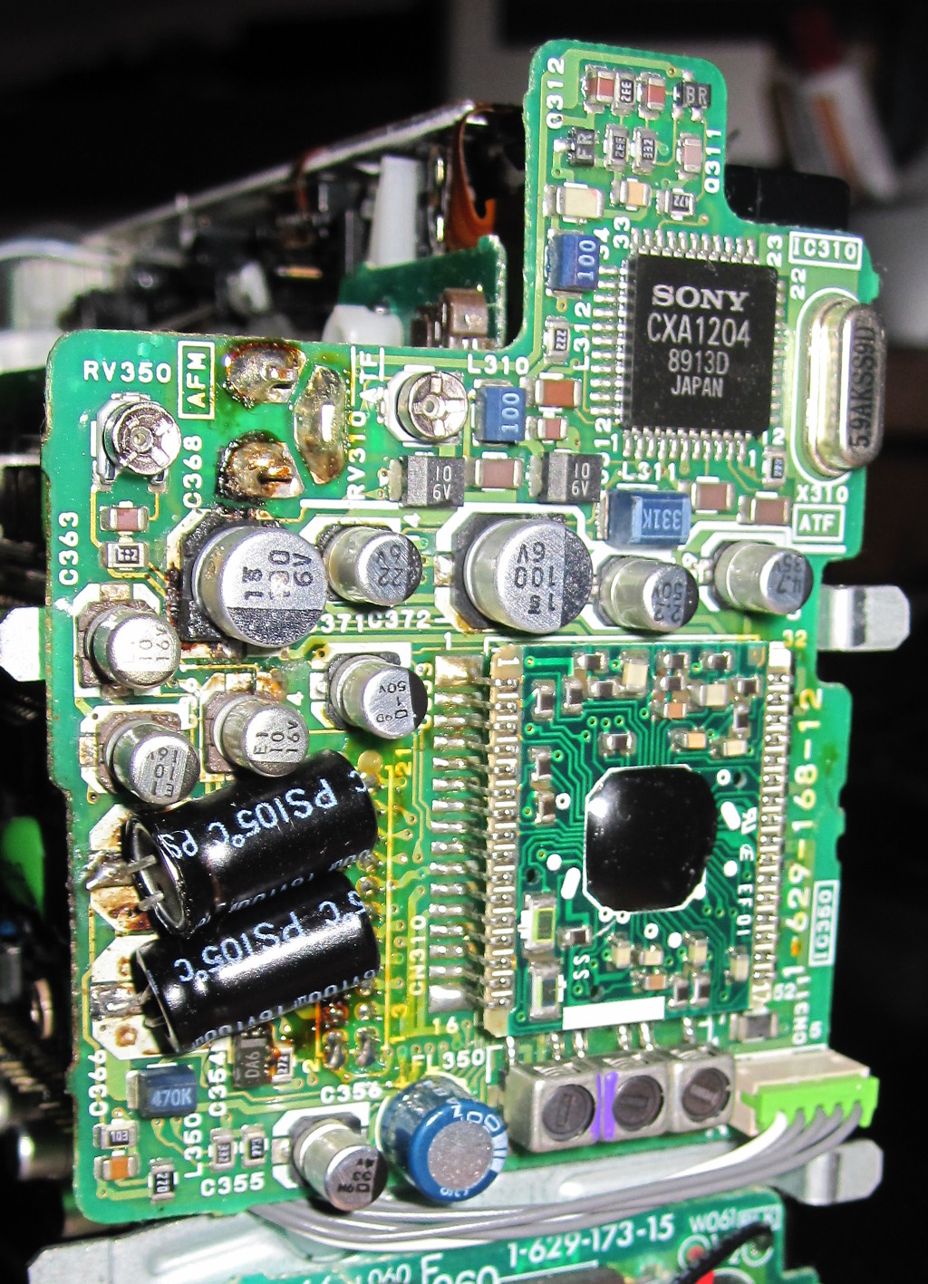

                            Oh gawd that fishy stench! Well I used my hot air rework and pulled off a few of the 100uF caps... The board when not heated didn't really smell like much but when heated, peee-yeew.
                            I measured two of the 100uF caps out of circuit:
                            C354 1nF, ESR > 5 ohms
                            C358 31uF, ESR > 5 ohms
                            C368 2uF, ESR > 5 ohms
                            C372 1uF, ESR > 5 ohms
                            It's no wonder things don't work...
                              Okay...I found two 100uF SMTs I swiped from another device and stuck on two through holes...and you can see what the problem with the through hole capacitors exhibit:
                              I might have to go remove the two through hole 100's and swap them with SMT again when I find more ... they're in the way
                                I removed those two through hole caps and put in two 100uF tantalums taken from a dead HDD, and replaced a bunch of the 10uF caps swiped from an old CDROM drive... I got a bit tired of looking at this thing as I don't have schematics or parts to replace the massive number of bad caps that I saw so I decided to button it back up.
                                As from another post... had a bit of a heartache when the thing was completely dead when I hooked everything back up. Ouch. Screen was white out with a thin line down the side. No blinking "no tape" symbol. I seemed to have killed it, it's now worse than before!
                                Discouraged, I took everything back apart and carefully reconnected the rat's nest of wires. I've always hated those flex cables, but tried reseating them carefully. As I grew weary of this device I reassembled it and put all the screws back in too. Luckily no extra screws out of the boatload that came out of the device. At least that's a good omen, then again it could go both ways.
                                Well not much hope as I knew that back PCB was a bit fried from the hot air rework, I still had to know if it's really dead or not. I held my breath and powered it up again... Again it white out, but after a moment a bit of fuzziness in the CRT showed up... but this time everything came back up! Still not great, still have caps in there that need to be replaced alas no parts available. But the acid test: I tried recording something from the CCD as that was the problem I was seeing before...
                                Just as before it looked like it was recording...recording... After a few minutes I stopped it and switched back to VTR mode, rewind. And gingerly pressed the "play" button.
                                A bit of static showed up on the screen.. That wasn't too far off from last time I tested, but a moment after... A picture showed up! Wasn't perfect, was a bit of fuzziness but it showed up!
                                Well I can't say this was totally a 'victory' but at least this camcorder is no doubtedly working better than when I got it - it can record and I can see what's on the CRT. Alas this gets put back on the shelf for a bit. Or at least when I can get enough caps to swap the rest of them, including the ones buried deep on the boards.
