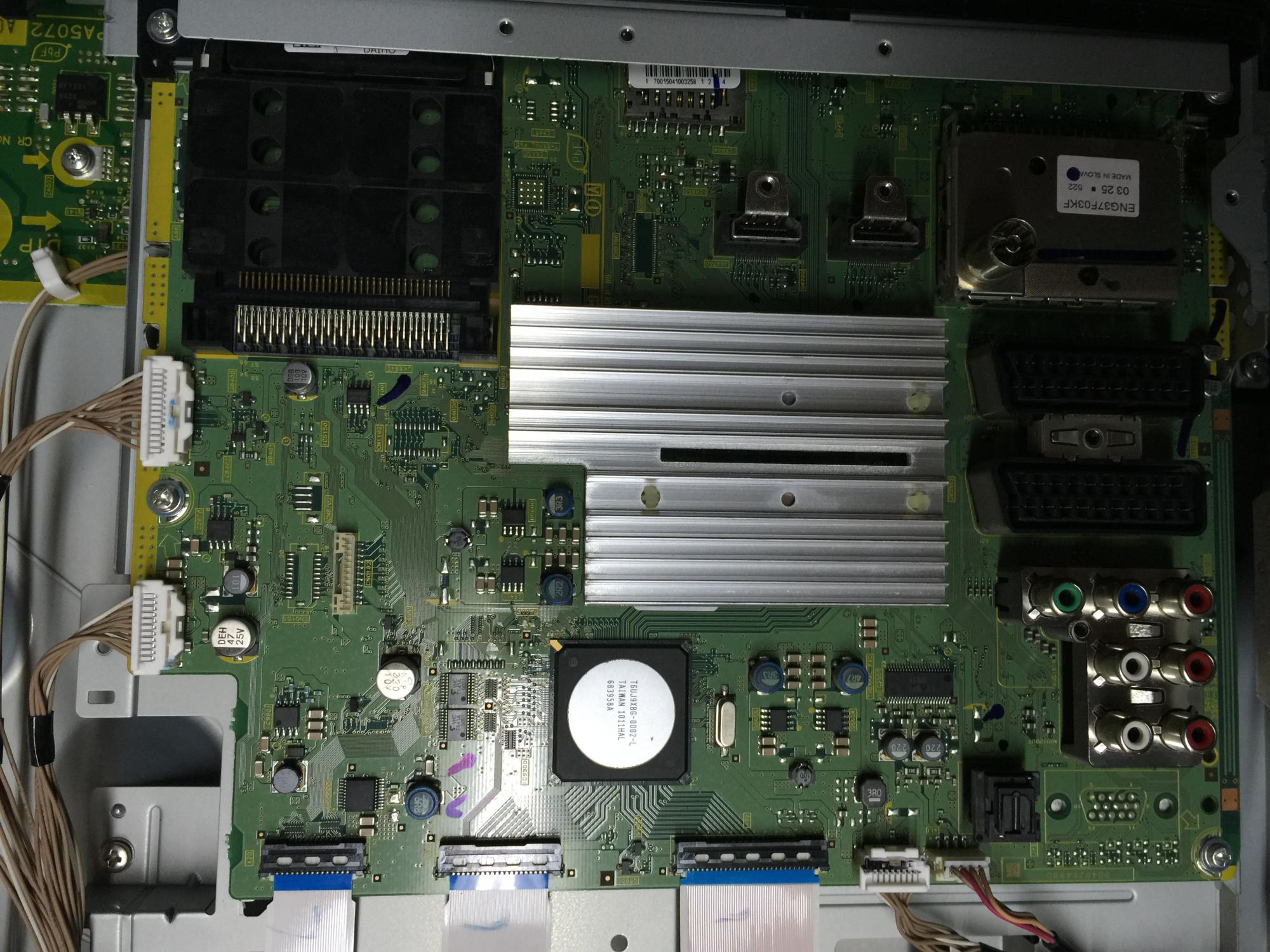

          For the A board, it's TNPH0829ME or TXN/A1LWUE to search for.Don't go by just TNPH0829 or because there'll be several versions for different sized TVs

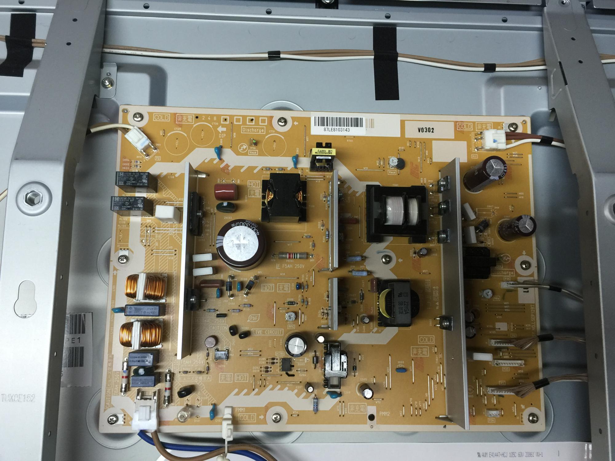

            Re: Panasonic Plasma 13 blinks no image. HELP!
            Image P-board
            • tonisanchez8
              • Dec 2015
              • 6
              • Spain
              Image A-board

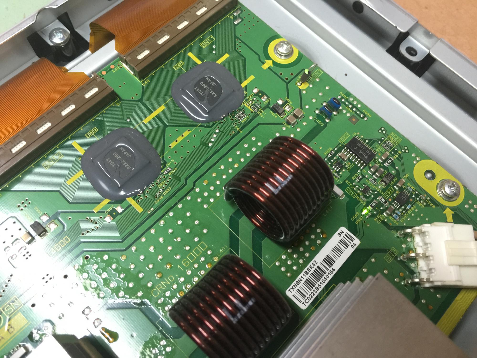

                      This is my Sn-board
                      When the tv fault the green led on the sn-board no light.
                      And I remember you... When i put On my tv for the firts time, she's run ok. I close and push again On... NO WORKS.
                      P-board or A-board? Or any component?
                      Thanks!!!
