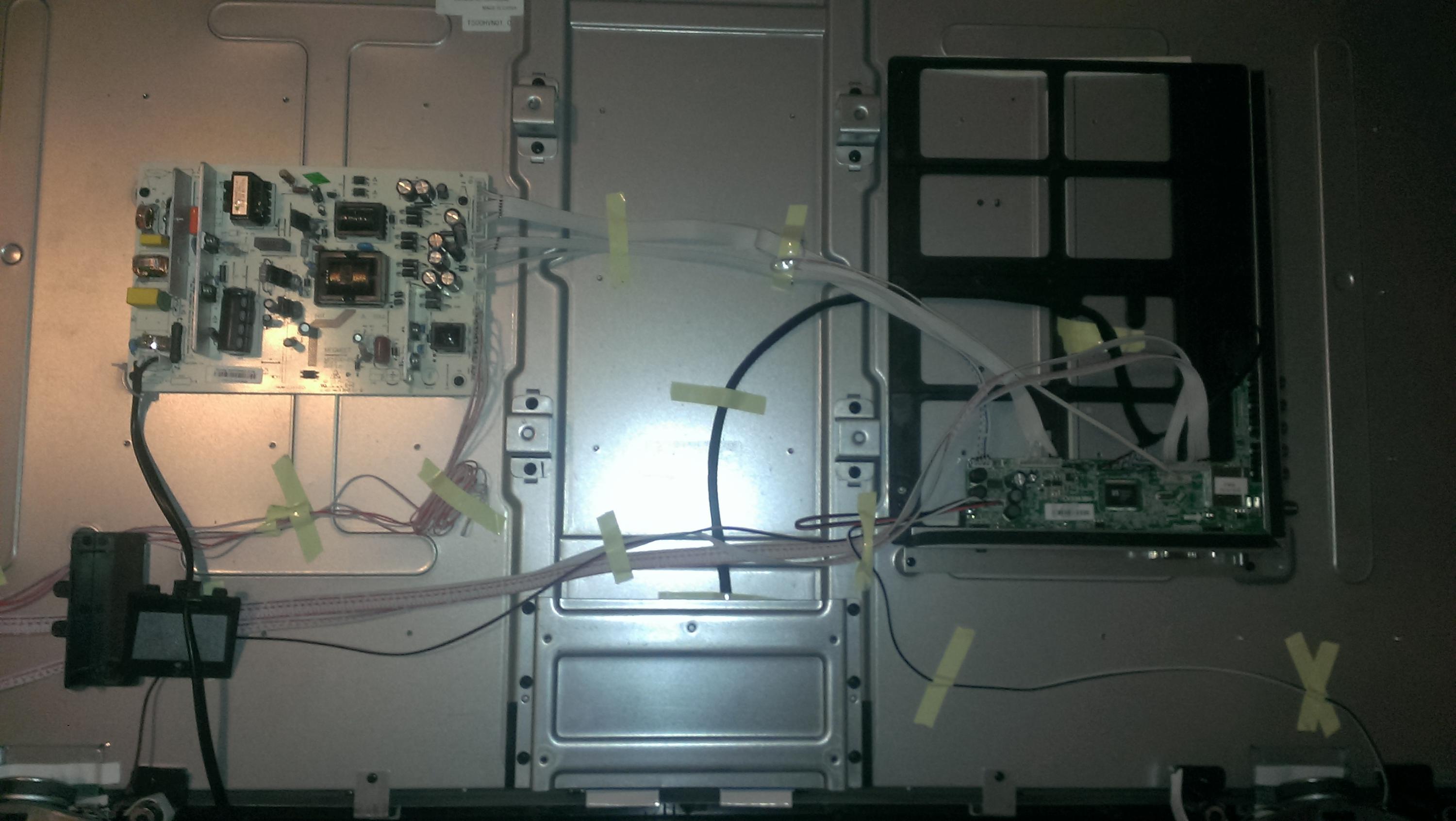

    Re: Seiki SE50FY10 sound no picture, NEW main board

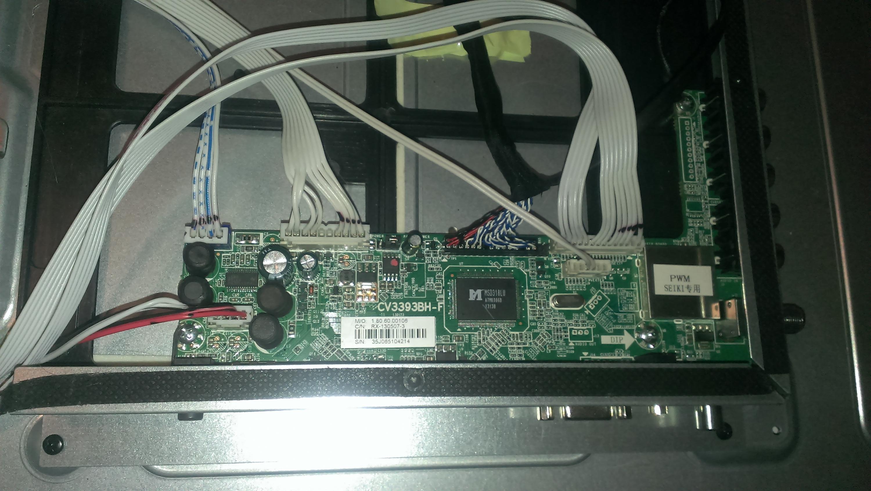

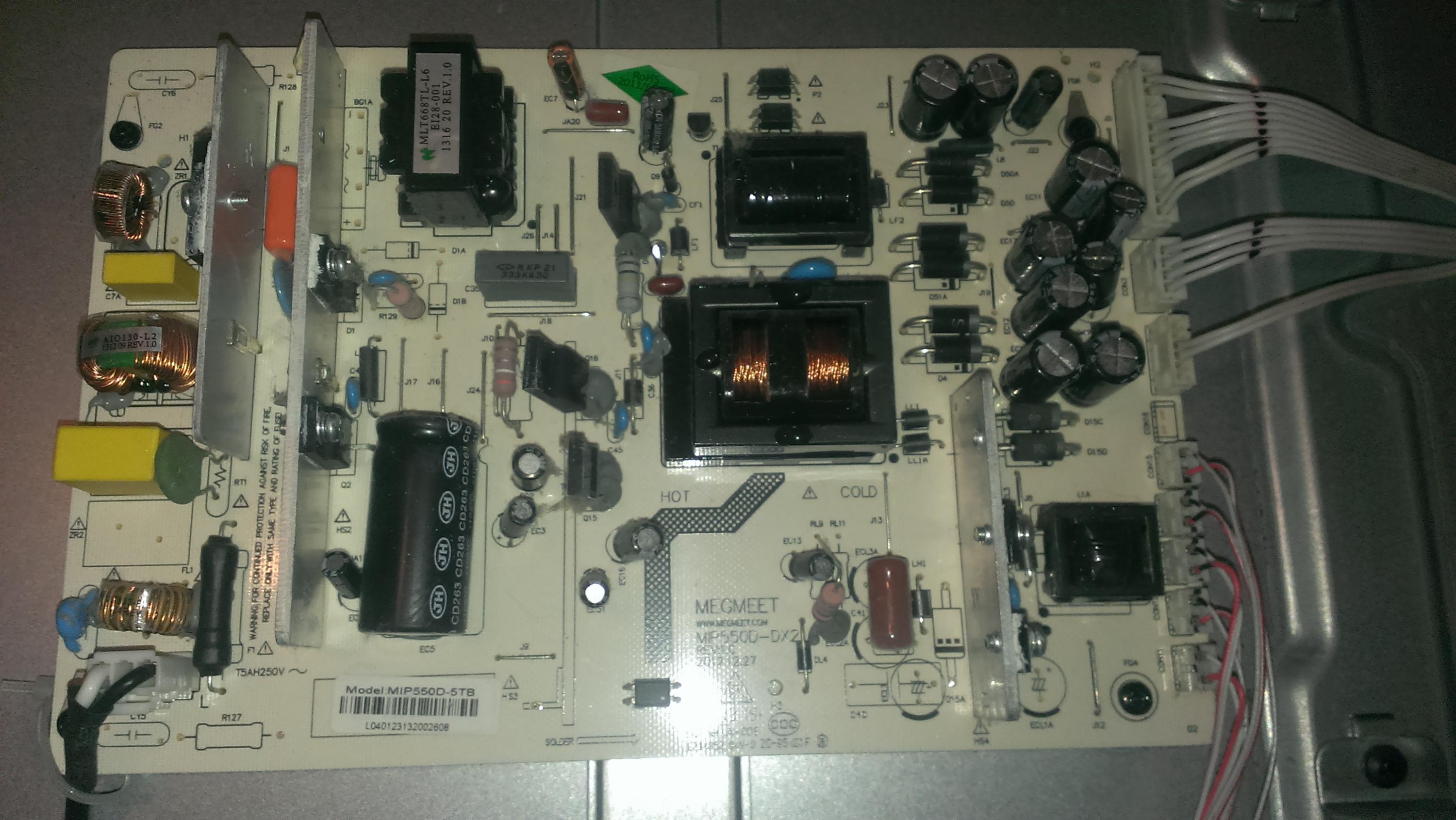

    Please upload the pictures of the whole back side of the TV so we can see how all the boards are connected together.
    • zacheriaj
      • Jan 2014
      • 138
      here are the boards
                Check the DCV between the Red wire of the LED connector CON 11 and GND to see what you have when TV is turn on.
                The LED strings are connected in series, the first string is on CON 11.

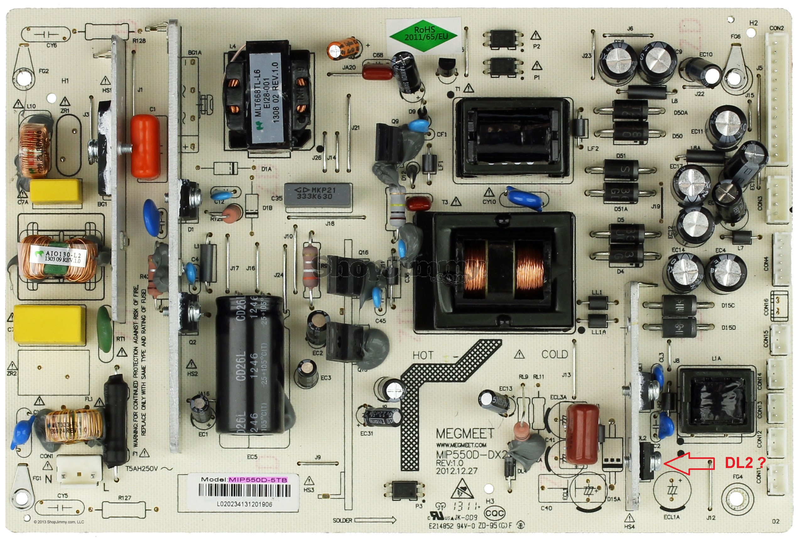

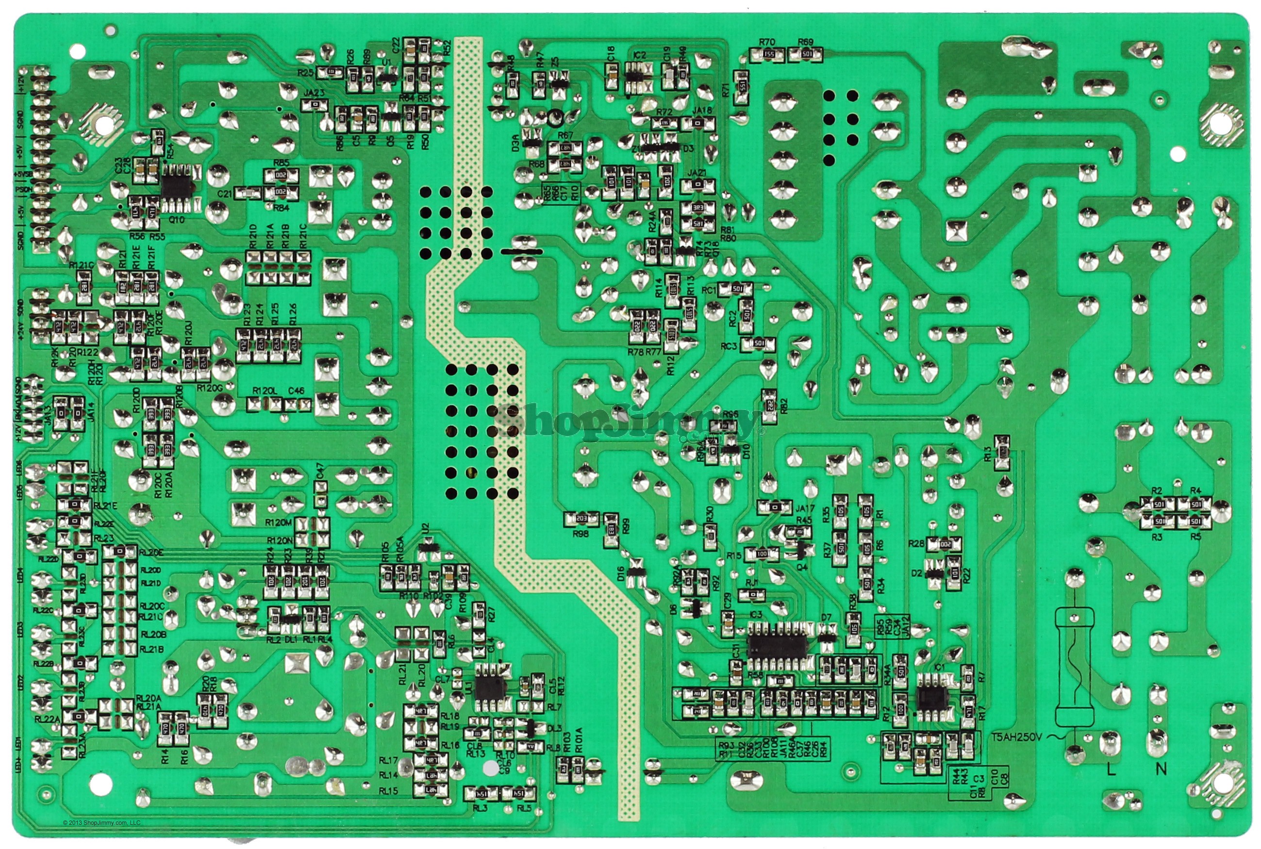

                MEGMEET MIP550D-5tb
                Pictures provided by shopjmmy.
                • zacheriaj
                  • Jan 2014
                  • 138
                  check the dcv between the red wire of the led connector con 11 and gnd to see what you have when tv is turn on.
                  The led strings are connected in series, the first string is on con 11.
                  Megmeet mip550d-5tb
                  pictures provided by shopjmmy.
                  123vdc
                  You Can't Succeed Until You're Willing to Fail
                    You have open circuit in the LED strings.

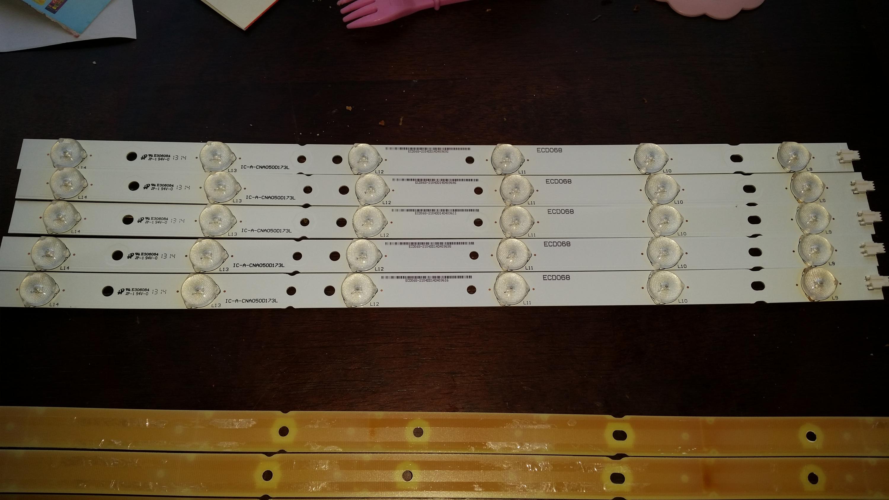

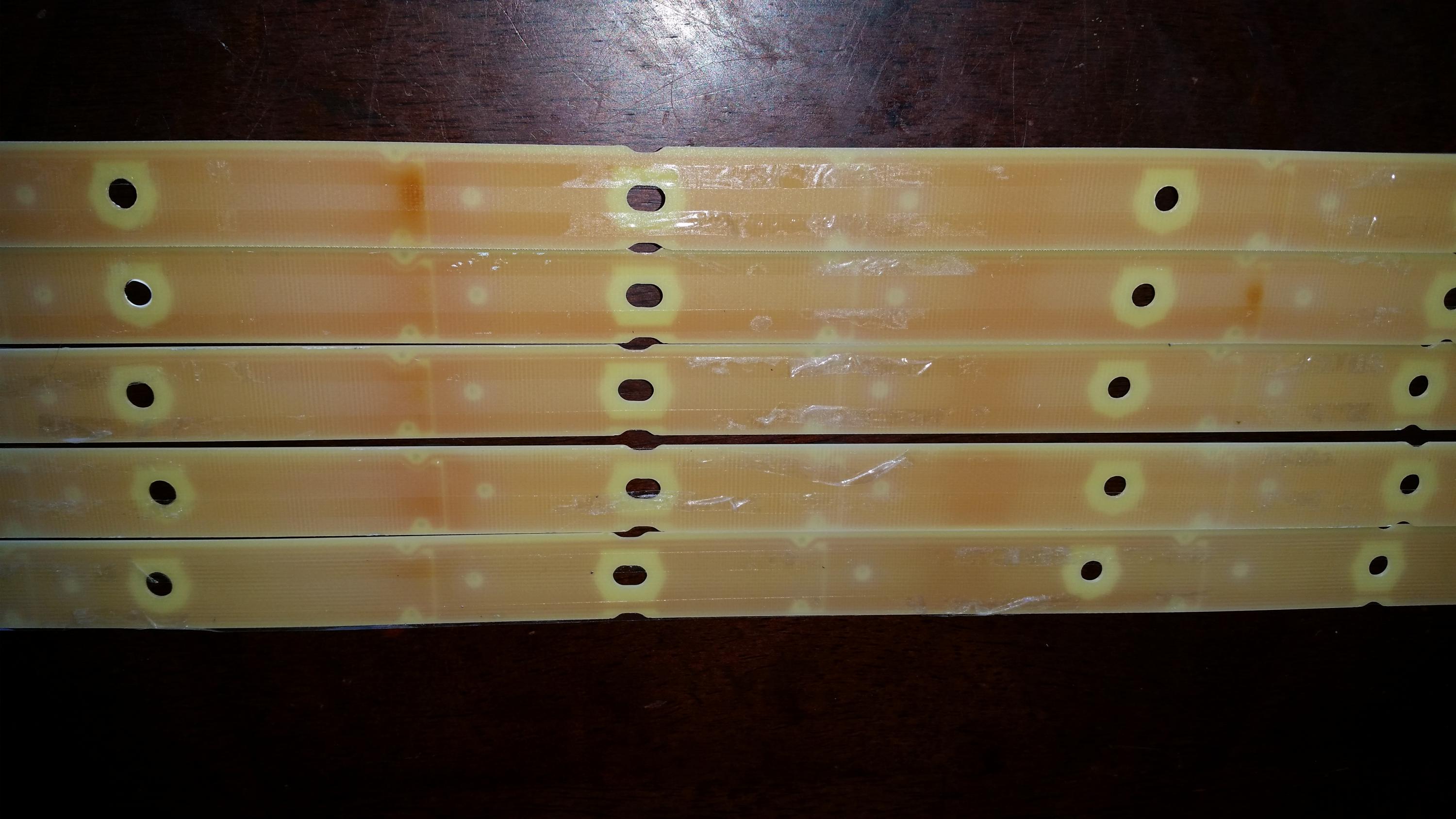

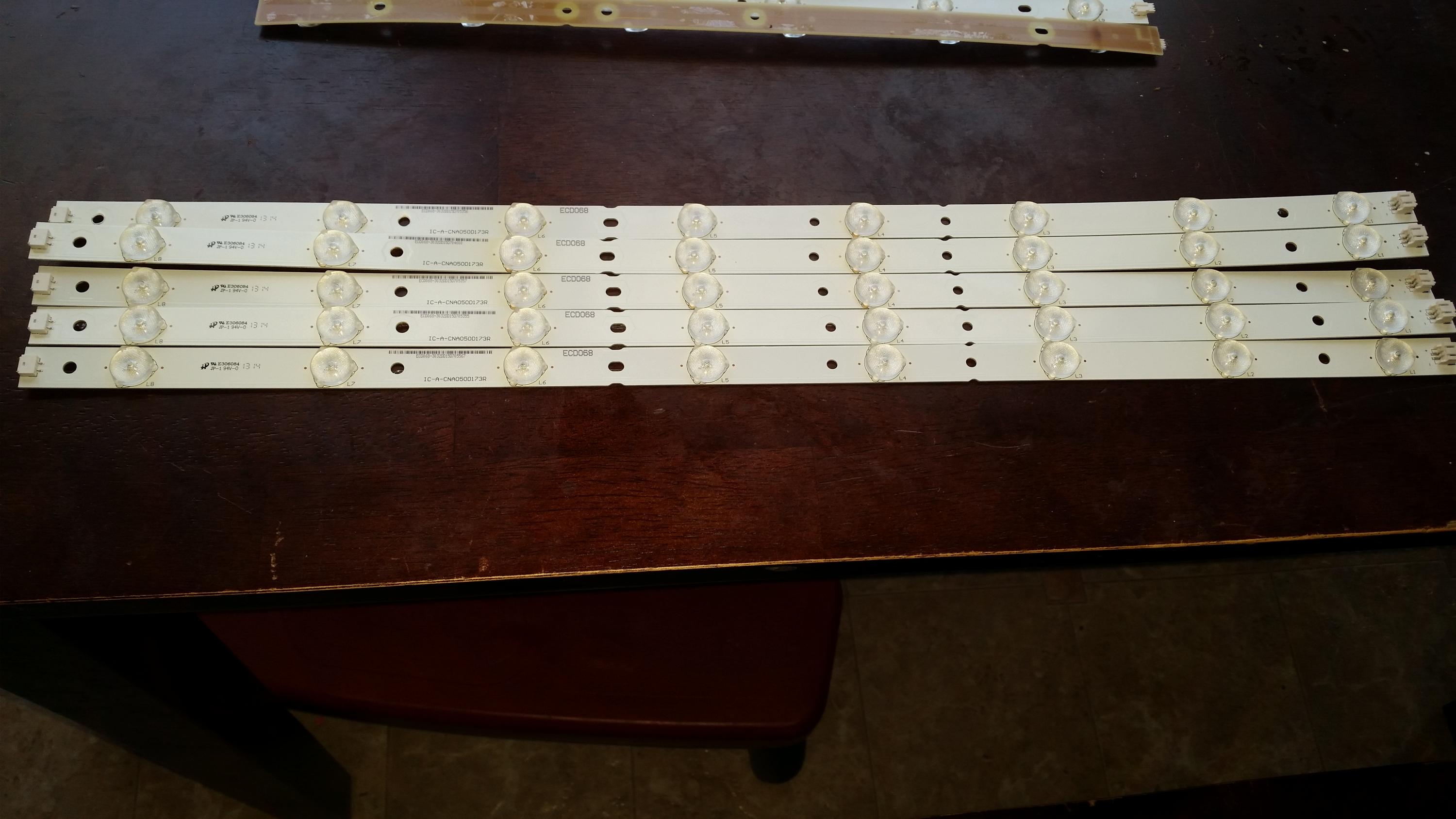

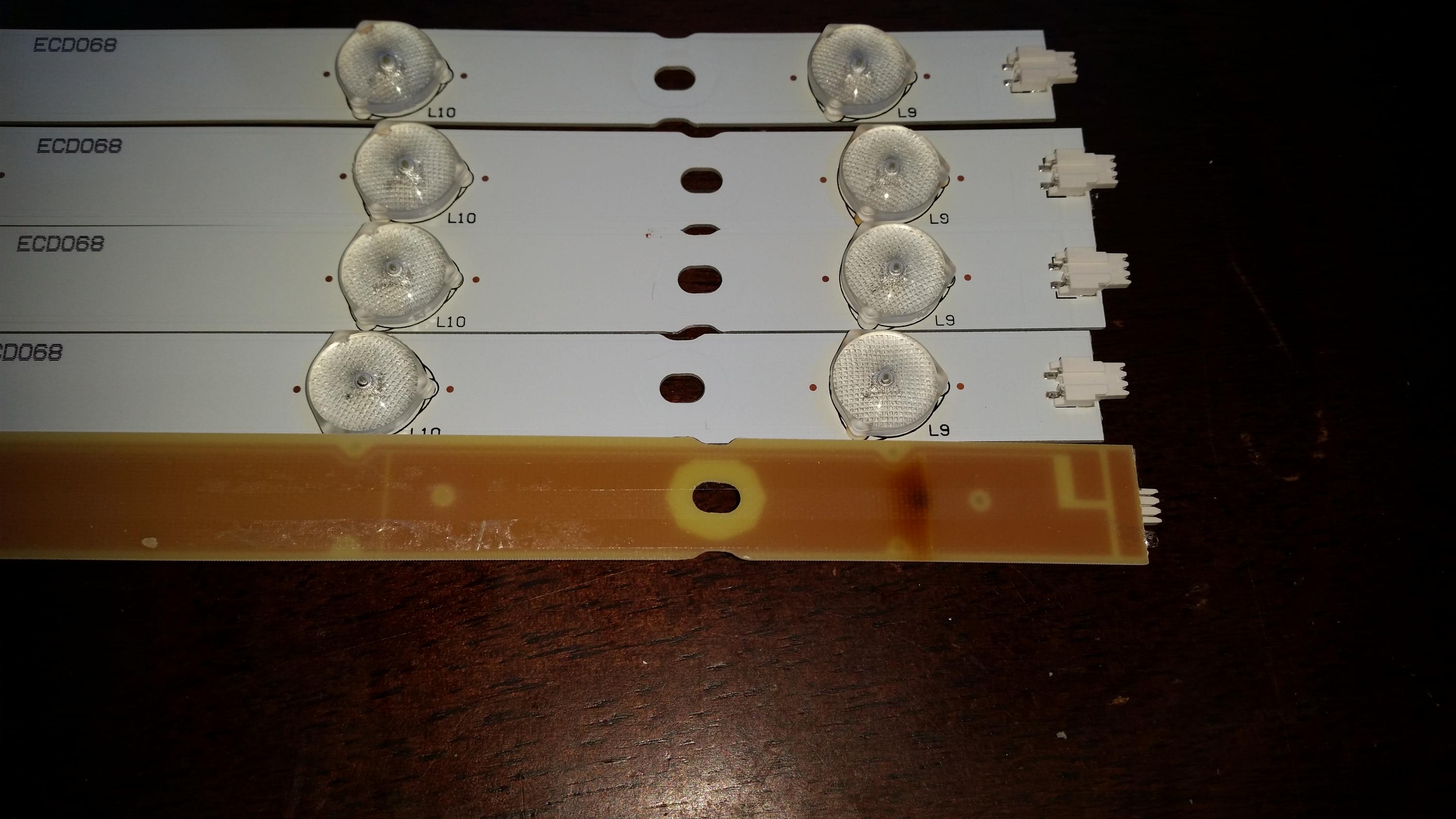

                          Pictures of LED Strips
                          L9 seems to be the main culprit on the smaller strip
                          L6 looks like it's going on on every single large strip with one also having a burnt mark on L4
                          On just about every strip on the front side you can see some level of discoloration
                            It looks like they got hot, so you need to test ALL the LEDs.
                            reeceyburger123 has the video on how to test them.
