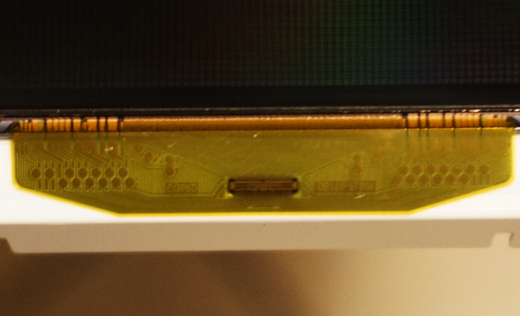

    Here is a video of what my TV is doing https://www.youtube.com/watch?v=9aHWQ9j9ois
    I've replaced both the power supply and T-con boards, but the problem stays the same, 5 red light blink error code. If I i disconnect the output ribbon cables from the t-con board, the tv will not fault.
    I've inspected all of the ribbon cables around the panel and none of them appear damaged. I've never worked on a Sony, so I'm curious how the side panel cables work.
    Do they use the frame as a ground? or are they just to test the panel in the factory?

      Have you tried inputting a signal in? Those tabs cables appear to be carrying / transferring signal from one section to another. Are they on both sides or just one side. If you "feel" them while the tv is on, do any of them feel warmer than others? I suspect if you actually input a known signal / display, your problem will be easier to ascertain.

        Yes, the tabs with the driver chips are on both sides of the display. One is hotter than the rest. I just ordered http://www.amazon.com/ARCTIC-Thermal.../dp/B00UYTTLI4 to install so that I can sink the heat onto the aluminum bezel. I'm hoping that it is a loose connection and not an actual chip or tab ribbon failure.
        Of course if it is internally shorted, there isn't a lot that can be done, although
        I have read that there is an option of removing a single driver and the display can still work.

          Back on your problem, if you disconnect the tcon cable(s) associated with that side of the set, does anything change ... again, good input will help with the diagnosis as looking at a blank screen / snow isn't very useful (even a menu has limited use if the menu is "sided").

                I figure that I will have to find one harvested from a broken panel.
                I really hope that I don't have to go that far; that the thermal pad will keep the driver chip cool enough to solve the problem.
