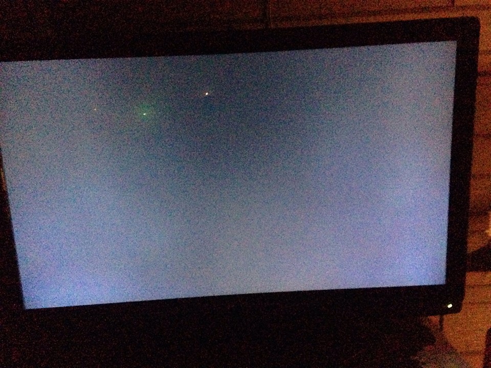

    I picked up a Sanyo DP52449 and it has a darkest blue screen not real dark but it seems maybe a little darker than normal. Also real choppy noise from the speakers. Have not done anything at all with it. Just wondering if the panel was bad would it still light up blue?
  • joeshannallie
    • Dec 2013
    • 103
    • usa
    Re: Sanyo DP52449
    Well now after I really got into it, It actually looks like a a really light washed out look. The bright dots on the screen is just a reflection and nothing to do with he screen.

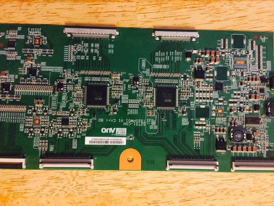

                          Here is a pic of the board. How can I test the board. If anyone has one of these that is guaranteed to be good and the price is right I will be interested. Please reply.

                            Have you checked the fuse on the Tcon board to see if it has a dc voltage on both sides?
                            Edit
                            I see that you have replaced the Tcon but it would be worth checking the voltage to it.

                                    so i replaced the main board and 120hz board, no change. t-con board (checked f1 resistance .04ohm) or a bad cable?
                                    • jasonbay13
                                      • Jul 2014
                                      • 195
                                      • usa
                                      Re: Sanyo DP52449
                                      Tv now works with t-con board replaced. - in case anyone cares to know.

                                        Good for you! I ordered another Tconn board from Ebay and installed it and no luck. Maybe I got a bad board, Who knows! Can someone look at my board and tell me where to check it? I dont see a fuse on it anywhere.
