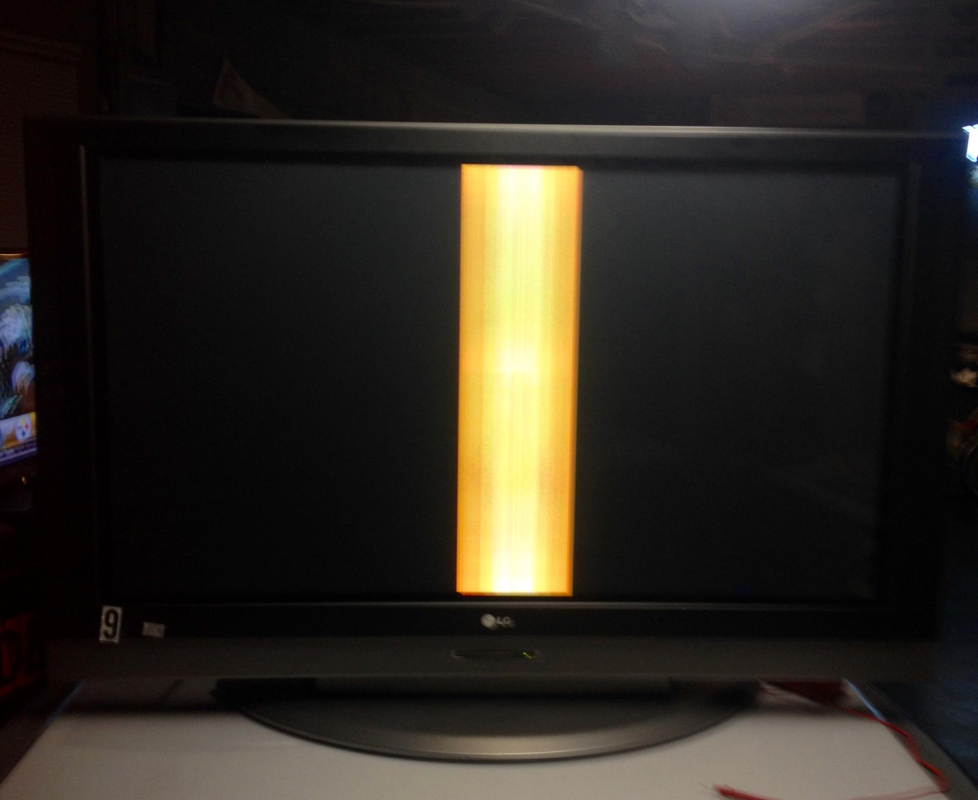

    Okay so I replaced the Y-sus main, and found 3fets shorted on the lower buffer. Replaced those and hooked everything back up and now I have a color vertical bar that moves across the screen left to right. Any ideas to what's causing this single bar?

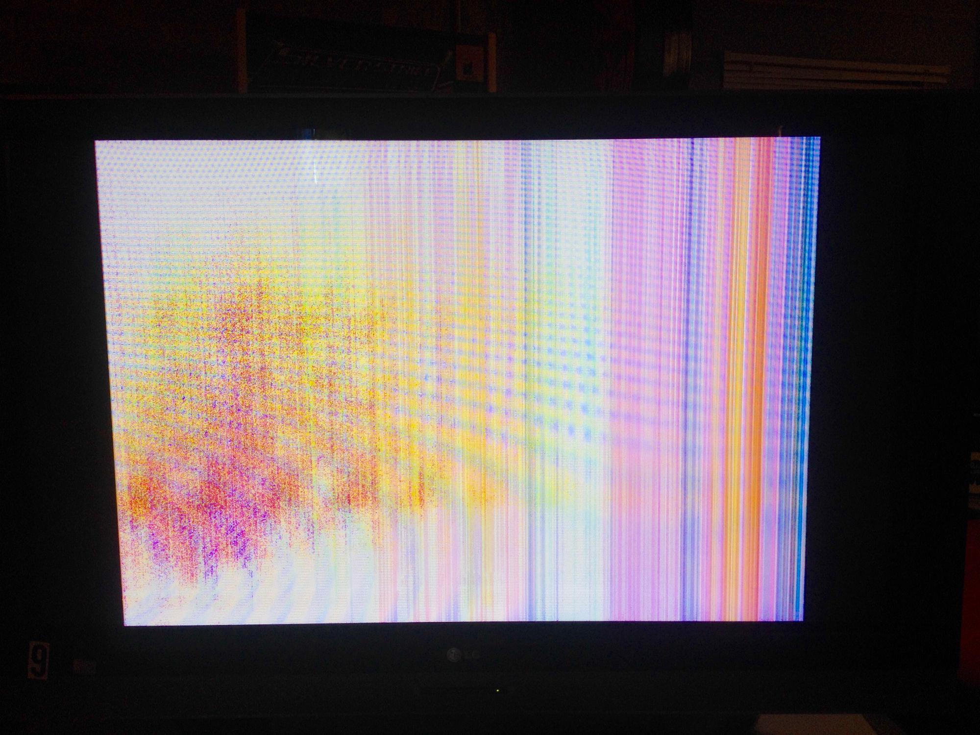

    Okay I hooked a componet signal to it, and now I've got this image. Could this be a ribbon cable not seated properly on a buffer board?
      Looking suspiciously like the "NO SIGNAL" which is yellow and randomly dances around the screen and often it's a bad buffer.
      I believe buffers have SMD FETs which fail or go short, check them out, could be

            The buffers are connected together. The I replaced all the fets on the lower buffer. The upper buffer tested okay....

              Something is still amiss with the fets on the buffers. You getting the same reading on all the MOSFETs of both buffer boards?

                  Okay I checked all the fets on the upper and lower buffer. With my meter in diode test mode this is what I got.
                  Upper Buffer Fets Reading
                  Q1 249
                  Q2 247
                  Q3 249
                  Lower Buffer Fets reading
                  Q103 242
                  Q102 241
                  Q101 241
                  None of them come back shorted. What do I try now guys, could the Y-Sus board cause this problem.

                    looks like one is leaky--I would expect a much higher reading--around 700 odd (body-diode) if they were OK.
                    --those mosfets are wired in parallel...
                    Replace 'em all with new I would.

                        Okay I replaced the Fets, and nothing really changed. So I ordered and tested the new buffers before I installed them. Nothing changed, so I ordered a Y-Sus board, and now the screen is white, and you can see a flicker of images moving in the background. I'm bout to right this off as a bad panel! What do you all think?

                          Nah--Doubt its the panel.
                          Check all the various voltages,--but I suspect you bought a dodgy Y-sus board...

                            I have boards for this set..but I suspect Y-sus has some bad components on it that were damaged by shorted U and L buffers. My set had same malady with moving vertical stripe..I had one of the ribbons to the buffers crack..so panel was toast.

                                Okay gentleman, I think think its time to retire this ole gal! She's been a good one, but I don't see putting anymore $$$ into it. I would like to thank everybody for info and suggestions!
