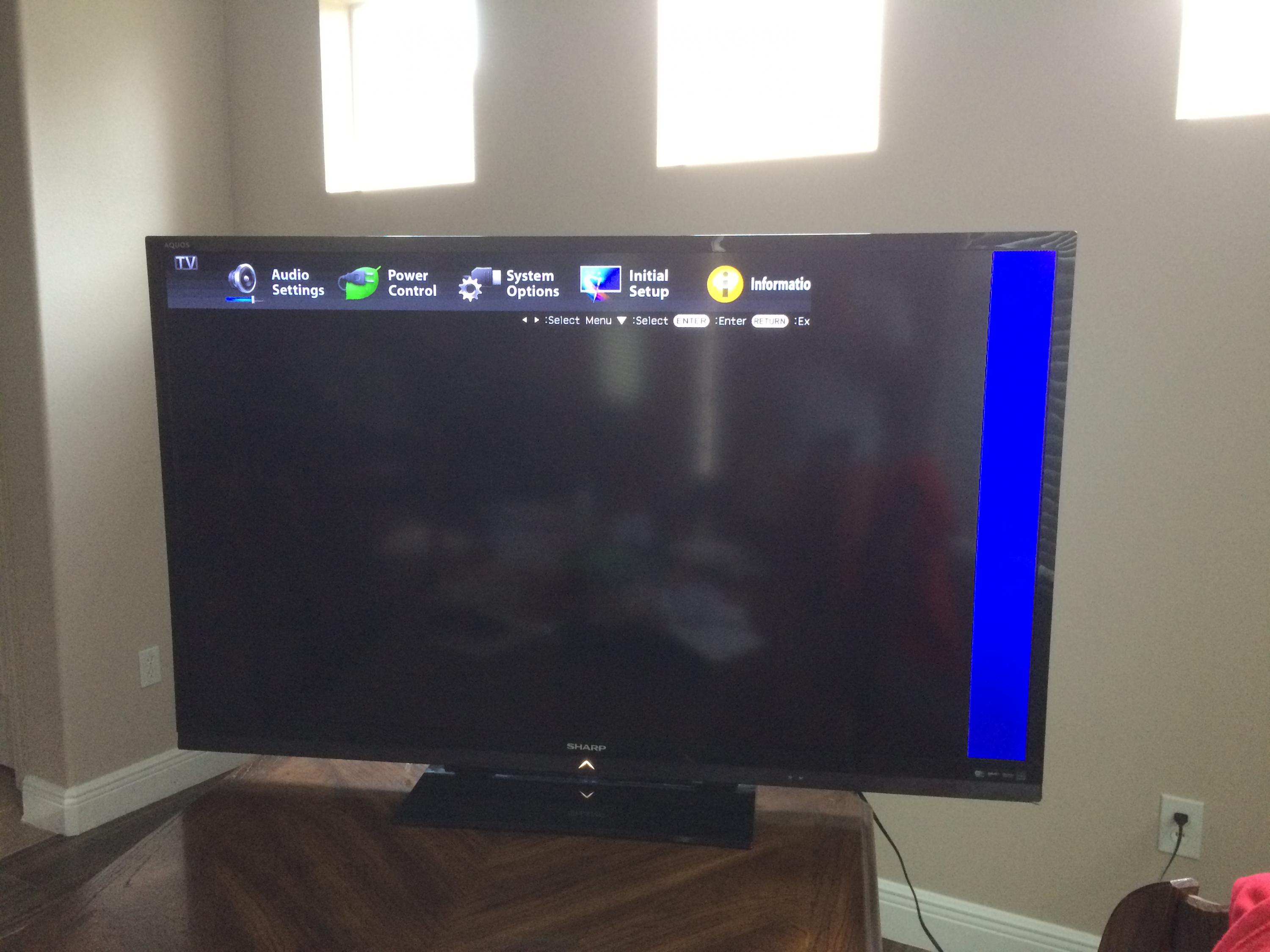

        "However this tcon provides absolutely NO picture. It provides a permanent BLUE screen on the left side, and a permanent grey screen on the right with the ribbons connected. I get a FULL bright white split screen if I disconnect the tcon. <<<<-----
        What do you mean by this. You disconnect the tcon from the panel (all cables 2?) or the lvds cable from the tcon to the control board.
        what happens with just one cable disconnected? Try each side?
        No need to bother...all answers are in post above.

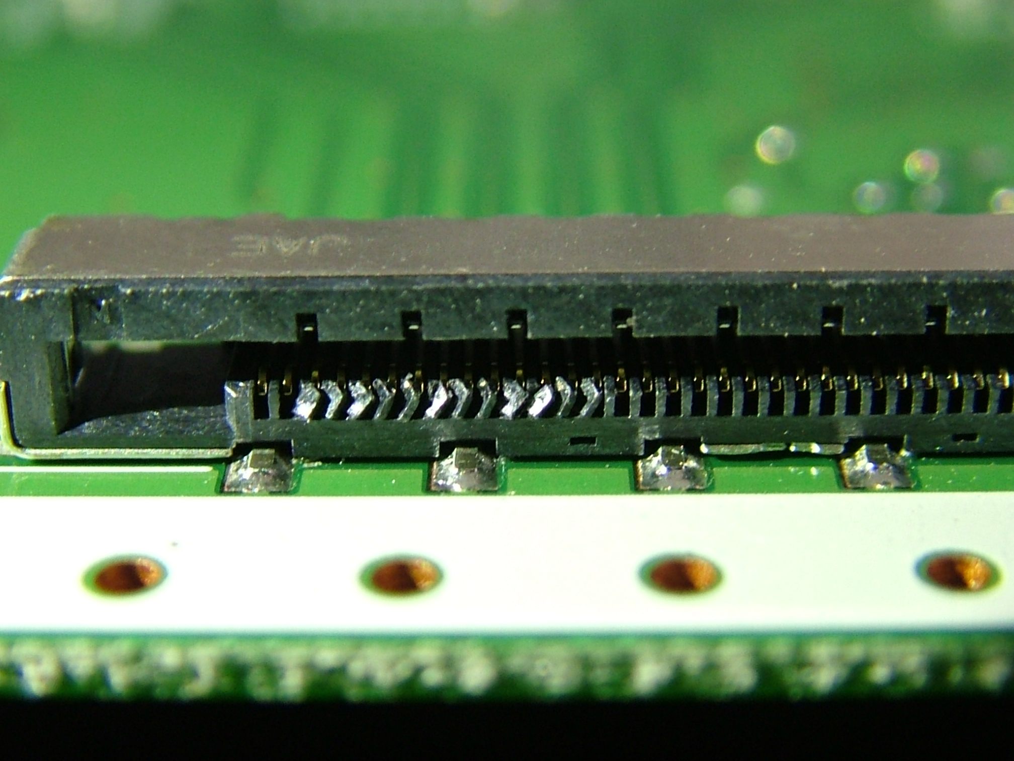

        See photo of damaged connector
        • crosstalk
          • Feb 2014
          • 68
          • Usa
          #64
          Re: Sharp LC-60LE633U 2-5 flash
          Too bad the connector was damaged, but the pins inside look ok. Maybe the ribbon will still make good contact?

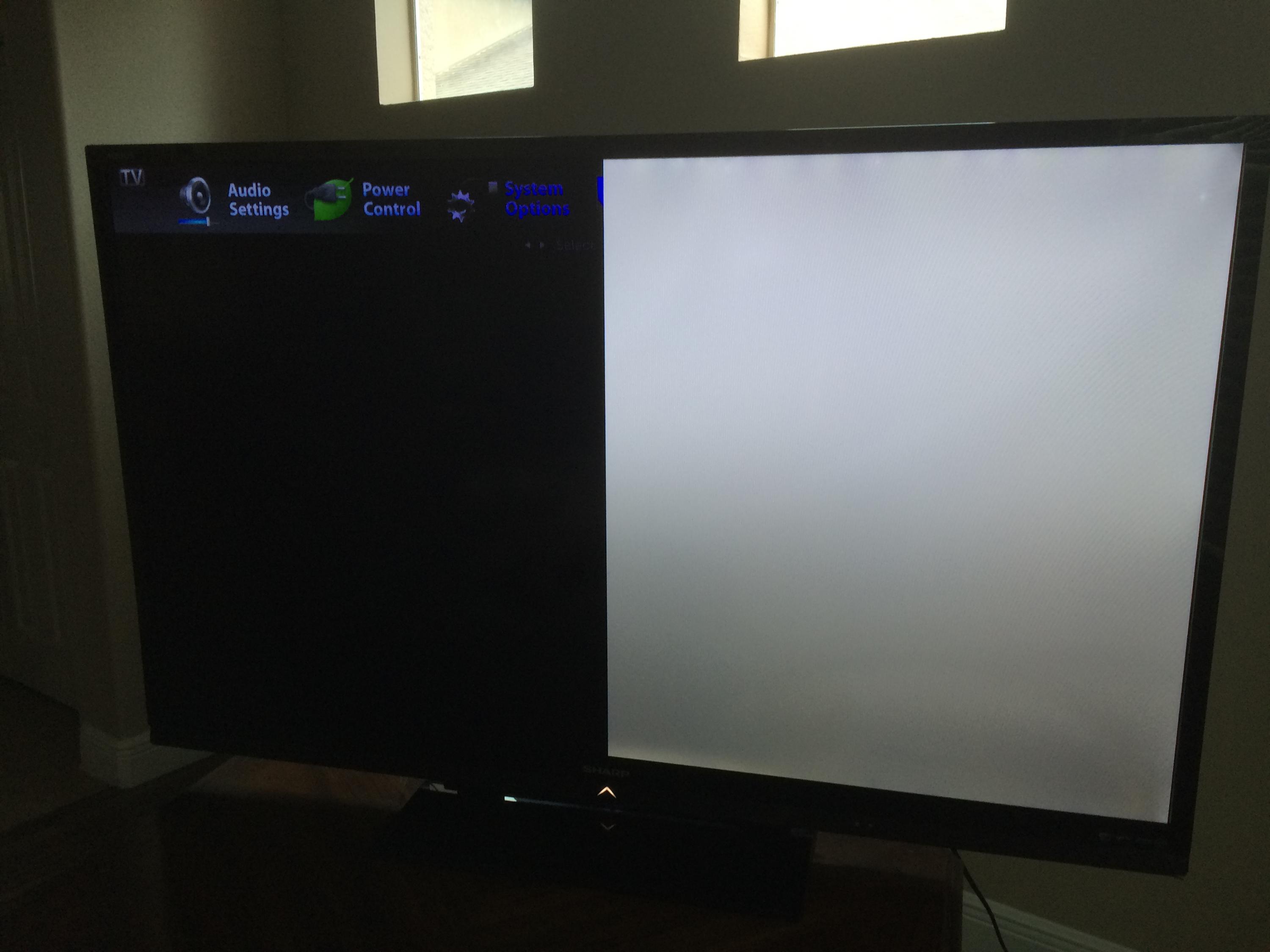

            As you can see in my photos, the 1/4 screen is missing. With the tcon removed you can see full back light no panel damage.
            I want to find something thin enough that I could pick the pins in the panel's main connector to pull them 'up' and make a tighter fit.

              it would certainly appear to be cable connection problem. The second picture appears to indicate half of the panel which means that cable is not connected at all if that picture was taken with it actually connected.
              Are you using your glasses when you are connecting the cables up??? :-)))
              You need to inspect and ensure you have good aligned of those cables... if not, you can easily damage them and / or the connector. Good luck as it appears you are almost "in business".

                The 2nd photo was cable disconnected.
                Lesson learned don't be lazy when connecting those cables. I pay attention now, but it might be a tad late. Yeah- I use my eye loop now
                Took apart the panel last night and ruled out the 'U' shaped jumper by swapping sides.
                If I unclip that side's connector and play with the black clip I can get the text to show up momentarily in that section. Hopefully I can resolve it by pulling those pins in the connector up somehow. If not I will have a lot of functioning spare parts

                      Anyone know where I can get 80pin connector for the tcon > panel ribbons?
                      They look like 0.5mm pitch, 80 pin. Top lock, bottom contact.
                      Thats about all I can figure out so far.
                      I tried to pull 2 of them from the bad tcon but both ended up getting damaged. The two ground pads run under the actual connector and it was extremely difficult to heat the connector evenly for removal with the air pencil. As a result both connectors I removed ended up having some sort of damage and can't be used as a replacement.
