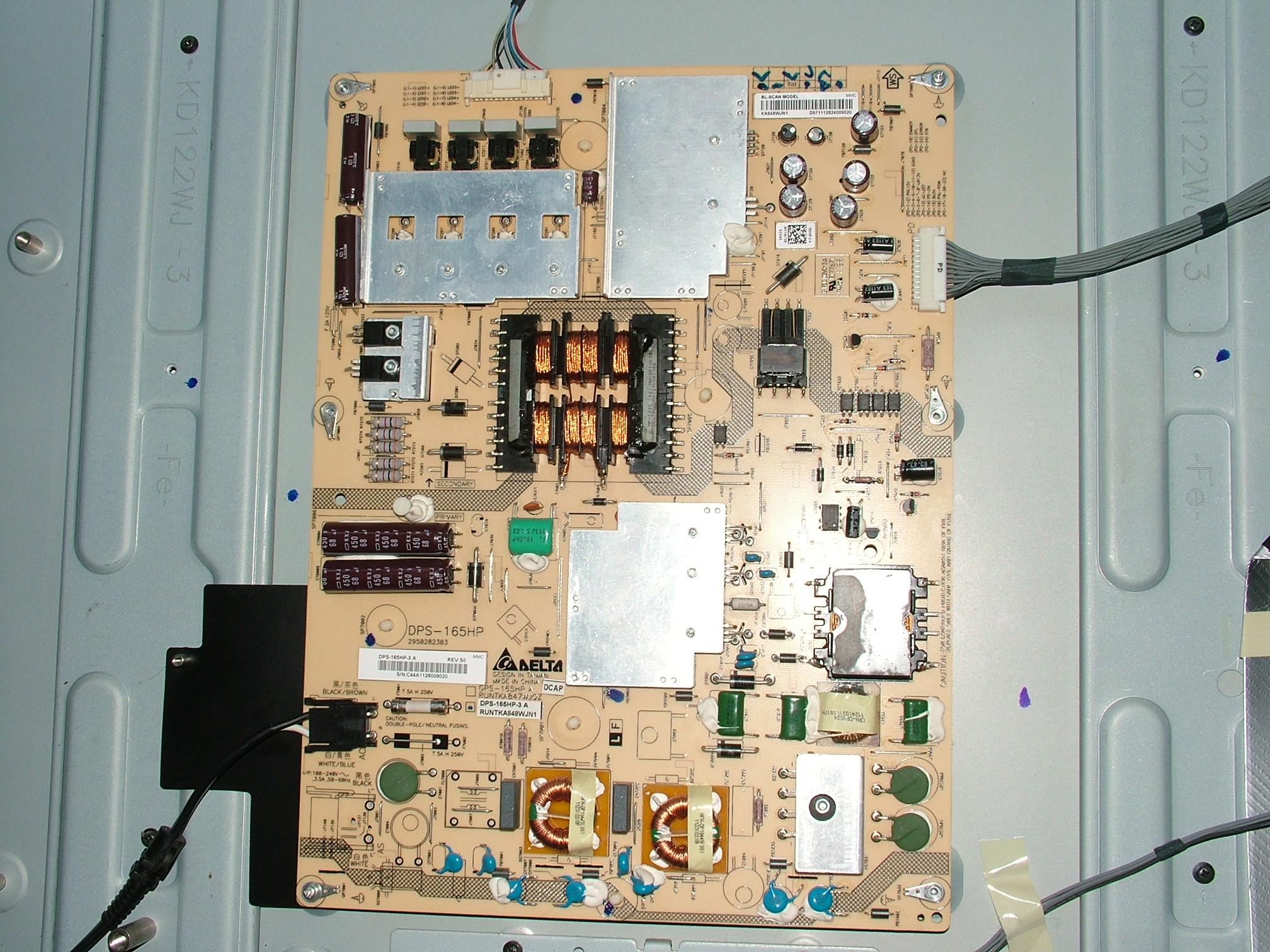

    The symptom when initially received was 2 long blink, 5 quick ones.
    SVC manual says its the error is PANEL_POW.
    So I check that, sure its 0v. STBY power is good
    I reset the TV and jump started it( hold volume/channel while pluggin in).
    TV icon lights up and stays solid.
    I probe around the board, 12V,3.3,sdby and 74vdc at the led power pins.
    There are 4 pairs, and each pair shows~74vdc solid.
    Tcon has 12V. Checked a few FBs on tcon, none are open.
    Next, I disconnected the t-con ribbons and repeated the procedure.
    The icon comes on, but I dont see any backlight.
    Next, with all parts connected and without jumpstarting the tv, I plugged it in and can see 12V come up for quite a few seconds, then it shuts down- with the flashing.It behaves as if its expecting some feedback but not receiving, then shutting down.
    With tcon ribbons disconnected, without jumpstarting, I see the same behavior, and no back light.
    Is my next step now to check the actual LEDs? Is is expected to throw 2-5 error with bad back light?

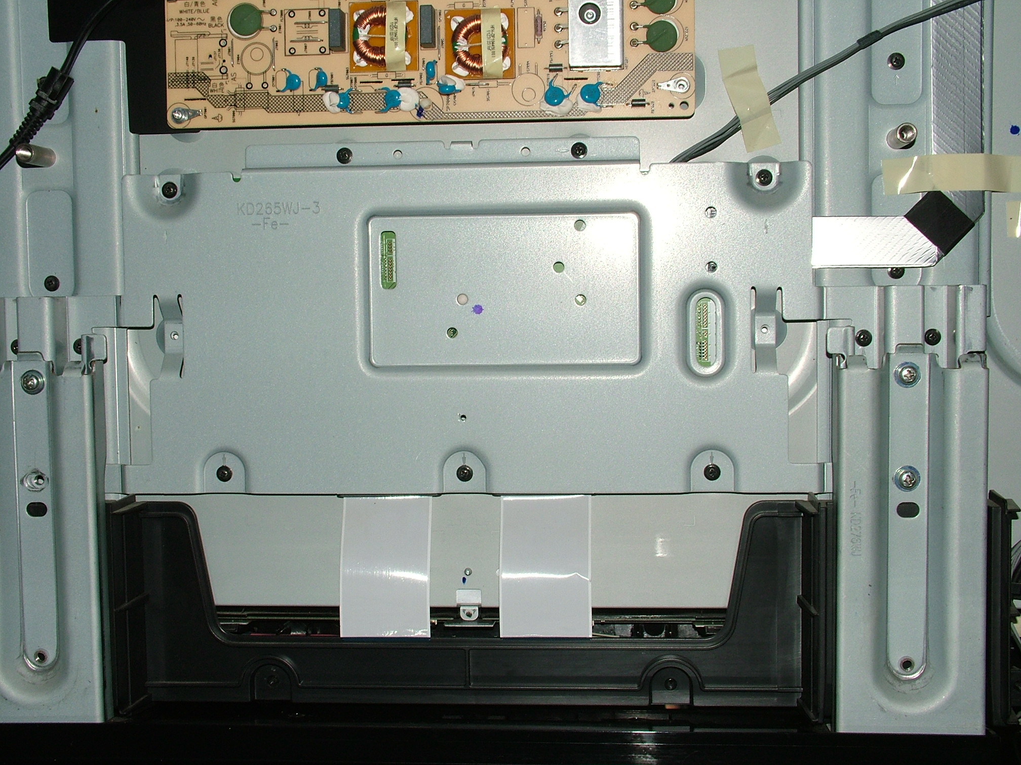

                      I took the panel off to check leds.
                      I made the mistake of disconnecting 2 of 4 strips before powering up.
                      Upon power up 2 strips lit up perfectly.Powered down and reconnected the other 2. All 4 work.
                      So now I'm unable to reproduce dead led strip....
                      Next, reassemble the panel including tcon ribbons etc....
                      Turn it on, still have sound. No picture, but backlight is good.

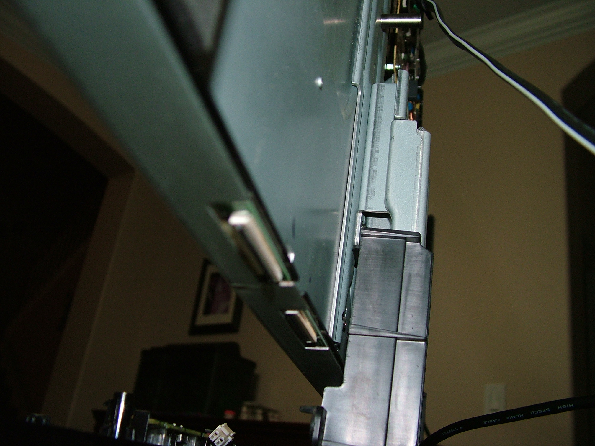

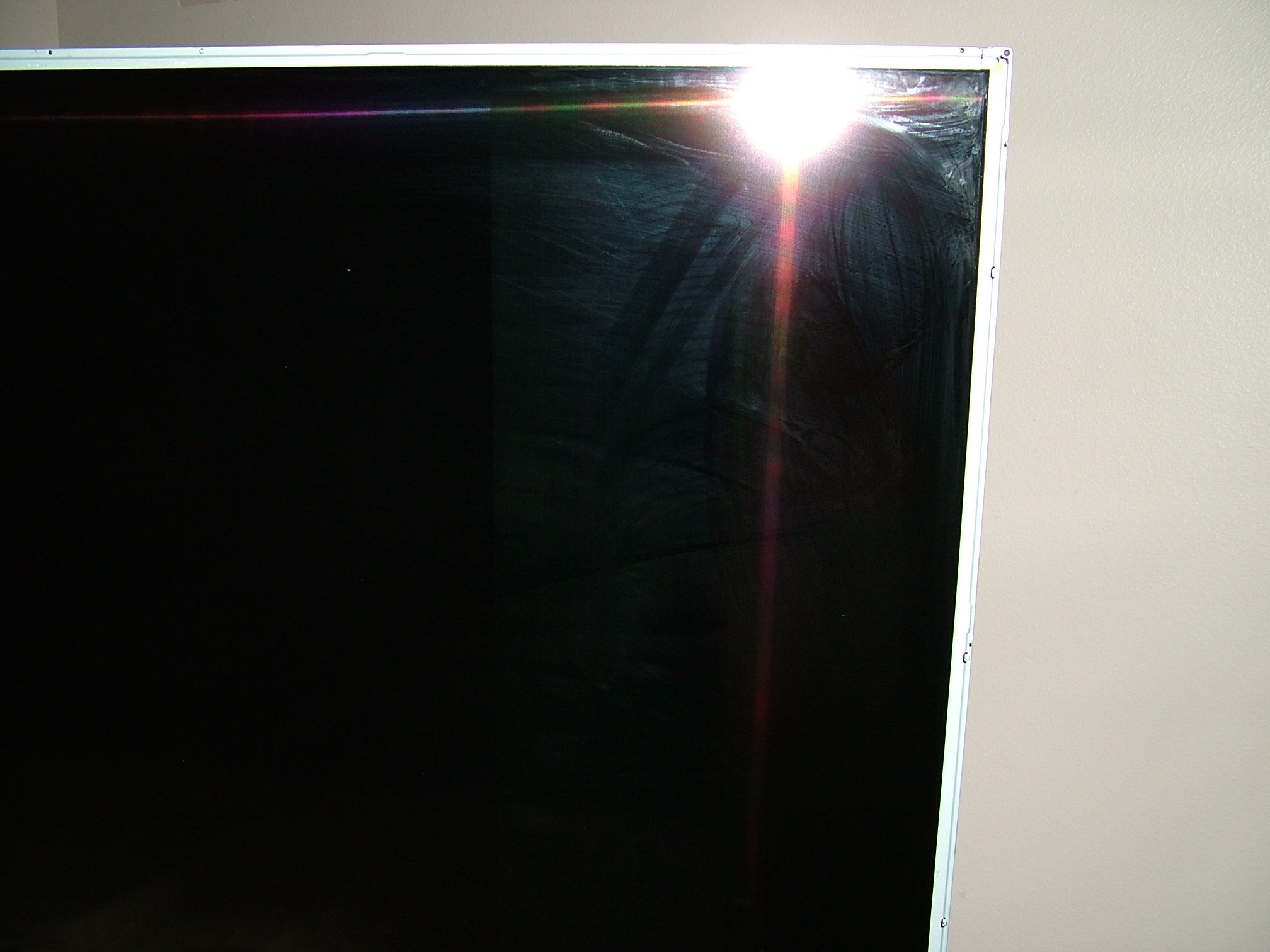

                      Next play with ribbons:
                      Unclipped two of the 'U' ribbon on the left side from behind the set (did not fully remove as its near impossible!).
                      You can see about 1/4 of the right side screen was grey in the photo.
                      Clipped em back in screen black.

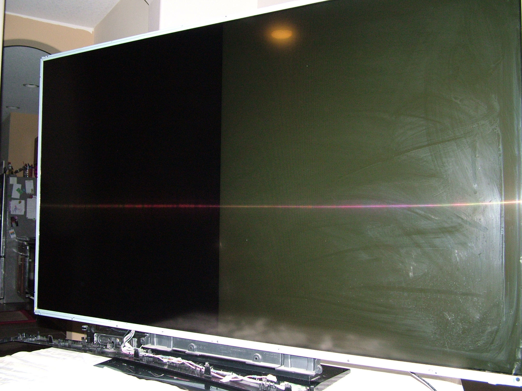

                      Removed tcon from rear left, keeping the right one on:
                      Scren left side black, screen right side grey as shown in photo.
                      I reversed which cable was connected, and tried again. Entire screen black.
                      I tried this reverse scenario a few times and once I was able to see the left side of screen grey, while right side black.
                      So as of now jumpstarting- I can get audio, consistent backlight.
                      I can get split grey/black screen by playing with with tcon cable is connected.

                              Re: Sharp LC-60LE633U 2-5 flash
                              Since you're getting a grey screen when you connect up the tcon to the panel that means your panel is getting voltage and the tcon is performing its duty properly. This would lead me to believe that it's actually not getting a fed video signal from the main board. Without an oscilloscope reading the measurements from the LVDS cable I might be advised to say that you have a main board fault.
                              Too bad there is not a jumper setting to feed a test signal to the panel on these boards.
                              • calimark
                                • Apr 2015
                                • 63
                                The gray side is the 'disconnected side'. Front right = rear left.
