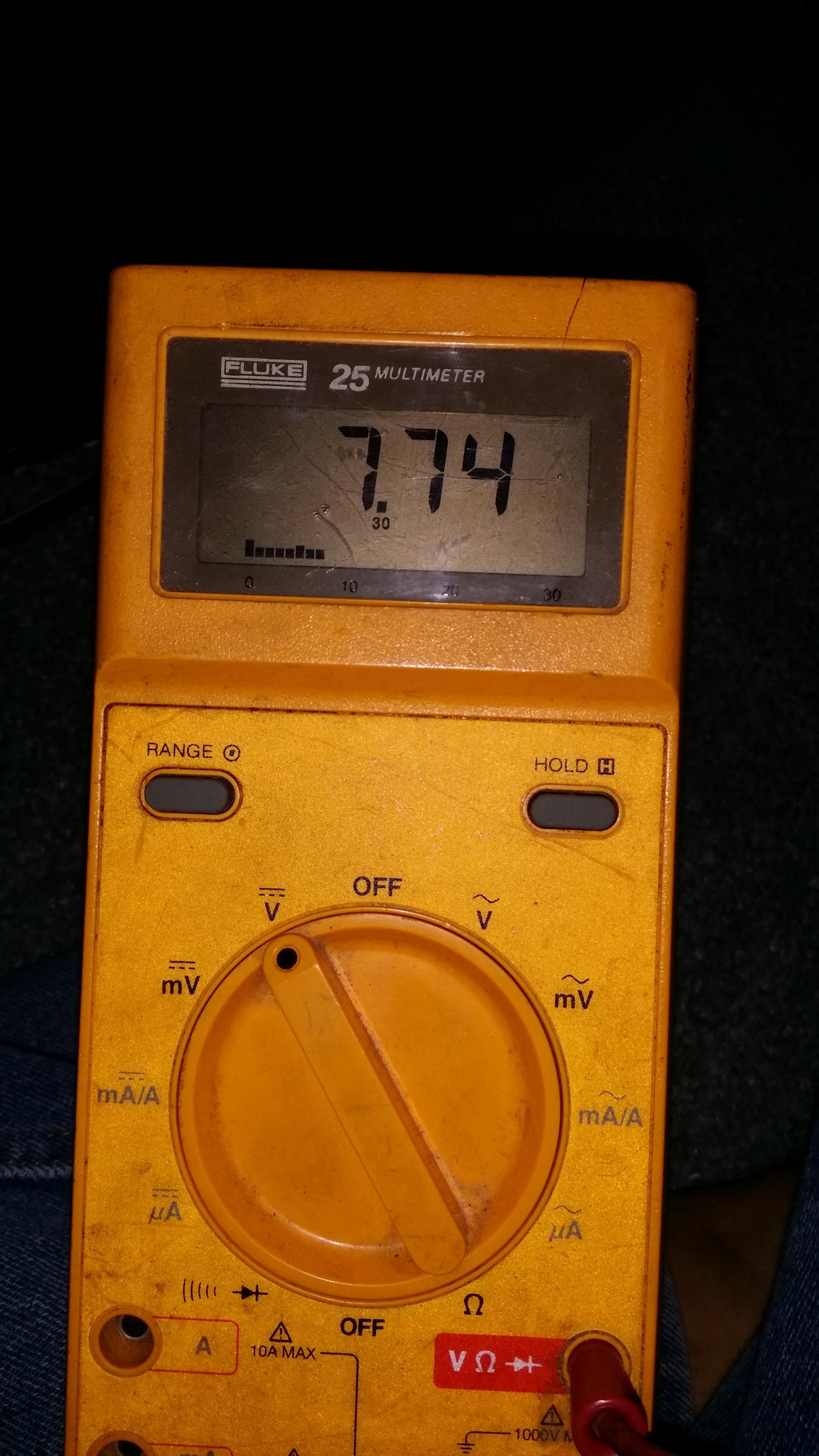

    Step one is to check for 5V to "Power_SW" on the Main Bd, during LED ON time. (see TABLE*1.0) Per table 1.0 - Main K8B "pin 1" should be 5V. I'm getting 7.81VDC... The flow chart is either 5V or 0V... The 5V STBY is also showing 7.75VDC... My questions are, would this over voltage indicate an issue with the power board? I've always heard 5-10% over/under is acceptable, but 7+ volts is beyond 5-10%... Should I stop at step 1 and replace the Pwr Bd? Or continue to step two?

    How do we know how accurate your meter is? Is it set to Vdc? What model? Batteries good?
    Do you have another 5V voltage source to compare to? Know someone to try another meter?

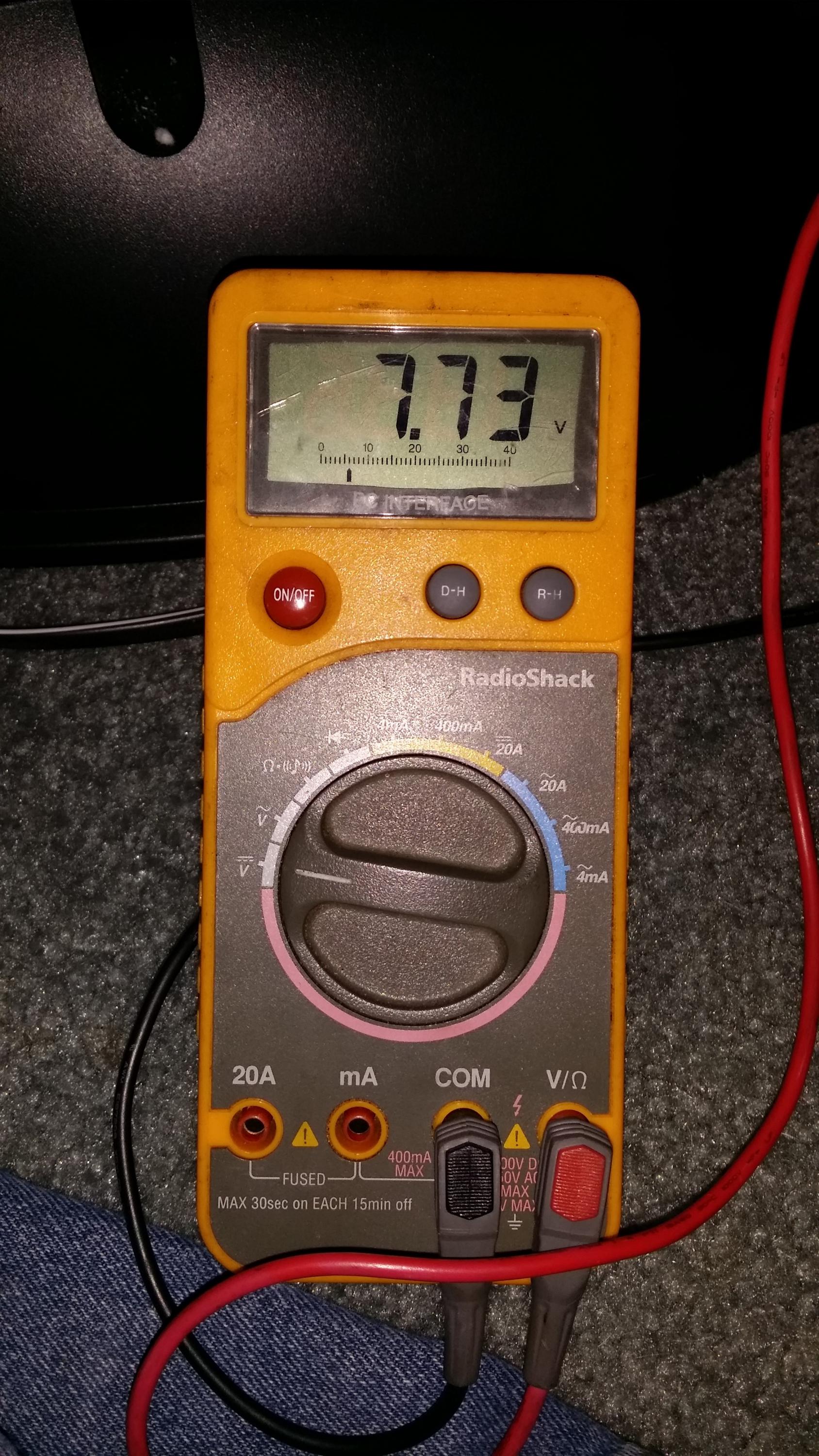

      You have a good point. I just got my second meter out to check, and it appears that I have a gremlin.
      The 7V I got at the Pwr SW (Pin 1 K8B) is now intermittent after being very consistent all day... I did manage to verify that both of my meters read with 1/100 of each other. However, I did NOT manage to verify the 7V at pin 1 with the second meter.
      The 5v StdBy was verified with the second meter to read 7.73VDC. The first meter read 7.74VDC. The first meter is a Fluke model 25. The second meter is a radioshack 22-805. The batteries in both are about 6 months old with little use.
      Both of the meters were tested on a known 5VDC output. The readings were as expected...5VDC not 7+VDC
