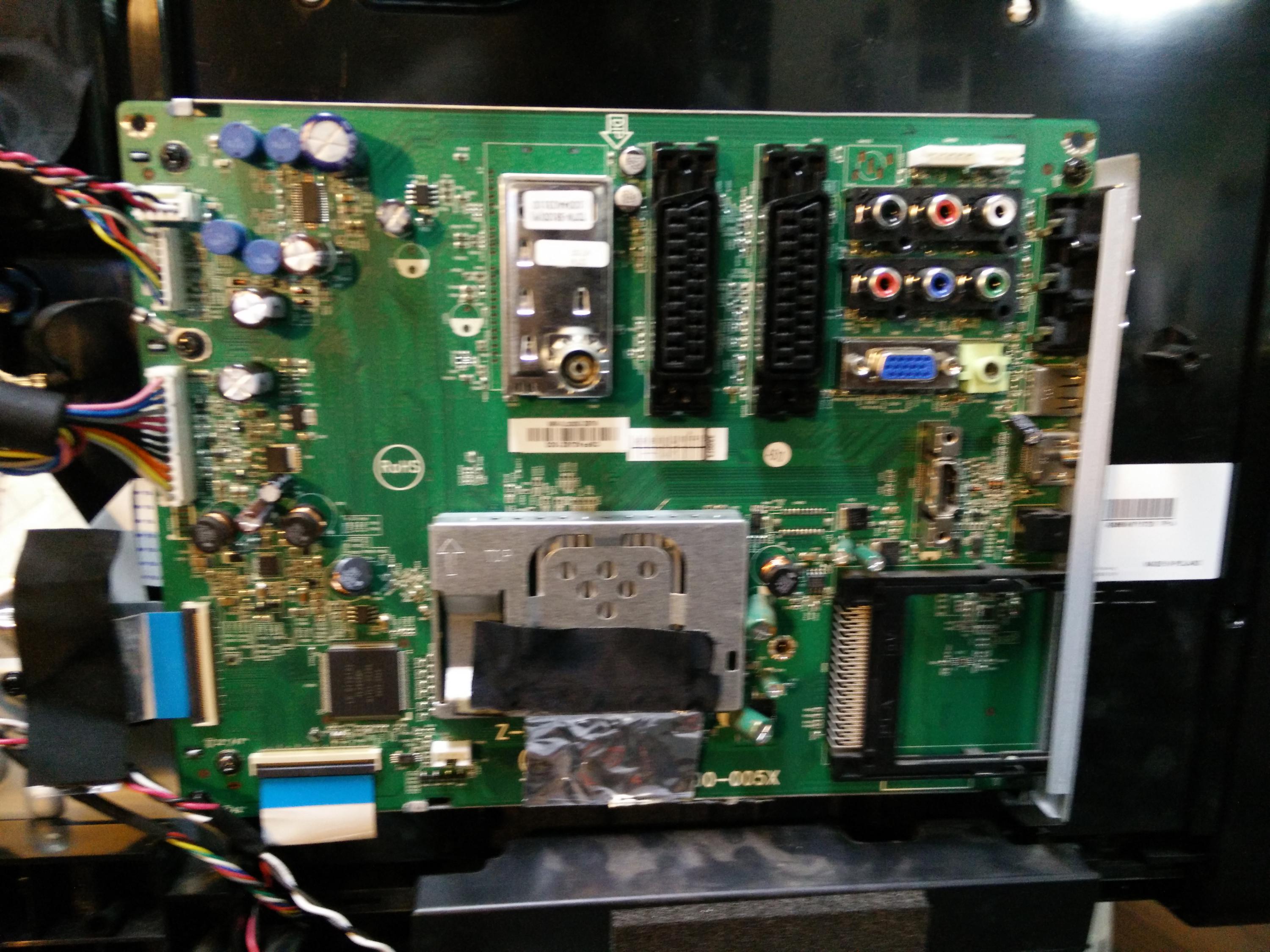

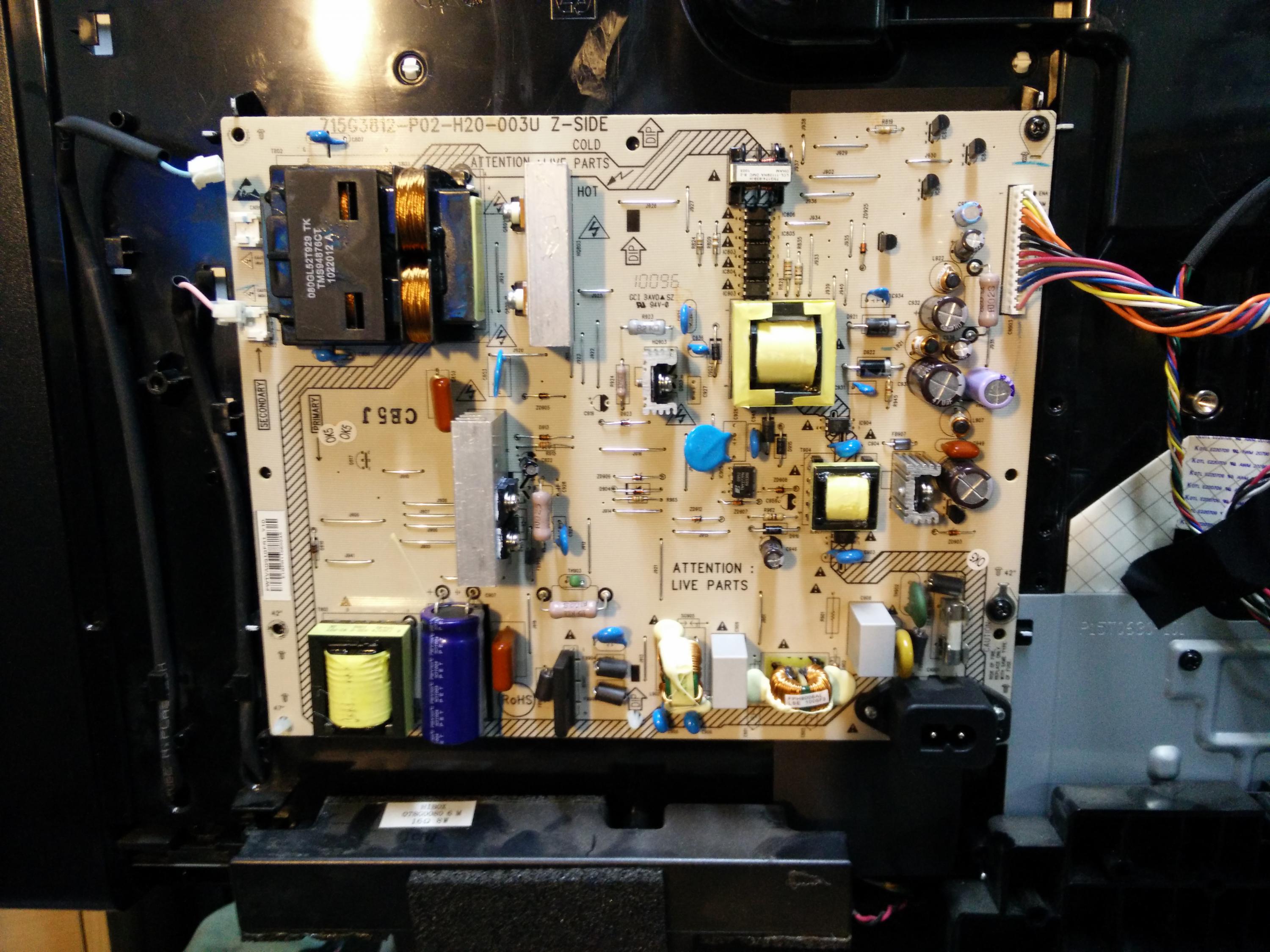

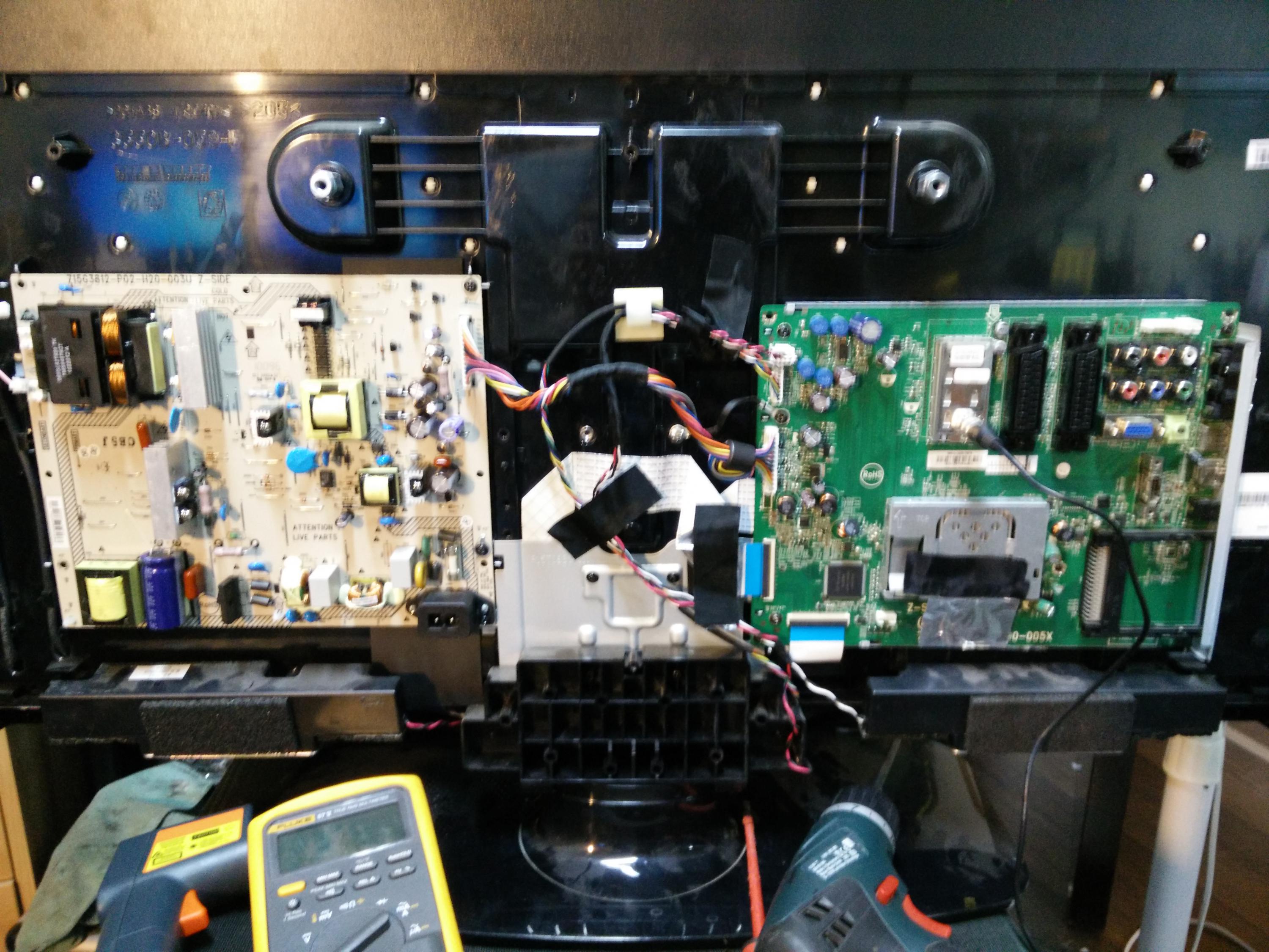

    Hi Guys,
    I need your help with my TV. So far I replaced Caps on both boards(even when tested good - used atlas ESR), Checked PSU transformers with blue ring tester, Check all diodes, resistors and mosfets with Atlas DCA pro, But I cannot find anything wrong with this PSU. When I plug the power and turn the TV on it will stay on for about 1 min then it will shut itself off and then after about 30 seconds it will turn on and then shut off again. Checked regulators on main board also fine. I think it's the PSU since I am getting a buzzing sound where the inverter is.....Any ideas and help will be very much appreciated. This is my 1st post so please correct me if I did something wrong.

            Re: Philips 42PFL3605H/12 Power on and off cycle
            It is a TPM 5.1 Chassis
            There are a lot of problems with D921 in SMPS RECTIFIER SR515
            08 X0 5A 150V DO
            201AD
            When the tv goes to stand by or is rebooting On the SSB replace item U753!
            Thats all I know hope it will help!
            regards thoma!
                Hi Guys,
                Replaced both D921 ans D922 ,replaced U753 on SSB and still no lack.
                Added a 0.1uF across IC804 and that stopped the buzzing on the T802 (inverter).
                I am attaching the service manual maybe someone can see something i cant?
                voltages are ok 5-> 5.3
                12->12.03
                24->25.6
                If i turn the TV on and then power it off from the power button i do have the 5v with no issues. any help will be very much appreciated
                    the 5VSTBY is steady only when I shut the TV off. When the TV shuts it self off it's not there, all voltages are gone, then after about 2 mins the power is back and the TV turns on itself...
                      If that is the case then you need to work in the standby power supply section.
                      When standby Voltage drops out then it will cause everything else to shutdown.
                      Look at solder joints, check rectifier and caps, etc. Standby supply has to be there at all time.
                      • g3org3
                        • Aug 2013
                        • 16
                        • Cyprus
                        SG6961SZ replaced issue resolved.... :-) Thank you all for your help
