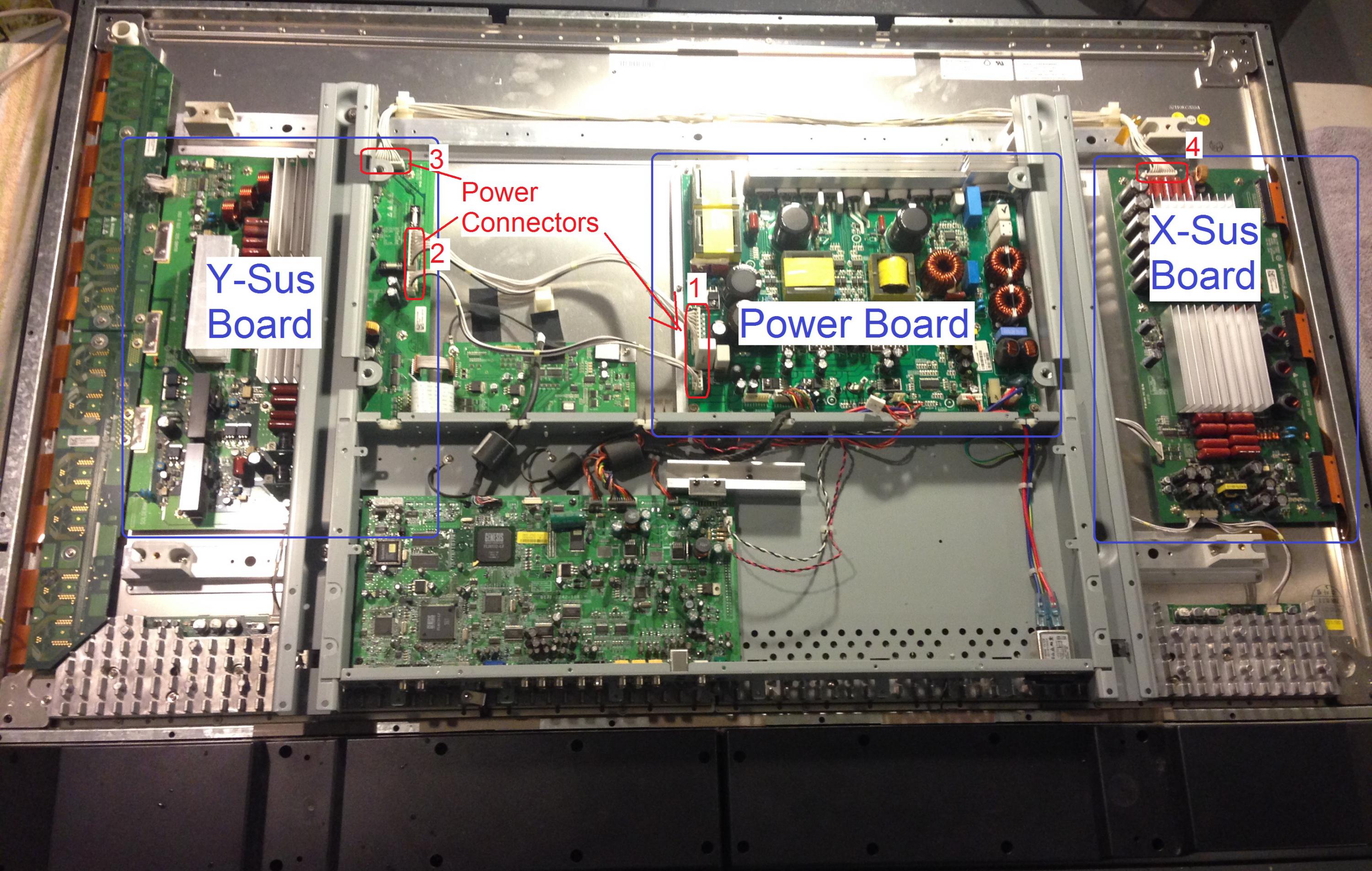

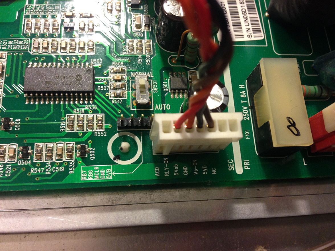

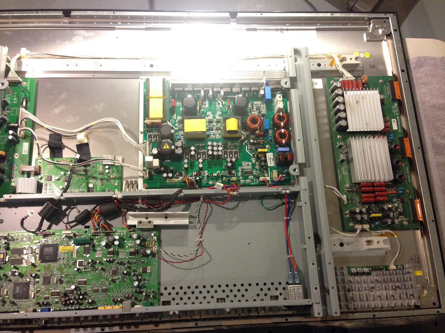

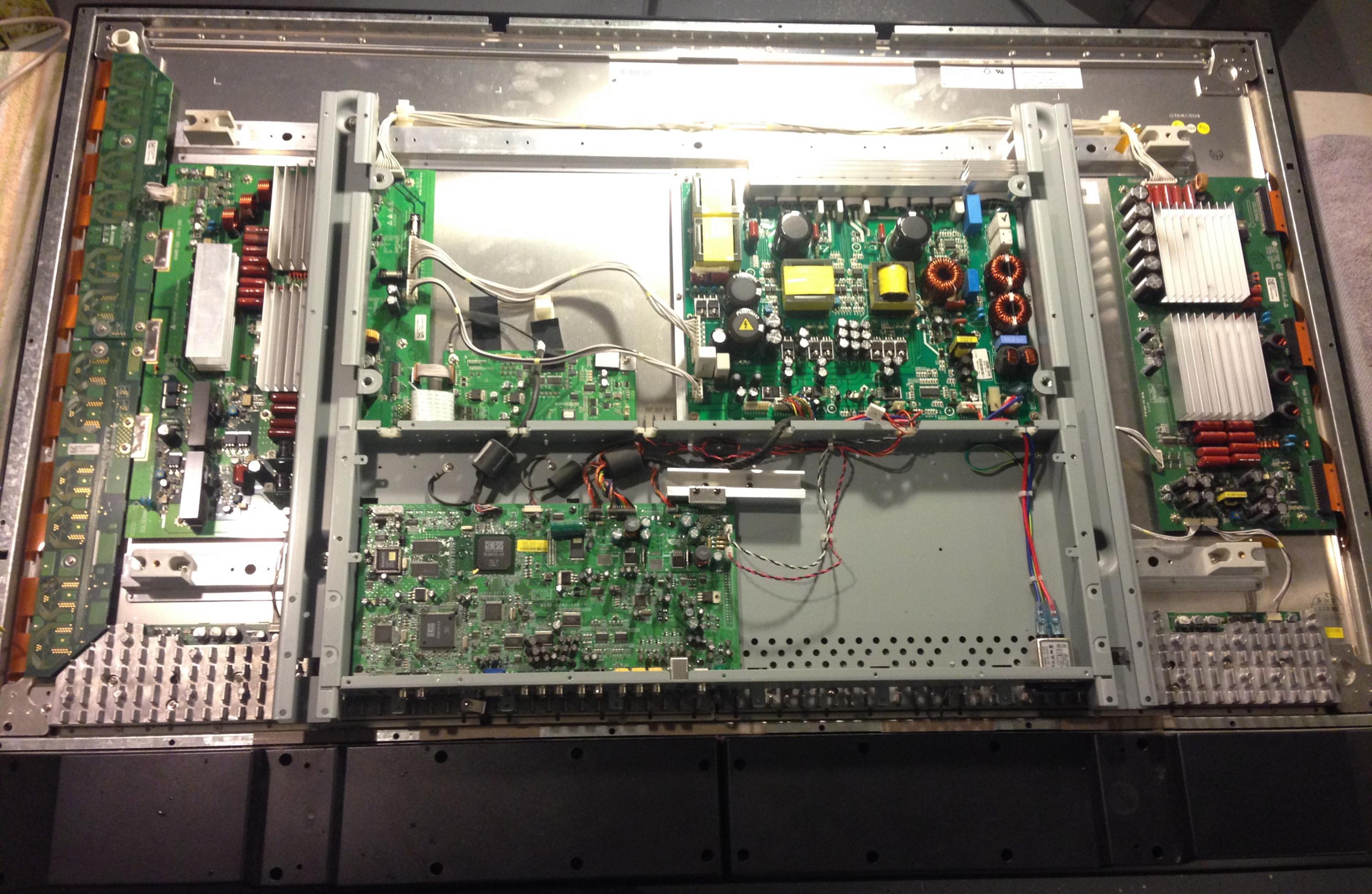

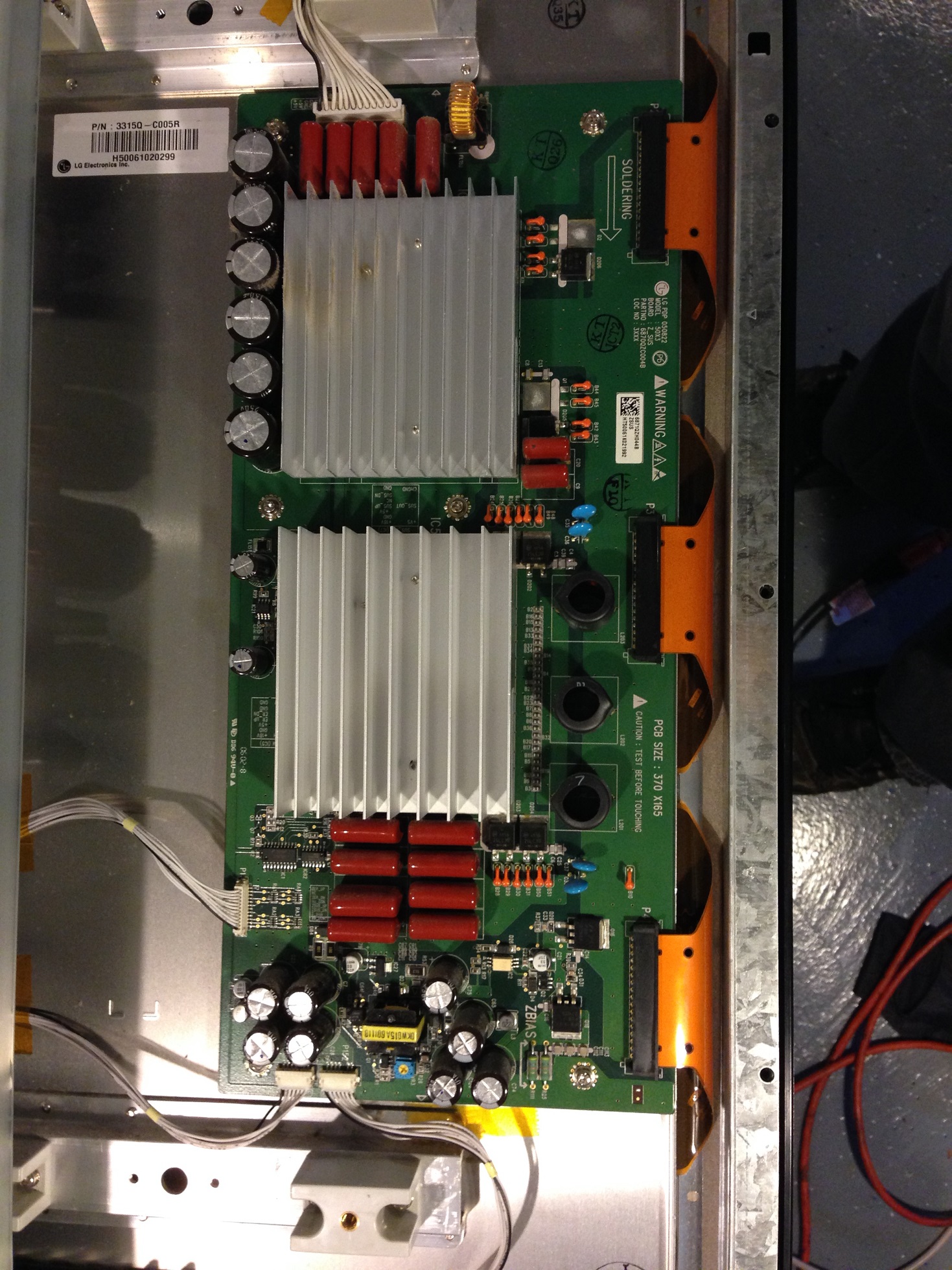

    I have a Vizio P50HDM Plasma TV that will not stay powered on. It tries to power on but turns back off in 2 to 3 seconds. You can hear a power relay click on then click off. The power status LED goes from amber to green, then its clicks off and goes to amber green amber green amber green flashing 9 times and then stays amber.

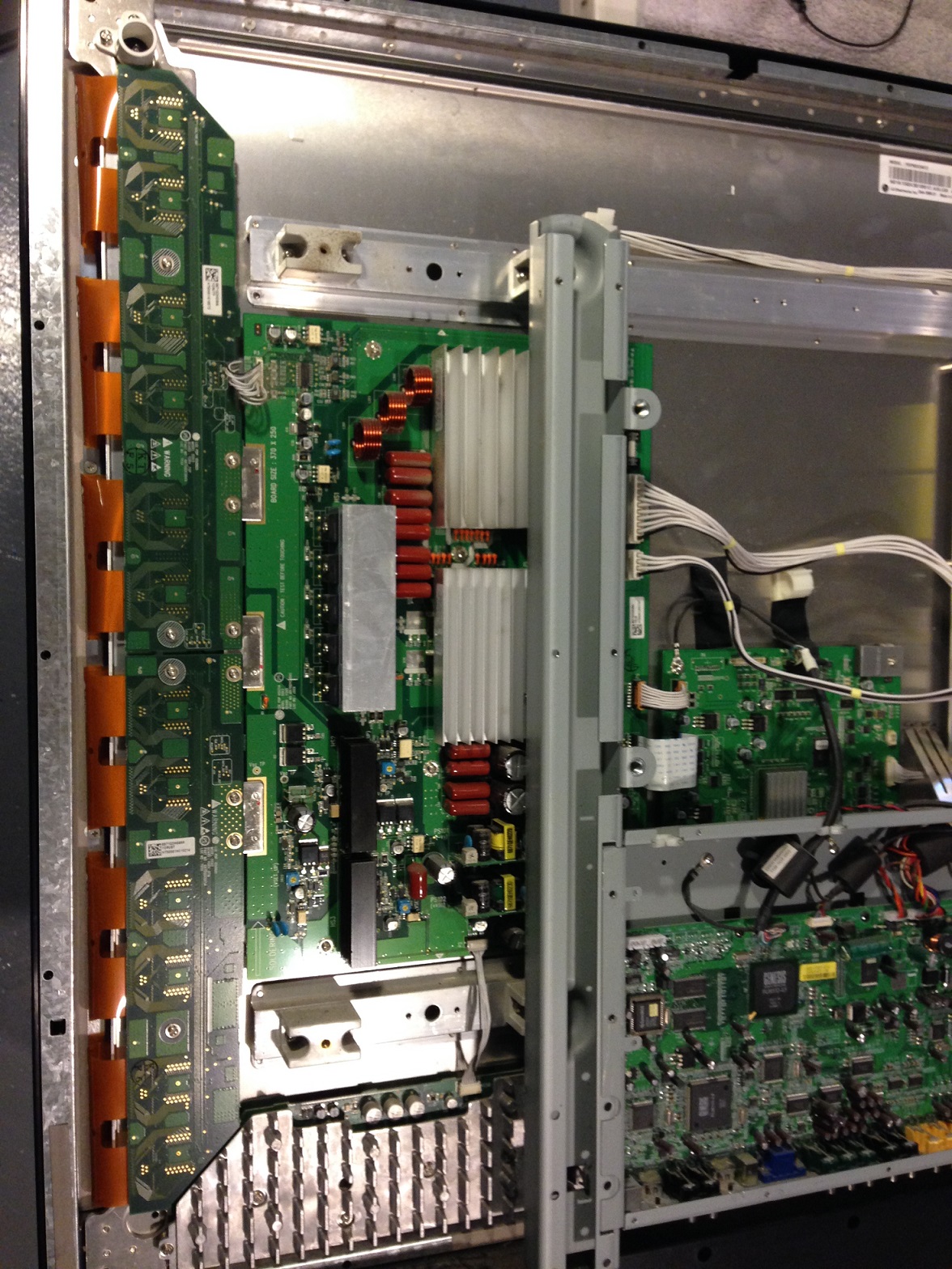

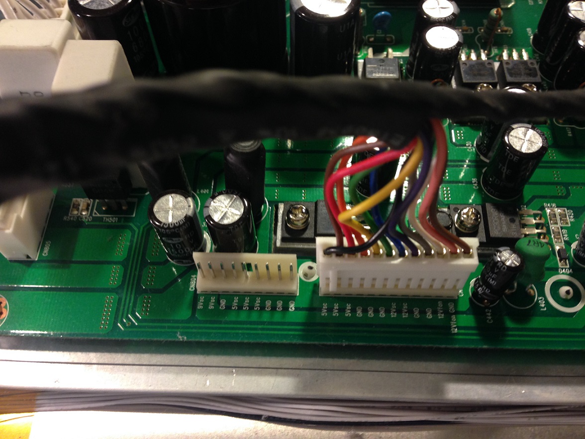

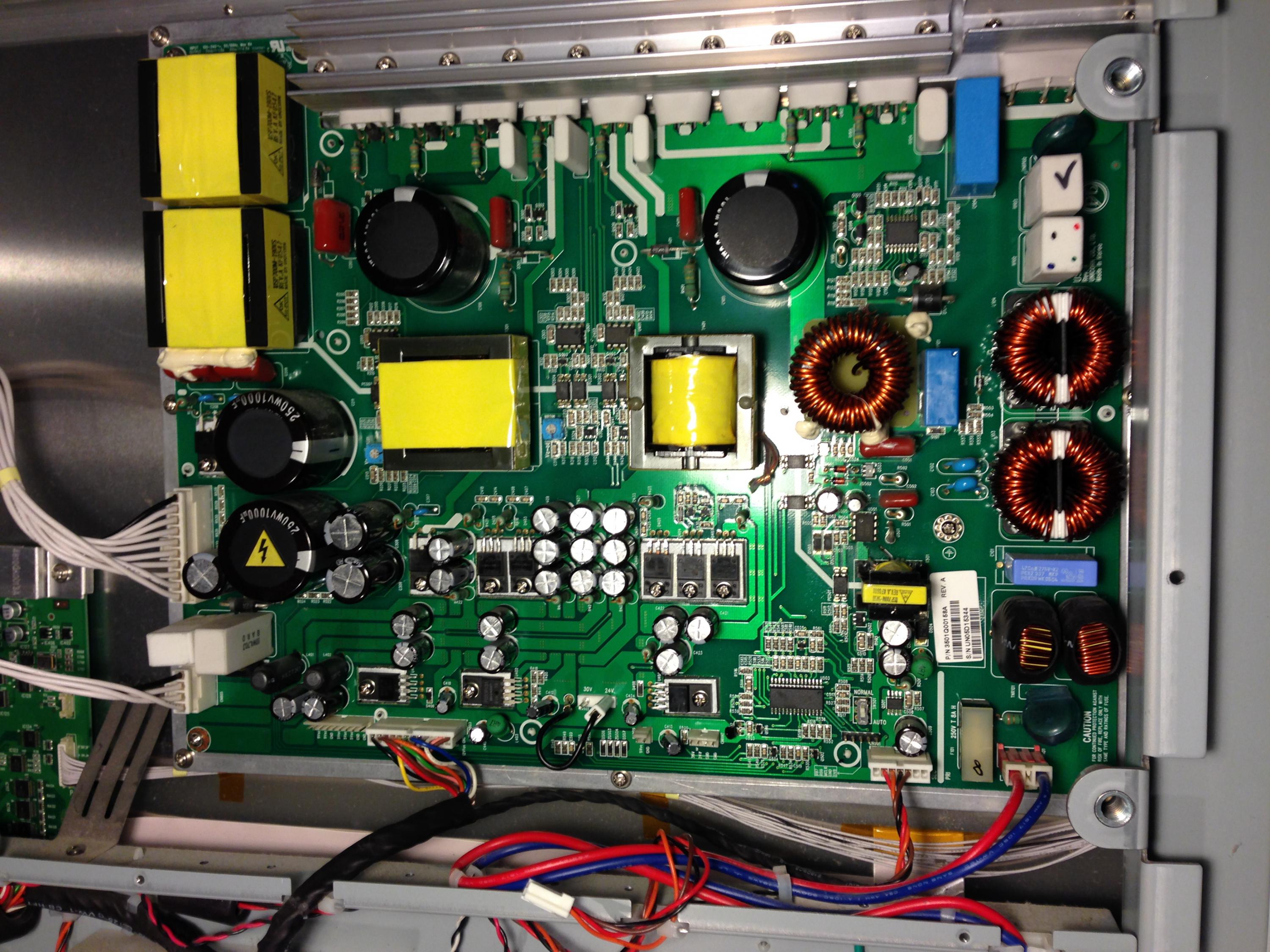

    I've tried to isolate the problem by unplugging the Y-sustain board from the power board – resulted in no change.
    I've tried unplugging just the x-sustain board from the Y-sustain board (since that's how it's hooked up) – resulted in no change.
    I don't see any obvious visual signs of bad caps.

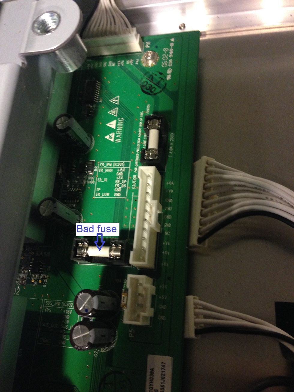

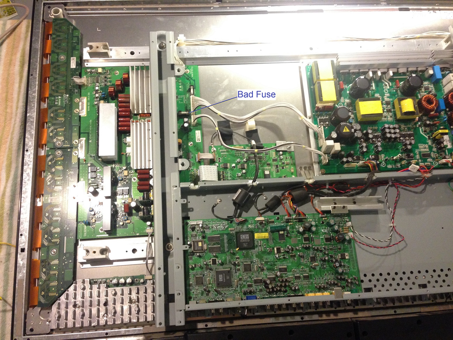

    I did find one bad fuse on the Y-Sustain board, I replaced but it blew again. See pictures for location
    I'm looking for other ideas on what I can test to isolate the problem.
    I'm guessing there's probably a problem with the power board? What do you think?
    I'm handy with using multi-meters and soldering.
    I'd be happy to provide any additional information or pictures if needed.
    Thank you in advanced for any advice.

    If you have a fuse that keeps blowing, focus your search there, the cause of the blown fuse is very likely the same reason why it shuts off.
    Sounds like something is shorted or otherwise bad on that Y-Sustain board.

      Probably shorted Ipm on the Ysus under the heatsink. Check for Vs short to groundn the Ipm.
