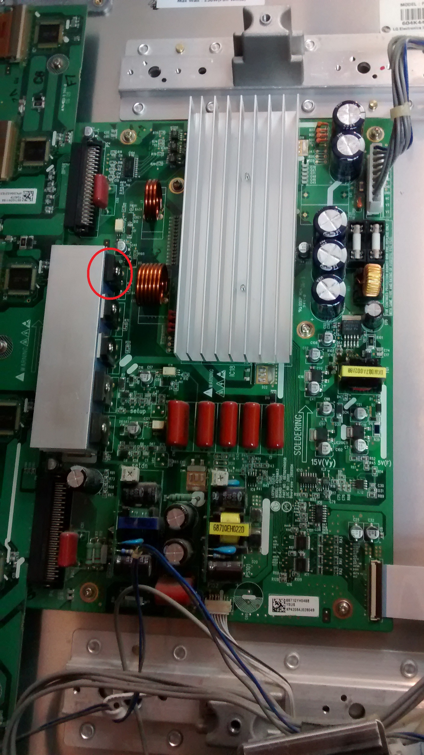

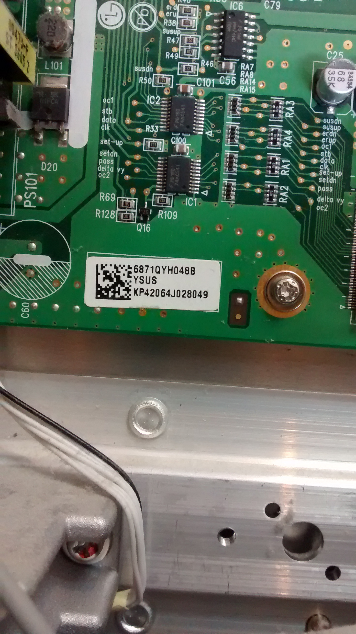

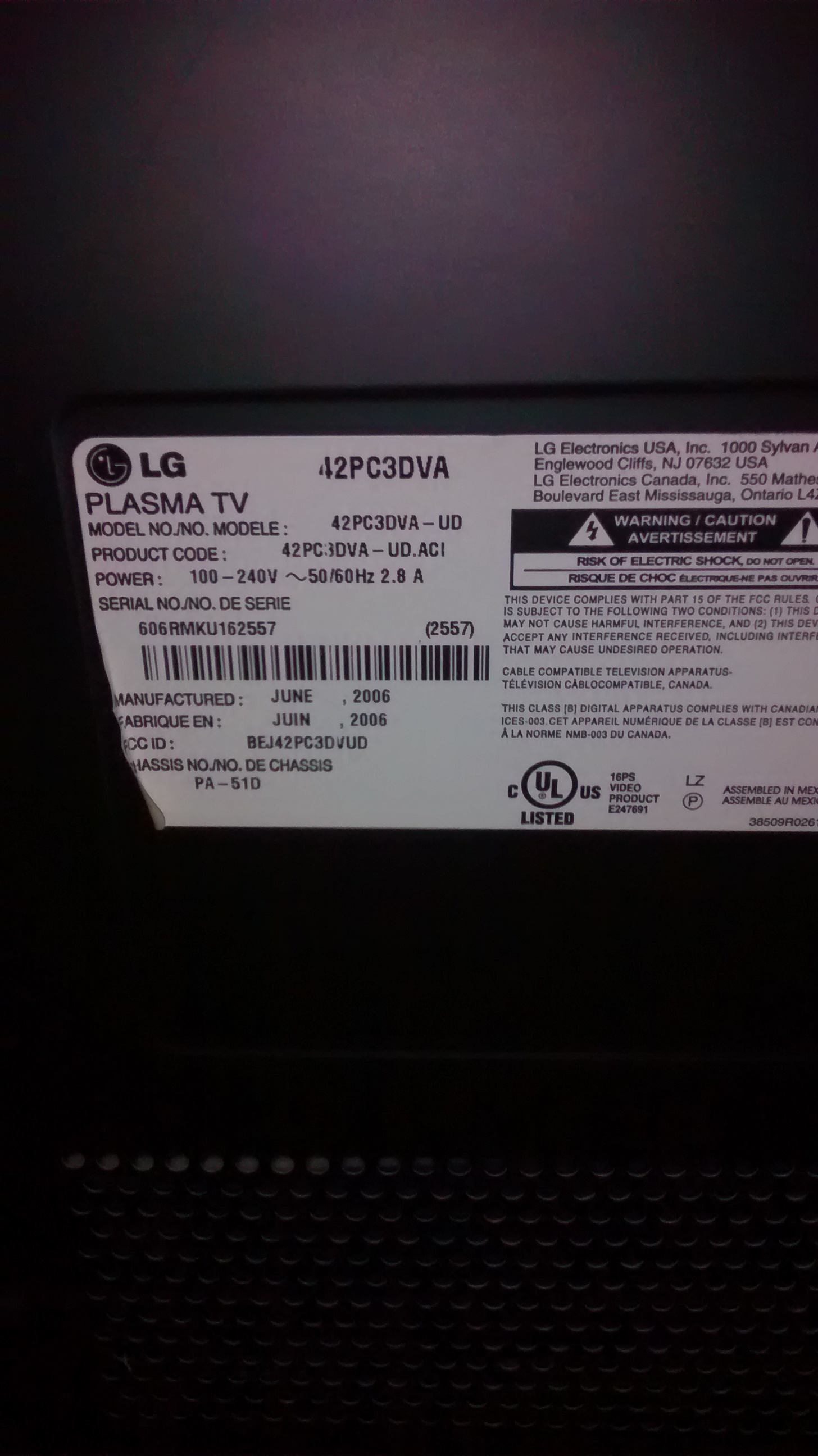

    is there any manual (training or similar) that gives more information than the useless service manual??
    The hybrid module on the Z-sustain was defective, repaired it. Still no picture.
    VS and VA are ok and get to the Y sustain board. The hybrid module on the Y board seems to be ok, no direct shorts are measurable.
    There was one FET shorted, replaced it, nothing changes, it doesn't blow again either. There is humming noise coming from the board... Don't really know how to proceed.

                One fuse on the Z was open, all other fuses were ok. Z is repaired.
                I can't see any other defective semiconductors on the Y.
                I don't know what is supposed to be coming out exactly from the Y board to the buffers :-/ I have a scope to measure.

                          No, there is no glow coming from the screen, it's completely off. The blown FET on the Y sustain makes me think there might be something else on this board....
                            Re: No picture 42PC3
                            If there is no -Vy and Vsc you will not get a glow, so check if these are present. Can be shorted Y-buffer, which will cause no glow.
                                        I get VSC constant 110VDC and -VY goes on and off all the time 0V/5V. Like half a second on then off and so on. There seems to be a problem with this voltage.
                                        Is it save to disconnect the Y-buffer from the Y sustain and turn the TV on?
