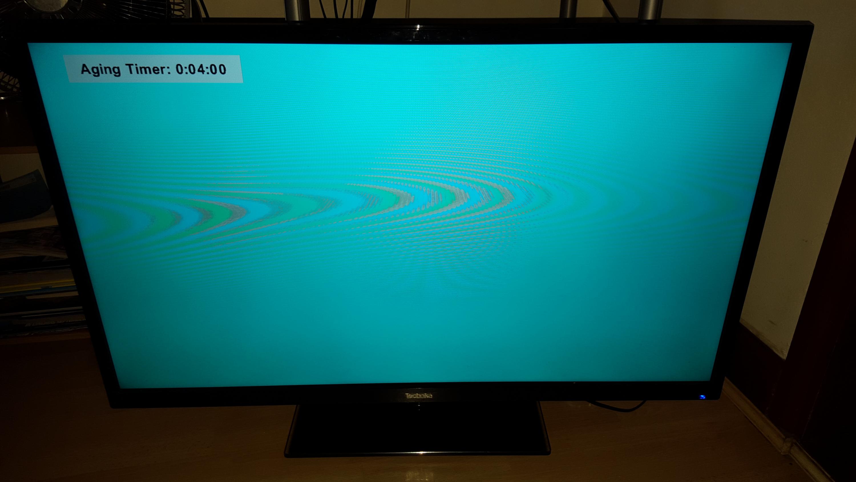

    Hello
    bought this tv today but for some strange reason its stuck on Aging Timer and i cant seem to turn it off !
    tried unplugging the tv etc but it still goes back to this menu
    im guessing someones been messing with factory settings ?
    thanks

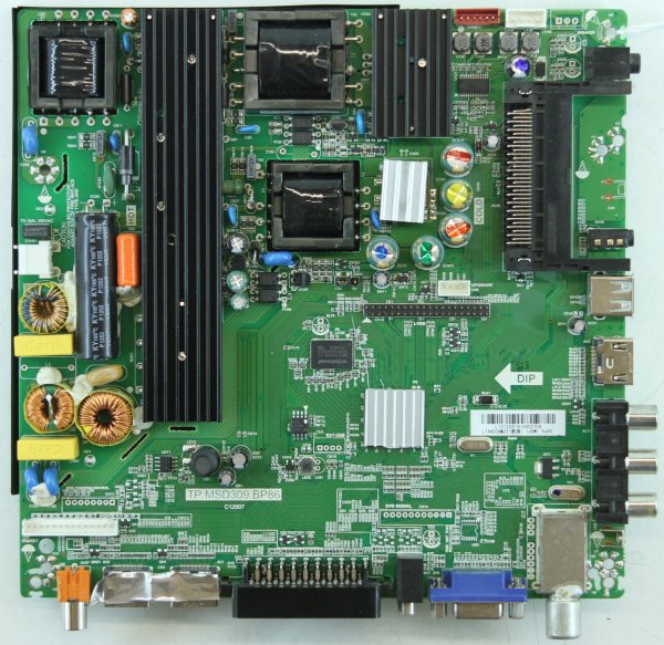

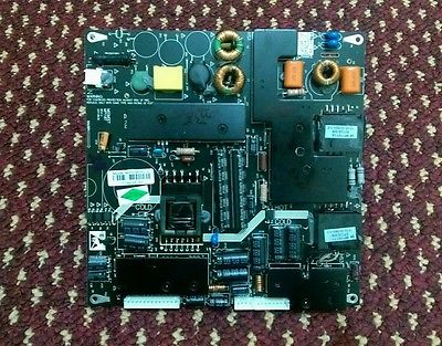

    what boards are in it Sordids999
    • sordids999
      • May 2013
      • 2155
      • uk
      Re: Technika 40-e271
      i have not took it apart yet but going on ebay its looks like its the following :
      Main Board - TP.MSD309.BP86
      power supply -MEGMEET MP118TFL-U REV.1.2
        Right all back to normall now it seems the remote would not work so managed to use the tv controls to turn this off
        im going to change the eeprom as well i think this model is prone for this fault,after all the person told me it wouldnt switch on before they started messing with the settings
            Wouldn't surprise me if it messes up again, the firmware on these is shite. Be sure to test if for a good while.
