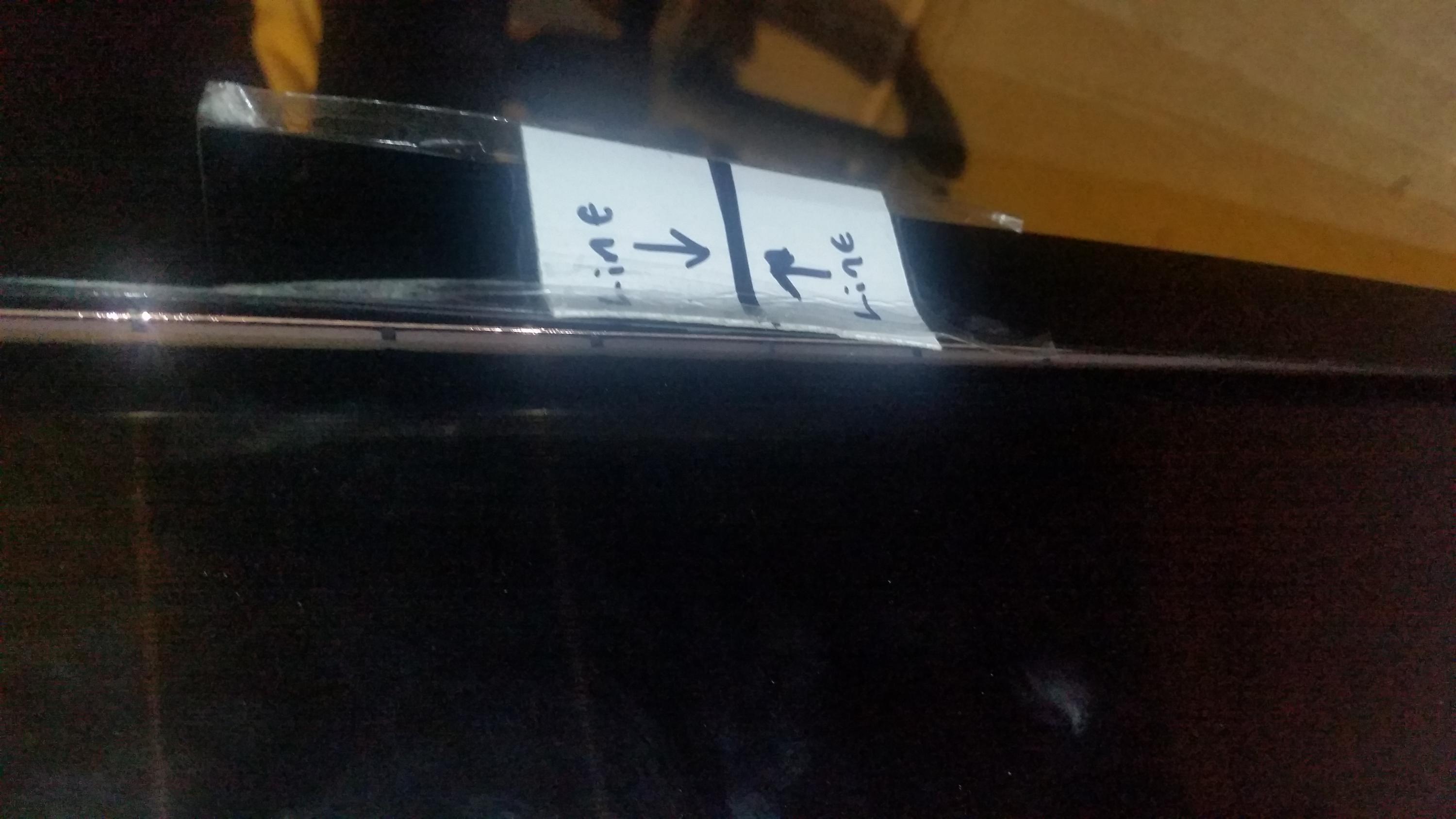

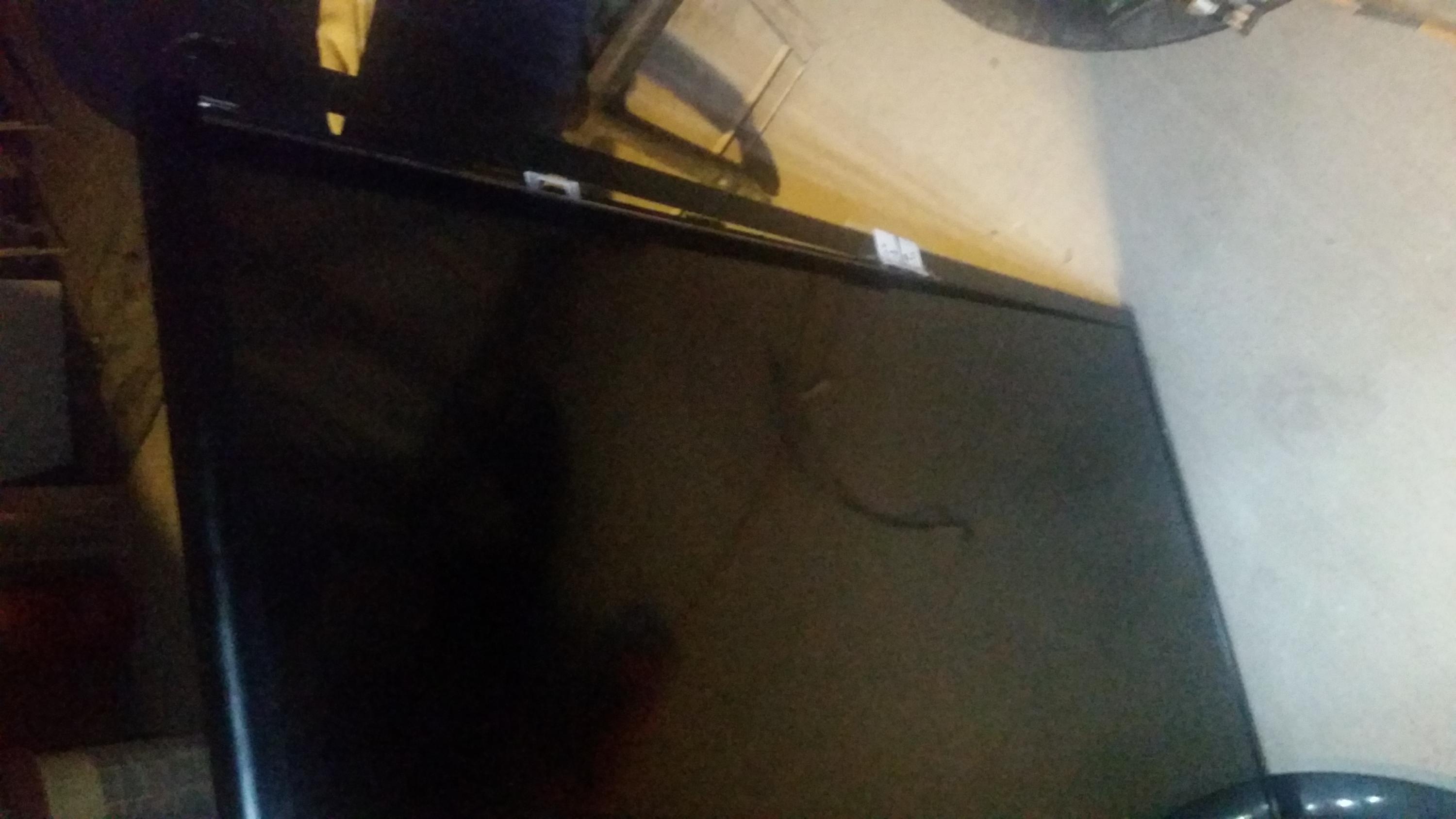

                  #48
                  Re: Sharp AQUOS 70" LCD model LC-70LE550U
                  Ok I threw caution to the wind and removed the 2 boards. The first image is with the bottom only ribbon cable removed as we were discussing. The upper part of the screen remained distorted.
                  Second picture is with the second ribbon cable removed.
                  At that point I could see a pattern and just removed the remaining ribbon cables and these two images are the end result.
                  I think we have a winner folks. Thanks for all your help Bud and freak

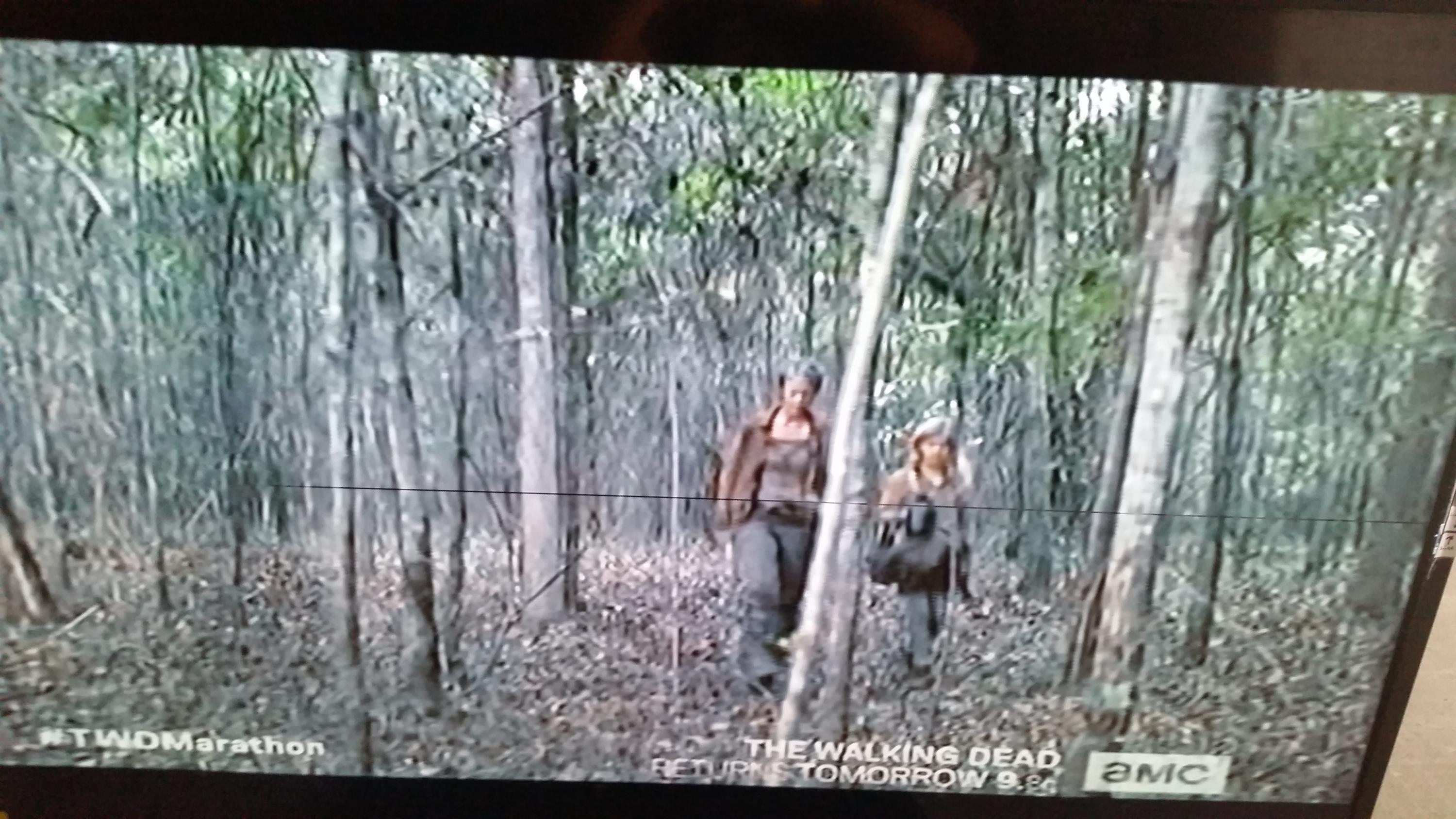

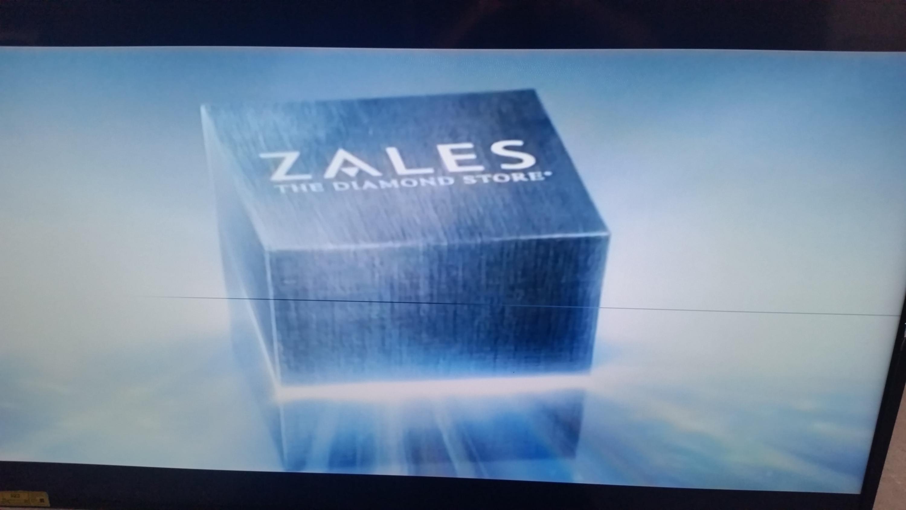

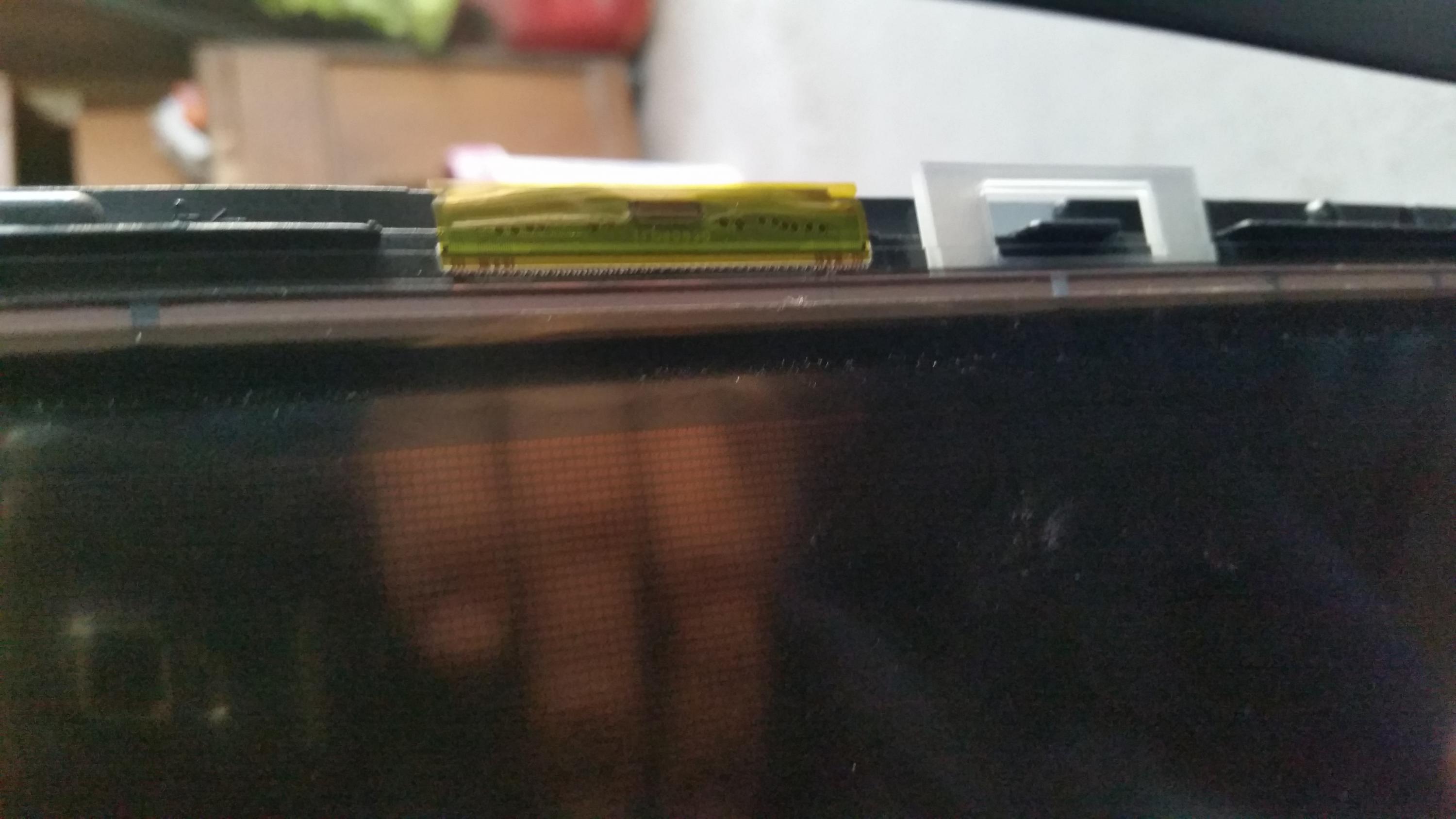

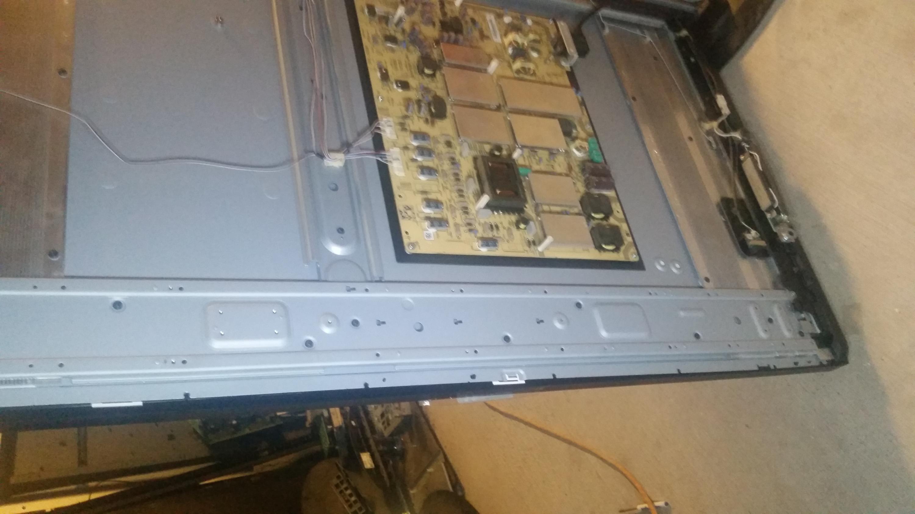

                            Ey freak8 I have a lc-80le757u it has a line in the middle of tv horizontal but these drivers are with no boards it is like a regular lcd tv there bit small. The line comes from the right side, the line stops like at the middle just above that. It won't get to the left side .it has 4 drivers. I did disconnect the 2 right t-con cables and it dI'd disapeared but it got darker screen. I don't know how these drivers work ????
                              #54

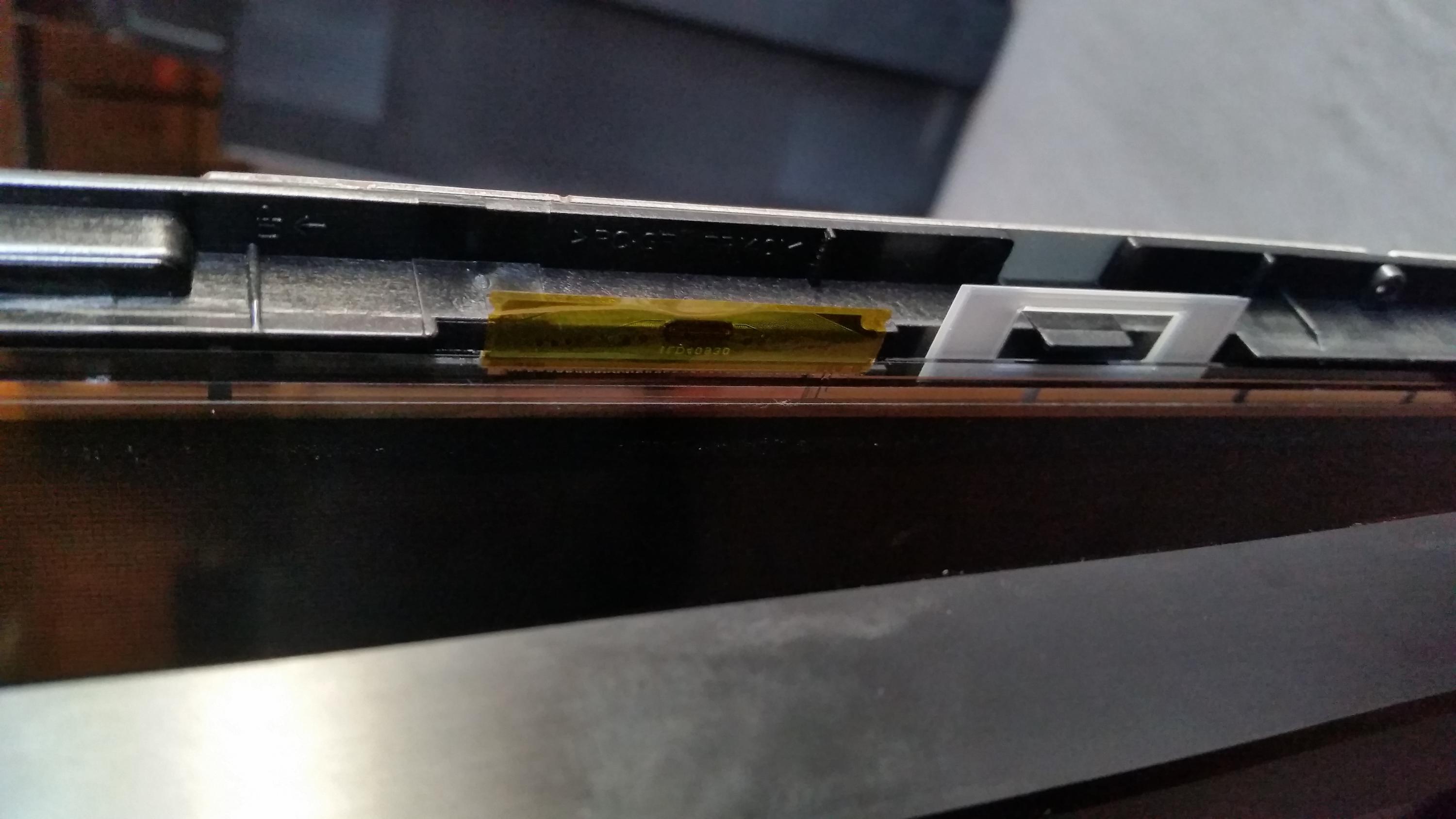

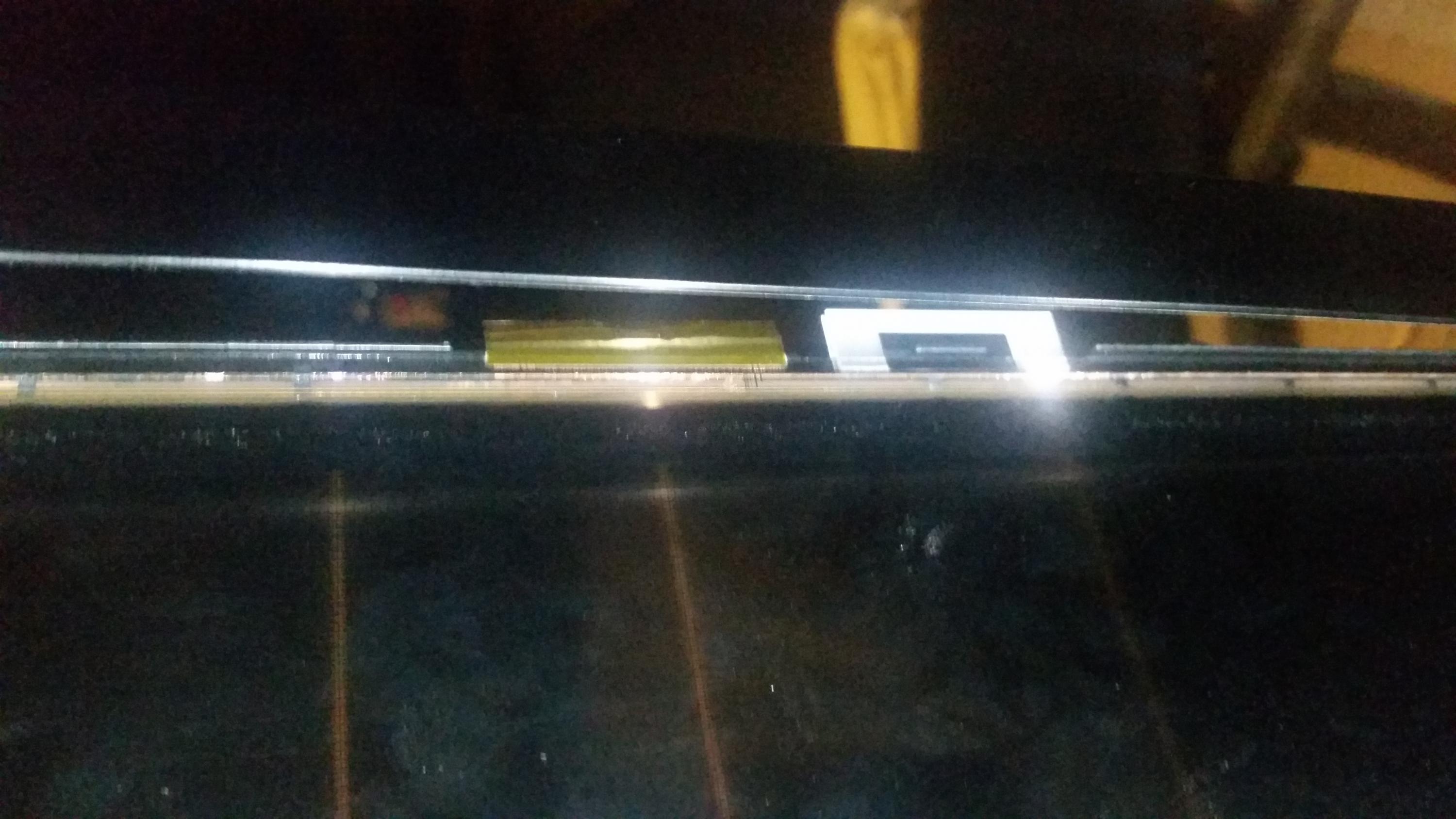

                              post some pictures of each side of the back of the panel. there are tab driver cables somewhere.
                                #55
                                  #56
                                  tough to see due to lighting conditions but maybe the second one shows the brown flex cables if I "understand" the picture. you may have to remove the bezel on one side (hopefully the bad side... where the horizontal line originates from) and get a closer look at the panel edge where the cables are attached.
