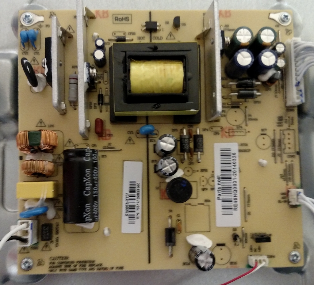

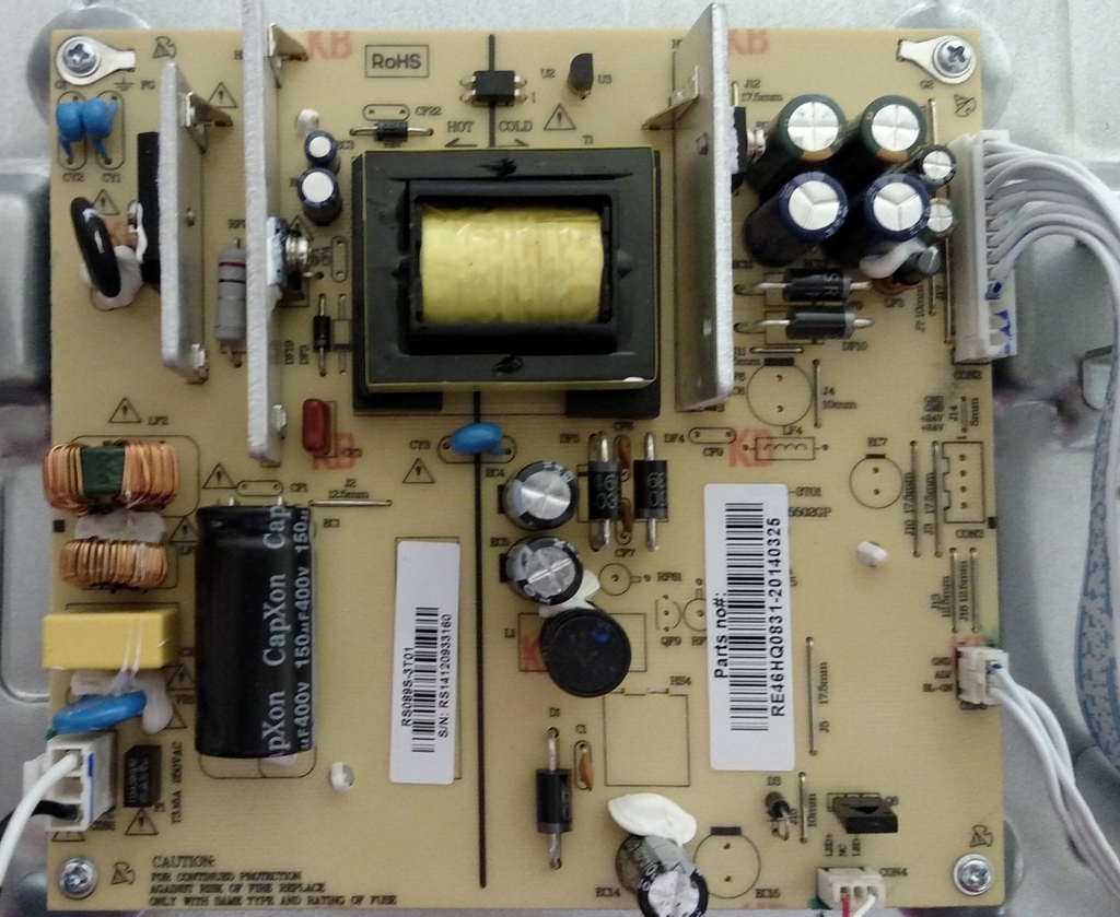

    I have an RCA that just decided not to turn on yesterday, worked fine the night before. No blinking light or standby light. So I opened it up to see if the power supply had swollen or leaking caps. They look fine, no signs of anything burnt.

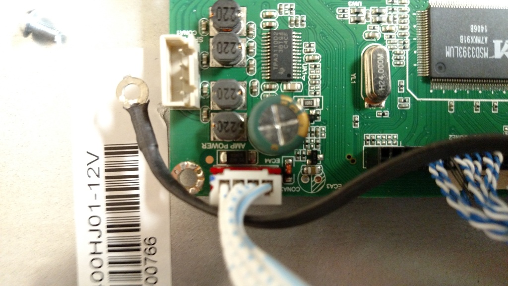

      No I dont. I have checked all the voltages on the main board. The connection that has the +24V only reads 13.98 on both connections. I have more pics if needed too.

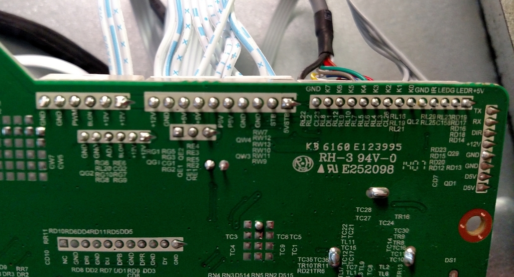

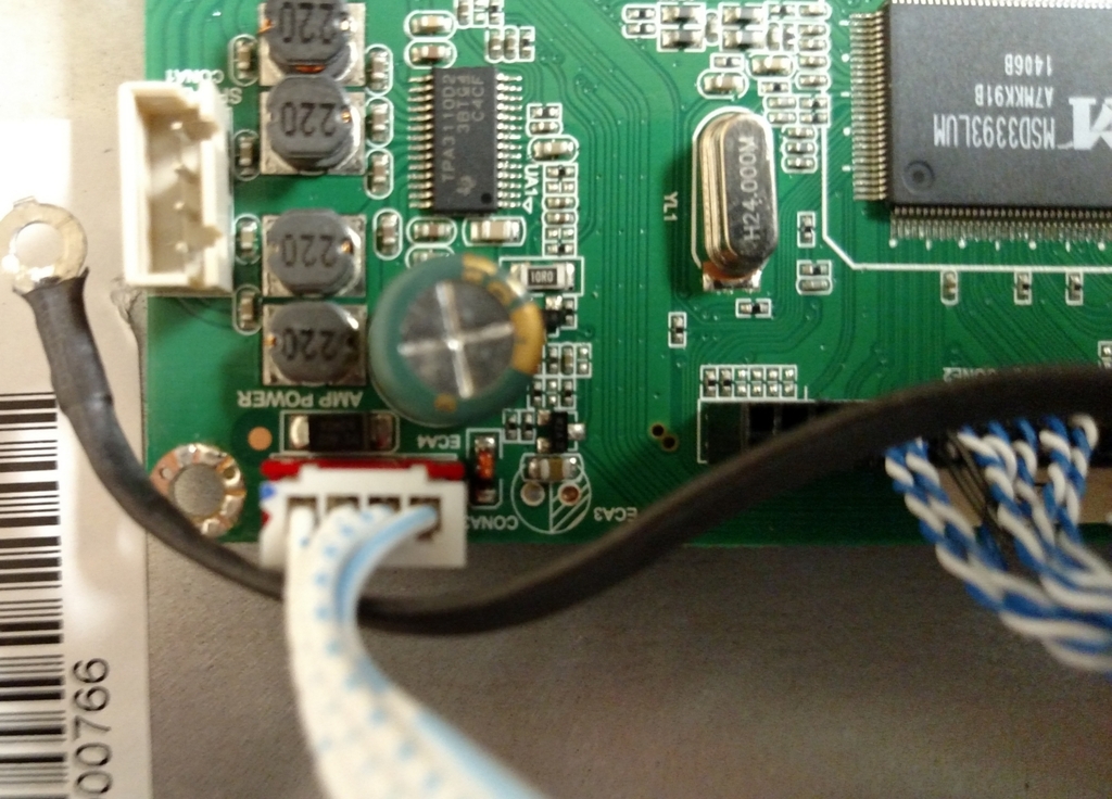

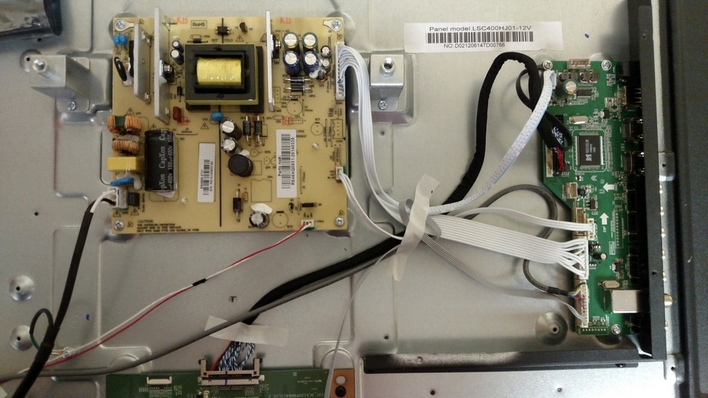

        Some of your readings do not make sense, one connector has BL-ON of 2.6V, but 0.1V on another connector?
        GRD has 2.9V?
        24V Pins have only 13.98V?

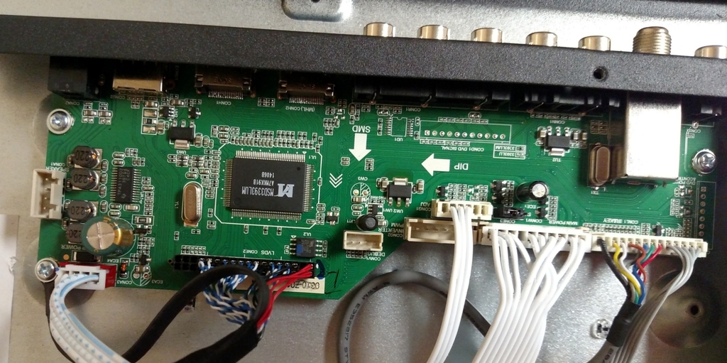

        How about up loading some good clear straight shot pictures of the whole boards and the whole back side of the TV so we can see how all the boards are connected together?

          I re-tested all of those connections and the readings are correct.
          I will upload more pictures. I will have to wait till in the morning to take more shots of the back of the boards.

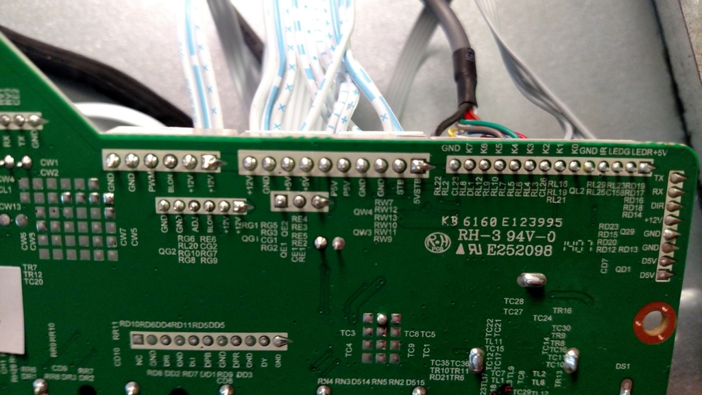

            A few more pics. The other pics show the connections on the back of the boards.

              Well, I cannot see how GRD (GND) pin can have 2.9VDC on it.
              What did you use for GND ref point for your meter?

                  First thank you for the help bud.
                  I used the chassis on the TV the other grounds reads 0 that I checked.
                  On the red LED+ W/ connector removed reads 116.0V / white still reads 71.4v

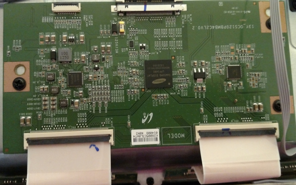

                  I noticed this morning the power supply board is making some noise. I originally suspected the power supply but did not want to just buy parts that are not needed. But the GRD reading and the +24 readings I dont understand either.
