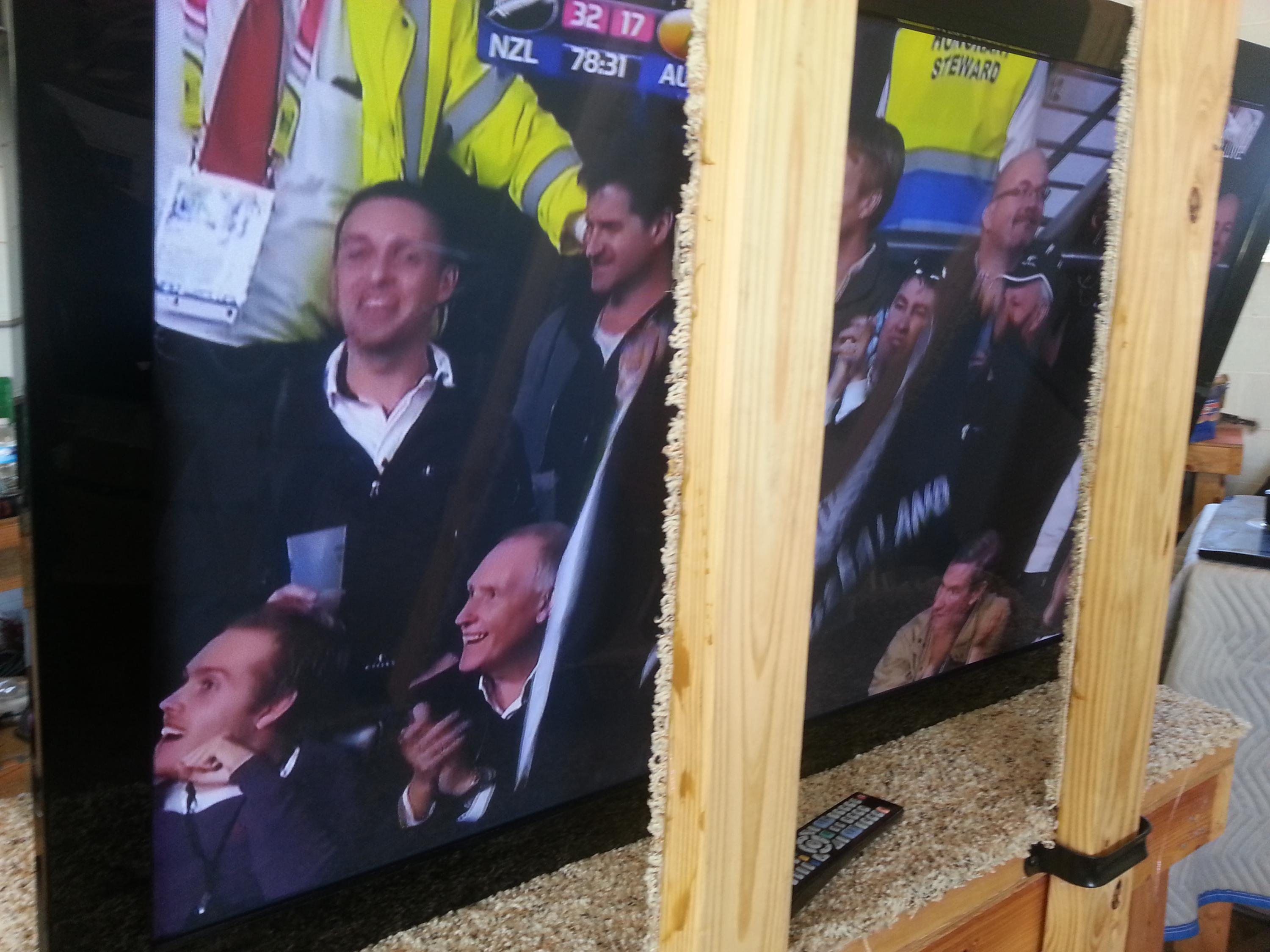

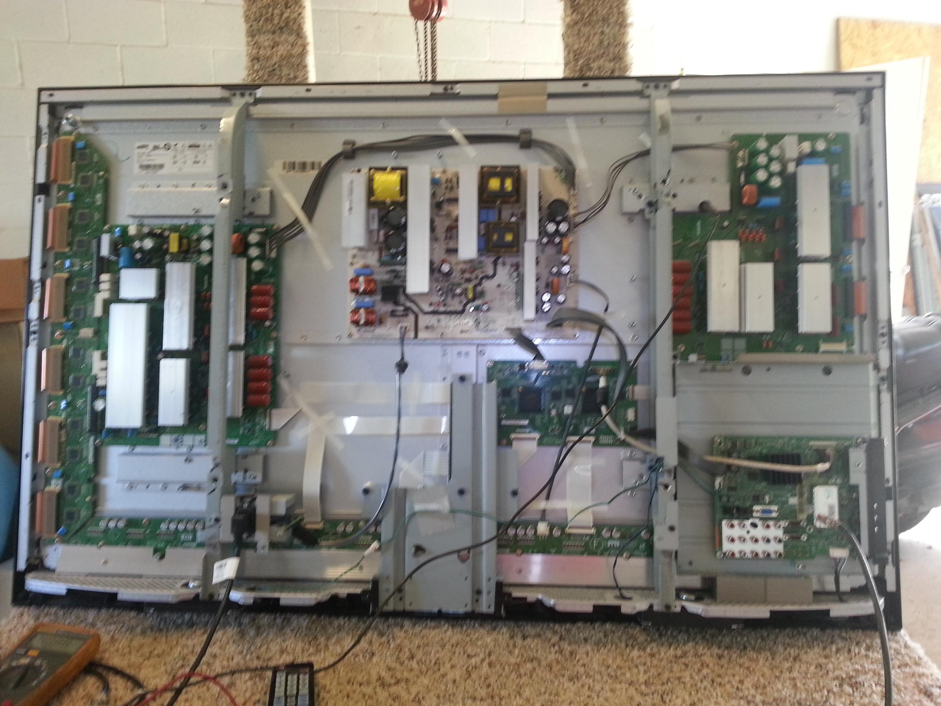

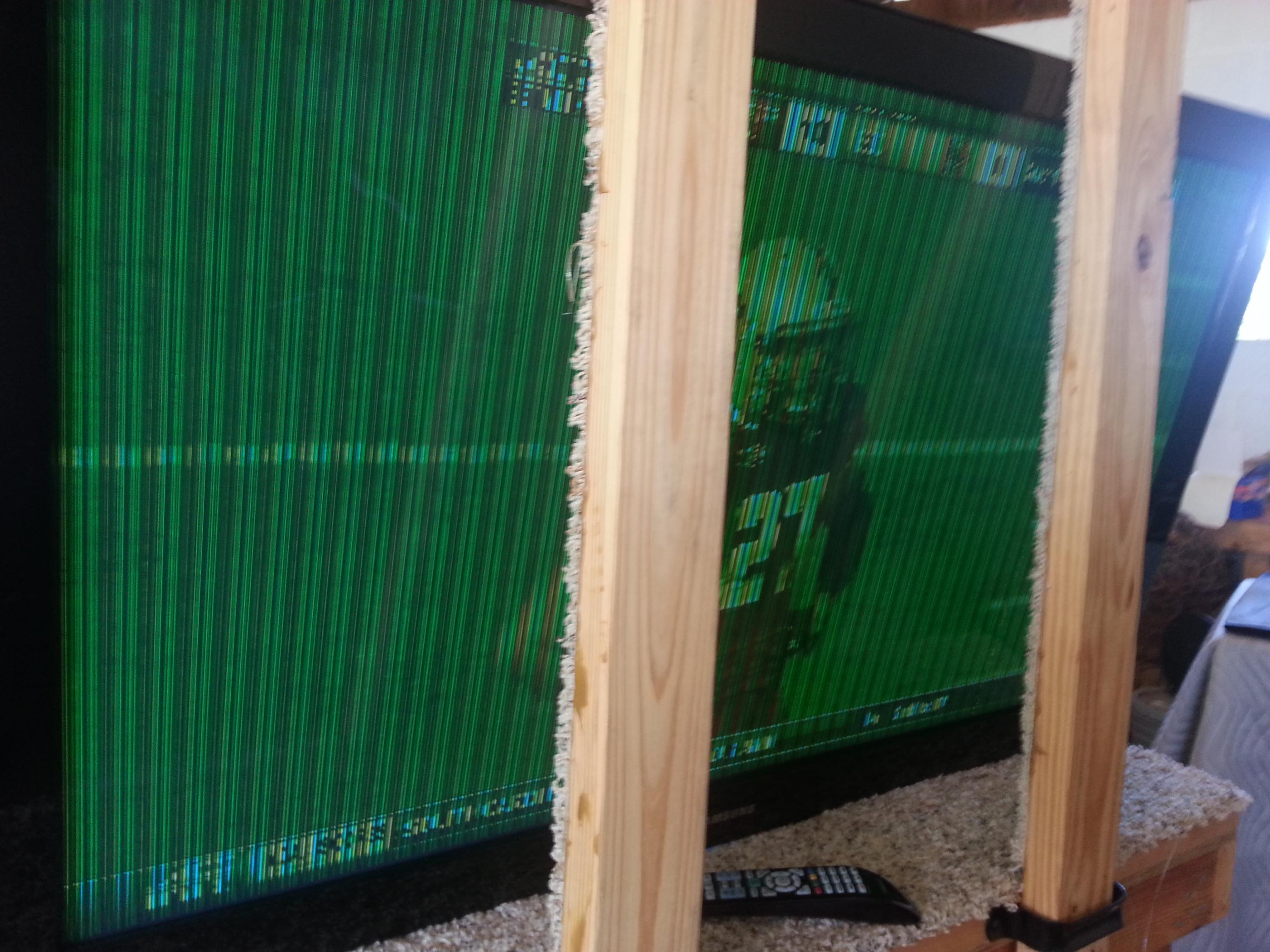

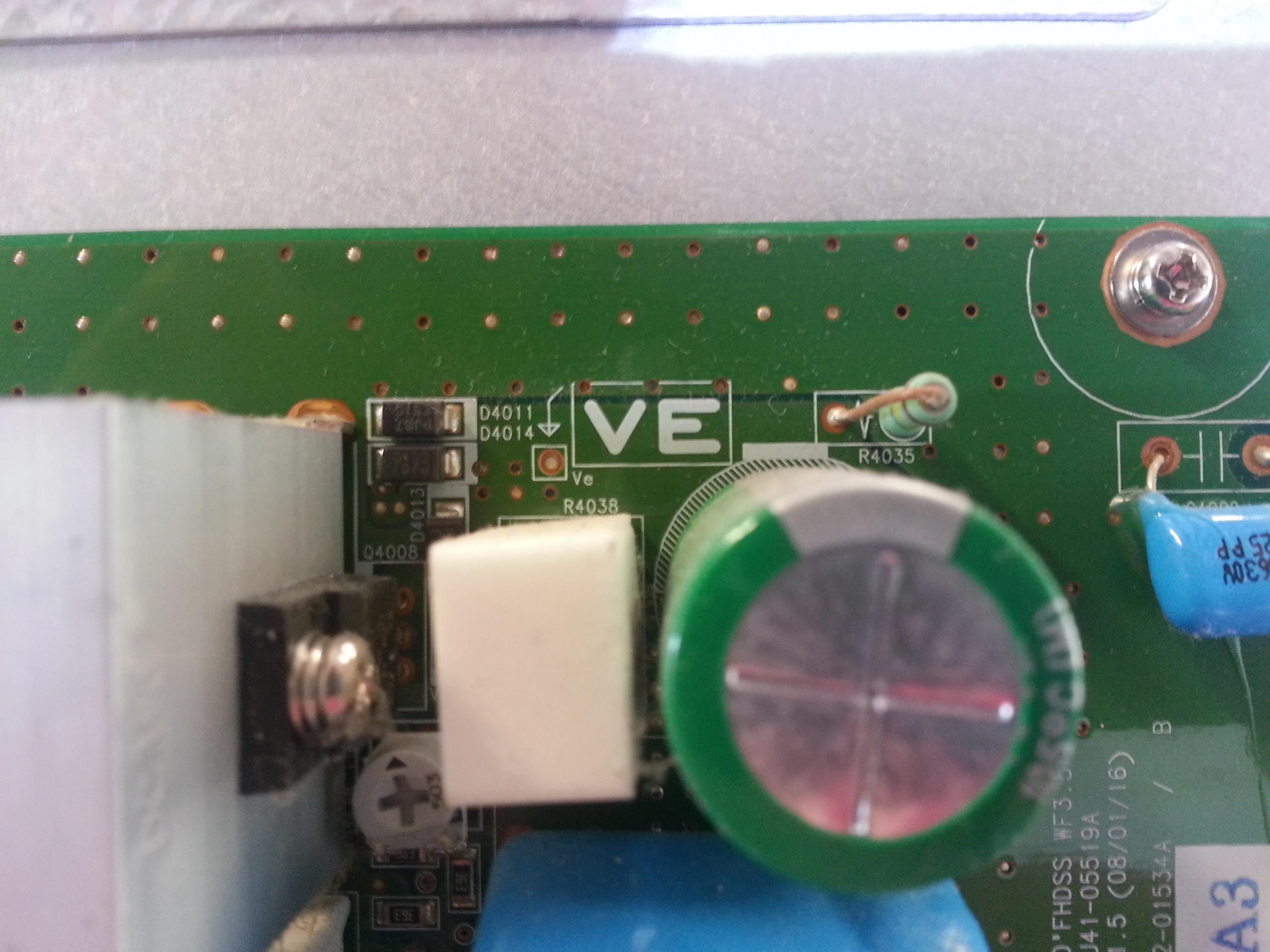

    I have a Samsung PN50 circa 2009 that I picked up. hard starting was the reason it was mothballed. I removed smps and went over(reflowed) all solder joints of items on heatsinks and all major power diodes as I have done this on another PN series plasma with success. Upon startup , I get the jingle then relay clicks then a high pitched squeal with fine vertical lines as in the picture. It will continue to shut down and try to restart on it's own four, five, even six times. Eventually, it will start and deliver awesome picture and sound. Vs is good as is Ve, I cannot find test pad for Va, Vsc is not good. Found test pad on Y main and measured -50 to -53 volts, (even when running with good picture) should be -196 according to label on pdp. Once it starts, it will run for as long as I want to run it. Turn it off and as long as I restart it within 60 to 90 seconds, starts right back up..waited 5 minutes, back to the squeal with the lines. Is Vsc generated on the smps?

    Kind of a dumb question...wasn't it..Vs and ground are sent from smps to Y main. Vsc must be developed on the Y main. Thus a measure of the performance of the Y main.

      Ahh well, let me state the following:
      Psu Vs rails wont cause lines out on the Pdp.
      Failed Ymain or Xmain wont cause lines out on the Pdp
      What could cause this is either the mainboard or control board which is located to the left of the mainboard.

            Well shazam! Heated main board and she came right on..
