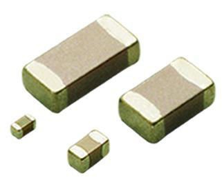

    Ahh more Vestel shit lol. Have you checked the MLCC's for S/C Gary common fault on these which will cause no standby failure ?

      Hi mate what are they? sorry im still quite new

        Hi mate, no worries here is what one looks like:

          oh i thought they were called caps lolol
          i will have a test and report back thanks mate

            No worries to test, put one of your probes on to ground (I use the Vga socket) and see if that cap is shorted to ground. Only on side of the cap should show shorted to ground if both do you have an issue some where.
