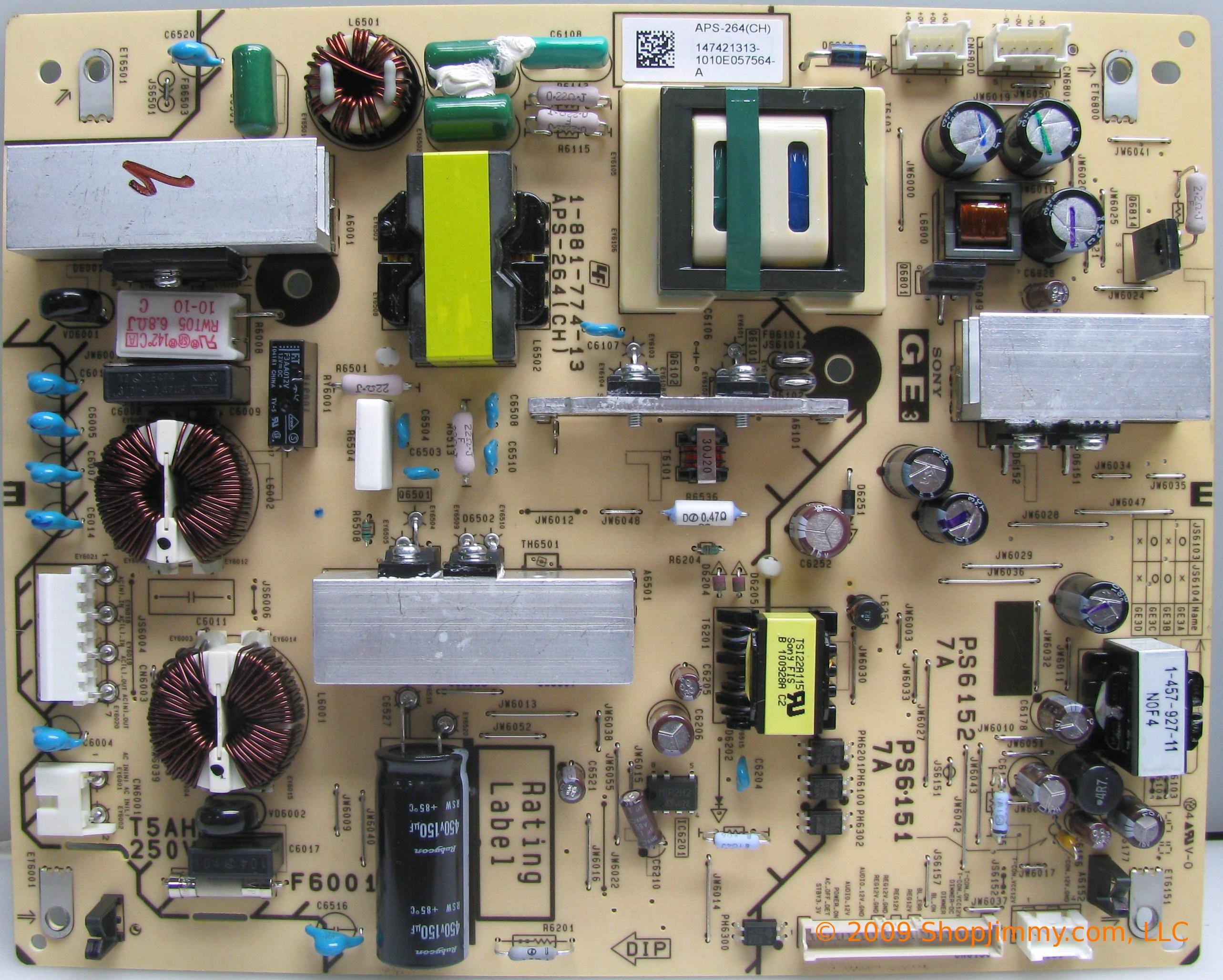

    Power on cold, set works great for a time then it power cycles off then on (green light off then on). Works for a minute or two then power cycles again, however green led stays lit and no picture or sound comes back.
    No error codes, power button still cycles relay on/off but no backlight or sony boot screen etc.
    when checking -out1 -out2 and +out1 and +out2 (to ground) i get
    before failure (power led on, normal operation):
    -OUT1 69.6
    -OUT2 69.6
    +OUT1 148.8
    +OUT2 148.8
    after failure (power led on but no operation):
    -OUT1 0.3V
    -OUT2 0.3V
    +OUT1 99.6V
    +OUT2 99.6V
    I have downloaded the service manual and training manual.
    Does anyone have any ideas where I should begin on this?
    (photo is from shopjimmy but is exacted same model and revision# from my set)

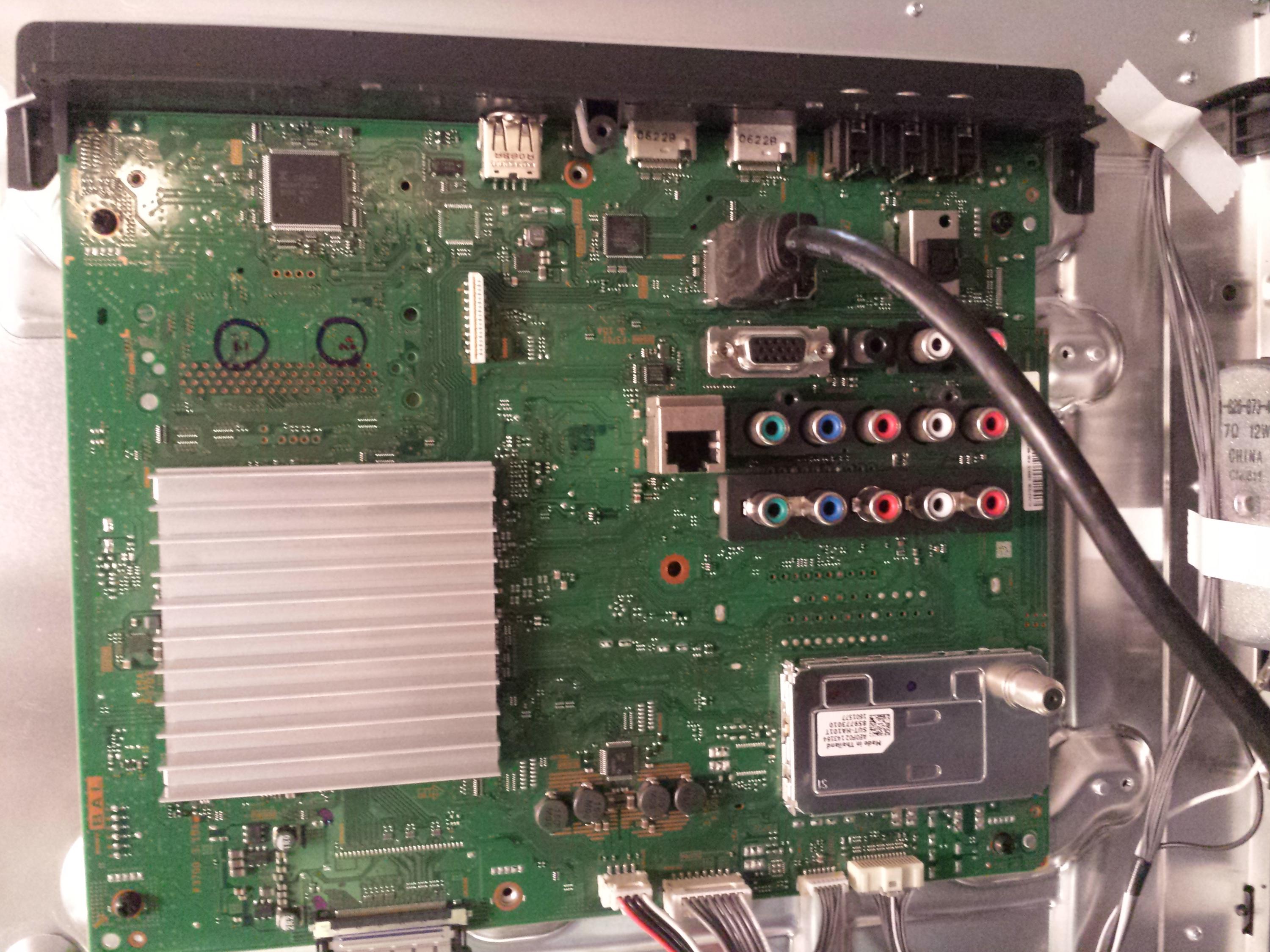

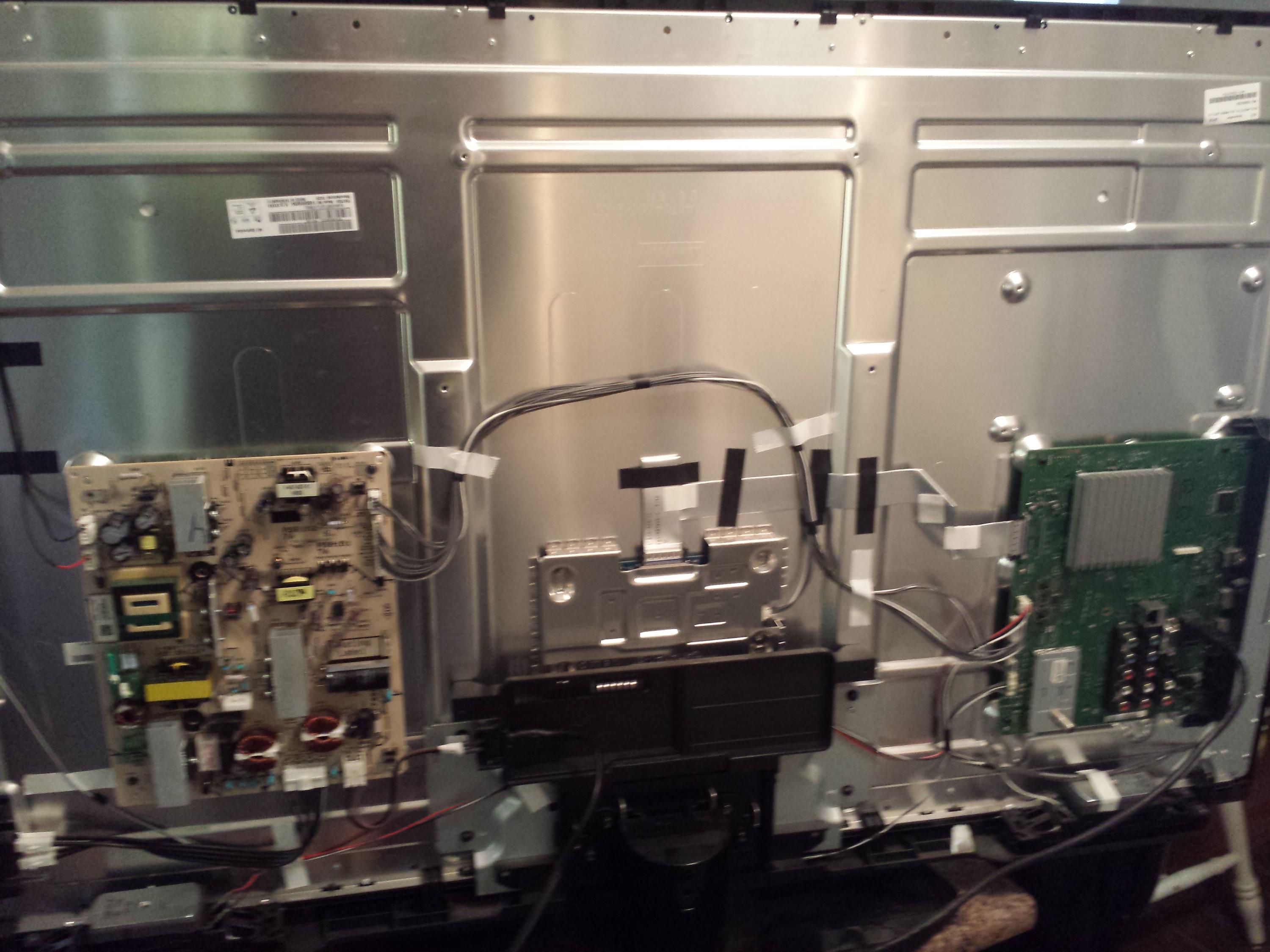

    Need to check the DCV of the connector of the power supply board that goes the main board to see what is/are missing when the TV does not work.
    We also need the pictures of the whole backside of the TV so we can see all the boards.

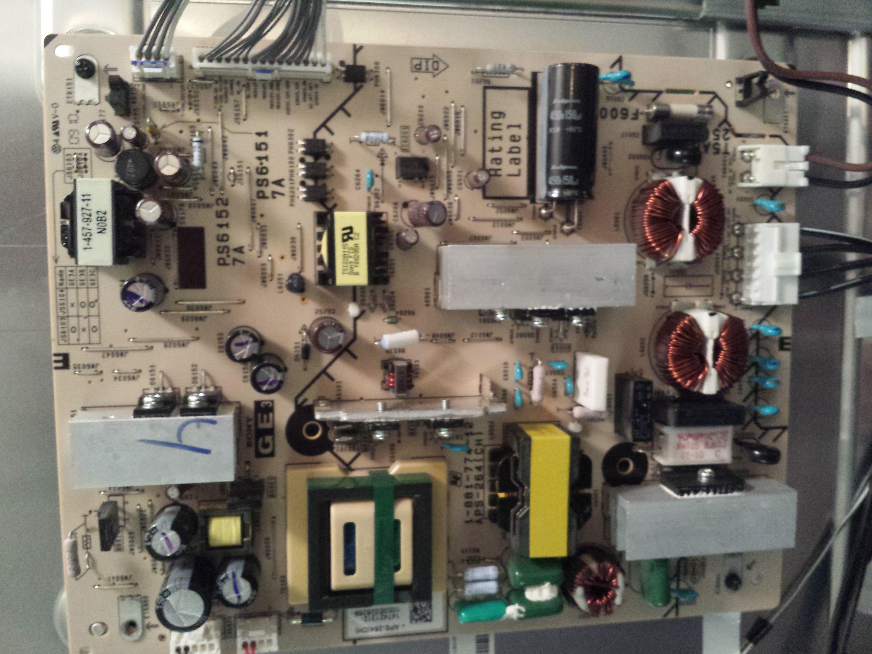

      Re: SONY KDL-46EX710 no error code failure
      here you go
      cn6150 plug to mainboard (when no picture)
      tcon_on 3.3
      tcon vcc12 12.6
      dimmer-dc 3.3
      dimmer 1.17
      bl_on 0
      bl_err 3.3
      reg 12v 12.6
      reg 12v 12.6
      reg 12v gnd 0
      reg 12v gnd 0
      audio 12v gnd 0
      audio 12v 12.6
      power on 3.28
      ac-off-det 3.3
      stby 3.3
      if you need any other values I can get them
        'bl_on 0': Main board is not sending the backlights on command to turn on the backlights, it must have been present for seconds before dropping down to 0VDC because you did see +OUT1 148.8
        +OUT2 148.8.
