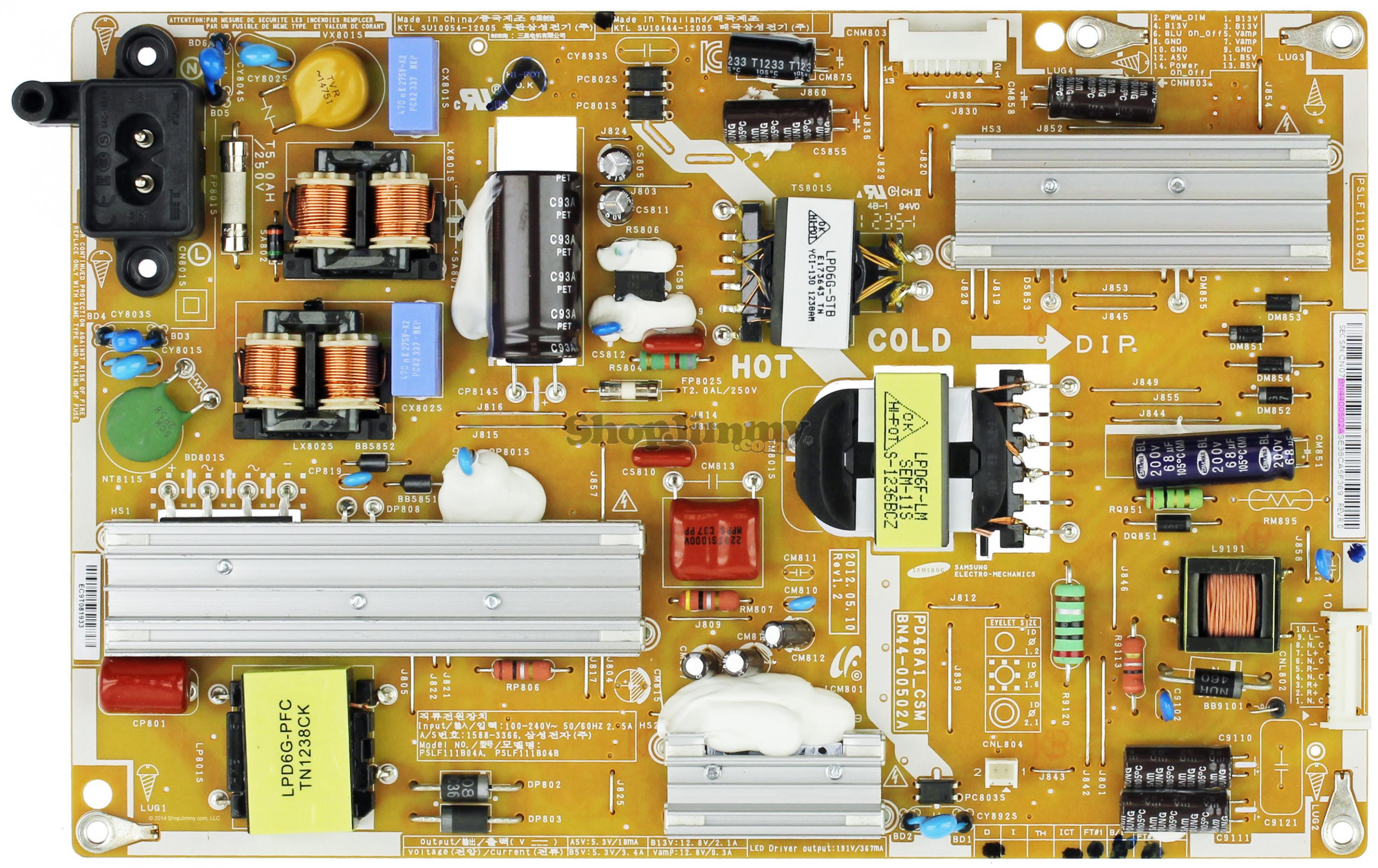

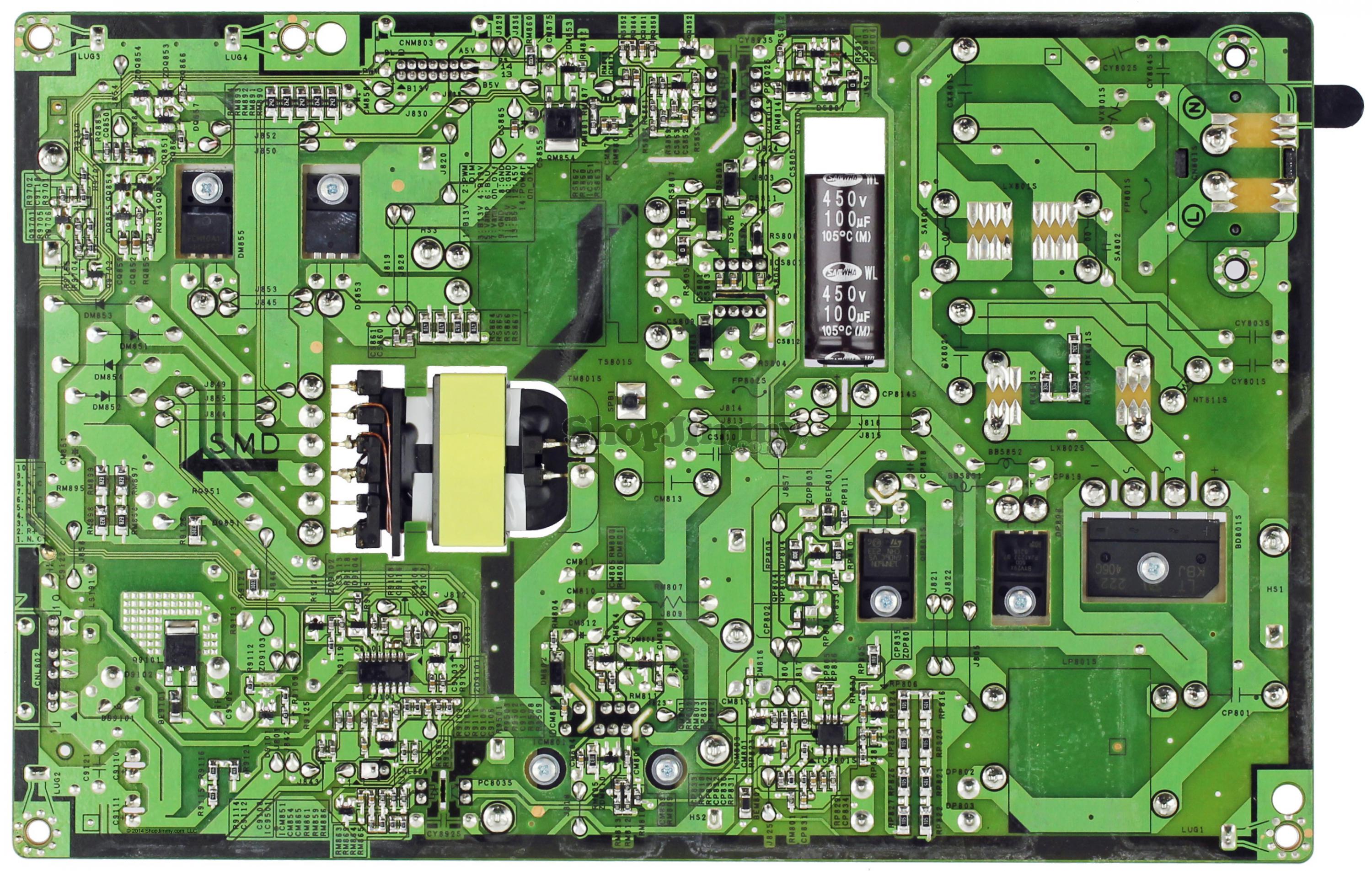

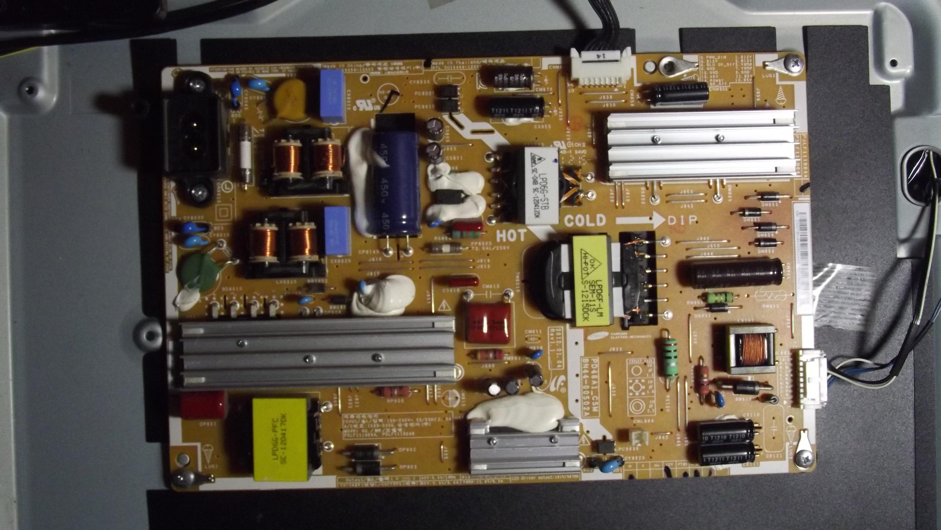

    So I was handed this set that has audio, an image on screen but no backlight at all.
    It has a BN44-00502A power board and I can't find any information about it at all.
    Over all the board doesn't appear to have any damage, caps visually look fine.
    I'm ready to start testing voltage and anything else I might need to but without any knowledge of what value should be at any point I am totally lost.
    It doesn't help that I am a complete nube at this but I am adapt at figuring things out, got a whopping 3 sets fixed so far.
    Any help, advice, encouragement or the next winning loto numbers would be greatly appreciated.

    Try looking at the TV in the dark room to see if you can see the backlights even flash on for seconds or not, if not then we need to find out if the main board is sending the BLU_ON on pin 6 and the PWM_DIM on pin 2 of the connector CNM803 or not.
    You may also want to check the solder joints of the transformers'legs, the 3-pin of the power devices hwich are attached to the heatsinks.
    If the command signal are there then we need to look at the LED connector to see what kind of DCV we have when you first turn on the TV (the meter must be in place when you turn on the TV since we want to see if the DCV does jump up and drop down or not).
    Pictures provided by shopjimmy.

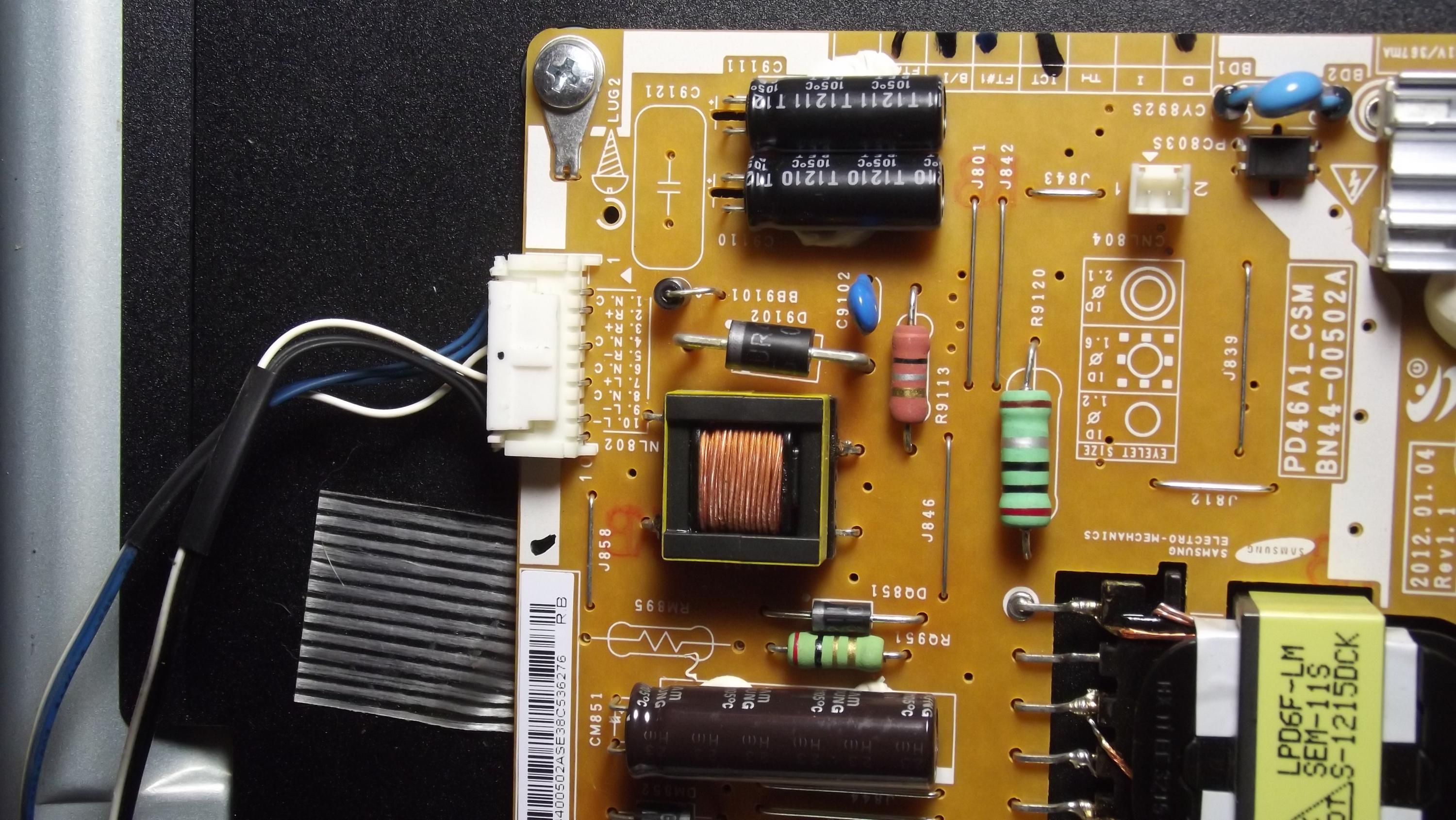

                  Re: Samsung UN40ES6100 no backlight
                  OK, pin #2 is at .437
                  pin #6 is at 4.94
                  • dsc
                    • Aug 2015
                    • 53
                    Double checked the solder joints, all test/check out OK.
                    To be certain I am testing the right legs, #2 is clearly marked so I moved over two legs on the same row for #6.
                    I soldered a test lead on each to make it easier.
                    Would the IC 9101 cause the off reading?
                    I pulled the connection to force the backlight prior to asking for help with no results.
