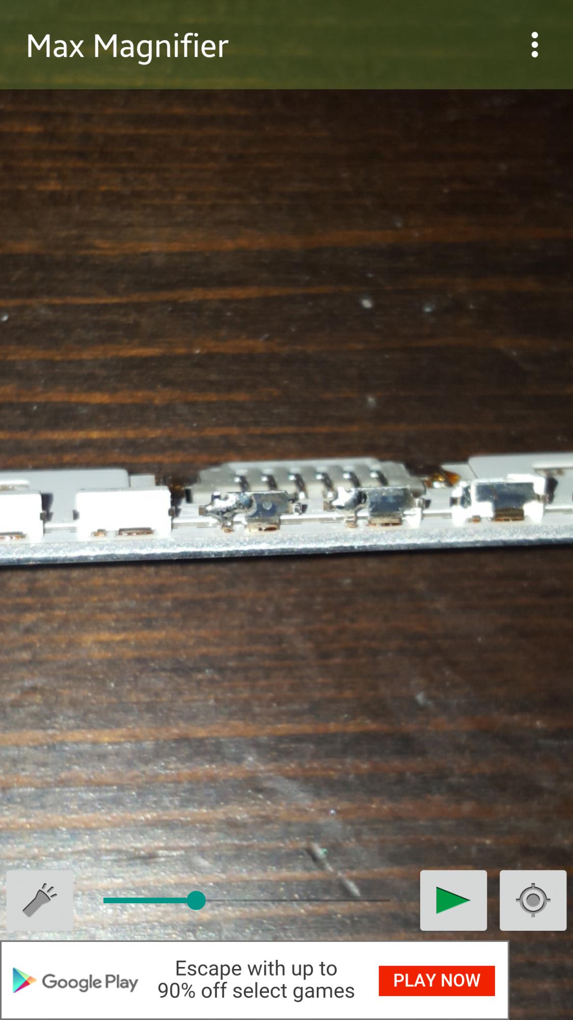

                    I got my UN40ES6100 working again. I removed the RH LED string and found several obvious problems. Problem 1: One LED on the lower portion of the string had a burn mark on the face, it was open. Problem 2: Three LEDS on the upper portion had the plastic exterior of the LED flaking off. Used multimeter in diode mode and found two off the three were open. Also noticed that on most, if not all the LEDs, the plastic exterior was at least cracked on the backside (fine cracks, not severe). On all three of the open LEDs, I carefully stripped the plastic exterior off of them. Under the exterior there were two terminals with a fine gap between them (see pictures). I simply joined the two terminals with a dab of solder. I re-assembled RH LED string into TV and checked operation. Presto, LEDS were on. The full LH string operates. On the RH string, obviously the three LEDS I soldered did not illuminate but there were also two or three others that did not light either but had no real obvious signs of damage. Since they were not preventing the entire backlight from working I did nothing with them at this time. I reassembled the TV fully, turned backlighting setting down to 2 and it has been working for about an hour and a half now. I assume this fix will only be temporary since there were obvious problems with other LEDs, it's only a matter of time before a couple more go open. For this reason I will keep looking for replacement strings to be in stock and get them when they are. I will probably wait for it to fail again before installing them. Budm: I sent some money to your PayPal to say thanks.

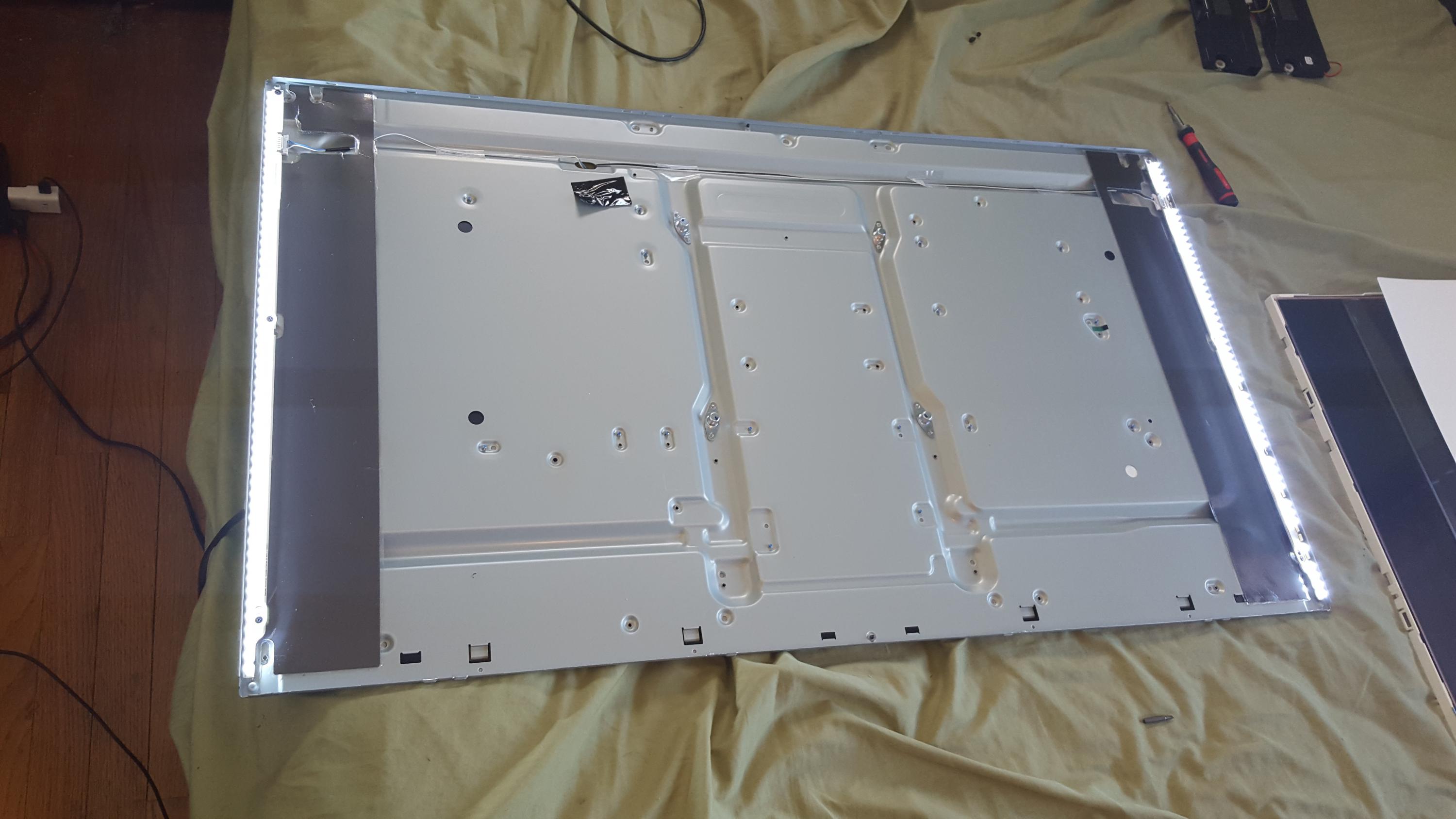

                        After a delivery delay and some time off I finally got around to installing the new led strips and giving them a quick test. I must say they shine brighter than a newly polished 57 Chevy bumper.
                        I'll assemble the set tonight and give it a full test.
                        Now I've got a bunch of LED's as spares incase I run into another set or want to make something.
