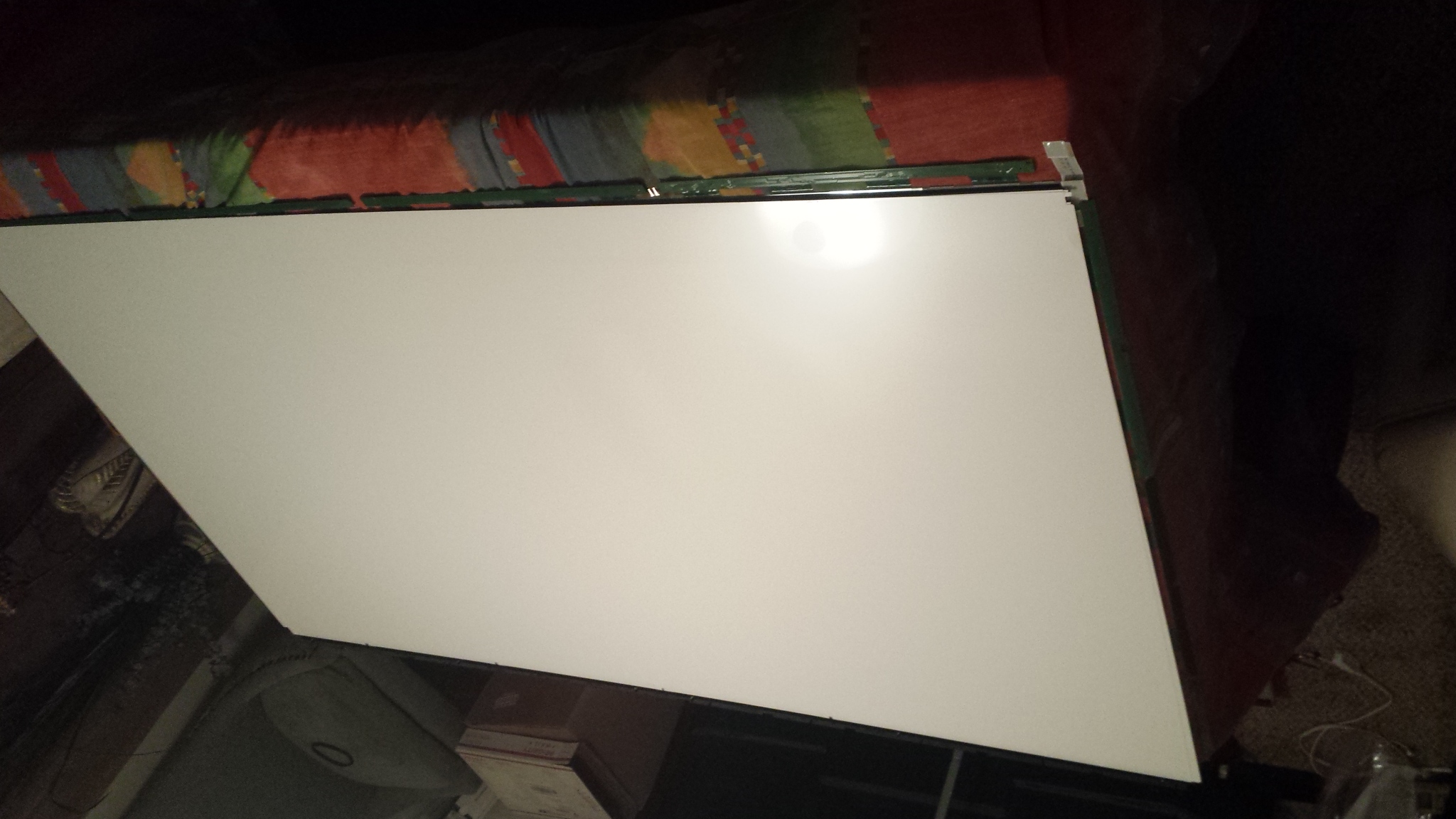

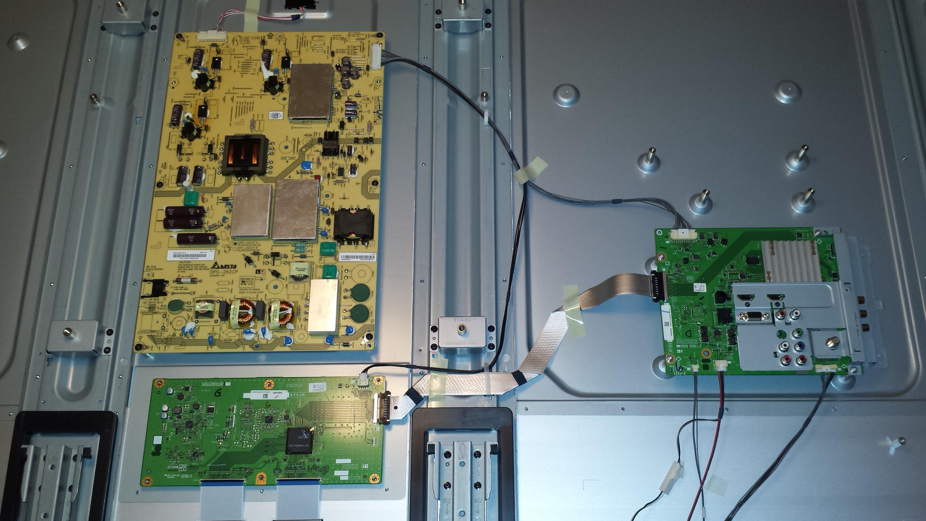

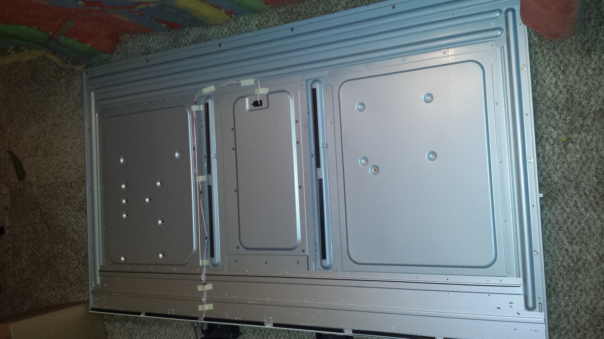

    So, I picked up a used 70" Sharp Aquos LC-70LE600U set that failed due to an LED lamp error. The front status LED flashes a slow on then off. The set will startup in service mode and the lower section of the right side of the display has a dark back-light section. I just cracked it open and will start taking some measurements when I get more time. So far the output fuses on the main board seem to be fine. My fear is that there is a bad LED edge strip...I really don't want to have to remove the display but it might come down to that.
    I will attached some pictures and the service manual. Any advice on things to look out for is welcome!

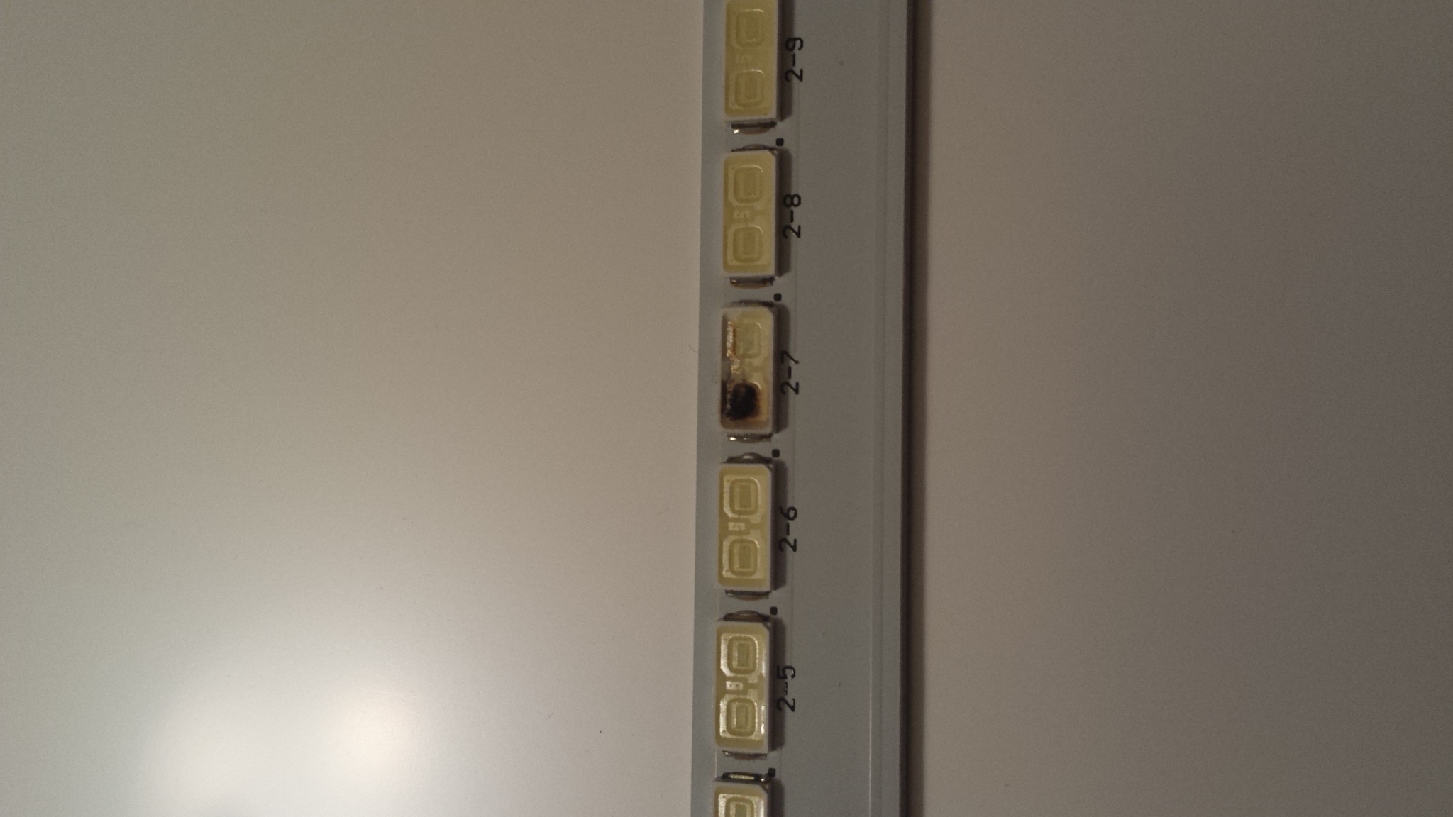

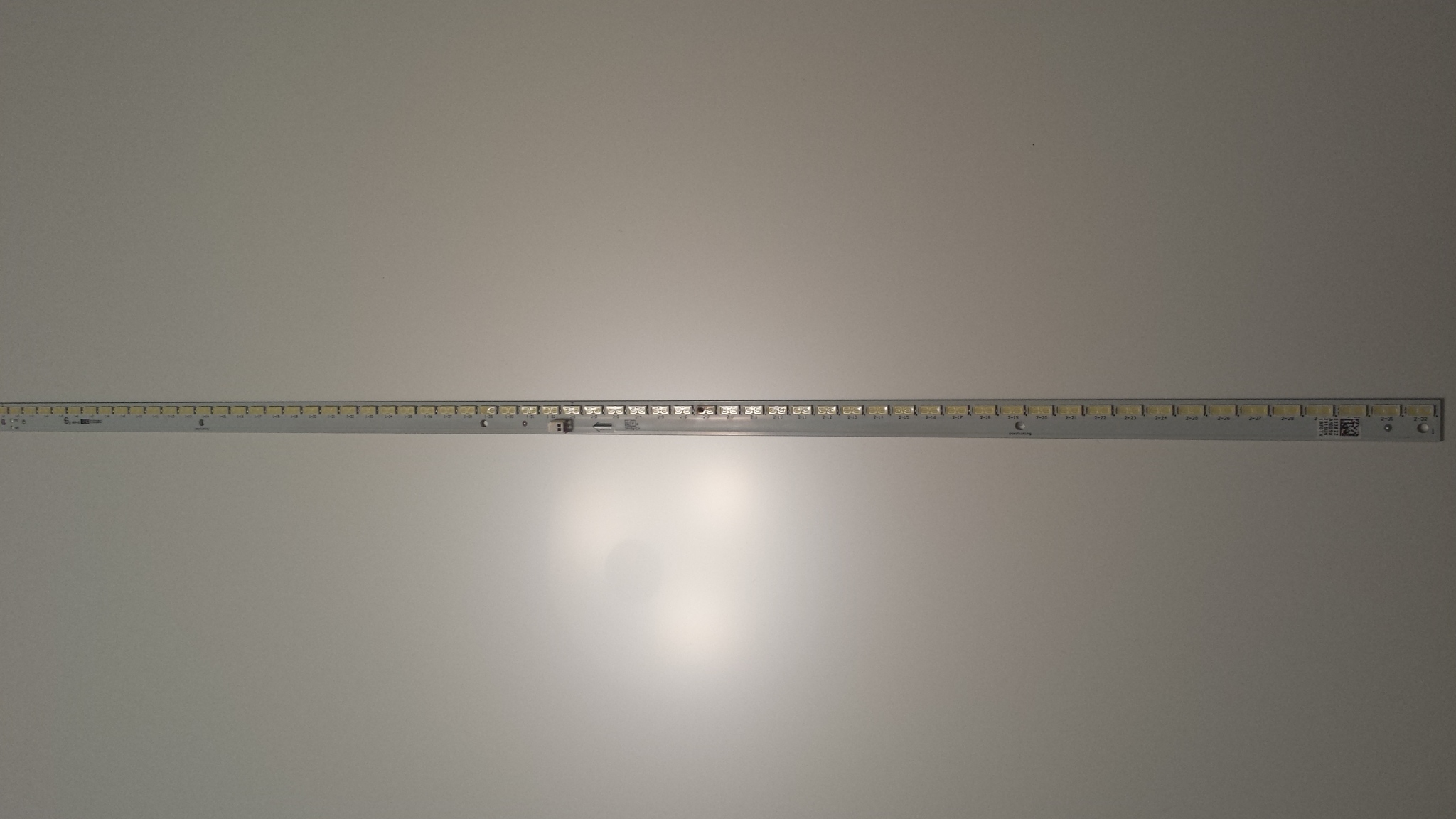

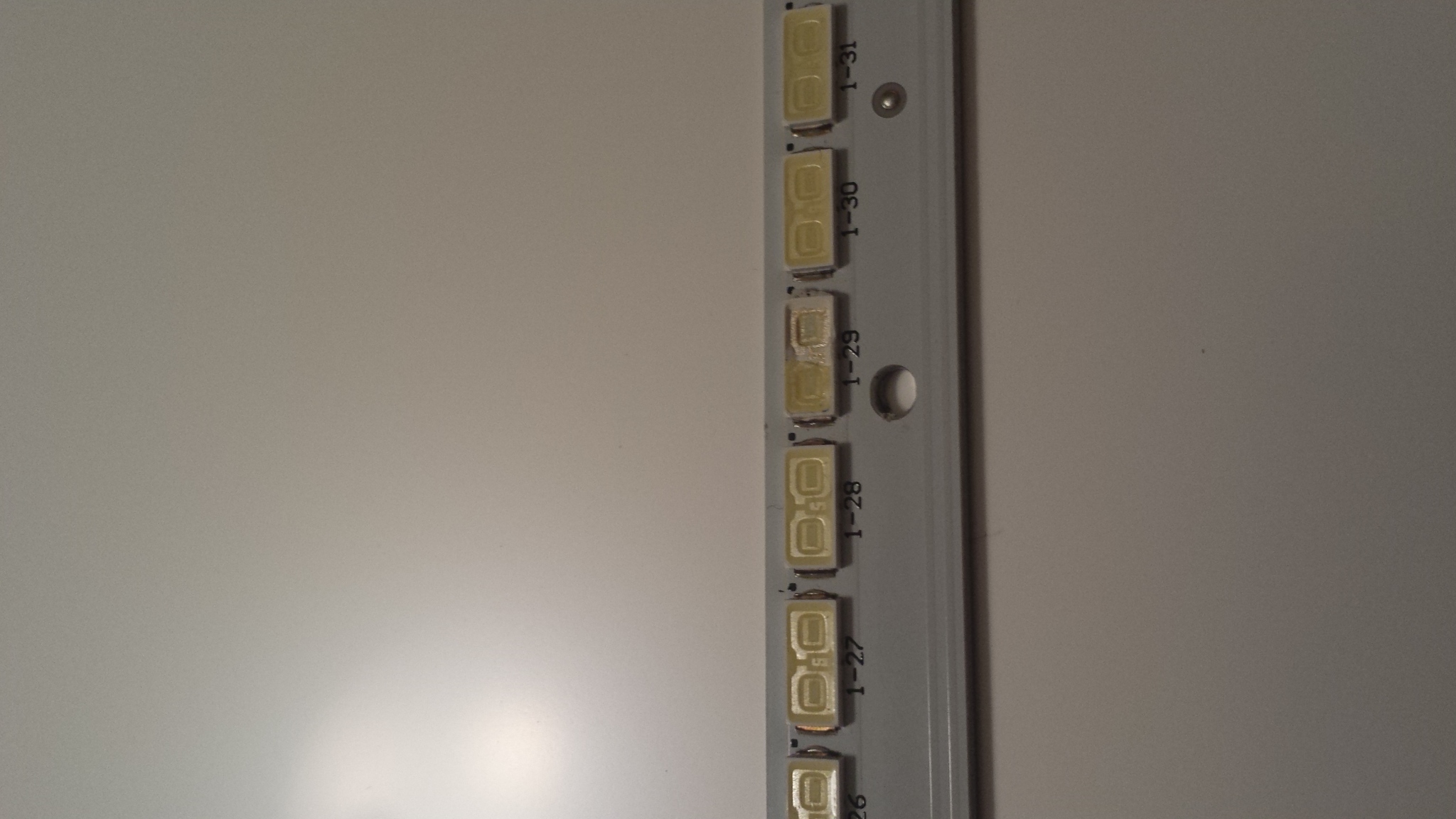

    So it turns out one of the three LED PWB strips is bad. Two of LED's are blown. What a tricky procedure to remove these. It looks like Sears Parts Direct has the strips in stock, I hope. Its going to be interesting getting this thing back together.
